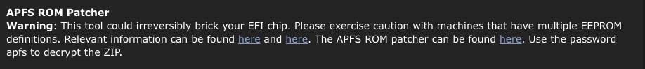

Arriving here a bit late on in this conversation, but have you installed the APFS ROM patch, this is different
from the APFS patch that you get with the Mojave Post install patches.
Go to the very first page of this discussion and scroll down to the APFS ROM Patch paragraph,
Click on the three blue here's for more information and the download.
Reactions: brian.tully
He's installed the APFS post-install patch - because he gets the scrolling text at boot. I don't believe he's patched the ROM. To me, @Syncretic has given him the best clues so far. He should mount the EFI partition and check the contents. Maybe he'll find something missing.
