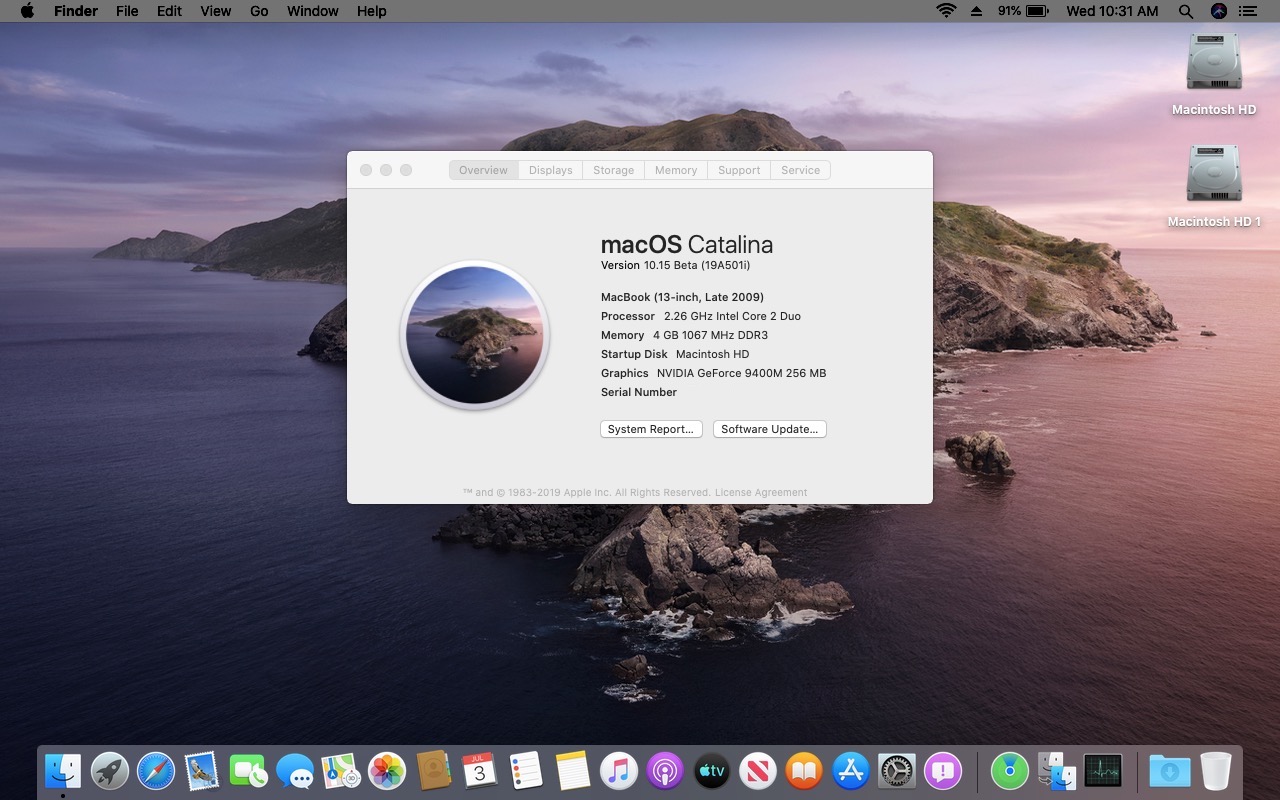

Installed DP3/PB2 on my 6,1. @dosdude1's patcher V 1.0b6 worked like a charm. The OS is a bit slower this time around compared to DP2/PB1, But it's much more stable. Something to do with Catalina, not the hardware. We'll see how the OS runs in DP4/PB3. I can send iMessages and do FaceTime pretty well on here. Regardless, considering this is only 4gb of RAM, I'm amazed how well it runs nearly 10 years later. I got SideCar working in system preferences. Now I have to figure out AirDrop and NightShift and anything else that I'm missing.
