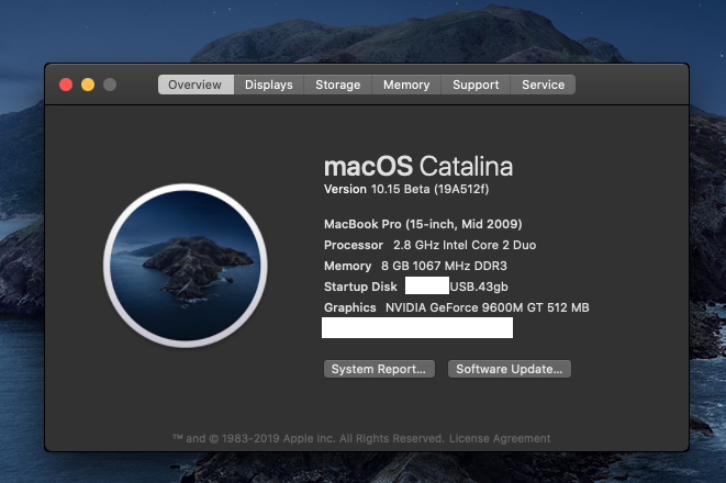

Well, I did try another boot drive to install Catalina using @dosdude1's 1.0b11 Catalina patcher. It did work albeit very slow since the boot drive is now USB, with my previous attempts to install on a SSD.
Steps followed:
  1. Booted into @dosdude1's Catalina Patcher 1.0b11 (which is formatted HFS by the way)
  2. Reinstall OS from the patcher utilities selection into a freshly created USB partition formated APFS.
  3. Took a while but finished installation.
  4. Booted to said USB/APFS attached to my MacbookPro5,3.
  5. Upon boot and setup for the "new" Mac with Catalina, got prompt to reinstall NightShift.
  6. Rebooted and everything looks fine.
Additional Observation:
  • After initial install, did not go into the Catalina patcher to execute patch updates.
  • After step 6 above, I viewed the Patch Updater and it did not list the APFS patch as being installed as I know this macbookpro5,3 requires it. @dosdude1 is this right?
  • Graphics acceleration accomplished, thank again to @ASentientBot. Question, will your other fixes, such as "auto mount" need to be applied?
Thanks again everyone and most especially to @dosdude1 and @ASentientBot !!!
An update .... now it will not boot back to my USB based Catalina boot drive. It used to be fine (see my attached screenshot).
I think there is some anomaly on my USB ports on my MacbookPro5,3. Is there a way to verify if the ports are ok or not?

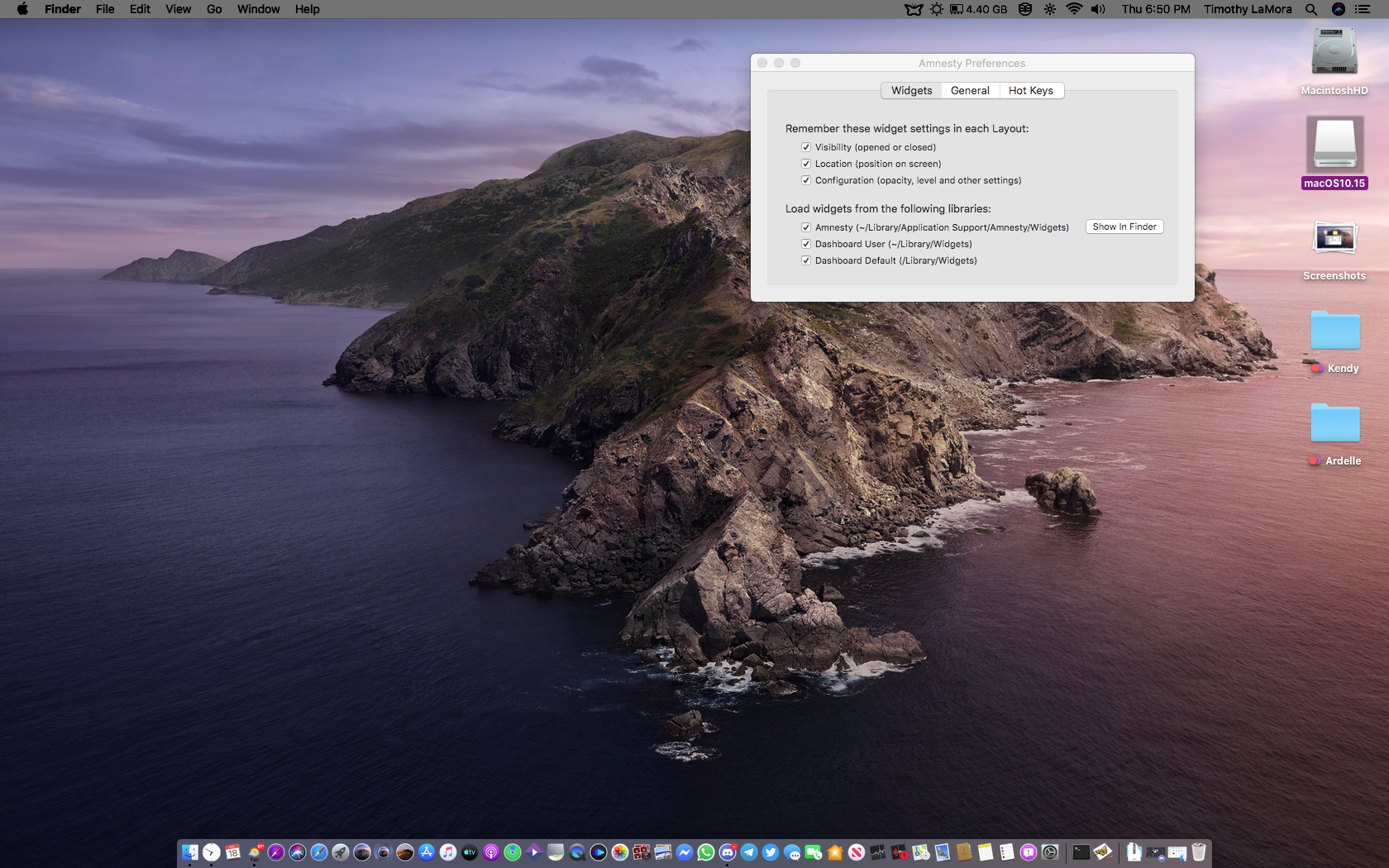

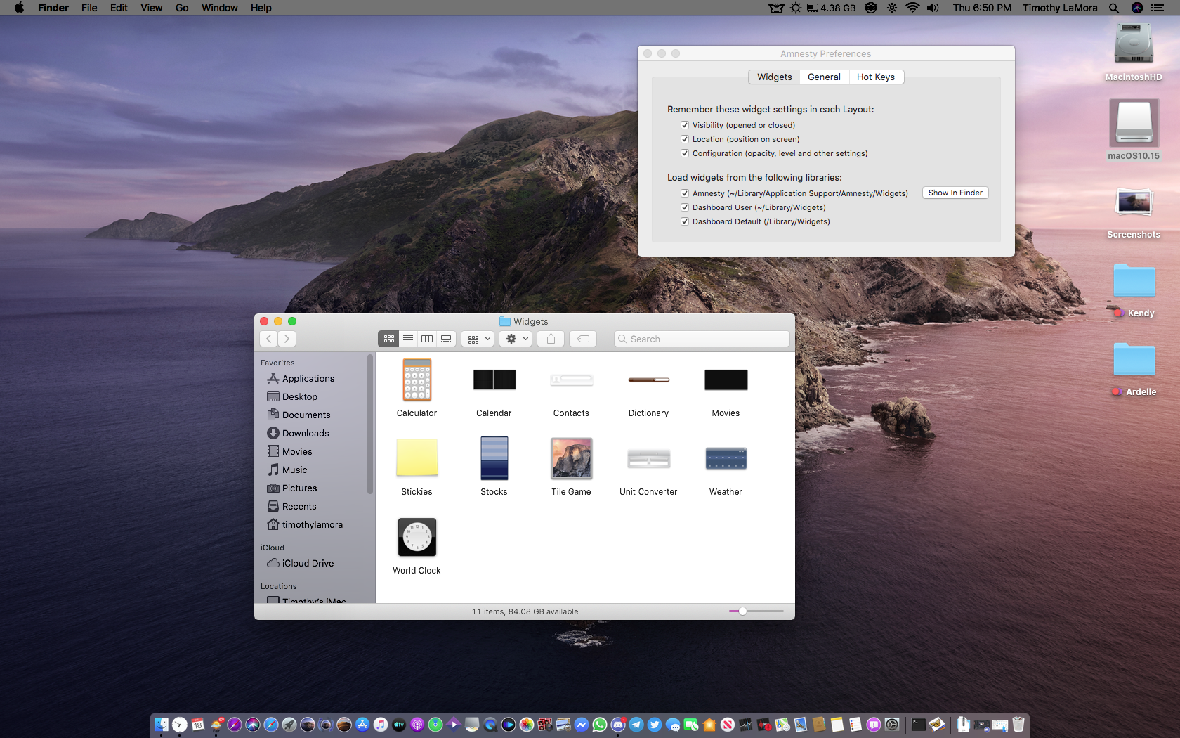

You need to download the widgets folder twice one goes in your library folder then install amnesty open the app then click on show in finder once it sows the widgets folder drop the widgets from the second downloaded into the amnesty widget folder then open each one and you will have to authorize each in security then close amnesty then reboot then open amnesty you see them listed in then menubar
  • Amnesty.zip
  • Widgets.zip
Reactions: PeterHolbrook
An important part that amnesty app is unaware of, is that to make a widget completely functional and customisable with the little "i" at the bottom-right of it, is to copy this folder (I attached) inside this Catalina path: /System/Library/
Just to clarify the widget resources goes in the System/Library folder :)
