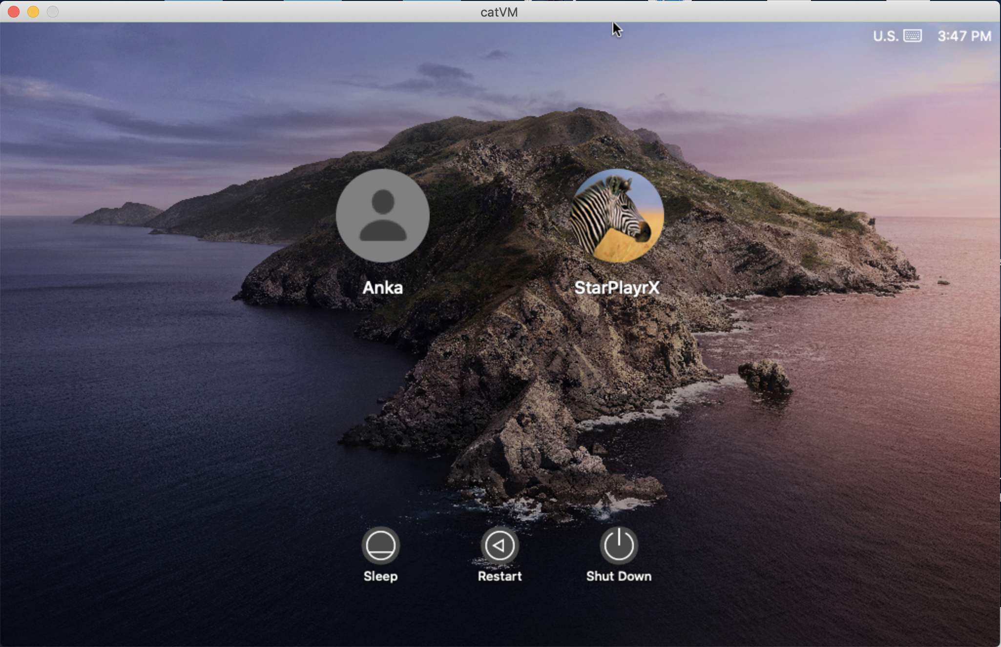

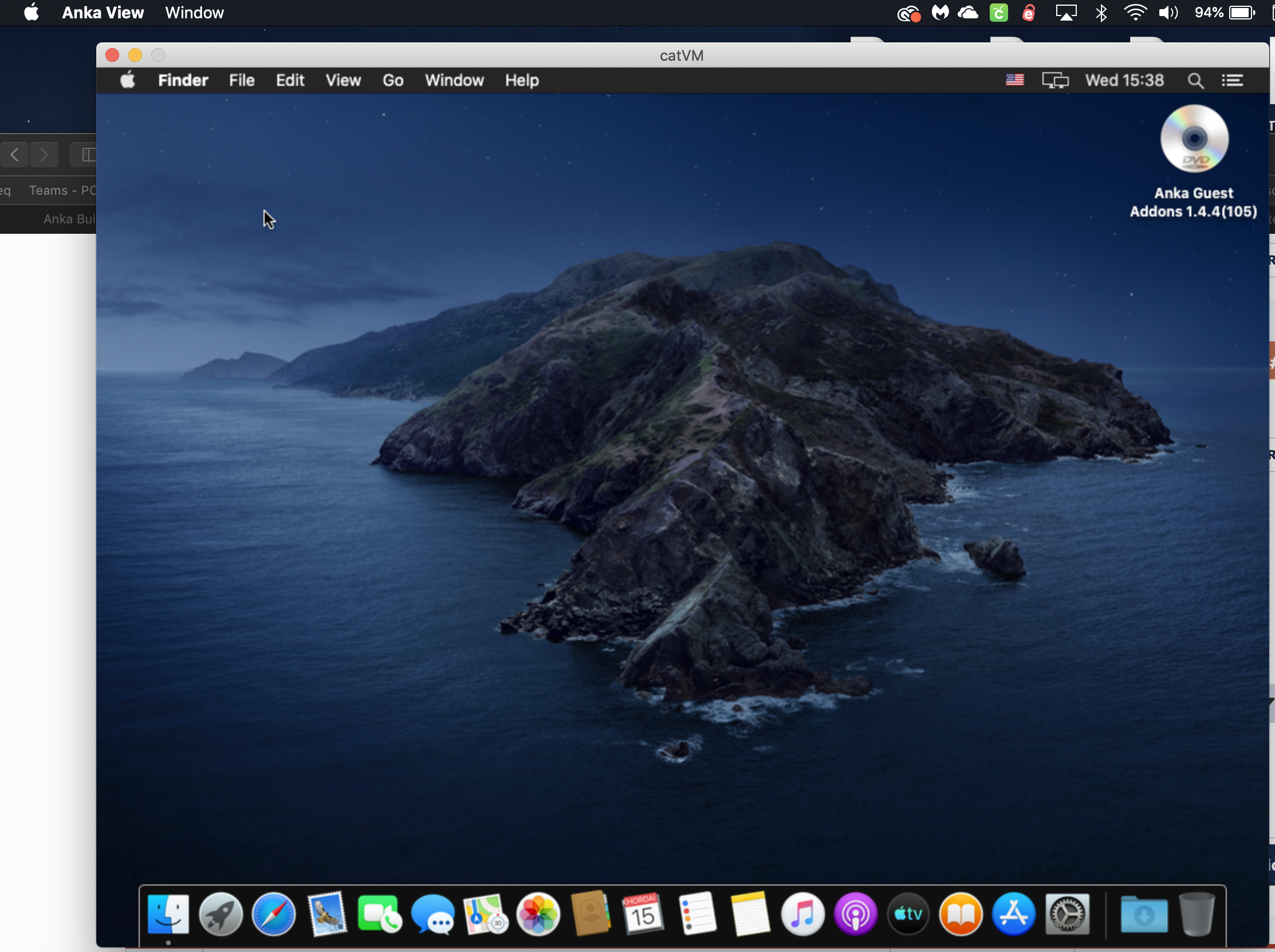

As a test from my supported Mac, I was able to get Catalina running on Anka Build VM. No networking on it yet. Just got it working. I am curious to see if Anka will run on my 2008 Mac Pro. Tip: On Mojave do not install the Nested VM option. It is not compatible with Mojave.
In case you are wondering why is this good? For developers, it has access to USB devices like an iPhone and it can be used in the cloud or on your own desktop. (with some command line setup) Going to see if Anka will run on an unsupported Mac. Anka Build runs in the command line but it's not free, but there is a free trial. I thought it might be nice to tinker with while I am working on a native install on my Mac Pro 2008 3,1.
Anka VM uses only 15MBs for its app to run. It uses Apple's Hypervisor framework.
I have a Mac mini "server" via a web host and this may be a good option for me to support SwiftUI development remotely. And put my server software within "Containers" like Docker.
Anka would not install Catalina as a VM or run it on Mac Pro 2008. Parallels (same as with Mojave) will run the Recovery disk installer with Catalina.
