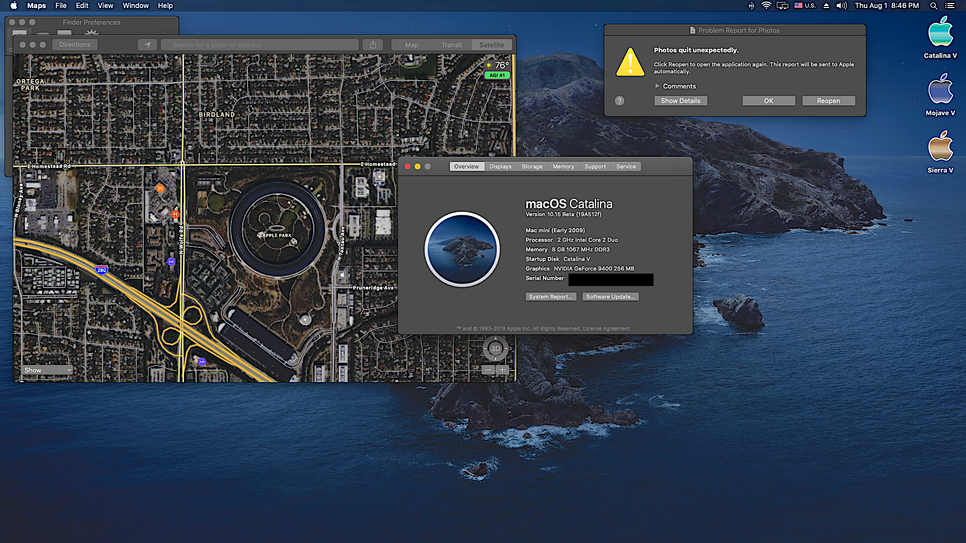

Latest updates, Macmini 3,1 early 2009. Maps, yes. Photos, no. Bluetooth and WiFi working fine.

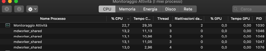

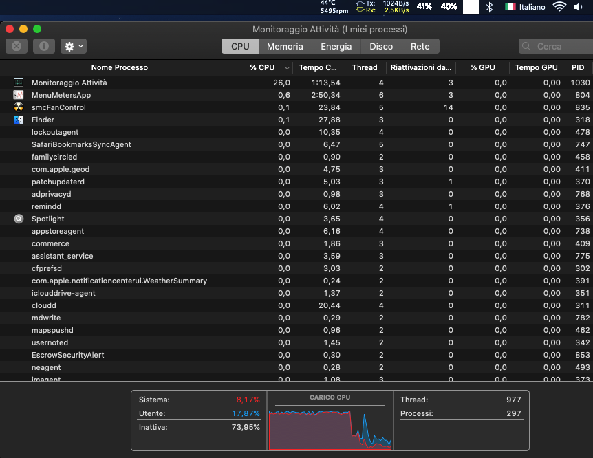

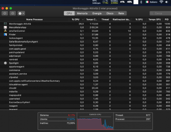

@dosdude1 @ASentientBot Macmini mid 2010 (Macmini4,1) 100% on both CPU due to mdworker_shared (multiple instances) i'm leaving it running for 2 hours (70° C with 5500 RPM fans) to see if process are automatically terminated after file indexing.
[SOLVED] After 2 hours processes has been terminated and CPU and temperature is OK!
