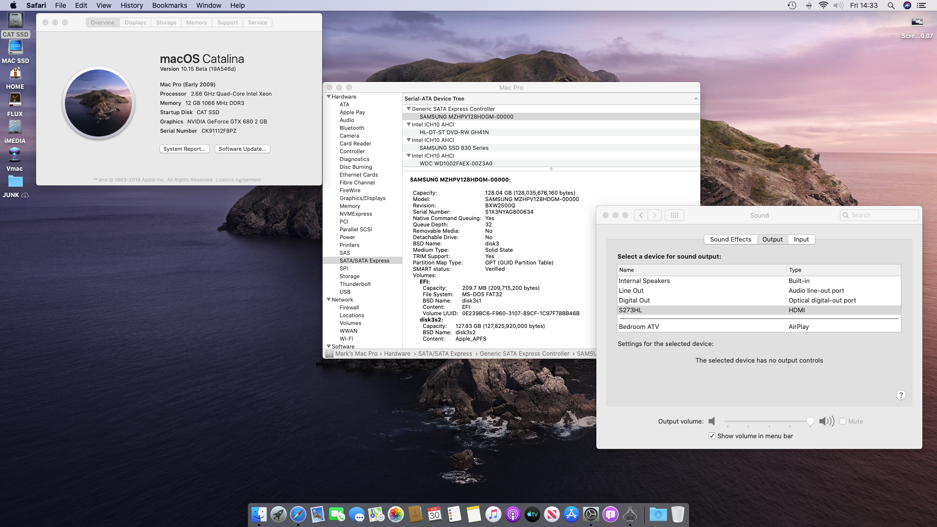

all working even got the HDMI sound working. also have the pic m.2 ssd recognised as internal
Dosdude your patcher is the business

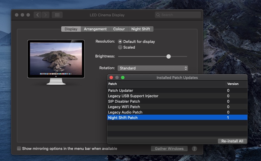

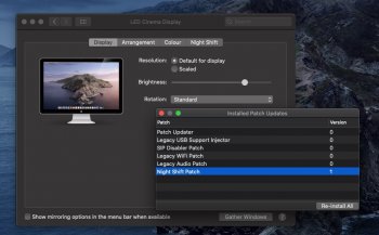

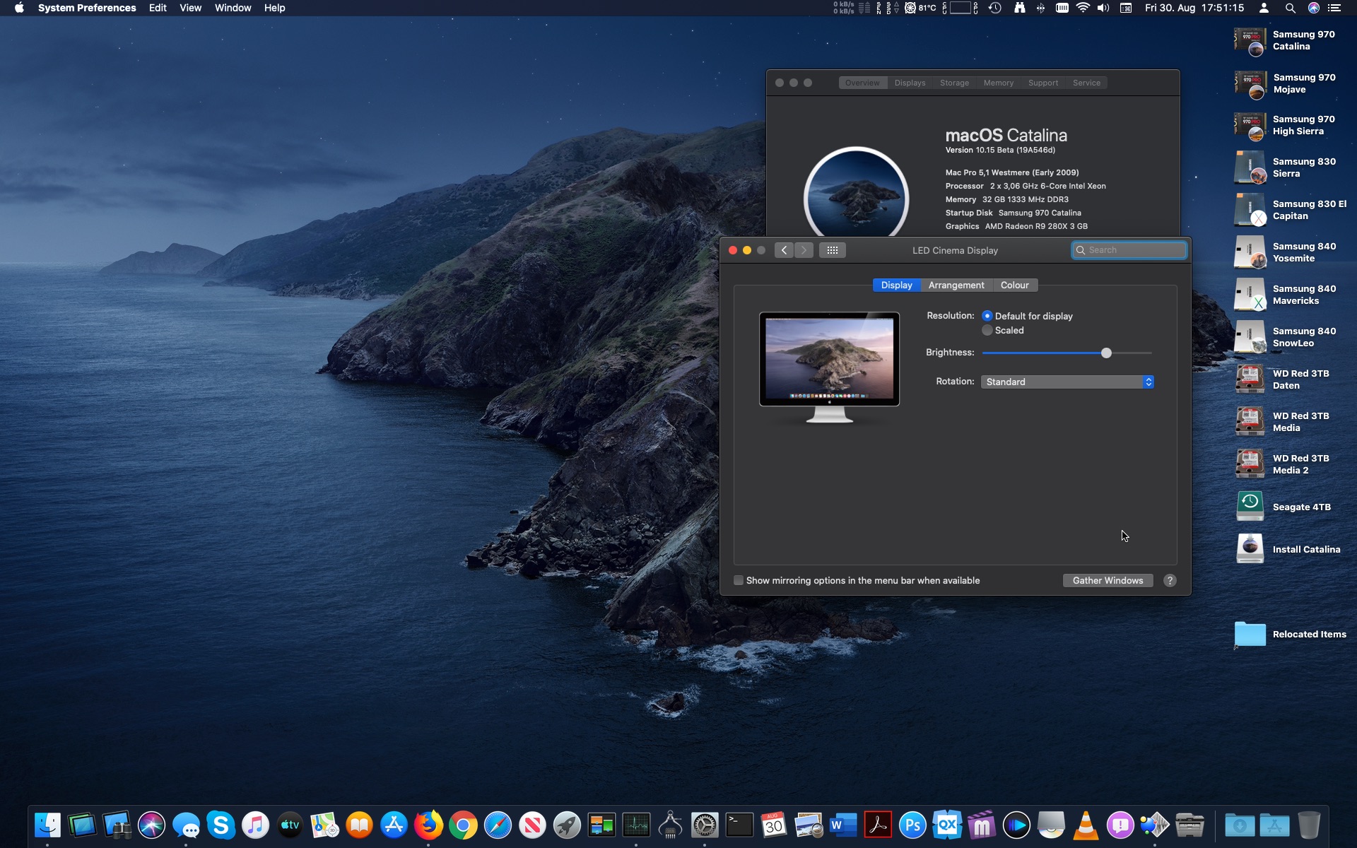

Got Catalina updated to DP7 w/ Patcher v1.0.8 on Wednesday, it went smooth on a cMP 4,1/5,1 – thanks again.
Noticed now the NightShiftUnlocker patch seems not to get applied anymore. Had it working with my LED CD in previous Betas, see #155. Tried to install the @cdf v2.2.1b version manually in Library/Extensions/Lilu.kext/Contents/Plugins like I used to do it in Mojave, works fine there but not anymore in 19A546d. Re-created the installer with v1.0.9 and ran the post install, no luck.
Other than that, no major issues except I'm missing Movie Explorer which is crashing with this build.
Edit, FYI @dosdude1 – it's back. Ran the Patcher Updater and was offered the Legacy USB Support Injector additionally. Once installed the Night Shift Patch showed up, with Re-install All and a reboot it is working now.

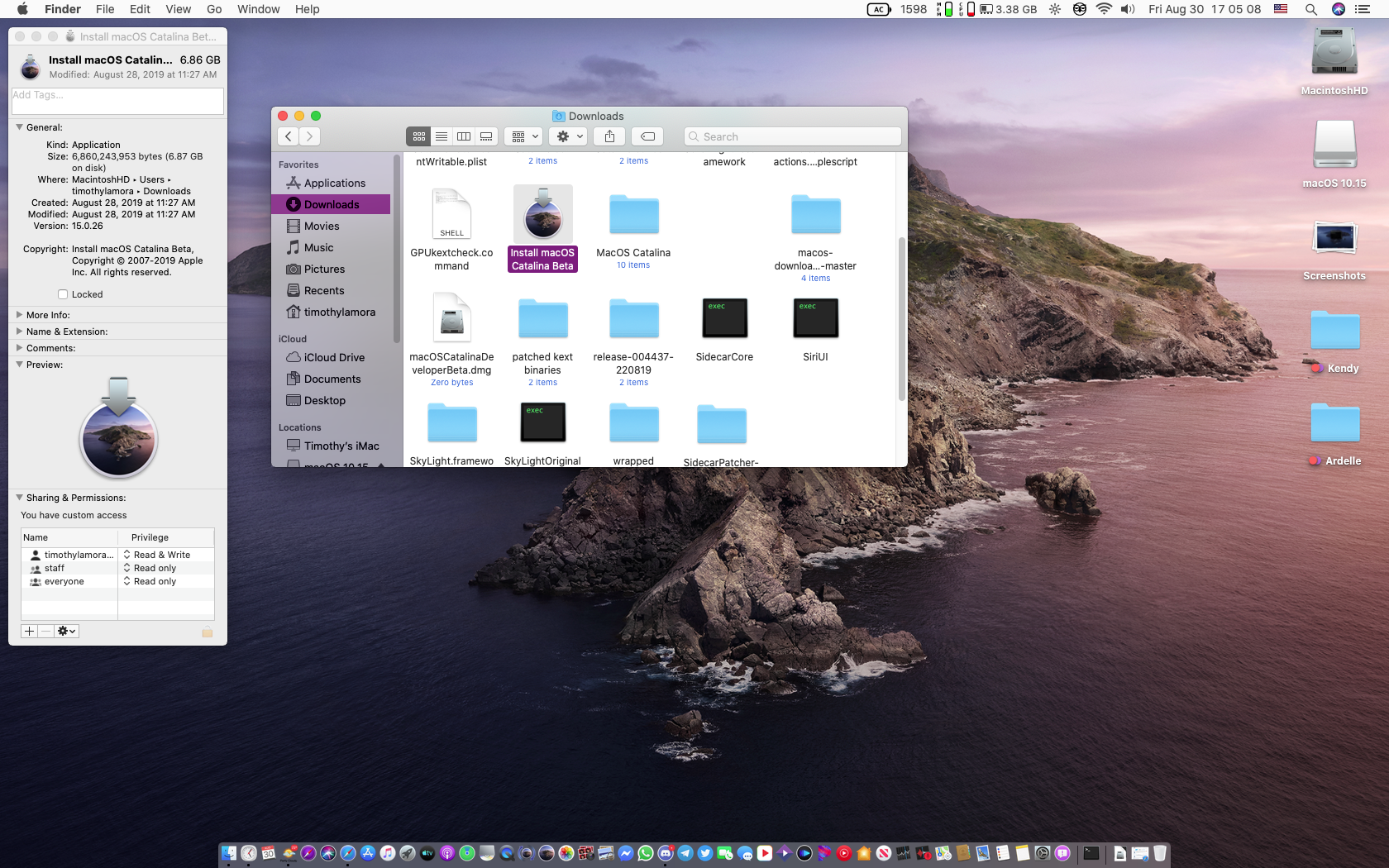

When I boot from the patchert and click on Install a new version of Mac OS it shows the version as (19A536g) isn't that the old version? My regular i Mac has ((19A546d) Now how do I know for sure?
The latest version should be 19A546d
[doublepost=1567210109][/doublepost]If you download a copy it goes in your downloads folder if you already have a a copy already downloaded there you move it to the applications folder the previous version should be 15.0.25 if you right click and click on get info when you move the one you have download a new copy then right click on it then get info if it says 15.0.26 you have the latest version
When I boot from the Patcher SD card and click install a new copy OS Mac it starts to install and on the top of the second page it shows the old version. Should I not be installing from the SD? And install direct from the install OS? But when I right clicked on the file and get info in Applications it does show new version. And yes right click does show proper version.
