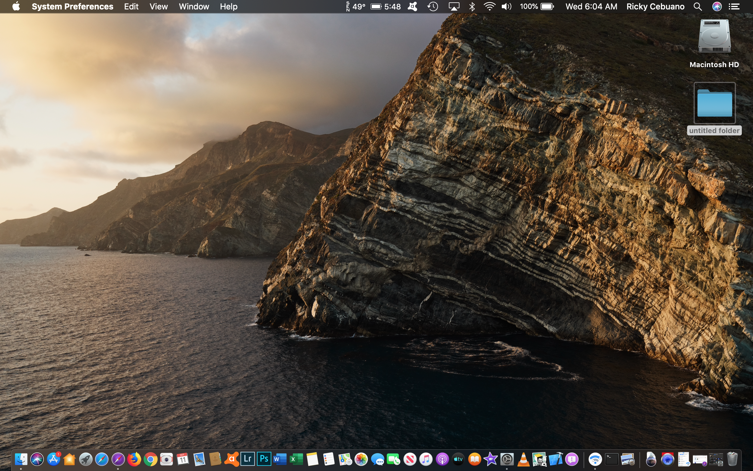

most likely Apple took into account some sleep for 8 hours so that leaves 16 hours so the dynamic changes every to hours as mine has changed
It's the same reasoning I did when generated the catalinadynamic.heic (I created the latest json pic change after 2 a.m. and then restart from the first about after 8:00 a.m. with changes every 2-3 hours), but in some way also with the Mojave.heic (16 pictures) apple probably already reserved 8 hours (16+8=24h) for sleeping.
For me I like both light and dark mode and watching the changes during the day maybe it is possible to create a script running in the automator using the 4 dark macOS Catalina Desktop pictures while in dark mode

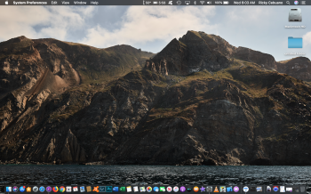

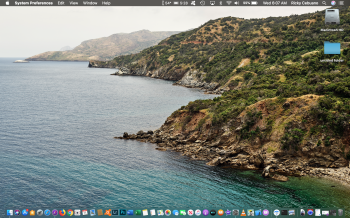

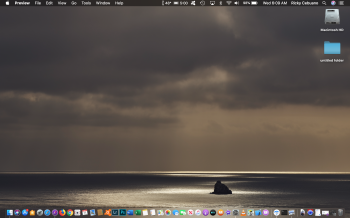

catalina beta 8 total of gorgeous 9 Catalina wallpapers.
Reactions: TimothyR734

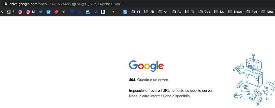

I get a 404 error when trying to get the latest patcher 1.1.1
I was just going to post the same thing...

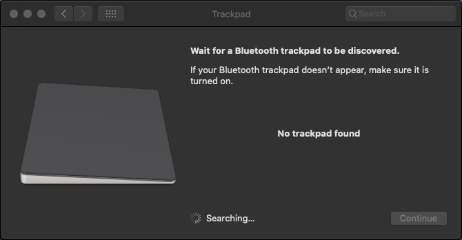

Anybody else is having an issue with the trackpad not being recognised in System Preferences? It is actually working but I am unable to change the settings. Any possible solutions/kexts?

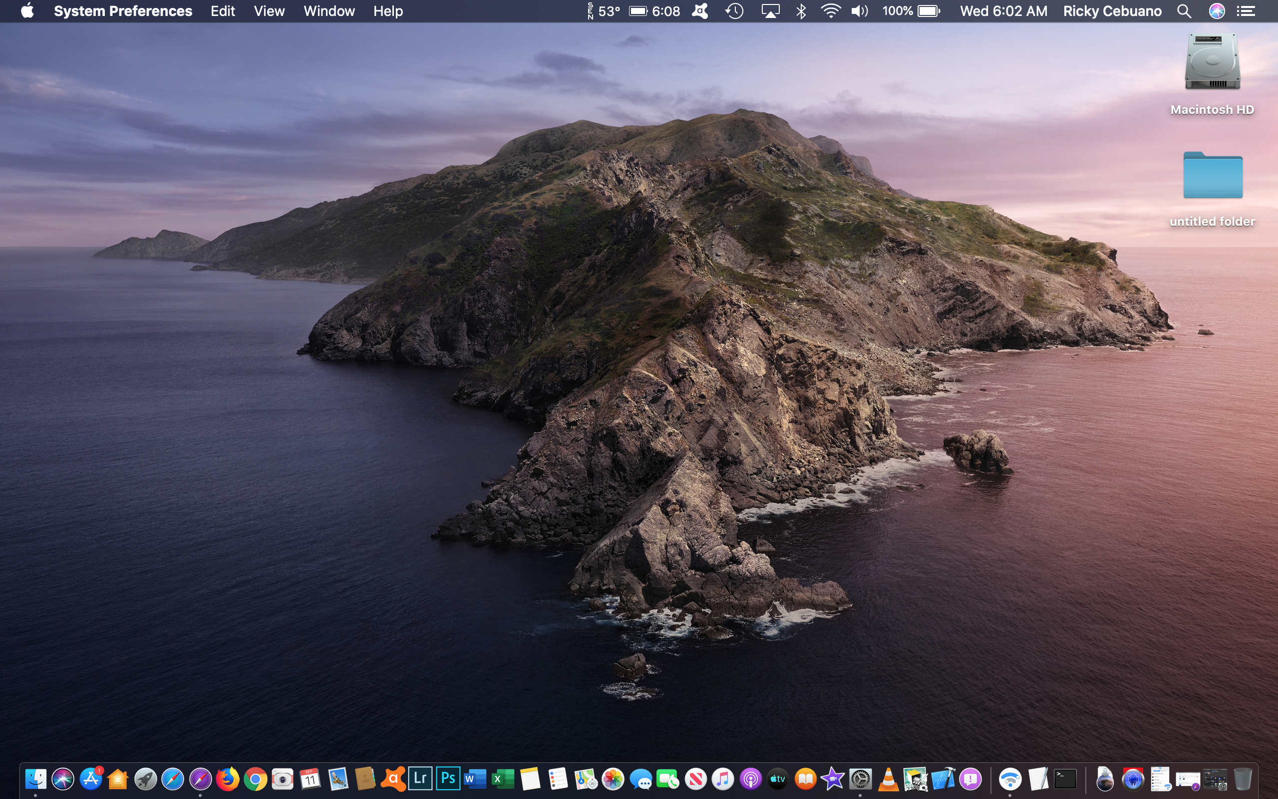

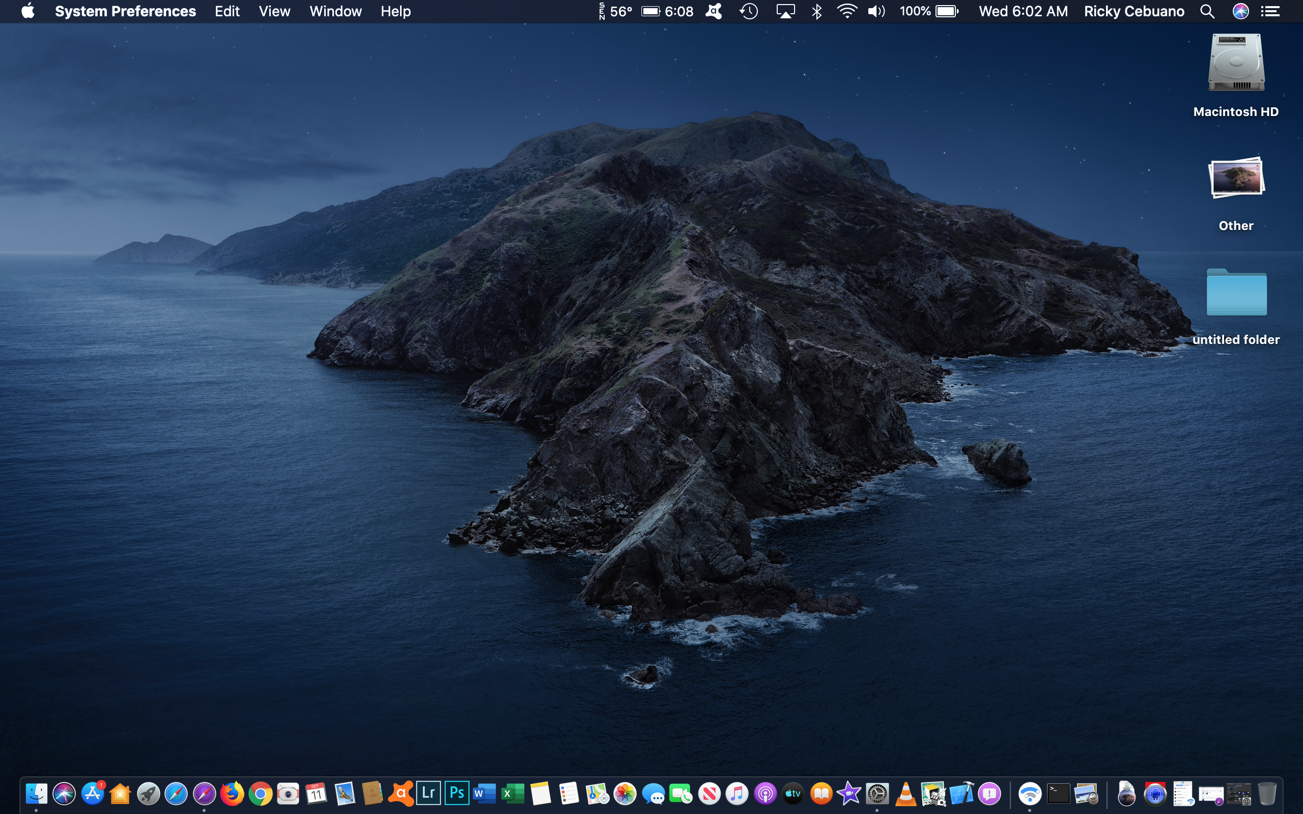

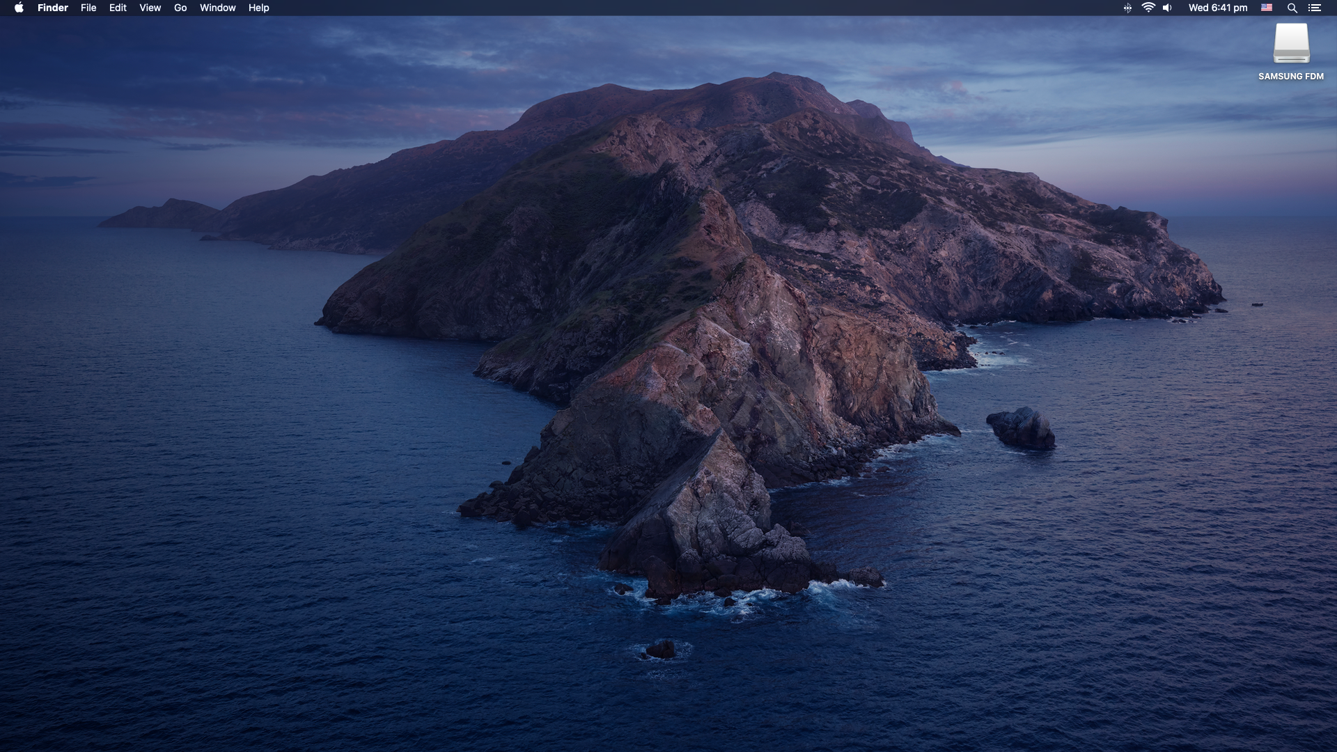

Dynamic Catalina Wallpaper seems to be working for me even in Dark Mode.
