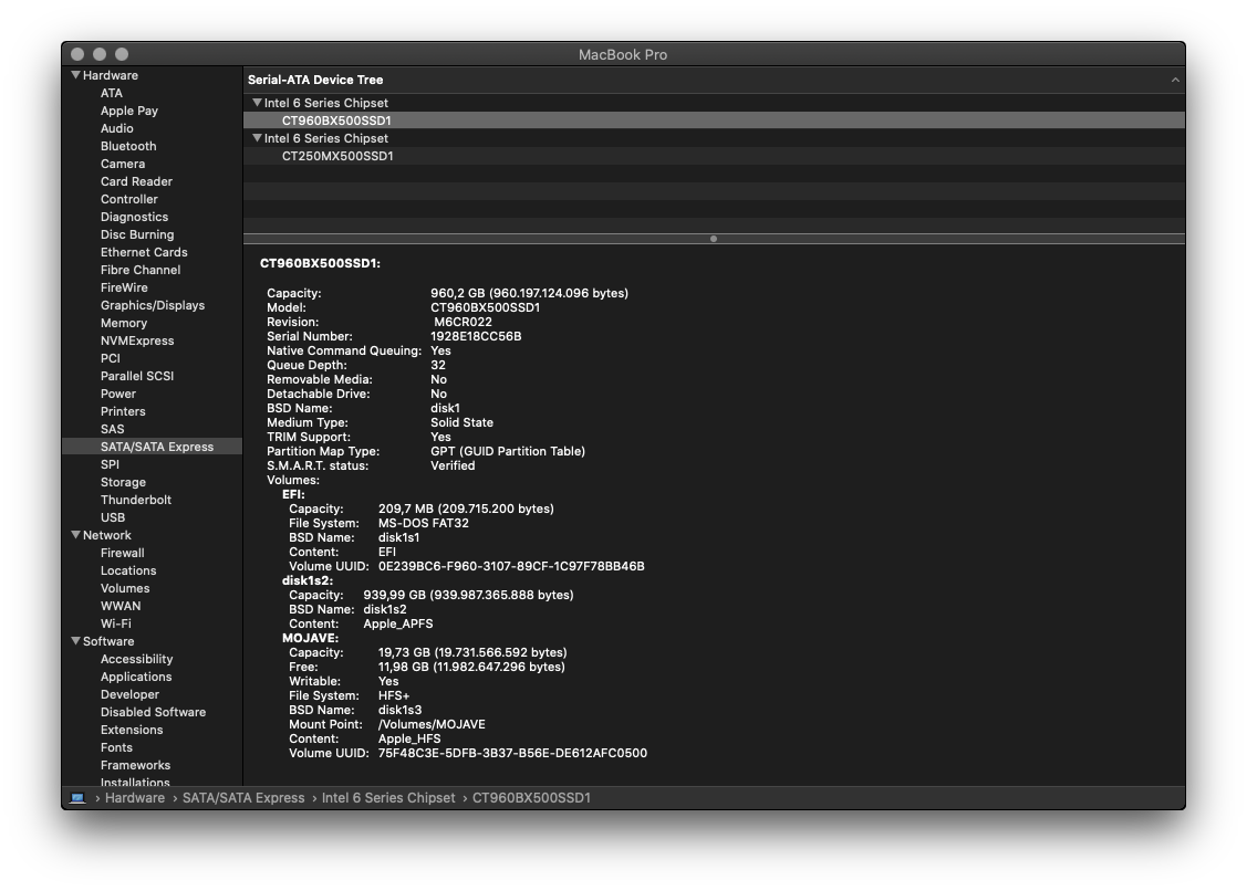

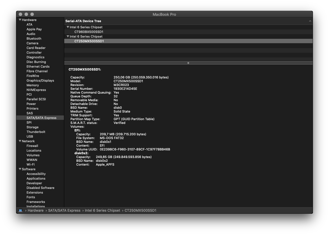

I'm with TRIM support using Trim Enabler (https://cindori.org/trimenabler/)
Reactions: TimothyR734

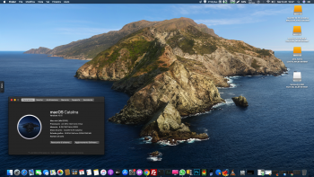

Reactions: ASentientBot
