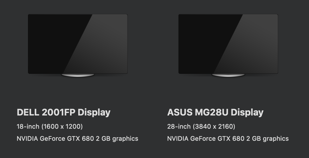

@L Caputo - I use the HDMI port on my 4k TCL 43" TV. However, I was able to connect a 27" Dell monitor and can get a signal on both the DVI ports, but not on the DisplayPort. I believe there are other posts that stated the same thing. At some point the DisplayPort stopped working. Hopefully, Apple will fix that in a later update, but I'm running fine with the HDMI port.
Ok so its Apples usual arseholery that has disabled the Displayport.
How do you get sound from the HDMI port, in previous versions of OS I have to install
an HDMIAudio.kext so I can select my TV in the Sound Output preferences.
Are you using anything to get sound through HDMI.
Thanks.

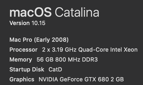

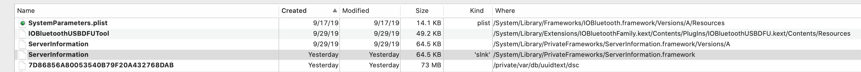

I was able to hack my system literally and got the DisplayPort to function.
This is not recommended, but I have some follow up stuff that may be of interest to whoever wants to create a patch.
Using Clover and Clover Configurator, selecting only a SMBIOS profile of Mac Pro 3,1 profile for my system and only changing the Board ID to the Mac 10,1 board ID of 'Mac-F2268CC8', and using the Clover boot loader, I was able to get DisplayPort to function on a Mac Pro 3,1 with an Nvidia GTX 680 Card with 4K@60Hz on the Display Port just like it did on the the early betas.

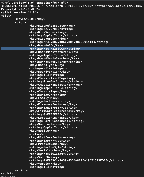

Now I did a search high and low for that 27" iMac 2009 board ID F2268CC8 and it is present in 4 files:
IOBluetoothUSBDFUTool
IOBluetooth.framework/.../SystemParameters.plist
.../PrivateFrameworks/ServerInformation.framework/ServerInformation
/private/var/db/uuidtext/dsc/7D86856A80053540B79F20A432768DAB <!-- that # may vary
I don't know if this matters but the Mac Pro 3,1 board ID is not in the two IOBluetooth files.
Now I have not tried swapping out that data from my working Catalina Beta or tried doing any hex editing yet. It spent a good bit of time all day yesterday just swapping out .kext files to no avail.
I did see an osX86 user have the same issue and he chose a Mac Pro 6,1 profile. That just KPs my system.
Again, using Clover is not recommended and once there is a proper patch, I will discontinue using it. I think for troubleshooting purposes, it does show that the DisplayPort can still be made active on Cat 10.15 GM and this does not appear to be a Video driver issue at all. I don't even think it is actually an AppleSMBIOS or System.kext issue either as I originally had thought. Just that Apple probably removed DisplayPort access on certain configurations.
Hope this information is helpful and that someone finds a fix so Clover or another bootloader does not have to be used. Attached are some screenshots of my findings.
Also several iMac profiles do not allow the DisplayPort to be used either, so this issue could be fixed by Apple, but also they may only fix it with certain board types. We shall see what .1 and .2 bring.
If no one tackles this, I may run a few more tests next weekend. I am hoping we can collaborate on this problem as I know there are better patchers on here than me.
Only caveat to swapping on a board ID is Apple may deprecate another board ID in the future. We all might be on borrowed time, but so far I am just glad to have 4k@60Hz back and can start building my 10.15 system out.

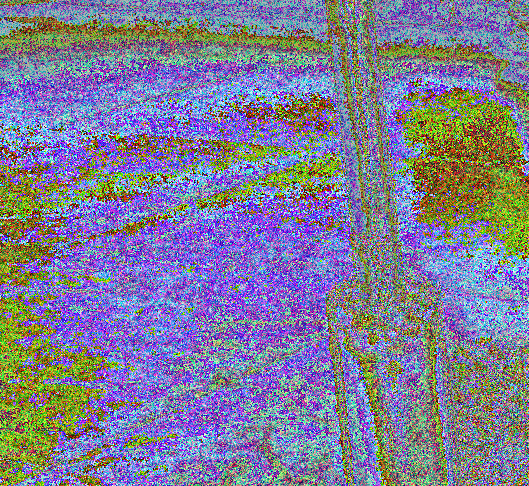

Thank you for dosdude1 and all that involve working to keep our old Macs running current OS.
I have the same problem with Photos, see pict., Final Catalina late 2009 iMac Radeon HD 4850.
Only when double click the picture though. Other than that so far no other side effects.

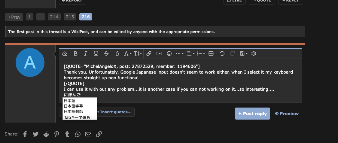

I'm stuck with the Japanese Romaji input giving roman phonetic equivalents of kana. The fact that selecting kana input at Japanese Keyboard Input Sources works (but using the awful kana key layout) to display the correct Japanese character, while selecting Romaji input does not work is weird.
Everybody, including Japanese natives, uses Romaji input and not kana input so this is a big issue for the few Japanese nerds using this patch.
Do you have any ideas dosdude1 (Colin)?
I don't have the courage to go through the whole forum to see if someone has found a solution to this problem. I run Catalina on an old mid 2009 13" MBPro and I also cannot input japanese through romaji, only with the japanese hiragana keyboard layout. The romaji will just not convert into hiraganas. This is kind of a bummer for me since I live in japan and have to write in japanese quite often, for now I write on my phone but that's not very convenient. Any chance for such a fix ?
Antony34 reports that installing either a free Google Japanese input alternative or a paid ATOK version overcomes the problem, but if you want to stick with Apple's Kotoeri it seems Asentientbot thinks the best short-term answer is to roll-back to Mojave (or get a Mac later than 2012 that officially supports Catalina). I am lucky because I do have a later model laptop so that's what I'll use for Japanese input now and the old MacPro 3,1 will be reserved for working in English.
Thank you. Unfortunately, Google Japanese input doesn't seem to work either, when I select it my keyboard becomes straight up non functional

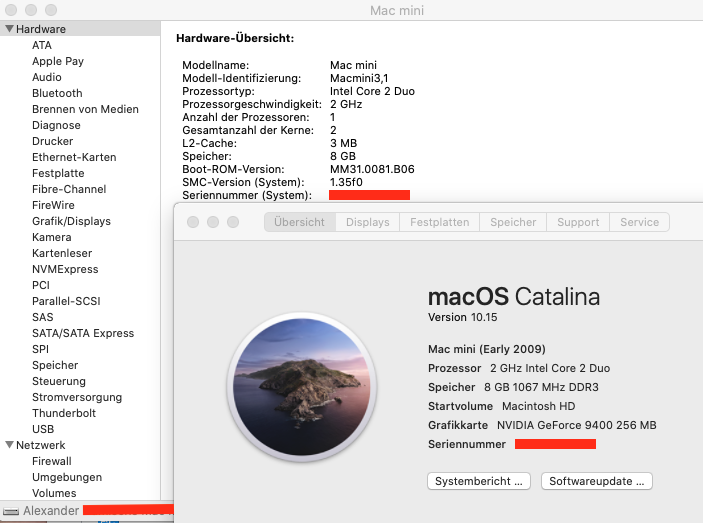

Sorry for wasting bandwidth with a success message: My mac mini from 2009 directly went from El Captain to Catalina! The dosdude1 patcher would fail when running directly from the mini (failing to load kernel extension), but after trying twice with USB, it was up and running. (failed the 1st time... just ran it again)
This is hilarious, and I never expected this to work, considering that my iMac 2011 is out (stupid Radeon HD).
One funny sidenote: It even shows the Sidecar pane in preferences! I never got this to work on my mac pro 5.1.
Congratulations and a big thank you to dosdude1 and team for reducing the waste on this planet!

Guys, please read the thread properly (to avoid duplications, but I know many pages already).
The solution for messed photos in the photo app is described in comment #4672 on page 187:
Some AMD GPU cards (mainly iMacs 2009/10 affected) do not support 10bit resolution (billions of colors), but only 8bit. Therefore use a freeware tool like ResXtreme app (Version 1.0.1) and set your resolution to 8 instead of 10 bit/sample (working with Catalina 10.15 on iMac 11,1 i7).
I'm also using the romaji-input. And it's working just fine.
Try something that refresh input sources, like remove and re-add the input source.
We definitely are on borrowed time. The real question is whether Apple will bother to prune out the remaining legacy support in Catalina for the MacPro 5,1 in coming point releases? I suspect not but they definitely might inadvertently break parts of it when those sections get updated to fix bugs. As for the OS release beyond Catalina, I could see Apple bumping up their default compiler flags to expect AVX support across the board. After all, do we even have any supported machines left that don't have AVX-capable processors?

I do not have a CAT supported machine but I am using the cMP5.1 unpatched. Using dosdude1's patcher the recovery partition is not functional. In fact, looking back at the many years and OS I have used the patcher the recovery partition was never functional. I have a vague recollection of dosdude1 confirming this somewhere but not entirely sure. Anyway, I always used the USB patcher or USB from "creatinstallmedia" to boot to a recovery if needed. Now that I do not have a boot screen I have found the recovery partition more useful. I have used this to make a fully operational recovery partition: Catalina Recovery HD Partition
I can use it without any problem...it is another case if you can not working on it...so interesting....

I have activated Apple Arcade and it works fine also with my poor hardware: Core 2 Duo 2,4 GHz, 8 Gb RAM, Nvidia GeForce 320M. Remove all USB pendrives and hard disks and you will have a much faster system 4% CPU instead of 40% IDLE, due to the heavy Spotlight files indexing.
