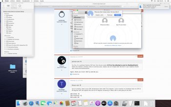

Here is, use the attached only for MacBookAir4,1 and apply following this method: https://forums.macrumors.com/threads/macos-10-15-catalina-on-unsupported-macs.2183772/post-27887552
Thank you, it is working for me on the MBA 4,1. Airdrop works bi-directional. Next stop will be the continuity.

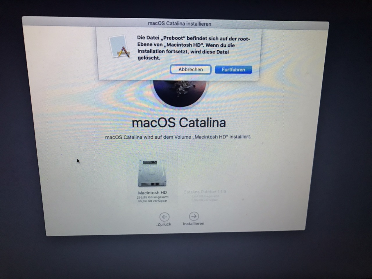

Hi,
I just prepared a stick with installer 15.0.33 using Patcher v1.1.9 to install the supplemental update...
However, I get this notification when starting the installation:
“The file ‚Preboot‘ is on root-level of ‚Macintosh HD‘. If you go on with the installation, this file gets deleted“. See screenshot.
Is this normal/safe?
Reactions: TimothyR734
While Catalina Patcher 1.1.9 can't produce a usable usb installer, installing from the 10.15.1 beta 2 full installer (15.1.2) onto an usb drive using a supported machine then moving this usb drive to apply the missing patches from a patched usb installer of 15.0.33 worked. The resulting 10.15.1 beta 2 volume runs fine on a MacPro 3,1 with GTX680 so the reports of removal of required SATA support are rubbish.
