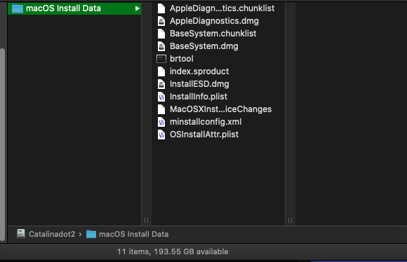

Similar situ here - "Install to machine" failed to clean install into an APFS container. After failing at the install step, after everything was built . . . . it looks like, here is what remained on both the source and target partitions. Patcher 1.3.0 and installer 10.15.2.02. The two screenshots are titled.
