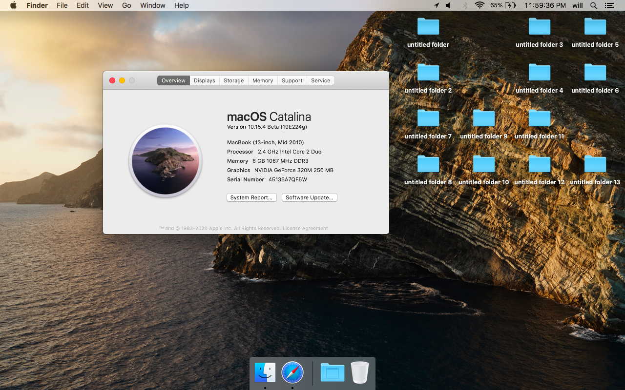

10.15.4 DP1 is now working on non-Metal systems with an update to my framework wrappers!
It was actually semi-usable prior to the update, but with some missing functionality and extreme slowness caused by services constantly crashing, as well as an inability to rebuild the dyld shared cache because of missing symbols. This is now fixed and the beta seems to run normally.

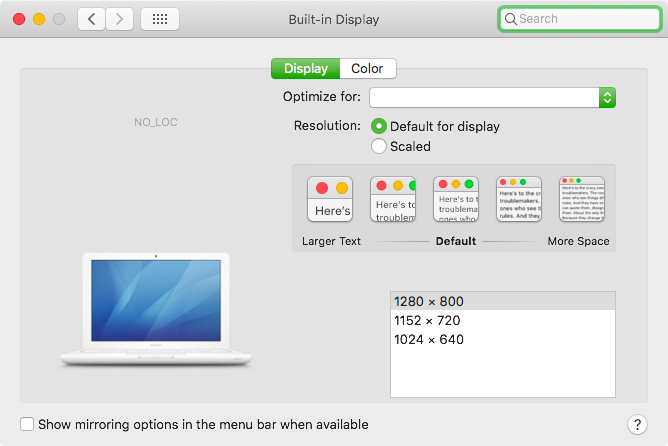

The one issue I notice is that Displays prefpane is totally borked. I'll see if there is a fix for this, but it doesn't impact the functionality so I'm not too worried about it.

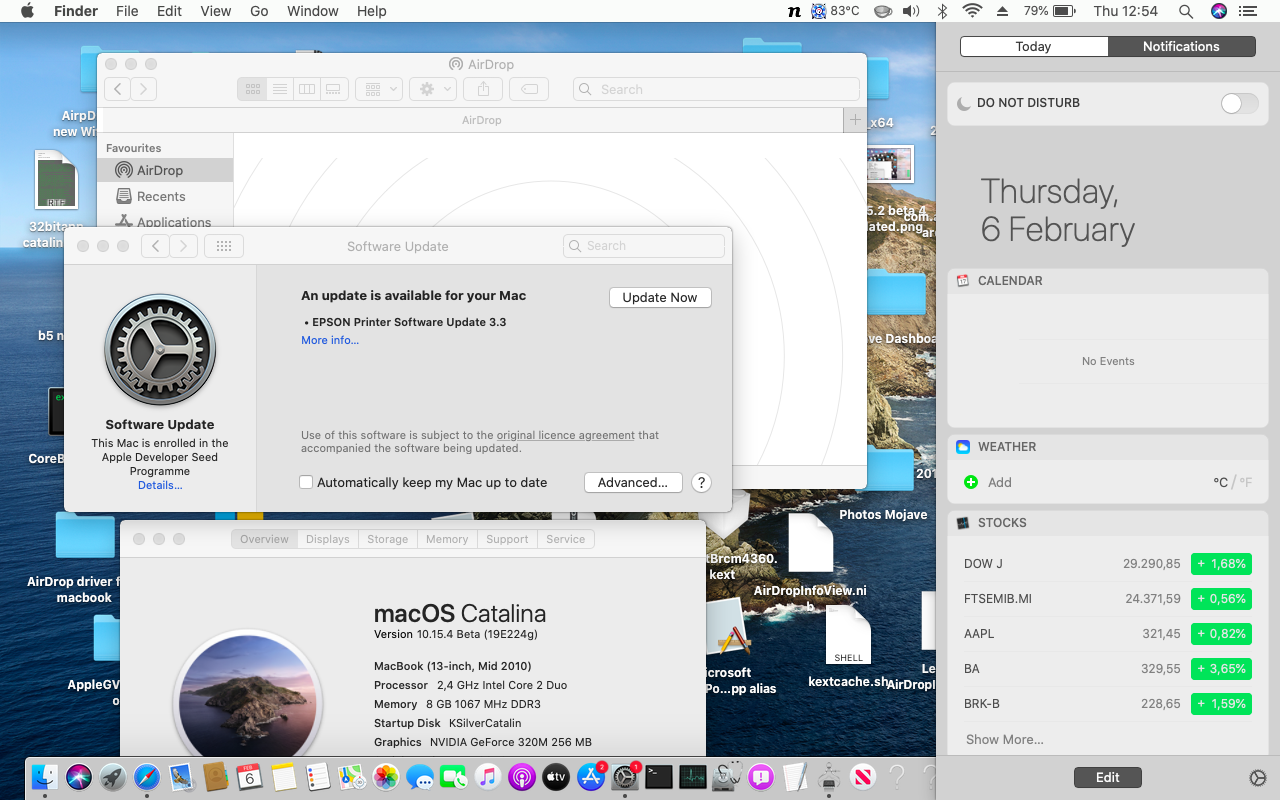

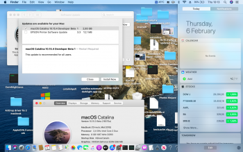

I have OTA updated from 10.15.3 beta 3 (19D75a) to 10.15.4 beta 1, using swupatch, the Pinarek method and my script catalinaswufix3.command still worked correctly, I mean applying all the known post-patches for machine model, except the Video patch, infact I have re-used the stock Catalina 10.15.3 : CoreDisplay and OpenGL (frameworks) + SkyLight and GPUSupport (privateframeworks) and system booted correctly to the GUI mode (pictures attached) without graphic acceleration of course.

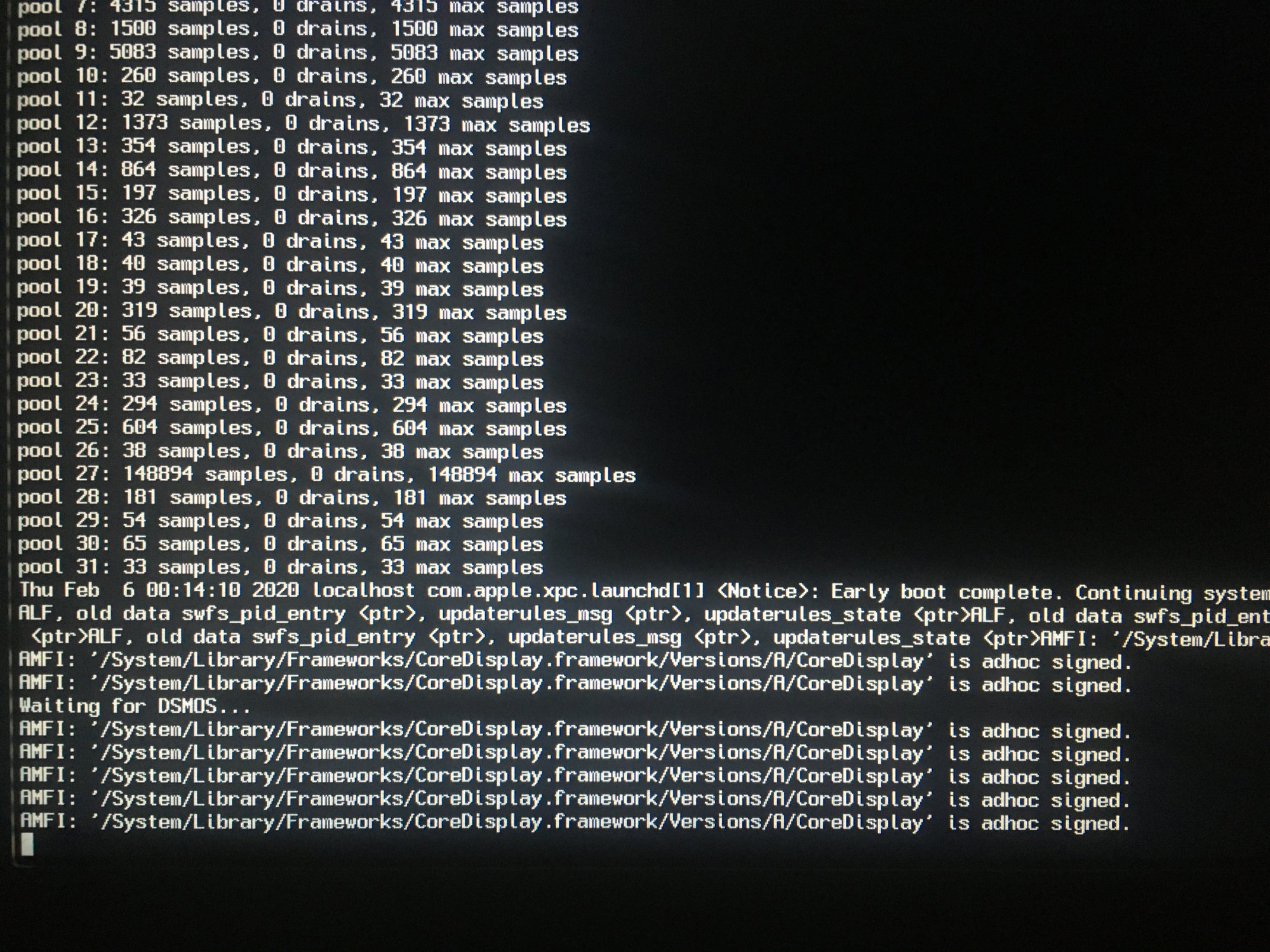

@ASentientBot I've tried your recent wrappers but from verbose mode I get these weird errors:
Code:
AMFI: /System/Library/PrivateFrameworks/SkyLight.framework/Versions/A/SkyLight is ad hoc signed
int_validateCodeDirectoryHashInDaemon(LazyPath *, struct cs_blob *, unsigned int * , int, bool, bool, char *, bool *) no registered daemon port
AMFI code signature validation failed
Got the same lines for SkyLightOriginal, CoreDisplayOriginal and CoreDisplay unix exec
Currently can't get acceleration to work under 10.15.4 due to an AMFI issues, but I have SIP disabled, tried also to update_dyld_shared_cache , but same result.
However with all-in post-patches and re-replacing the 4 non-metal frameworks with their stock Catalina ones allowed me to boot again to GUI Mode with at least framebuffer video.

That is bizarre... I don't experience this on my system at all. Nothing has changed in the way that I build/sign the executables for quite a while. Is anyone else getting this issue too?

Just tried to set: sudo nvram boot-args='-no_compat_check -v amfi_get_out_of_my_way=0x1'
and now I don't get more those AMFI issue, but later WindowServer pid crashes and as you know doesn't allow me to land the loginwindow.
But maybe is only related to my Catalina installation.

Are you able to get a crash report for WindowServer?
You mean from /private/var/log/system.log or with a listener ?
But is something related to security frameworks, probably something mismatched on my Catalina installation, but the weird fact is that using the stock 4 Metal frameworks the system boot up correctly, without accel.
