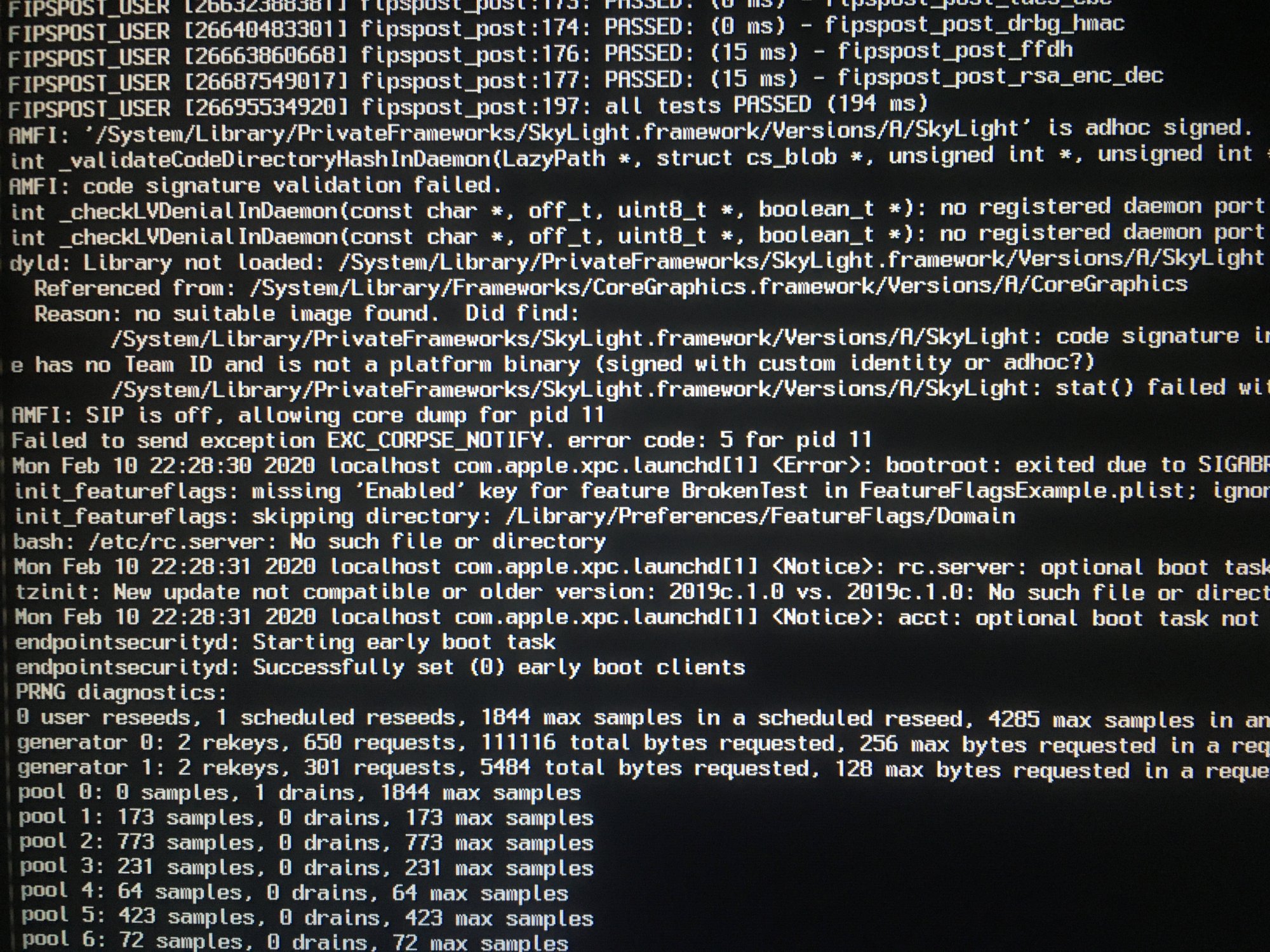

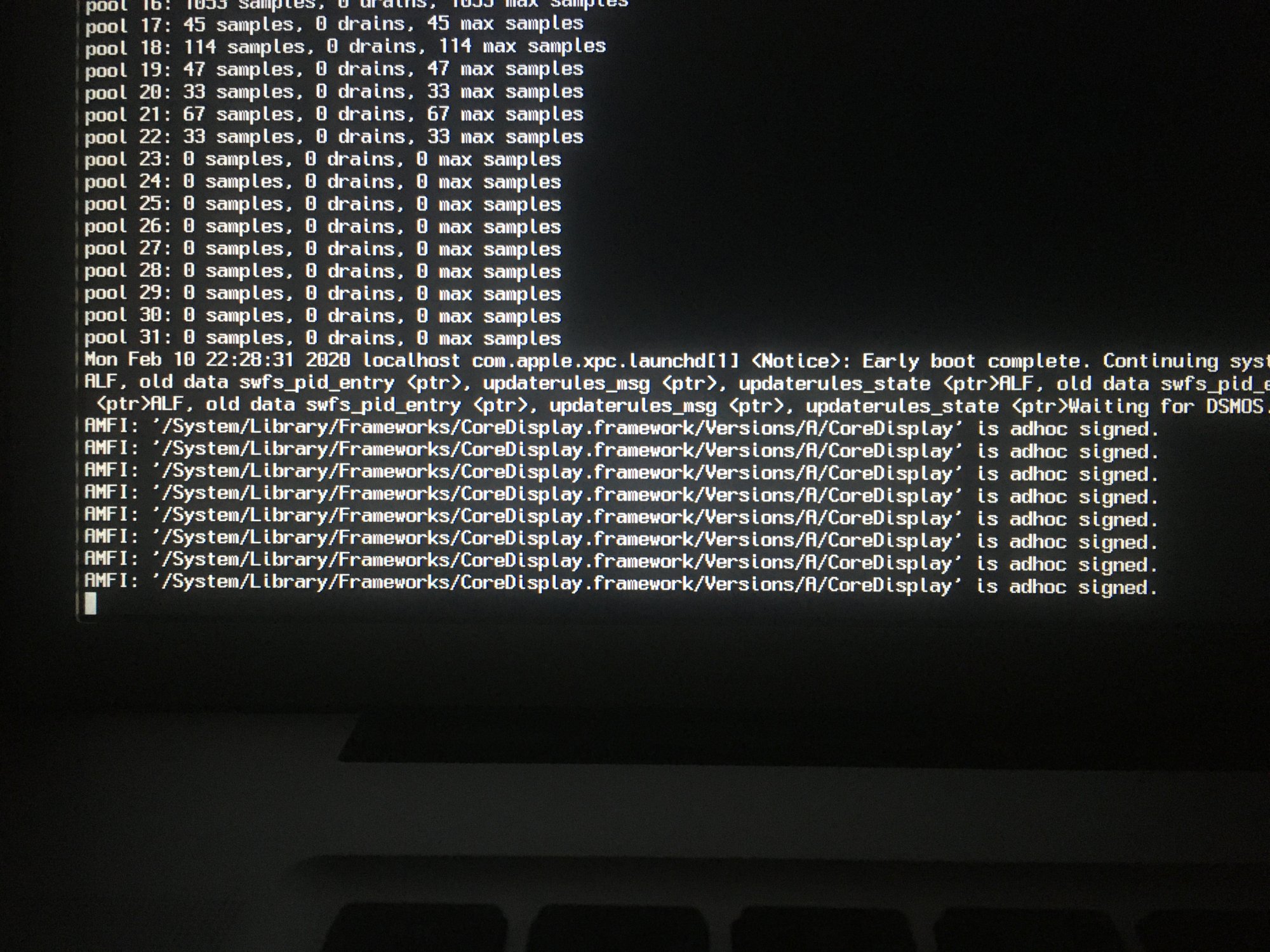

Different behaviour on my Apple MBP5,2: I didn't get beyond the point where booting stalls with ad-hoc-signed messages (post #8226). This happens also when placing the two amfi options in nvram. Didn't use the DisableLibraryValidation.kext.
I then made a fresh attempt (fresh clone of my working SSD with 10.15.3, updating the clone OTA to 10.15.4 DP1).
- before post-install patching with patcher 1.3.0 boot doesn't stall but fails (boot loop)
- after post-install booting stalls as before, both without, or with either or both of the two amfi options in nvram. Didn't put ASentientBot's new CoreDisplay and SkyLight versions in place yet.
-- there is the adhoc-signed message for SkyLight during the Early Boot phase, and the one for CoreDisplay at the begin of System Boot, see attached photos 1+2.
Then another try with the boot-args in Preboot. There isn't a Preboot though on the 10.15.4 DP1 (the externel) disk, but a PreBoot. I then used this PreBoot to put the boot_args, with Xcode, while booted in the internal SSD with 10.15.3:

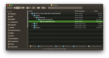

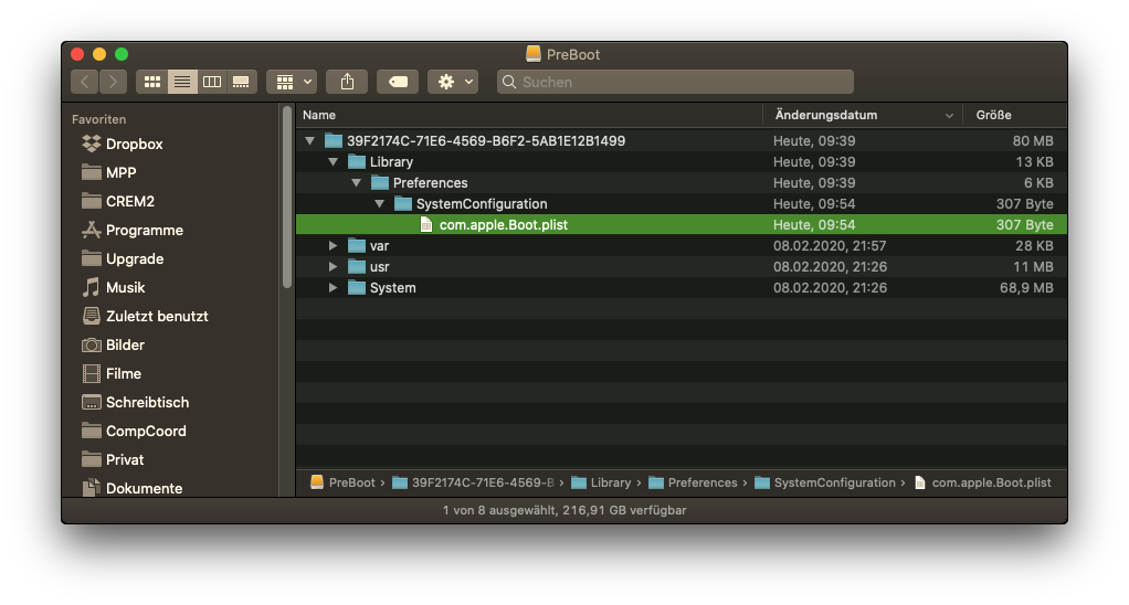

macbook-pro-6-~> sudo -s
Password:
macbook-pro-6-~> diskutil mount disk3s2
macbook-pro-6-~> cd /Volumes/PreBoot/
macbook-pro-6-PreBoot> open .

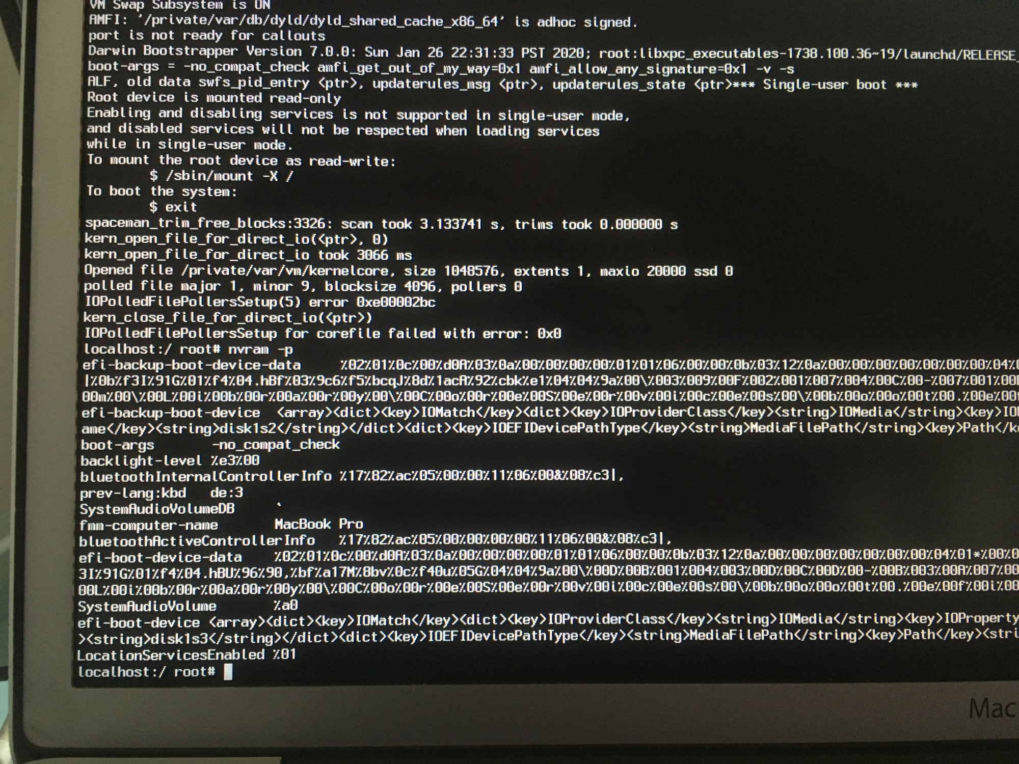

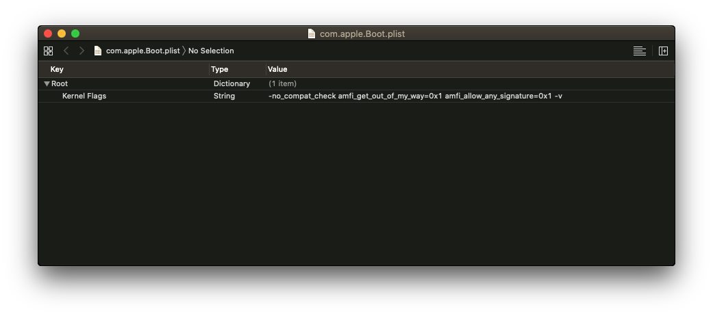

See photos 3 and 4.
- the string of Kernel Flags in com.apple.Boot.plist is empty before editing.
- booted again from the external SSD, but still the same behaviour: stall during boot with same messages.
Still puzzled about this Preboot vs. PreBoot.
Password:
See photos 3 and 4.
Your configuration is right, but from 10.15.4 beta1 there is a kind of stage4 (OTA post-scripts), that is after the Catalina logo OTA installing, you should not apply post-patches and let the apple logo loading bar to complete with "Remaining time", only then after the first bootloop you should re-apply post-install patches, with the addition to use these output wrappers: if you done this way, then try to boot from 10.15.4 single user mode and type:
Code:
mount -uw /
chown -R 0:0 /System/Library/Frameworks/CoreDisplay.framework/
chmod -R 755 /System/Library/Frameworks/CoreDisplay.framework/
chown -R 0:0 /System/Library/PrivateFrameworks/SkyLight.framework/
chmod -R 755 /System/Library/PrivateFrameworks/SkyLight.framework/
reboot
Code:
mount -uw /
reboot

One more observation, when booting from the 10.15.4 DP1 disk in single user mode, the intended boot-args are displayed as I entered them into PreBoot (towards top of attached photo), but nvram -p then only shows the -no_compat_check.
EDIT: not sure if I had overwritten the boot-args in nvram directly before that with "blabla".
From 10.15.4 beta single user mode when you type "nvram -p" it should output on the boot-args line not only "-no_compat_check" but all those "amfi strings" too.
But you can set them also in this other simpler way, after the post-install patches, reload a Catalina usb installer recovery environment, open a recovery terminal and type (I know it's a long string):
Code:
nvram boot-args="-no_compat_check amfi_get_out_of_my_way=0x1 amfi_allow_any_signature=0x1 cs_enforcement_disable=0x1"
I haven't written to set the nvram boot-args from another OSX (installed on target machine) or directly from single user mode because (at least in my case) sometimes they don't take effect, instead from a recovery environment (that is the place also where to disable SIP) they always work.
