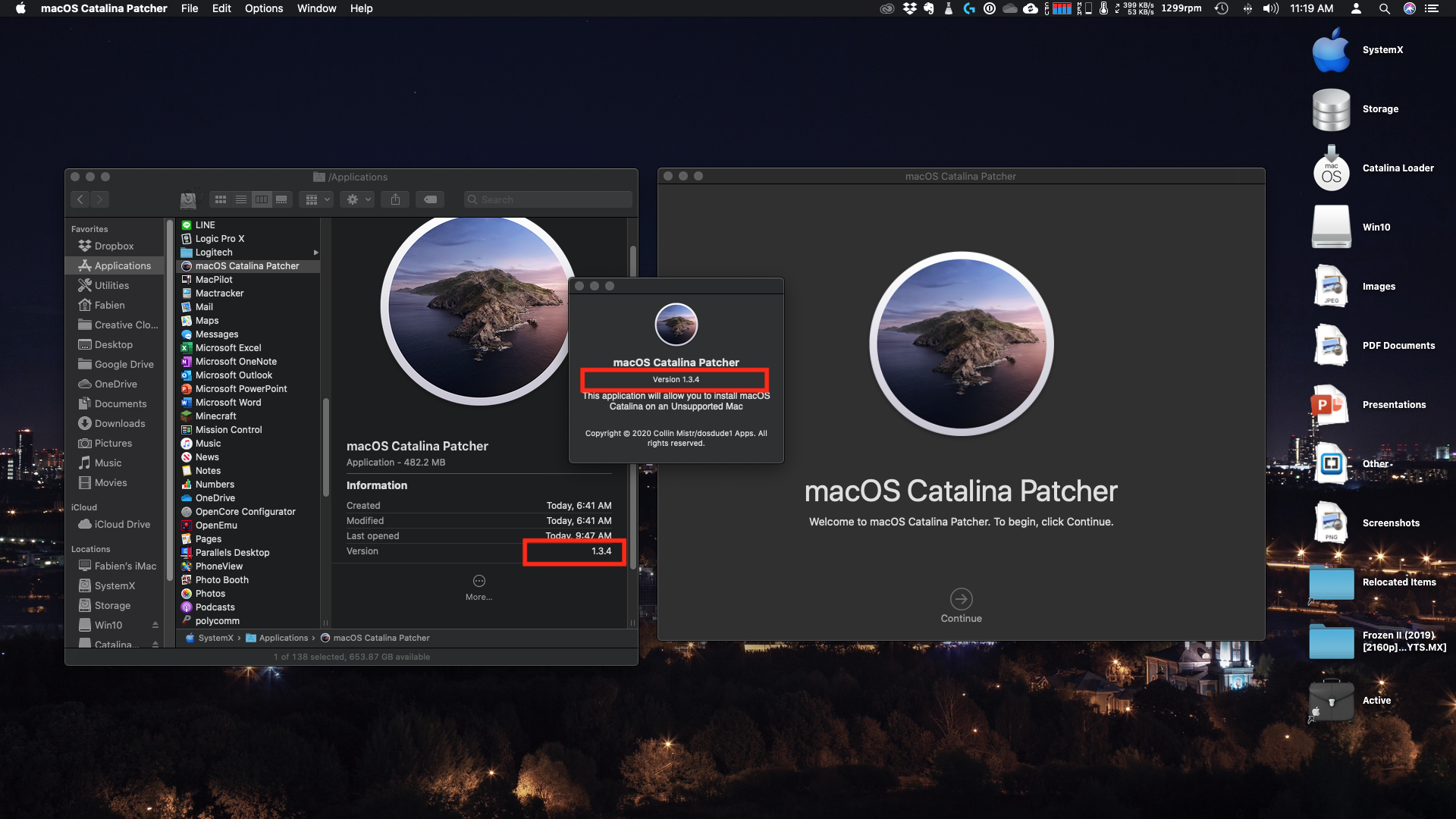

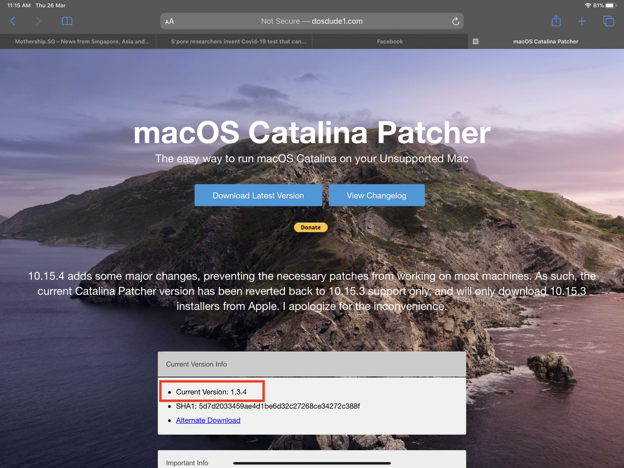

Am I missing something? When I go to the website and download the tool, I get 1.3.0. Where can I get 1.3.4? I want to upgrade to 10.15.3 from 10.15.2.
I guess so.
See the screenshots attached.
I just used 1.3.4 to get from 10.15.2 to 10.15.3

From the website you will get 1.3.4

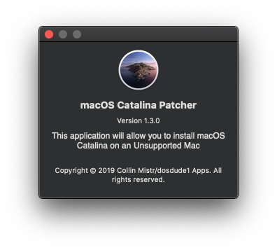

You are not listening. I want to attempt another 10.15.4 and I need the 1.3.1 installer because my issues was different. i don't need the legacy video patch as I use a modded Quadro card which support Metal.

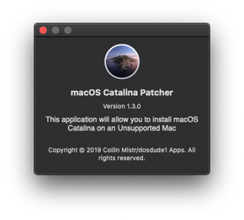

This should be 1.3.1. I downloaded it Tuesday.
Thank you!!!
But unfortunately it's the 1.3.0 =D haha
Cheers,

You did not read what I wrote he doesn’t have it uploaded in the archives as I checked as 1.3.2 and 1.3.3 are not there either
That's right. 1.3.1, 1.3.2 and 1.3.3 still have the AMFI issue that's why he pulled these releases.
Everyone of his patchers have the legacy video patches all you have to do is uncheck macOS 10.15.3 is the one that doesn't have the AMFI issues thus patcher 1.3.0 supports that version of Catalina
