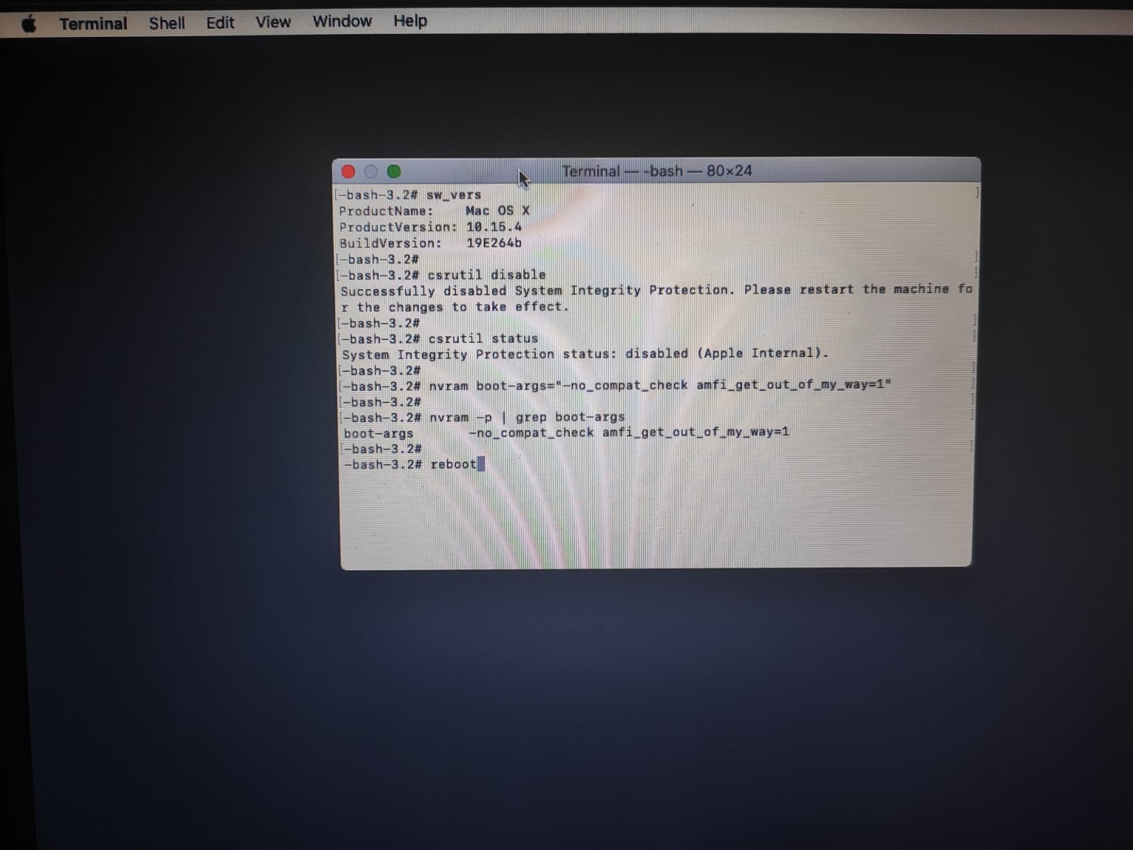

I attach a picture of how I disabled amfi in nvram (since .4beta1 it worked for me), but machine is a MacBook7,1 that is a supported HighSierra with EFI APFS firmware, I repeat, probably the "El Capitan" machines don't have the "amfi flags" because maybe apple added those variables on later EFI firmware update.
Anyway, retry these steps:
From another macOS (or from a terminal) on the same machine, download and use this ASentientBot com.apple.security.libraryvalidation.plist.zip
and copy it inside your 10.15.4 path /Volumes/YourCatalinaLabel Data/Library/Preferences/
You have to mount the "Catalina Data" volume from diskutil to view this path /Library/Preferences/
In addition to this try again these example steps, booting from the USB Catalina Patcher or a macOS Recovery (even an El Capitan or HighSierra recovery should work), commands and results in the picture attached.
Thanks. The attached screenshot was very clear. Will advise of results.

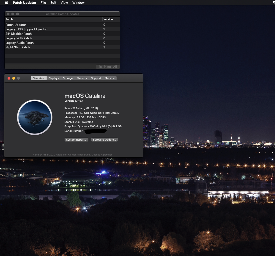

@vjani understood what I was asking and sent the 1.3.1 he downloaded.
The update is done to 10.15.4. No issues at all. It didn't work originally because I was attempting the update from the 1.3.0 patcher (I thought the Patch Updater will also update the macOS catalina patcher app) which can't patch the 10.15.4 installer properly (the installer will not work - USB and install over existing OS won't go beyond 5% boot loading bar). I have a metal card in my 2011 iMac so the legacy video patch is disable for me by default thus I am not running into all the issues reported by the users on legacy cards.

- verified that the .libraryvalidation.plist is in place on the clean-installed dsik and on the over-installed.
- reset the nvram
- the clean-installed doesn't boot, with the AMFI messages shown in single user mode.
- csrutil status in single user mode shows SIP disabled, but there is no csr-related entry in nvram
- the over-installed disk boots nevertheless...
Then in terminal of the bootable USB installer. Also here csrutil status shows SIP disabled. Still did csrutil disable. Now there is this entry in nvram: csr-active-config w%00%00%00.
Now booting works again with both disks (clean-installed and over-installed).
