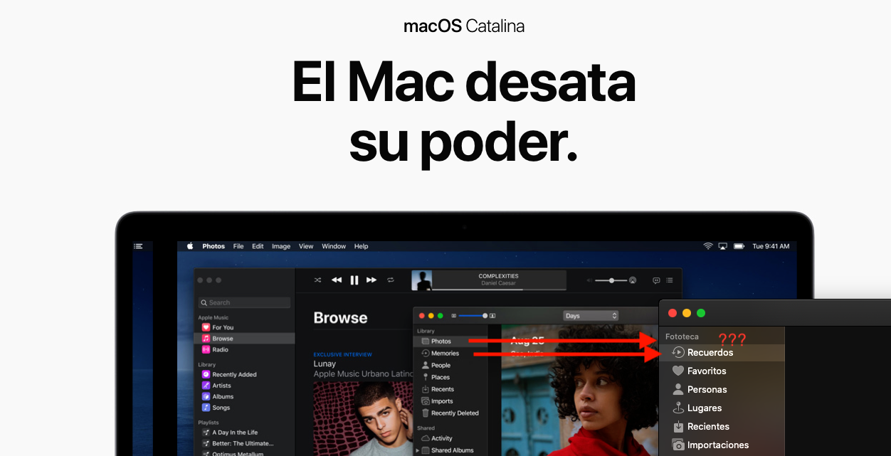

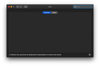

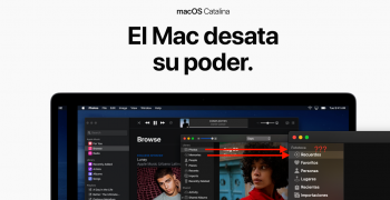

Hi, I've a iMac 27" Late 2009 and I installed 15.3 three weeks ago. two days ago I update to 15.4 (with 1.3.4) and I install post patches Night Swift, and I have the same problem with others people here, in Preference doesn't appear, and Display is empty.
Moreover in Photo App don't appear Photos inside de Library, firstly is Memories.
Appearance don't change if you set in Automatic.
Do you recommended apply the patches 1.3.5, right?
Everything else is great.

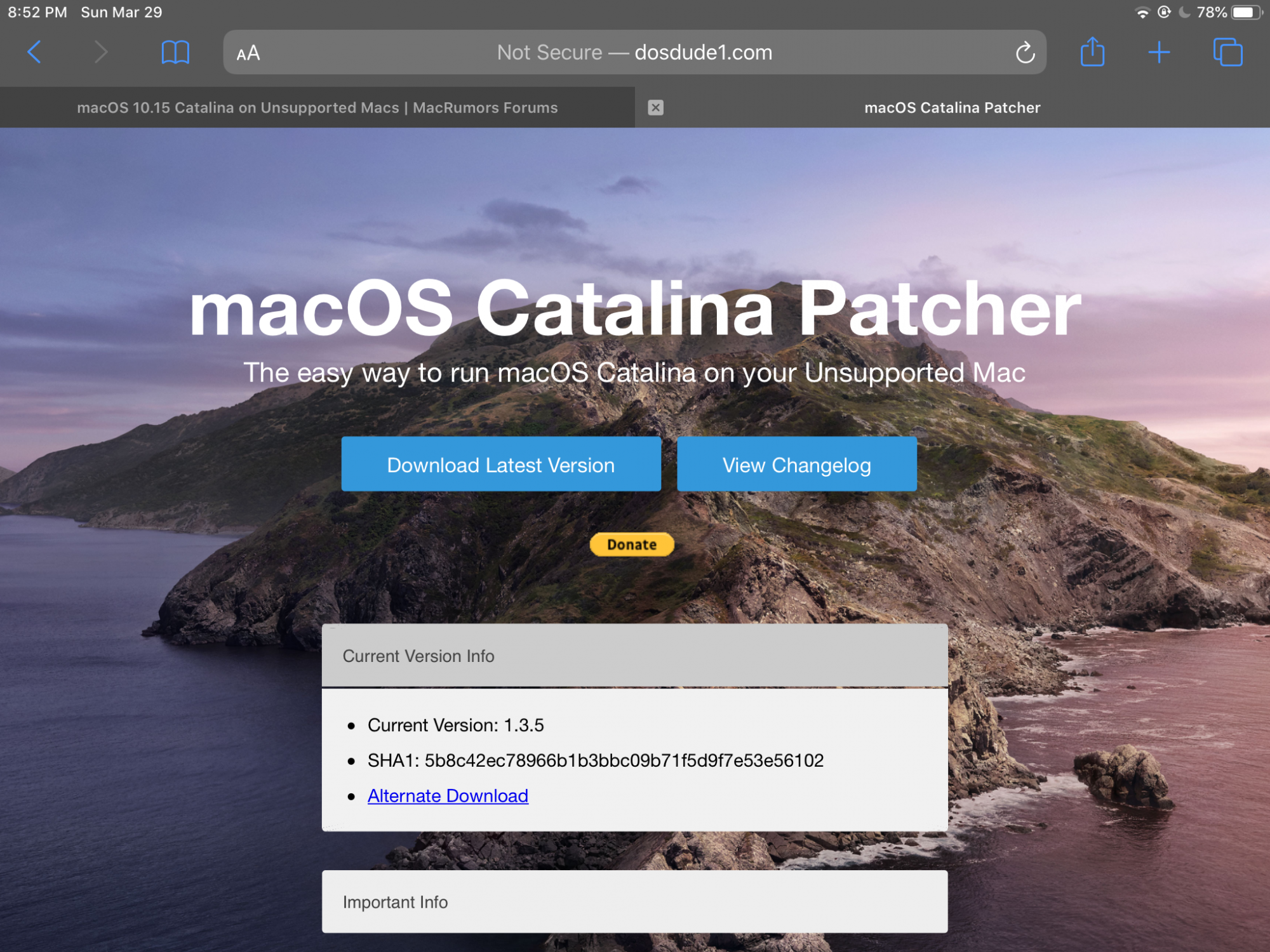

Finally, I have gotten all 10.15.4 issues FIXED in Catalina Patcher, mainly thanks to @ASentientBot's patched boot.efi file keeping SIP disabled! Catalina Patcher version 1.3.5 has now been released with full 10.15.4 support.
Success with patcher 1.3.5 on MBP5,2 17" mid 2009.
Although I already had 10.15.4 installed with 1.3.1 and running:
- made bootable USB installer with 10.15.4/1.3.5
- reset nvram (for clean test conditions)
- clean install on erased external disk. Install and boot went fully automatic
- installed over a clone of 10.15.3 on external SSD. No libraryvalidation.plist present, no amfi settings in nvram or elsewhere. Also here install and boot went fully automatic.
Verified that /Library/Preferences/com.apple.security.libraryvalidation.plist is installed on both disks.
All set to make 10.15.4 my standard system on the internal SSD.
Thank you very much! Time for a DONATION

yes but there is still a problem on the homepage of dosdude1, why are the new versions 1.3.4 etc.
and 1.3.5 not shown at the bottom, version 1.3.0 is over. Only with a detour above
at "Current version info" can you get to 1.3.5 via "alternative download".
I use Google Chrome latest (last version) build version 80.0.3987.149 (official build) (64-bit).
Reactions: TimothyR734
So are you saying that if you click the “Download Latest Version“ button, you can’t get v1.3.5 ?
