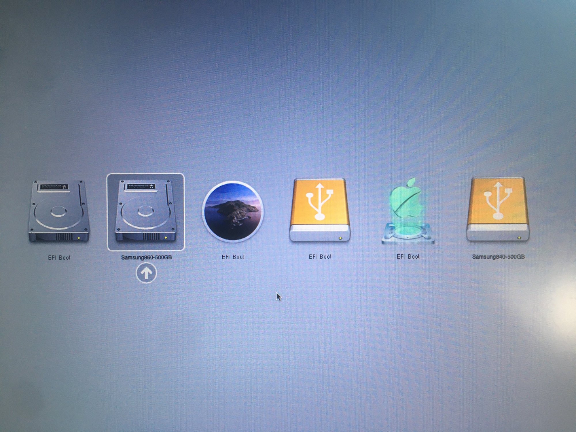

@hvds I fixed that minor issue, now the app should automatically assign an "EFIext" label temporary mount point when using any external USB device.
Download here: USBOpenCoreAPFSloader2.app.zip
edit: this is also updated on my previous post.
Thank you jackluke for this change.
I confirm it works well now also for my setup. The app is now independent of previous EFI mounts.
The boot selector shows the internal and external SSDs with their EFIs (from APFS ROM patch I guess), and the USB stick's bootable installer with its OpenCore EFI.
