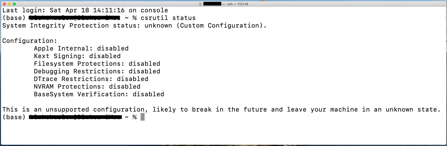

Hey all, I'm new to this--thanks so much dosdude for the patcher and for all the help through this forum!
One question: I installed Catalina with the patched tool as you suggested (iMac 11,2), but now when I check the SIP status, I get:
System Integrity Protection status: unknown (Custom Configuration).
Configuration:
Apple Internal: disabled
Kext Signing: disabled
Filesystem Protections: disabled
Debugging Restrictions: disabled
DTrace Restrictions: disabled
NVRAM Protections: disabled
BaseSystem Verification: disabled
This is an unsupported configuration, likely to break in the future and leave your machine in an unknown state.
This makes me a little nervous; is it normal for SIP to be in an unknown state after this patch and to say that my machine might be left in an "unknown state"? I added a screenshot of my terminal just in case that is helpful.
I have also had similar issues with the recovery mode that others have mentioned, but I am not as concerned about this because I have been able to access recovery mode by first going into single user mode (command + R + S) and then using the following commands:
sudo nvram "recovery-boot-mode=unused"
sudo reboot
Even from recovery mode access in this way, however, I cannot enable SIP. When I try, it just tells me that I need to do that in recovery mode (apparently it does not recognize that I am in recovery mode?!?). Anyway, this is not as concerning to me as the SIP issue, but maybe it is helpful for others trying to get into recovery mode.
Thanks for any insight regarding the issue I am having with SIP!
Configuration:
sudo reboot
That is normal to see when SIP is disabled!!!! What macOS Catalina Patcher version did you use as 1,4,3 fixed the recovery
