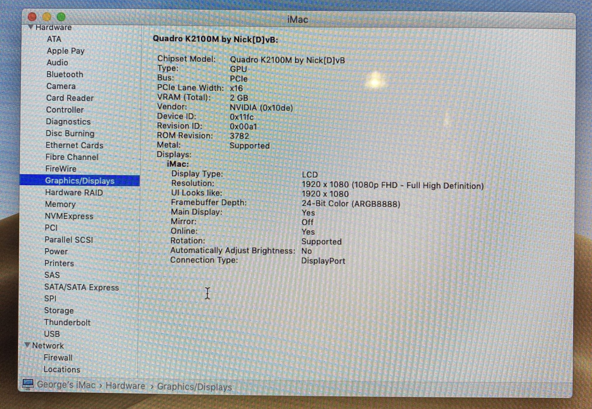

I have a iMac mid 2011 21.5 inch that I upgraded the GPU to a NVIDIA K2100k. I have a i7 2600s 2.8 and 20Gb mem.
I used @dosdude1 patcher to install Catalina. Part of the way through the install (towards the end of the first phase) the screen went blank. The screen stayed blank through the rest of the install.
The voice-over aid began speaking so I know it fully installed, but the screen was still blank.
I ran the post install patches and restarted, still a blank screen.
What am I doing wrong - what should I do differently?

Do you have a metal GPU after upgrade to Nvidia. Check page 1 of this thread to see if your display card is compatible for Catalina

Oh great you have flashed Nick's bios to your metal card as I see in the image. In that case normal on start up you get a black screen and then the apple window white screen with progress bar to take you to Catalina. When you used Dosdudes patch 1.4.3 the legacy video patch should be unticked and also ensure you have SIP disabled.
Oh great you have flashed Nick's bios to your metal card as I see in the image. In that case normal on start up you get a black screen and then the apple window whit screen with progress bar to take you to Catalina. When you used Dosdudes patch 1.4.3 the legacy video patch should be unticked and also insure you have SIP disabled.
I’ll give it another try. I did untick the legacy video patch. I didn’t do anything with SIP.
I am not sure if your display card is compatible K2000m. Check this forum for Catalina compatibility for your card may fetch you some answers
The K2000M flashed with a proper vBIOS is perfectly compatible with Catalina. Writing this in an iMac 2011 having installed an Nvidia GTX 780m card running Catalina 10.15.3. Even with some DELL vBIOS versions the card would work, although without some features...

Probably you can "heal" this issue by using the OpenCore image provided by @Nick [D]vB to be used with this card for brightness control. Currently some people are complaining about this problem, @Mark Meretz got around it using OpenCore (without having a GPU needing this) and I do not have it at all because all my machines have metal cards with a vBIOS by @Nick [D]vB and OpenCore.
Currently this is the only (common) indicator I see. This is a guess...

I was able to finally get into the Catalina install. I disabled the SIP. I still get a black screen. But if I press down the option key and select the drive to run Catalina, it boots visibly and I get in with the system visible on the screen. The system is very usable.
How do I use OpenCore to instal Cayalina?
I ask myself how did you get the K2100M into your machine with our reading this thread and more importantly the first post and the guides in there? Search for the OpenCore announcement. BTW, does your machine has sleep issues?
