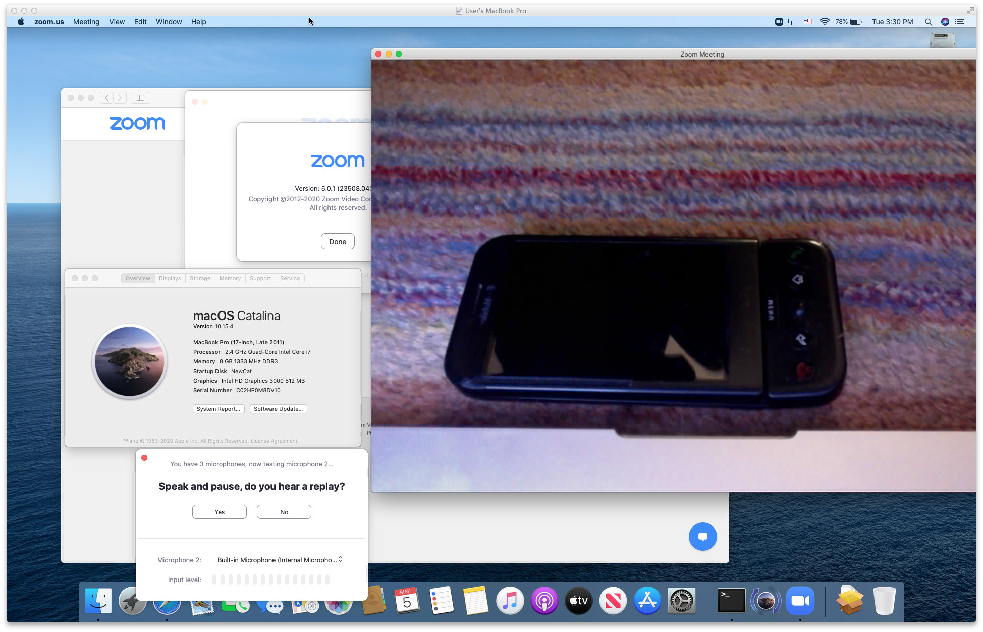

Well I tried replacing from version zoom 4.5.9 zMacRes.bundle, zVideoApp.bundle and zVideoUI.bundles with the one in zoom 5.0 wouldn't detect my iSight cam
Yes!! Successfully patched the latest Zoom version to work under Mojave or Catalina with a non-Metal GPU!
EDIT: To apply this patch to your own Zoom install, download the attached script (zoomnonmetal.sh.zip), extract it, and run it as follows using Terminal:
Code:
chmod +x /path/to/zoomnonmetal.sh
  • zoomnonmetal.sh.zip
Great news! Another legend move!
Would you share the Step-By-Step and related files/patches to pull this off?
Just finished making a script to apply the patch, updated my initial post to include it.
I can confirm that this has worked with Zoom Version: 5.0.1 (23508.0430) on my iMac11,1 under catalina
Code:
Dear Collin,
Thank you for your untiring efforts keeping us going on older hardware.
I got the following errors after upgrading Zoom to latest, closing Zoom, and updating Xcode to latest version known to work with Mojave - which I am running.
/Applications/zoom.us.app/Contents/Frameworks/ZCommonUI.framework/Versions/A/ZCommonUI: replacing existing signature
dyld: Symbol not found: _OBJC_IVAR_$_NSTextViewIvars.sharedData
Referenced from: /Applications/Xcode.app/Contents/SharedFrameworks/DVTDocumentation.framework/Versions/A/../../../../SharedFrameworks/DVTKit.framework/Versions/A/DVTKit
Expected in: /System/Library/Frameworks/AppKit.framework/Versions/C/AppKit
in /Applications/Xcode.app/Contents/SharedFrameworks/DVTDocumentation.framework/Versions/A/../../../../SharedFrameworks/DVTKit.framework/Versions/A/DVTKit
codesign_allocate: error: unable to locate xcodebuild, please make sure the path to the Xcode folder is set correctly!
codesign_allocate: error: You can set the path to the Xcode folder using /usr/bin/xcode-select -switch
/Applications/zoom.us.app/Contents/Frameworks/ZCommonUI.framework/Versions/A/ZCommonUI: the codesign_allocate helper tool cannot be found or used
Patched "/Applications/zoom.us.app".
Apologies for my ignorance, here.
Re-install Xcode command line tools (xcode-select --install), then it should work.
Thank you Collin for your timely help.
I had another old Mac to update without any Xcode installation.
I ran this line first - before seeing your reply - and it worked fine.
So anyone who has NO prior Xcode installation should just do this - no need to install the whole Xcode developer bundle!
UPDATE - On the Mac that produced the error sequence in my post #10,694, I totally removed Xcode - at least to the best of my knowledge - following various probably non-definitive online instructions. The last one I tried - which may have been the best to try first - was as follows (note these are for Mojave):
Select  > About This Mac > Storage > Manage...
On the left hand side select Applications (near or at top of list)
Sort by name and select Xcode.app then select Delete...
Wait while it uninstalls. It may take a few minutes.
Go to Terminal and enter xcode-select --install (This may not be needed.)
Follow dosdude1's instructions in post #10,677.
I finally have a (relatively) secure, up-to-date Zoom app tested and working.
As a HUGE bonus, I found I also got a much faster, more responsive Mac after uninstalling Xcode.app. This iMac 11,1 now runs faster than it has in years - at least since Sierra in 2016.
I am not a developer (pretty obvious from my posts :)), and can't recall for what reason I installed it in the first place. I think it had to do with learning Python and installing Anaconda, which seemed overkill even at the time.
Quite likely, I only ever needed to install the command line tools to make something work that I almost certainly don't now use.
Reactions: TimothyR734
Code:
When I open Terminal and type
chmod +x <then drag the script from my desktop to here
it then looks like this
chmod +x /Users/Gene/Desktop/zoomnonmetal.sh
and I hit return, but nothing happens.
my logged in account name is Gene
What am I doing wrong, please?
