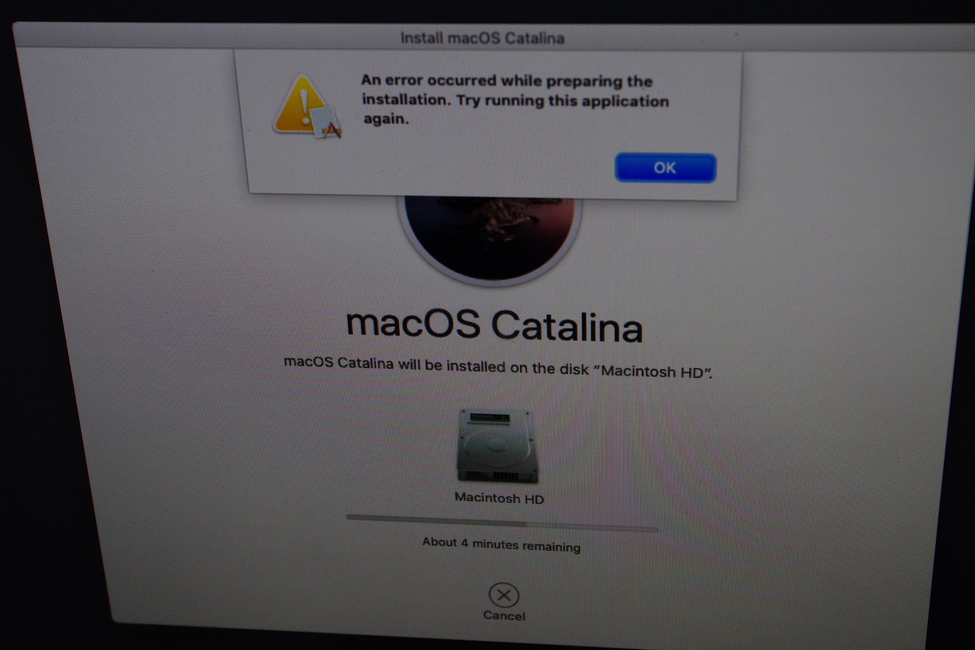

Hello there
Attempting to update an unsupported Mojave to an unsupported Catalina is causing me grief.
The installer fails in the first state (screendump and log attached).
I managed to break the Mojave install so I cant boot my previous installation (this message is written using windows bootcamp).
Is this due to a broken installer or some issue on the existing Mojave installation?
I would like to preserve the files in the existing installation so I havent tried formatting the drive.
Any suggestions?
Cheers, Mikkel

Hello there
Any suggestions?
Cheers, Mikkel
UPDATE: The logfile (.txt) I attached is removed when I complete the post...what to do?
Buy a solid state, try the install again. If all your installers are busted, internet recovery to install high Sierra. Create the installer from there. Install and migrate. No possible loss of data. Hopefully you have and ‘09 or better for internet recovery.
The HD is solid state.
Would it be possible to somehow prepare the Catalina installer from windows so I don't have to install High Sierra just to make the installer?

This is the first time I have been unable to successfully update. I made it to Catalina 1o.15.5, but I can't go any further. I have a mid-2010 iMac 21 inch with ATI Radeon HD 4670 256 MB. Any thoughts?
If you want to update to 10.15.6 Beta 1 If you have a spare usb about 1 gb format it extended-journaled then unzip the USBOppenCoreAPFSloader and run and follow the instructions. Then open your terminal-unzip the swupatch and place it in the terminal-run it then check for the update in System Preferences wait close and reopen your terminal once the update is at least 10percent download-I usually wait until it nearly finished and place the catalinaswufix5amfi.command in the terminal run it. Once the update shows the black screen and progress bar a bit into it it will restart your Mac hold your option button select your USBOpenCoreAPFSloader in the select menu choose macOS install this will install the update then once it restarts boot into your Catalina patcher and apply the post install patches. If for some reason you have issues as the USBOpenCoreAPFS will add "amfi_get_out_of-my-way" into the boot-args run nvram-p to verify in the terminal restart your Mac and do a pram reset command-option-P and R this should move the amfi-get-out-of-my -way
  • USBOpenCoreAPFSloader2.zip
  • swupatch.sh.zip
  • catalinaswufix5amfi.command.zip
