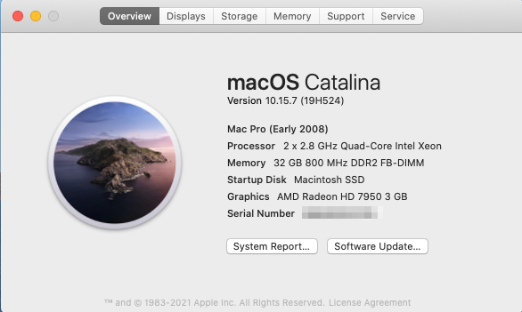

So I updated an old 2008 MacBook to Catalina using dosdude1's patch several months ago. It's on 10.15.6. But I've noticed that under Software Update, it never offers 10.15.7 as an update option, much less the recent supplemental update patches. I can't find anything on his site addressing this, but am I supposed to go download the standalone update file for future point upgrades or is there a setting I'm missing that would allow it to pull them like normal under Software Update?
Yes, you missed the frequently mentioned (sic!) CatalinaOTAswufix.app that you ought to run in order to get all the latest updates, including supplemental and security updates, right now up to build 19H1009 of 10.15.7
It´s a two-step procedure but you will be guided by the fine piece of software.
APFS boot capability should be patched prior to this, at best with dosdude1´s APFS ROM patcher.
Reactions: Ausdauersportler
