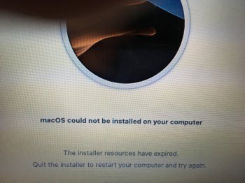

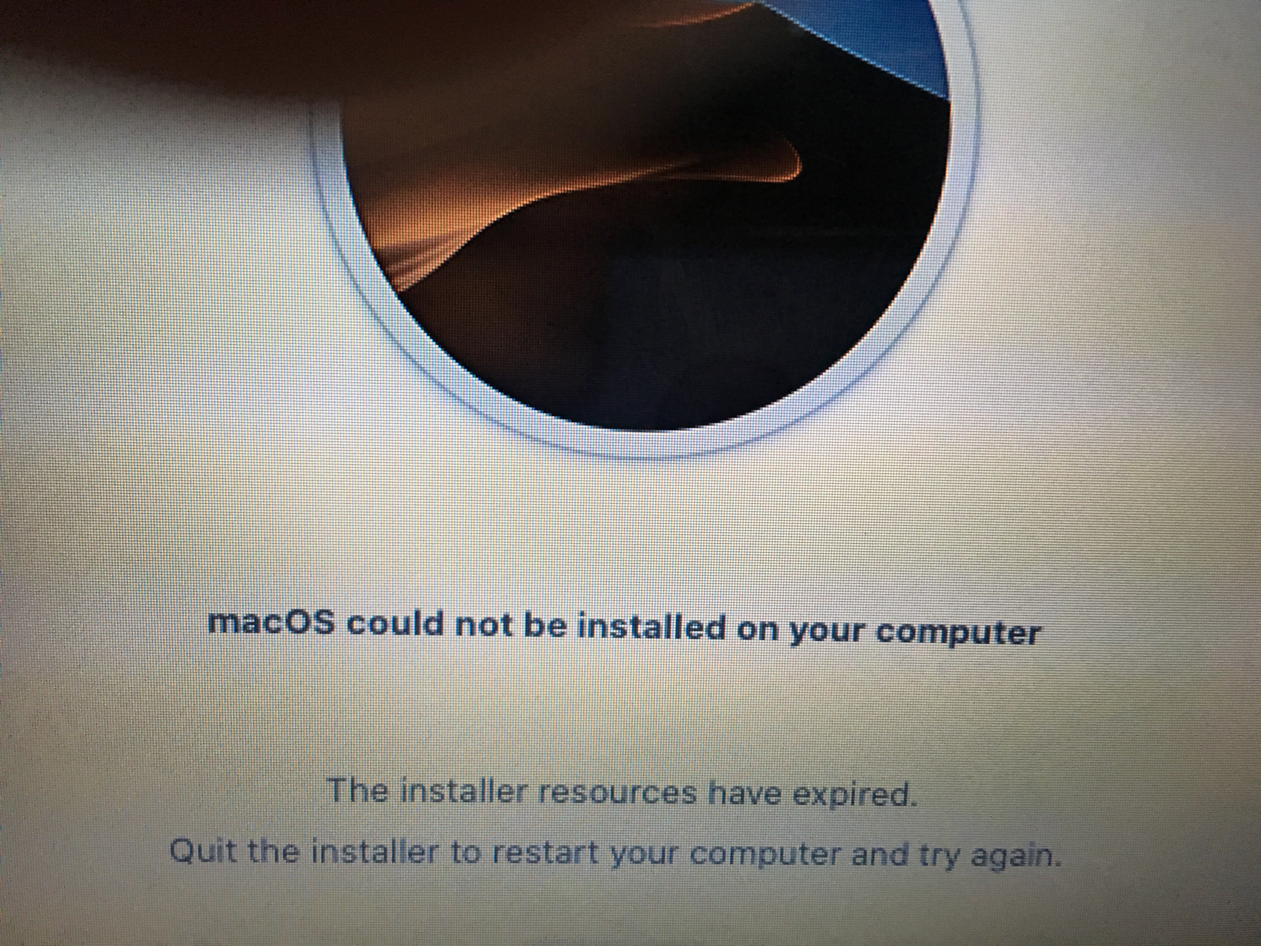

I tried that this is what I got I even pull the Mojave Patcher out before rebooting after applying the selected patches

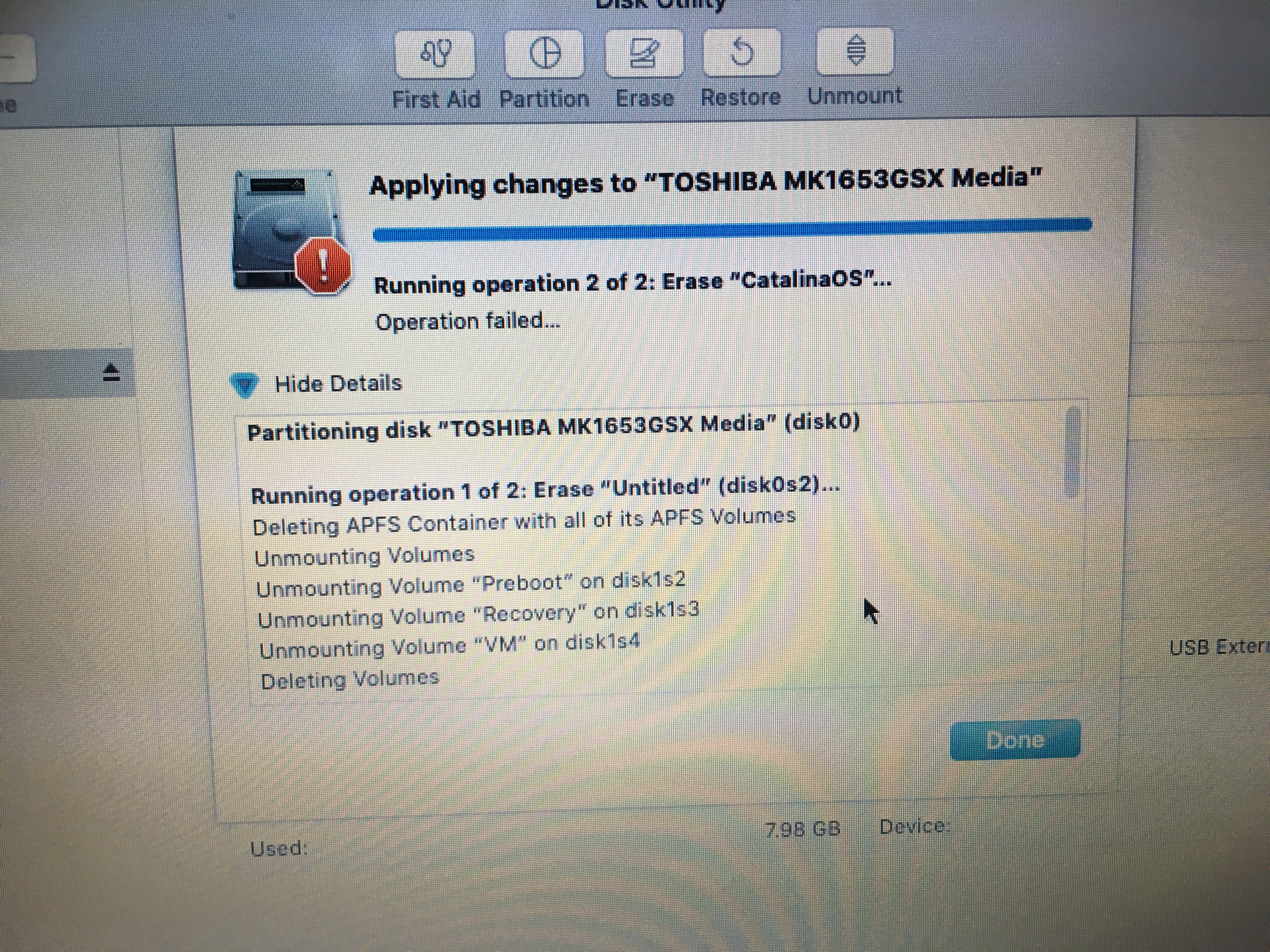

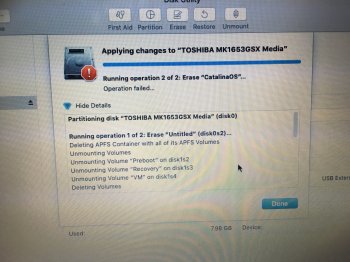

This is the error message I get trying to partition the drive both with b6-b7 partial installers with Cat beta 1
