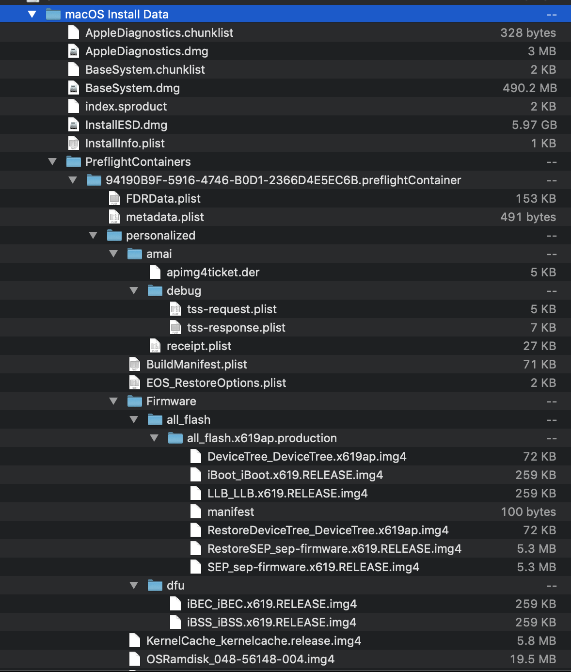

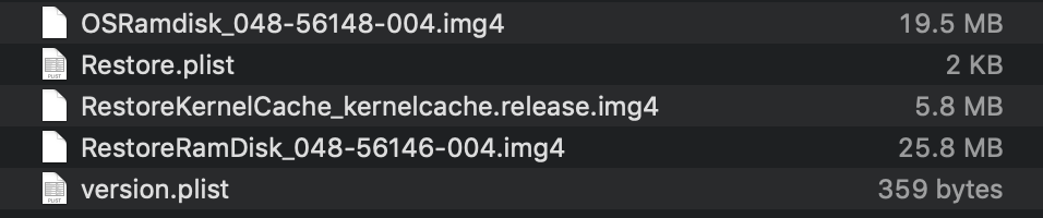

Is anything in this install directory of any use?
