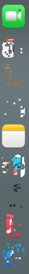

I have the same machine. And if it's like mine it will not work great on Sequoia, the video driver is very buggy, specially when using an external monitor.
Do you see video glitches (artifacts)? Like on these images.
Mine never worked correctly after the 15.4 update. I had to return to Sonoma, it's very fast and stable on Sonoma.
Ouch. That's not great. I've not seen anything like that on mine, but I haven't tried it with an external monitor tbf. Had a bunch of problems getting the initial install done (constant 'error preparing the software updater' in OCLP). But once I got 15.7.4 installed and patched, it's been fine. 🫤 (Unless this 15.7.5 update goes badly).

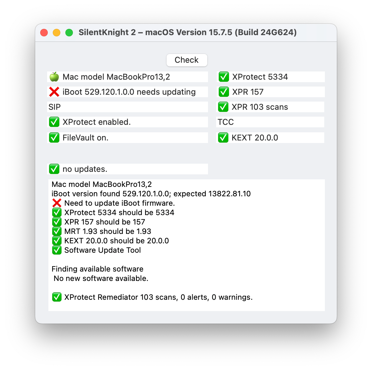

I have an iBoot issue on my MacBook Pro 13.2: since the latest Sequoia 15.7.5 (24G624) update, SilentKnight has been reporting: iBoot 529.120.1.0.0; expected 13822.81.10, need to update iBoot firmware.
However, I even reinstalled macOS Monterey on the MacBook Pro, then reinstalled Sequoia, with no success. Can anyone help me?
SilentKnight doesn't officially support OCLP Macs. Firmware 529.120.1.0.0 is latest firmware for your MBP 13,2 installed w/ Monterey, the latest supported macOS for your model. OCLP unsupported Macs don't receive firmware updates.
