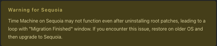

when it worked for me, I only needed to perform TM Restores without OCLP root patches. Backups with OCLP root patches were ok. At some point, TM restores stopped working for me even without OCLP root patches as mentioned here.
Oh, I get the problem with restores from TM--I had that issue trying it in Sequoia, but my original question stands: why should just TM backups be done without root patches?
After OCLP TM backup from MP 5,1 Ventura, I could not restore successfully to either 2017 MB or MP 6,1, both OCLP Sonoma. Root patches were uninstalled for restore on both. Neither would boot successfully. I have been successful multiple times backing up and restoring the 2017 MB using TM. Root patches are uninstalled before manual TM backups and before any restore attempted.
My experience certainly isn’t conclusive, as I did not try every combination of OCLP, macOS, or hardware. My take away - if you want to use TM for backups, which implies you will eventually want to restore/migrate to either an OCLP or non-OCLP Mac in the future, your most likely chance of success is to have backups taken when root patches are uninstalled. But, as with all things OCLP, YMMV.
Reactions: roronl
Again, (as I keep saying) *aside from restores*, what would be the problem with TM backups?
If you want to hyper-focus on just the TM backup process itself, then, yes, TM backups will succeed with OCLP patches installed/applied. However, backups exist for when restore is necessary, do they not? Do you need that restore to be successful when the fateful day comes? If you are planning to use TM backups for a different goal then restore, now would be the time to say, and we can move on.

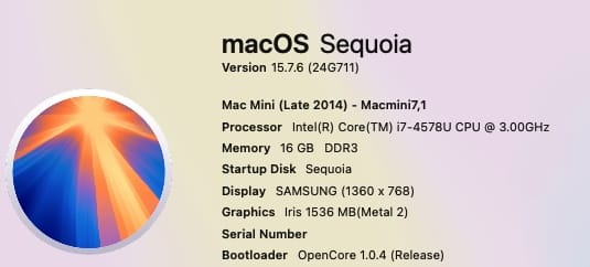

Anyway, the latest one, 24G711, seems to be running OK on the two Macs here, details are in my spoiler. Both Macs are running Safari 26.5 (20624.2.1.19.2)

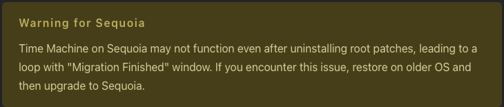

I put Sequoia back on this again just to see if the HDCP issue was fixed. I went to go back to Monterey again and my TM backup would NOT work. What pain. The data was there but Migration Assistant just would NOT start the restore. Picked the TM drive and the backup on it and it just sat there for hours.. overnight.. just sat there. On both TM drives I use. I gave up and just setup the machine manually and copied all the apps and data over manually and had to setup everything manually. I think I only did that once before on my Air. Never had an issue on this MBP. I wonder what happened.
"I wonder what happened?" There have been many posts on the various forums here saying, essentially, that a TM backup didn't work when someone had relied on TM, and only TM. Then there are posts saying it is best to have, or also have, a Carbon Copy Cloner <https://bombich.com/> or similar backup <https://www.maclab.tokyo/document/superduper/16800/>. What actually happened may never be revealed in detail, but is clear that TM doesn't alsways work, and it also seems clear that you didn't have that other, or alternative, backup. At least in this case you were lucky to have avoided a total "No Data" situation, and a manual copy restoration was possible. You could use the free 30 day trial of CCC to make a backup, just in case it ever becomes necessary. Personally, I think CCC is well worth the cost of a license, as it has saved me many such "manual copy hours" over the years. To be clear, I have no connection whatsoever with Bombich Software, the makers of CCC, just a very satisfied customer.
Yeah. I've known about CCC for years. Just didn't think I'd have to start looking at it.
