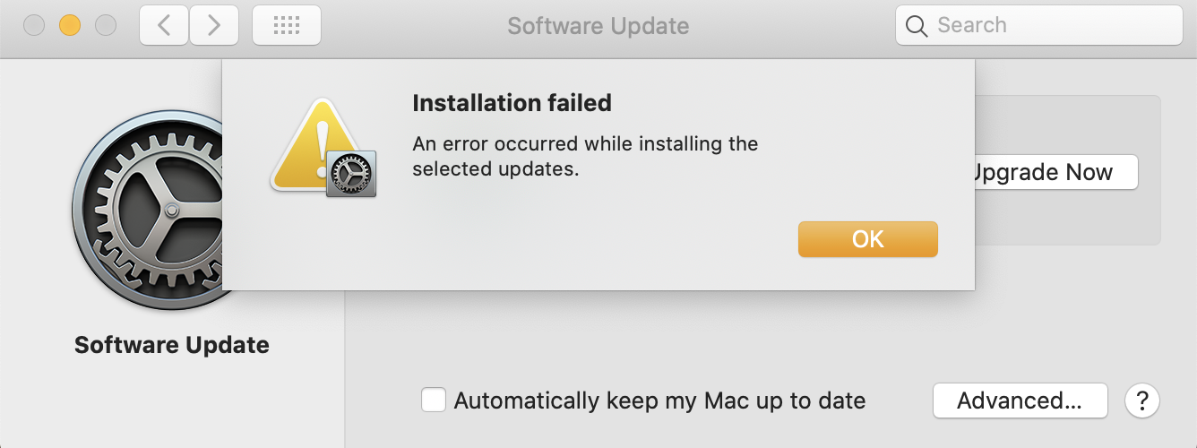

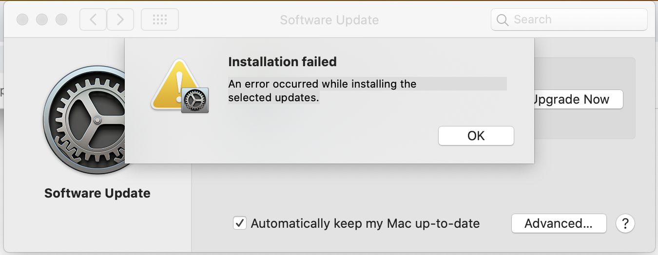

getting error while trying to update to Mac OS

Looked in Console, filter by errors and faults whilst hitting the update now button and it'll be in there.
I get errors like this instead (and no I am not a standard user):
Fatal: interaction not allowed (kAuthorizationFlagInteractionAllowed not set) (engine 1137)
Sandbox denied authorizing right 'system.install.app-store-software.standard-user' by client '/System/Library/CoreServices/Software Update.app/Contents/Resources/softwareupdated' [662] (engine 1139)

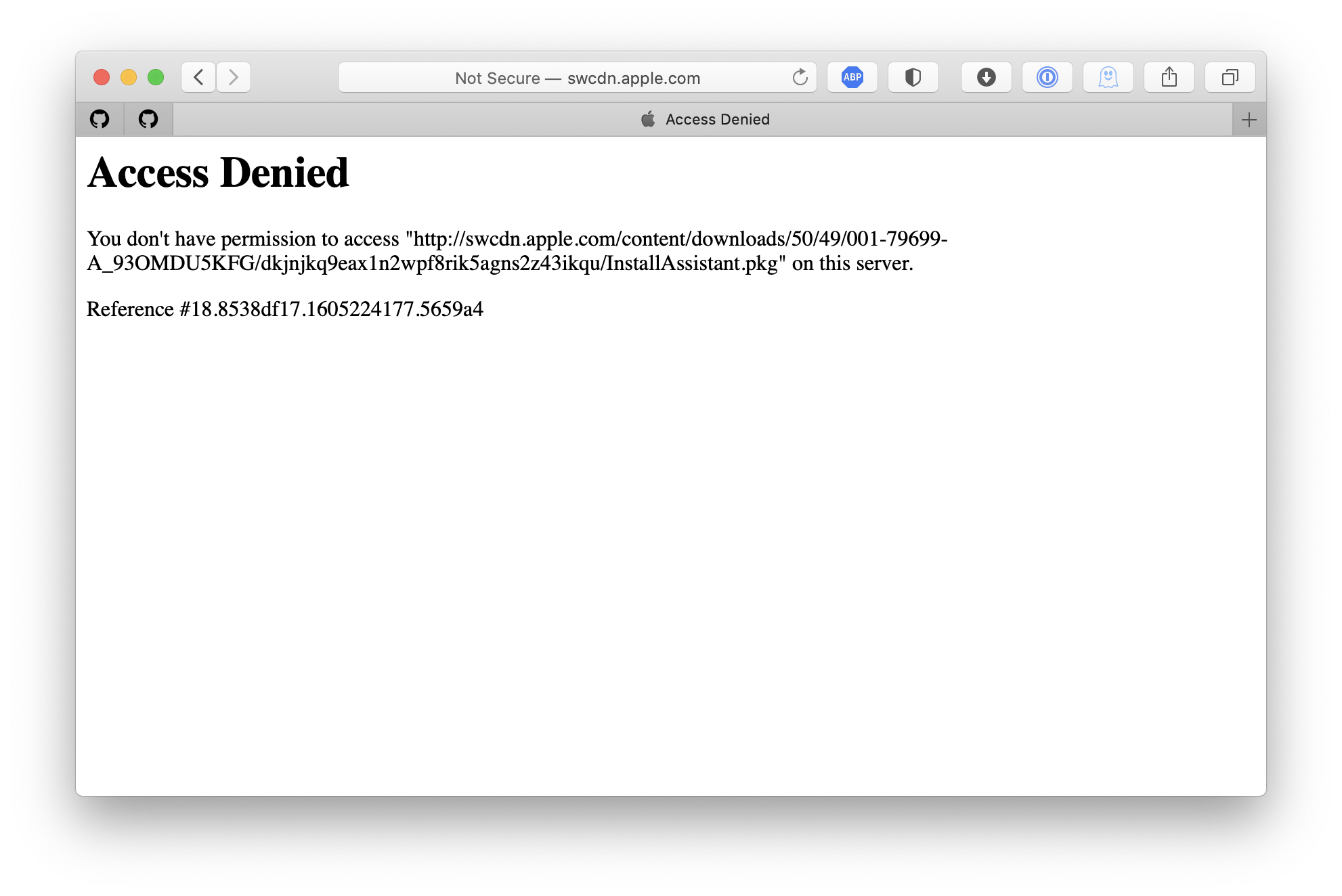

Out of curiosity, some members mentioned that the issue what due to an issue with Akamai : how did they figure this out ? Can't find this in my logs.
Run Console, select 'Log Reports' and open install.log & scroll down to the most recent entries. You'll see things like:
2020-11-12 23:25:17+00 Colins-iMac com.apple.preferences.softwareupdate.remoteservice[1187]: SUOSUShimController: Install finished with error: Error Domain=PKDownloadError Code=8 "(null)" UserInfo={NSUnderlyingError=0x600002954de0 {Error Domain=NSURLErrorDomain Code=-1102 "(null)" UserInfo={NSErrorFailingURLStringKey=http://swcdn.apple.com/content/down...x1n2wpf8rik5agns2z43ikqu/InstallAssistant.pkg, PKURLTransportErrorStatusCodeKey=403, PKURLTransportErrorResponseHeadersKey={
Connection = "keep-alive";
"Content-Length" = 406;
"Content-Type" = "text/html";
Date = "Thu, 12 Nov 2020 23:25:17 GMT";
Expires = "Thu, 12 Nov 2020 23:25:17 GMT";
"Mime-Version" = "1.0";
Server = AkamaiGHost;
"X-Cache" = "TCP_DENIED from a62-253-3-166.deploy.akamaitechnologies.com (AkamaiGHost/10.2.0.2-31441410) (-)";
To my untutored eye its not clear if a62-253-3-166.deploy.akamaitechnologies.com is the problem - or swcdn.apple.com
Reactions: StrongArmmed
I am a little sceptic about this observation. I have never seen Apple using Akamai for software updates. Apple definitely uses their own IPv4 address space (17.0.0.0/8) for software updates and I am not aware that Akamai offers BYOIP.
Well, unless I'm reading it wrong you can see it pull from Akamai CDN in the logs, at least in some capacity...
"TCP_DENIED from a62-252-168-238.deploy.akamaitechnologies.com (AkamaiGHost/10.2.0.2-31441410) (-)";
