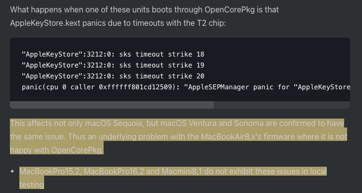

Thing that worries me most is the fact that the MacBook airs with t2 were not able to be patched in the end, and the chip is the same for the pro models. If I am not mistaken Tahoe is the first macos that dropped the t2 macs except the air. Older macs without the t2 seem fine using the current oclp patcher for Tahoe.

I'm surpised that someone with a real MacMini8,1 hasn't tried to create an OpenCore EFI that injects the 'Skip Board ID' Booter Patch.
EDIT: If you don't want to use Open Core, you should be able to add -no_compat_check boot-arg to NVRAM instead of the Booter Patch.
If it was that simple, don't you think that there would already be reports of Tahoe working on MacMini's 2018? Genuinely asking...
So simple that someone could have already tested and posted results.
The operative word in my previous post is 'tried.' I'm just saying I'd like to hear test results from someone who knows enough to test.
EDIT: I couldn't find the earlier post, but someone said the MacMini8,1 boots Open Core which would be necessary if USB mapping is required. Again, I'd just like to see someone's test results.
EDIT2: This suggests that MBP15,2, MBP16,2 and MM8,1 do not exhibit the T2 issue with Open Core
  • MacBookPro15,2, MacBookPro16,2 and Macmini8,1 do not exhibit these issues in local testing
