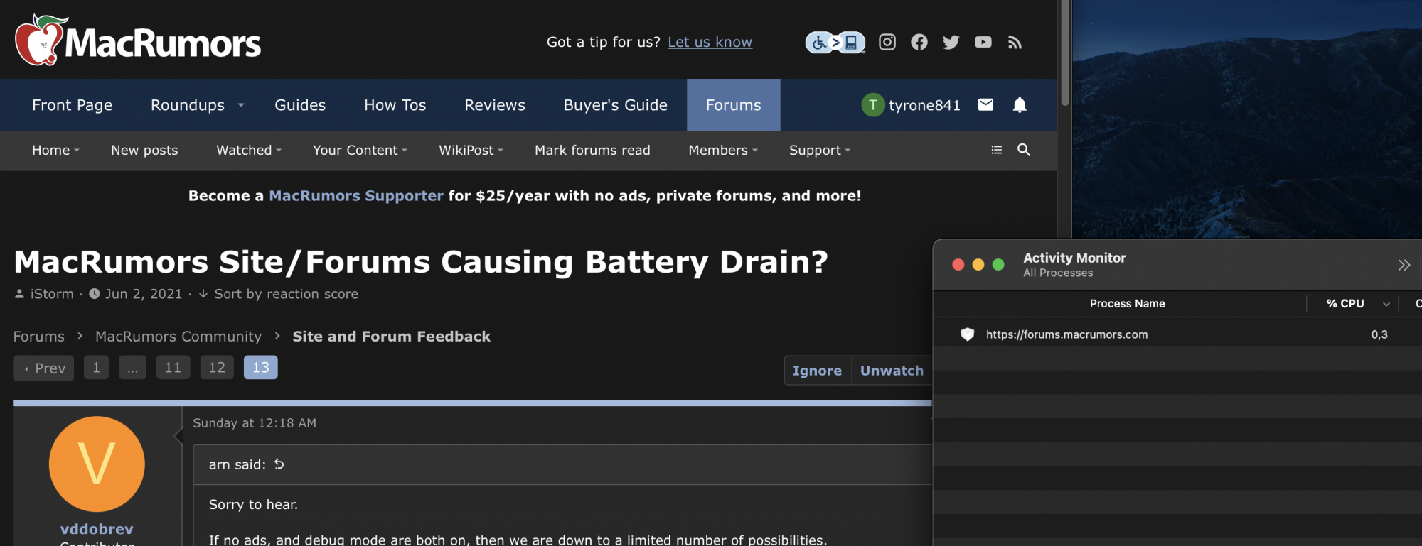

Unfortunately happened again to me after a few days working well.
I tried with and without debug and no changes whatsoever. The iPhone
was uncomfortable to hold.
CPU usage never went to high, strangely enough.

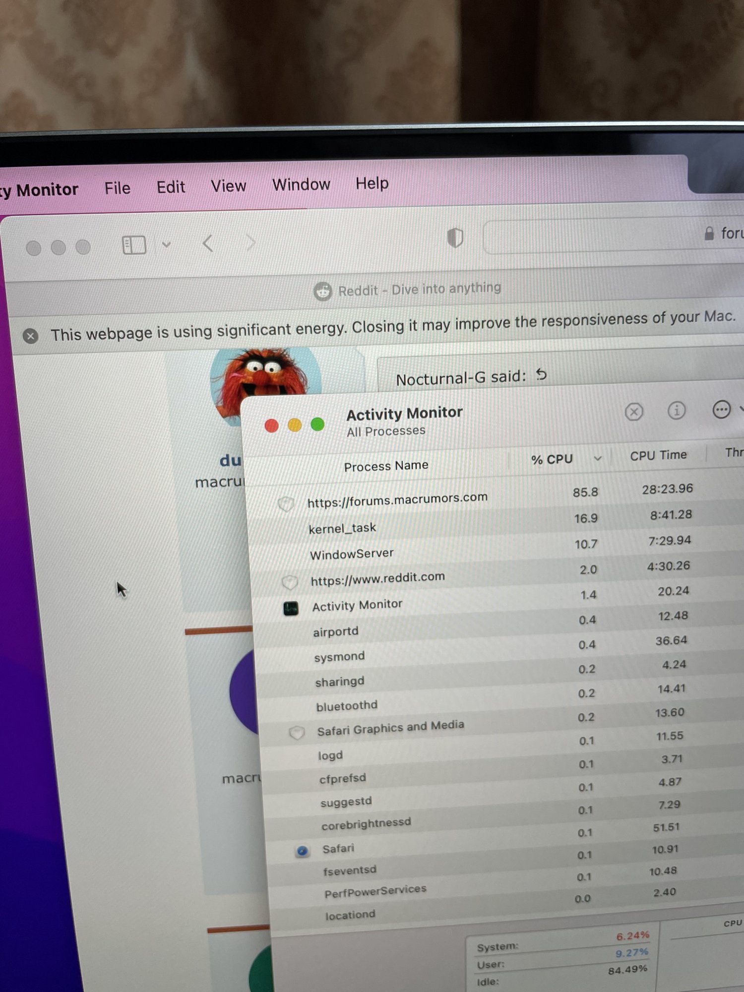

Can you post a screenshot of 100% cpu time?

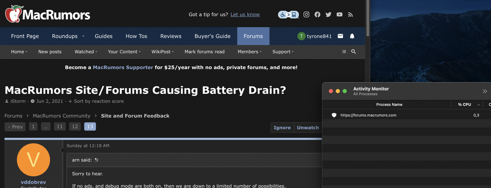

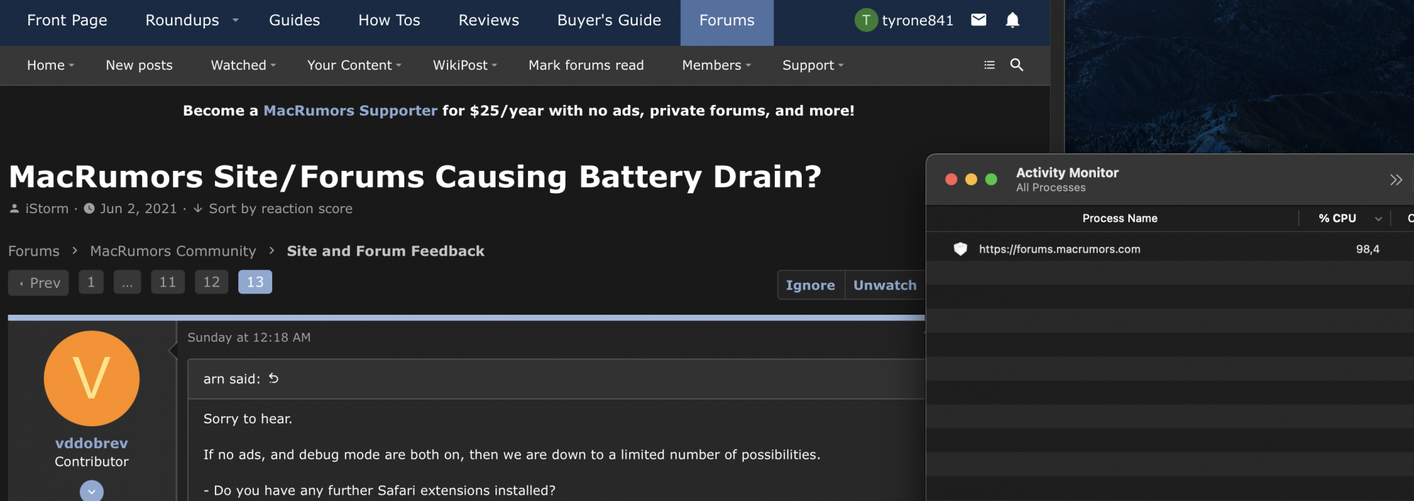

@arn

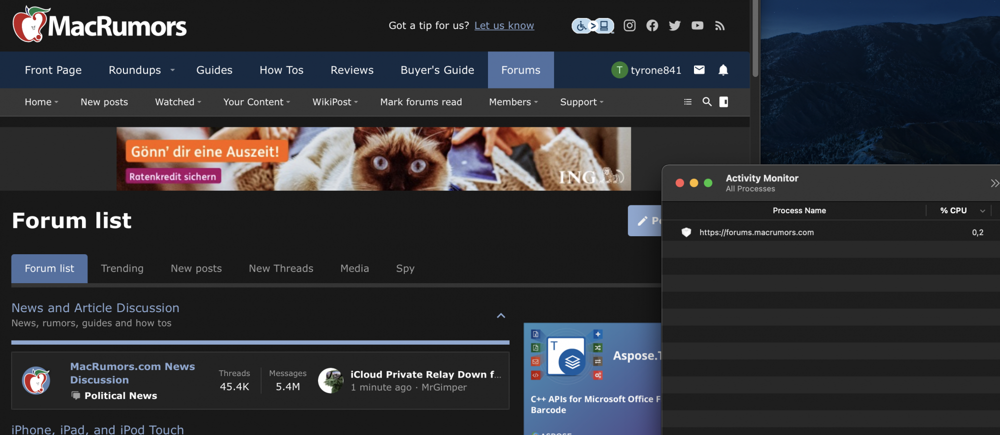

I am using AdBlock for Safari (https://apps.apple.com/at/app/adblock-for-safari/id1402042596?l=en&mt=12)
Debug on and NO Adblocker
Debug On does occasionally show ads, CPU usage is < 1% as per the following image.
However, the behavior is a bit erratic. Sometimes the ads were not shown at all even through multiple reloads. Sometimes when I go to a thread, the page is totally broken (looks like the css is missing I guess), while the forum list is perfectly fine. However, after turning debug off and on again (and always completely closing Safari afterwards) it is working again.

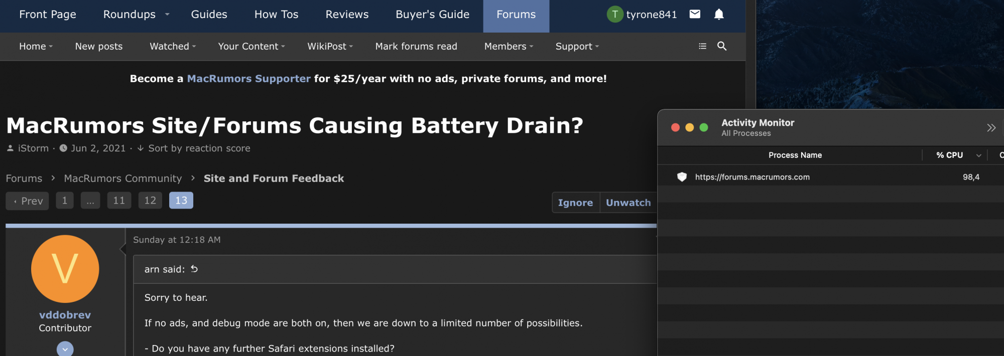

Debug off and NO Adblocker
Here you can see the image with Debug Off and no Adblocker. As you can see, CPU usage is around 100%.
Although I could perfectly reproduce this before, CPU usage was not acting up immediately this time. It took a few moments (jumping from Forum list to thread view back to forum list) when it suddenly jumped up again.

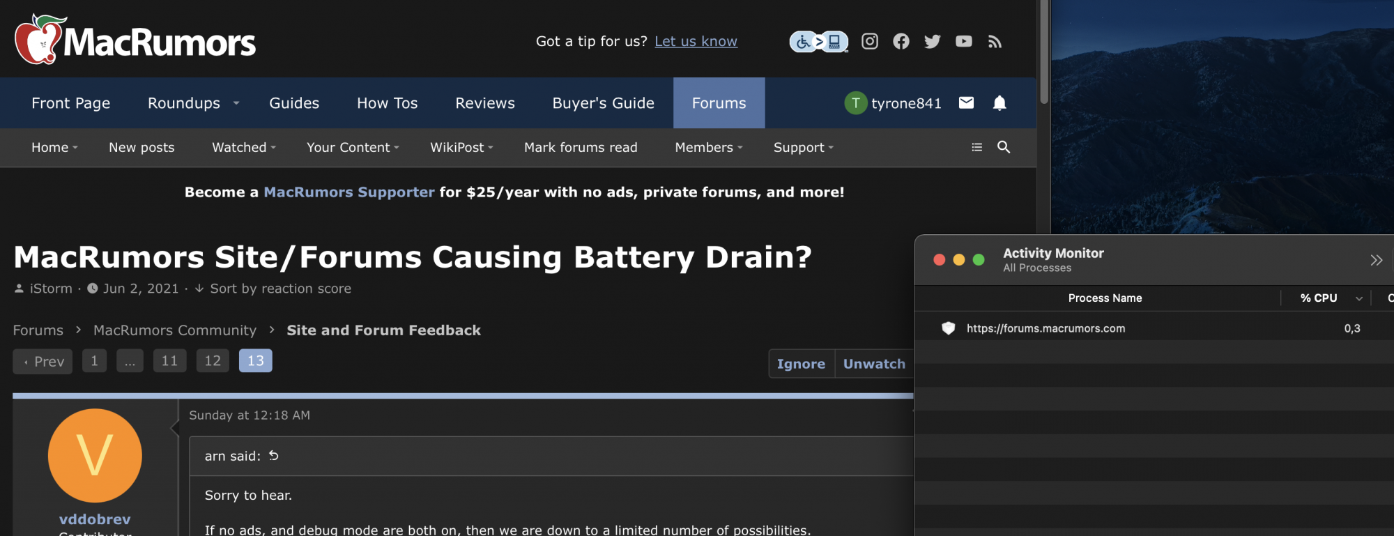

Debug off WITH Adblocker
When I activate the AdBlocker I get the same < 1% cpu usage - without ads.

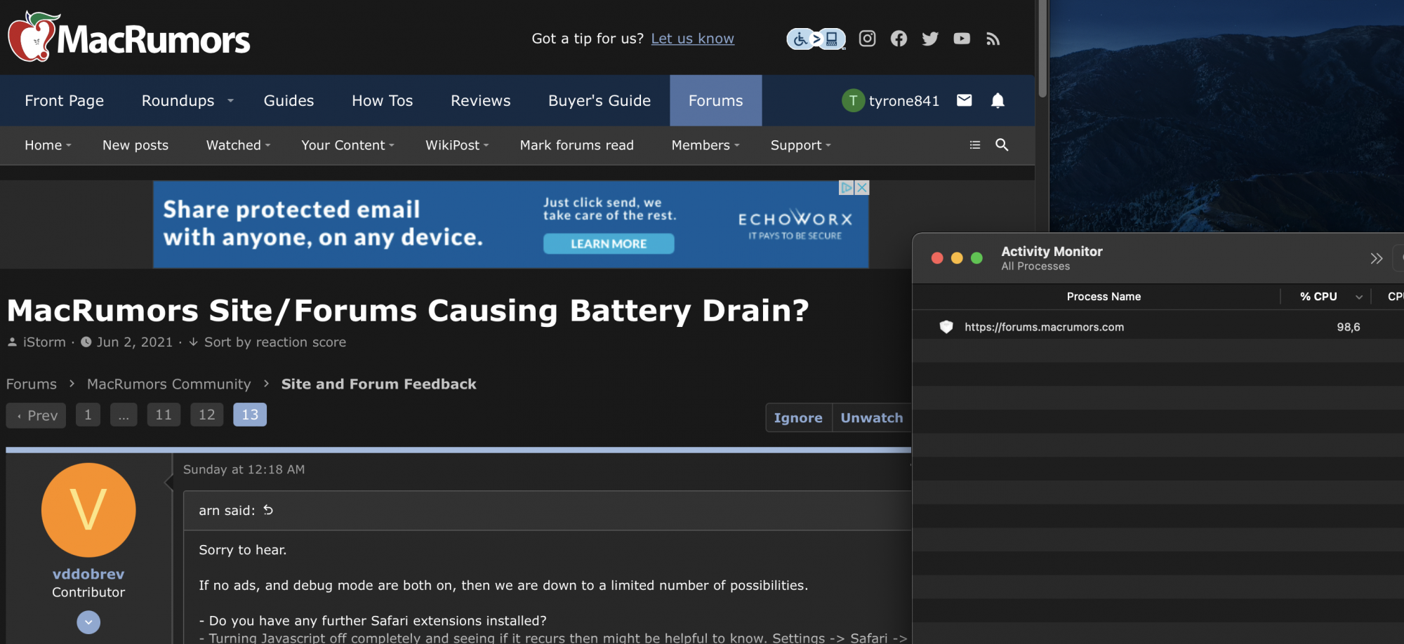

With Debug on (and no AdBlock) I still managed to get the 100% CPU usage all of a sudden.
Initially it seems to be okay (mostly <10%, when completely idling also < 1%).
Then I switch to the "Watched Threads" and go back and forth to the threads I watch. After visiting a few of them and going beck, CPU usage suddenly spikes at roughly 125 % and then comes down to the 100%. As I said, that is with debug mode on.
However, I was not getting any of that "broken style" thing anymore.
When I do the same thing (switch between my watched threads for a while) with AdBlock on, CPU usage stays around 1% (not accounting for loading spikes of course).
@arn

Macrumors continues to be the culprit in using excess system resources. My iPhone always gets very hot while on the site and yesterday I confirmed the same on my Mac. Macrumors was using 30%+ of cpu power, which is ridiculous. And this was WITH content blockers enabled, so it’s not the ads. They really need to fix this site.
