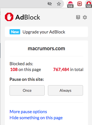

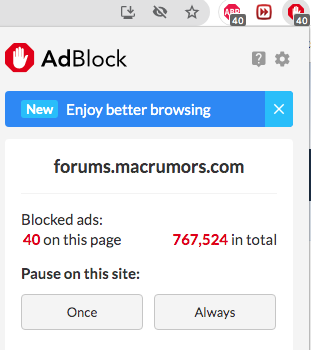

I visit MacRumors on desktop 99.999% of the time, using AdBlock so I don't see the bogged down ads thankfully. I actually never knew it was THAT bad until I did go on this site using my phone, whew...no. I can understand why the battery takes a hit and I understand the site needs some ad revenue, but sorry, that's a bit insane.
I never paid attention to how many get blocked on any page - my little icon "stop sign icon" counts up...and up.
Homepage of MR - 108 blocked
Forums / MR - Another 40

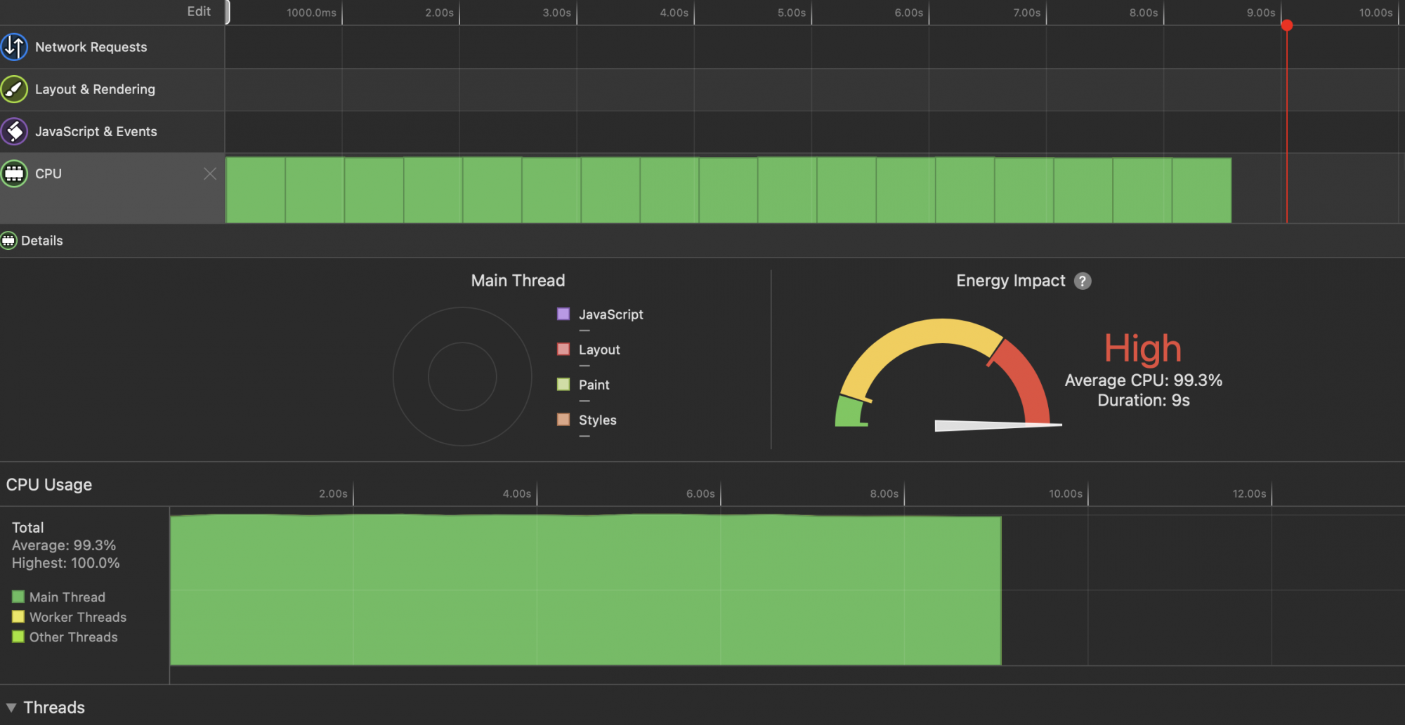

Thanks, that fixed my problem with #2, but the CPU usage is still 100%.
Is this on desktop?
If possible can you post a screenshot of what is causing the cpu load?

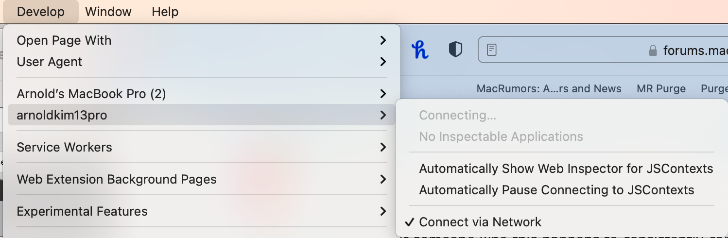

If you are on desktop you can skip the steps about connecting to your iPhone and just go to the Develop menu and choose Show Page Resources. Do this when you are experiencing the issue.
You may have to check off "Stop recording once page loads" so the recording continues for more time.

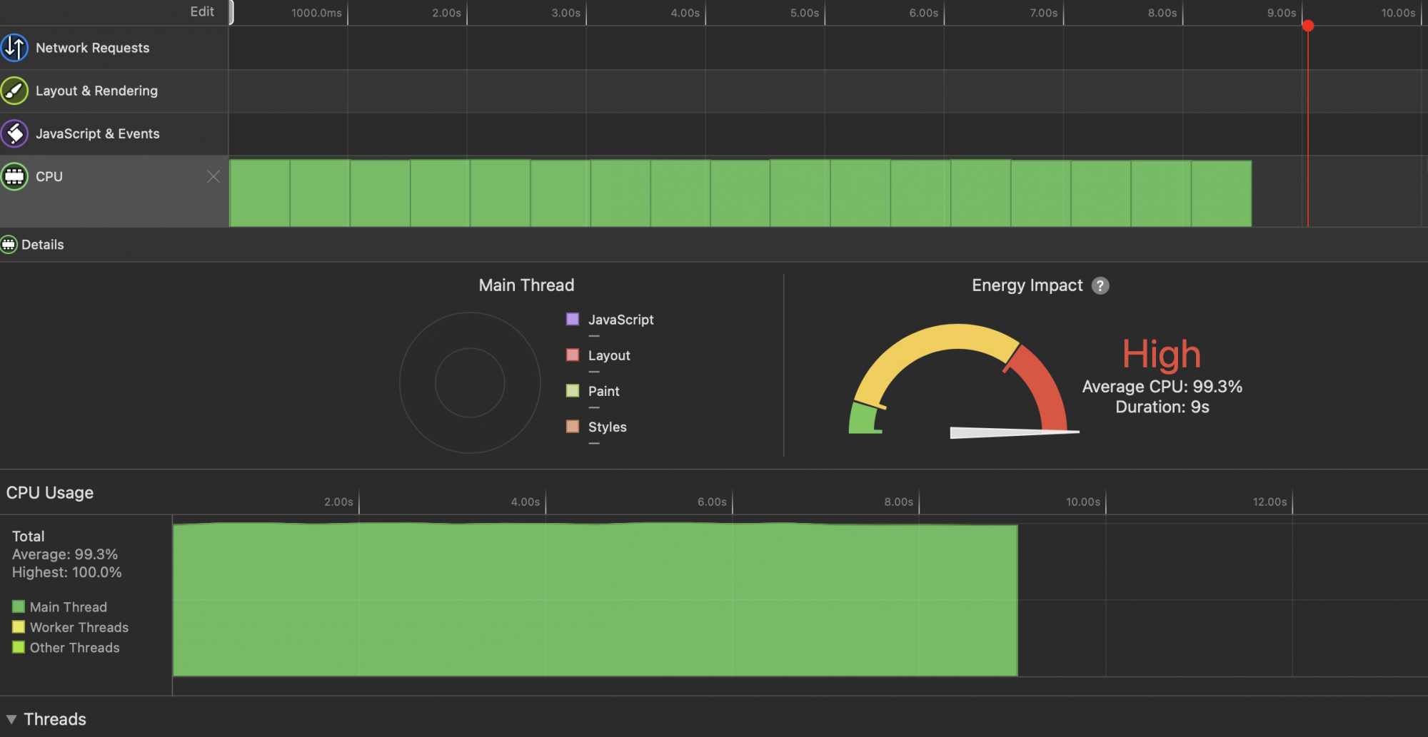

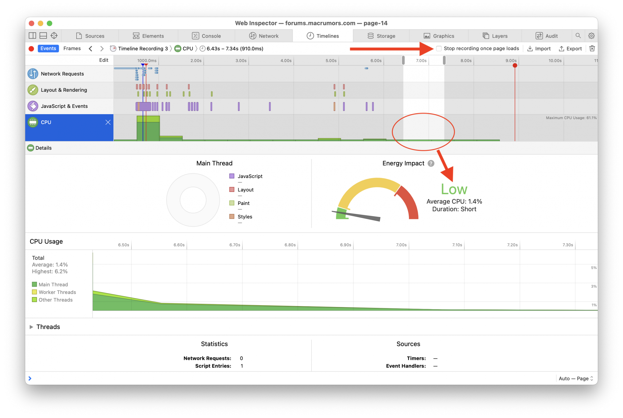

This is how it looks on my Mac. No ads. Normal mode (not debug). While viewing this thread.
Reactions: yitwail

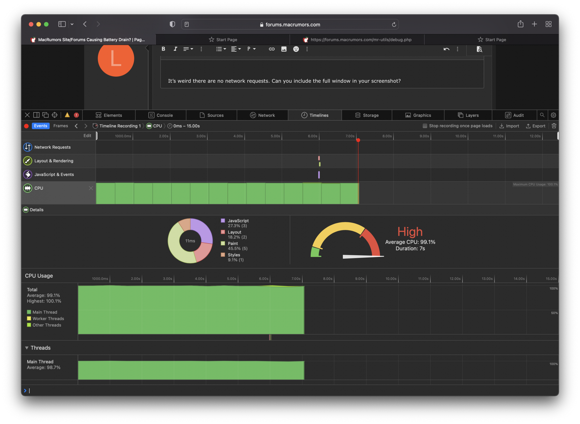

Are you in debug mode? What device? Ads blocked?

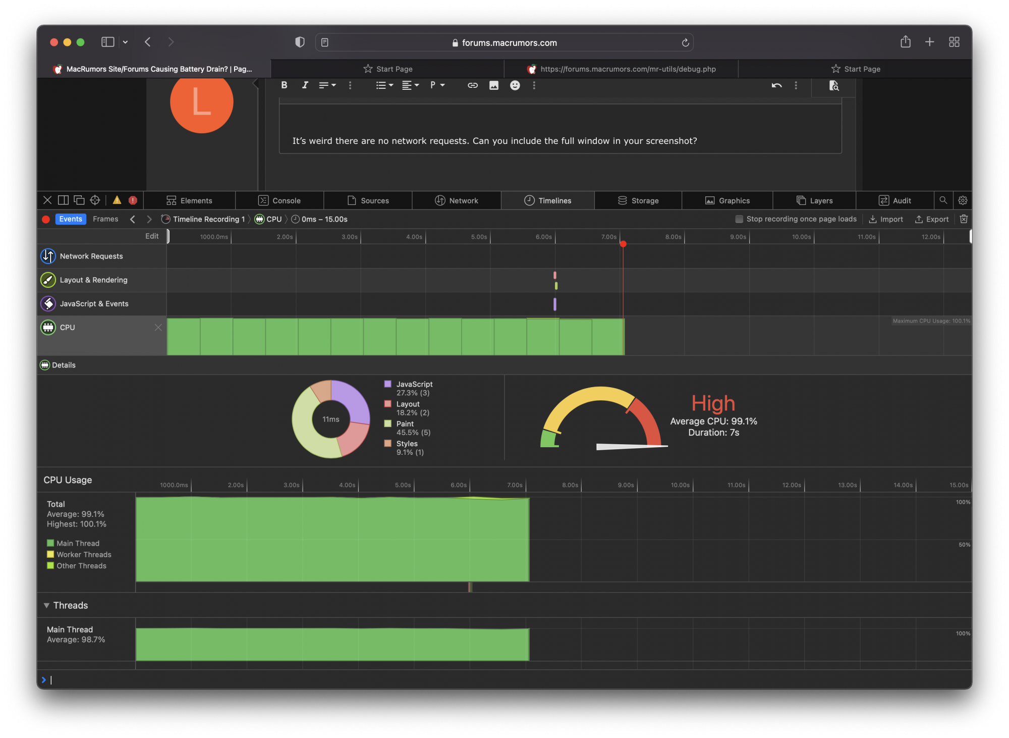

Debug mode on, ads blocked, MacBook Pro 16" 2019, Monterey 12.1 Beta (21C5021h). Tried with both Safari and Safari Tech Preview, no difference.

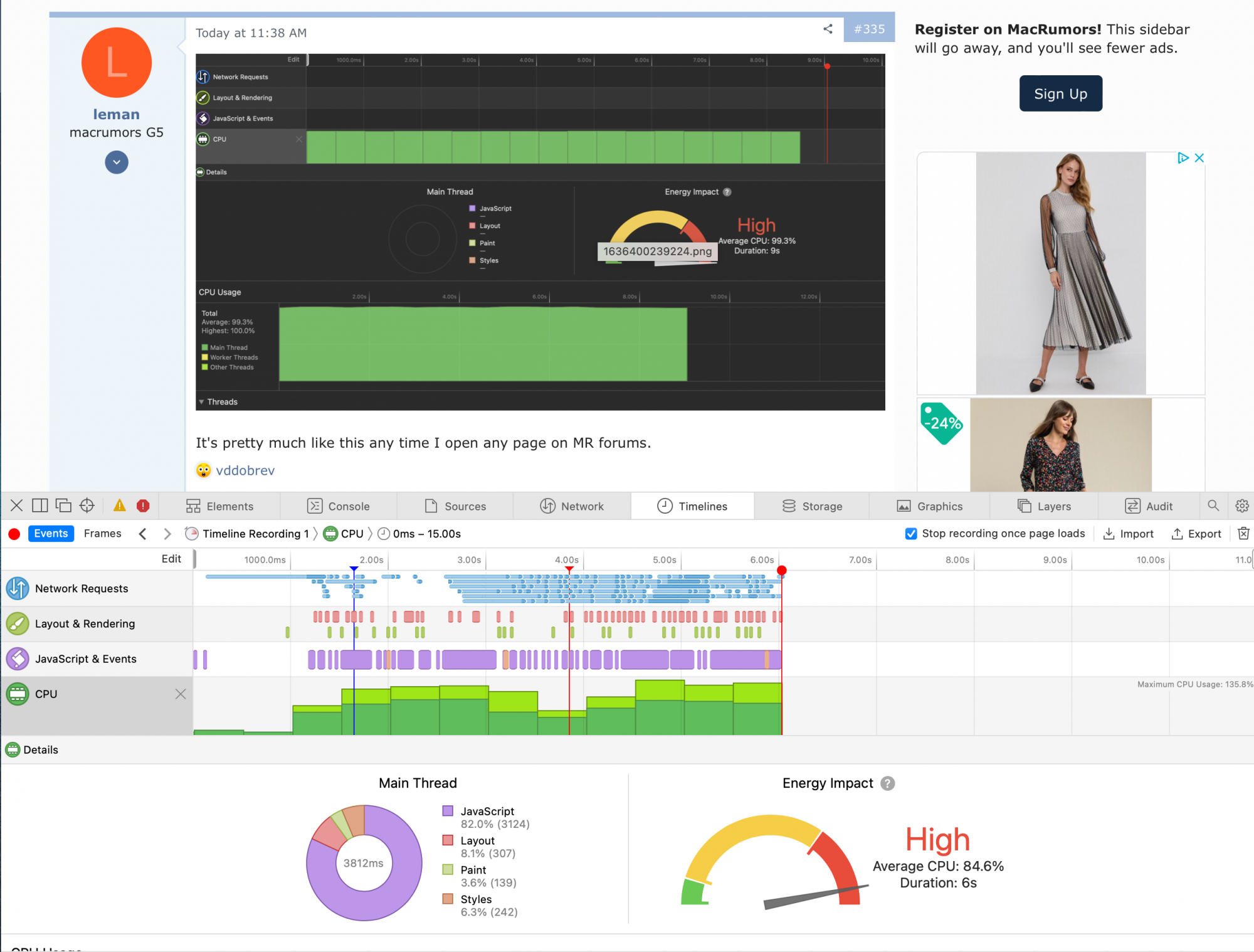

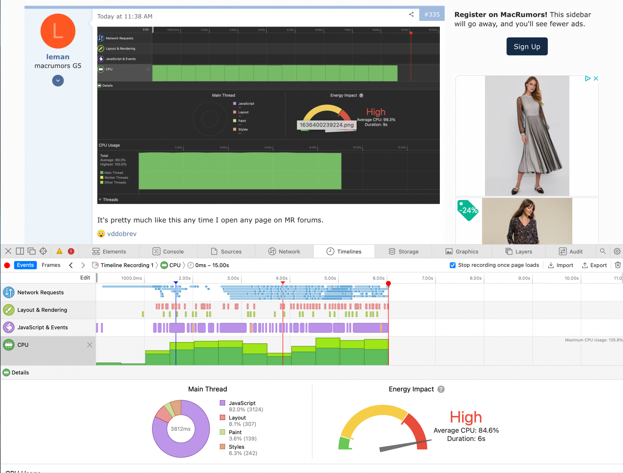

It’s weird there are no network requests. Can you include the full window in your screenshot?
Is this fine? It's all on the main thread btw.
P.S. Disabling JavaScript makes the high CPU usage go away.
It’s still weird looking. Can you go into Safari preferences. Turn off JavaScript entirely and reload the page and see if it fixes it.
Yeah, just did it, disabling JavaScript and restarting Safari fixes it.

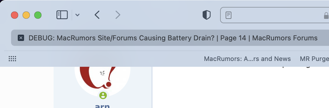

I've made another change to make the DEBUG mode more obvious.
Can you post another timeline with it not happening? I'm still not quite why your timeline doesn't have any other activity.

Ok. @leman
Right now. Debug mode strips down the page even further. Some things might break because of it, but at least you should be able to see if it is still happening on this thread view.
thanks

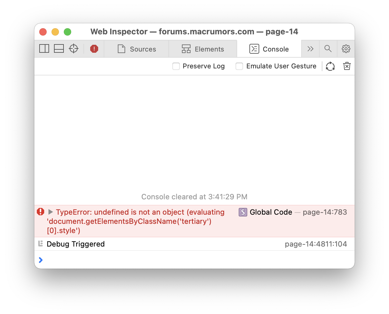

Yeah... definitely Javascript related, but I have a theory now.
I've modified the Debug code once more. If someone is seeing it and can look at
Safari -> Develop -> Show Javascript Console
While in debug mode. If you look at that after you load the page.
1. If it's happening (CPU 100%)
2. I'd be curious to see if "Debug Triggered" appears more than once.
