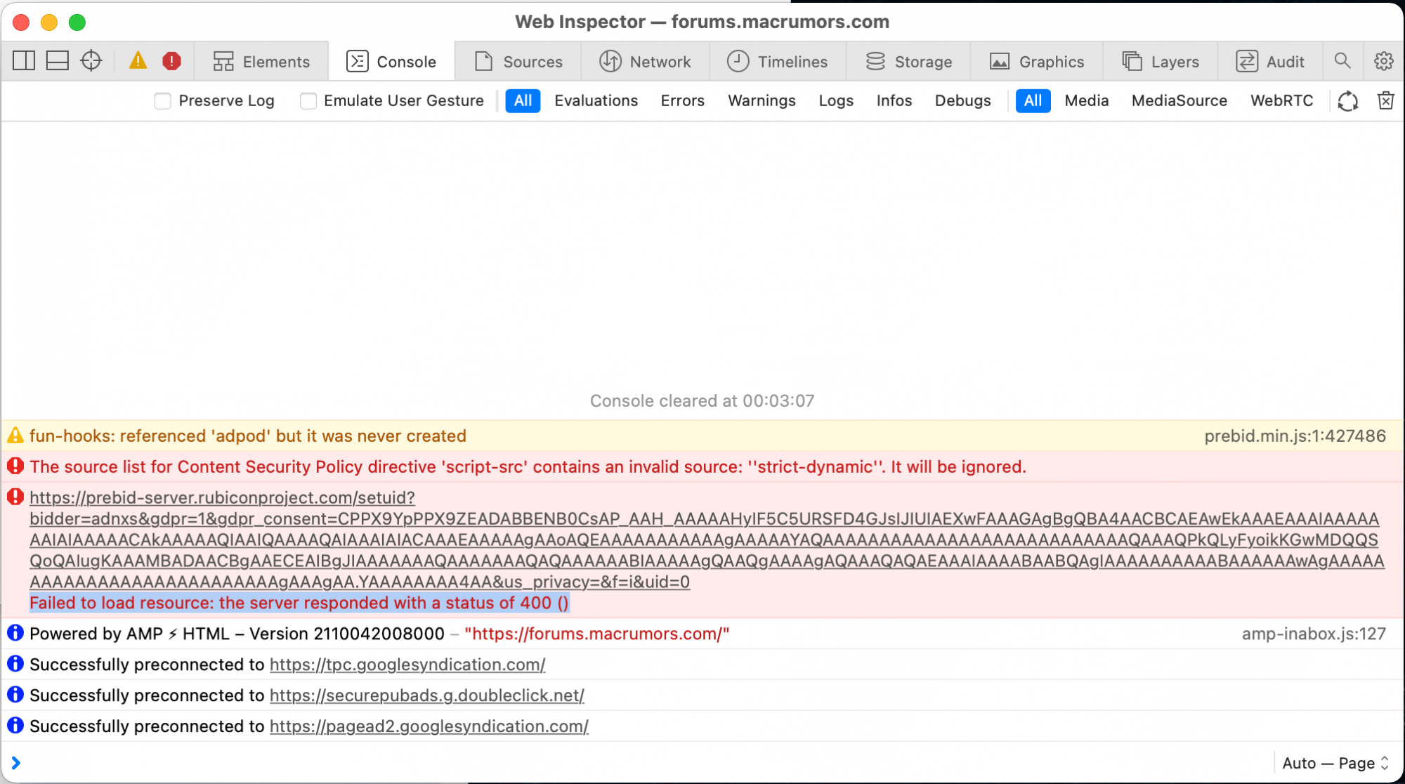

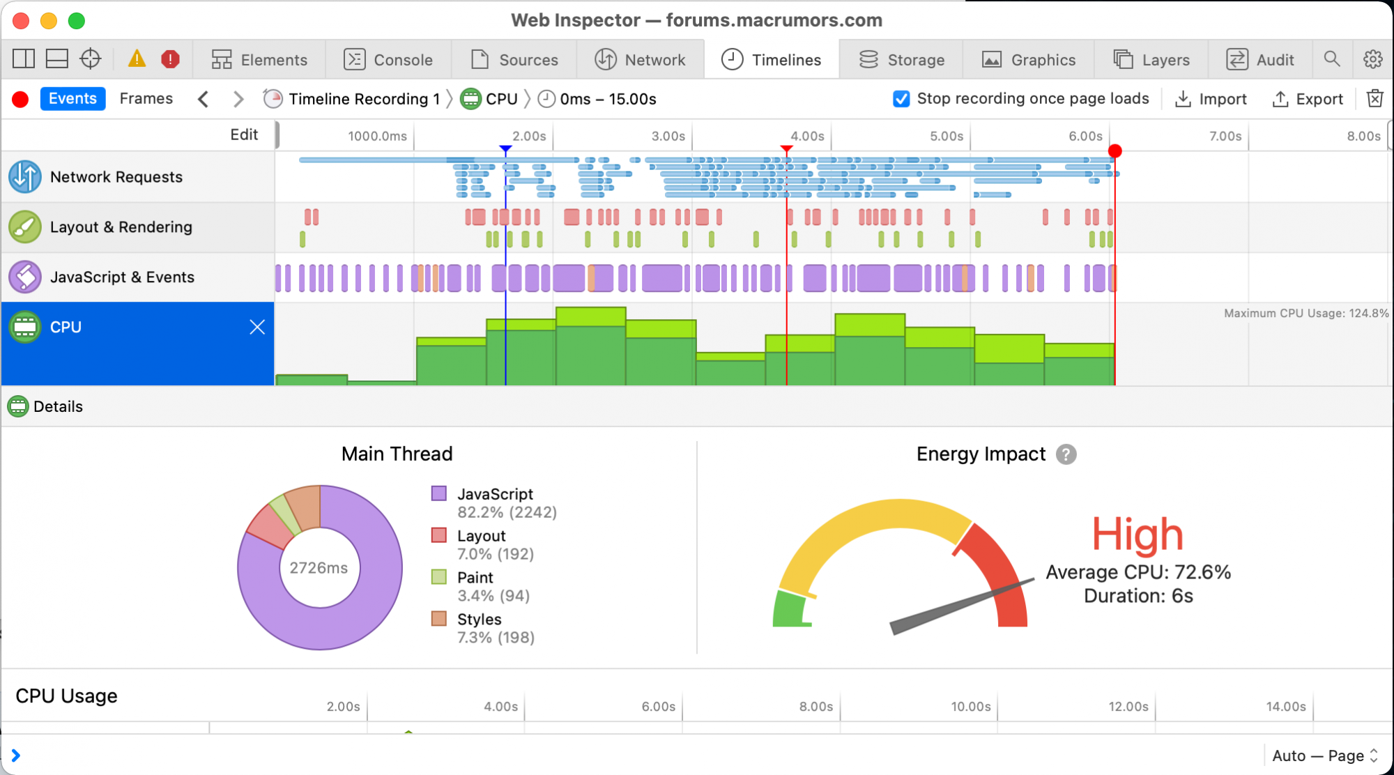

Could you check Safari -> Develop-> console in debug mode when it happens?
thanks

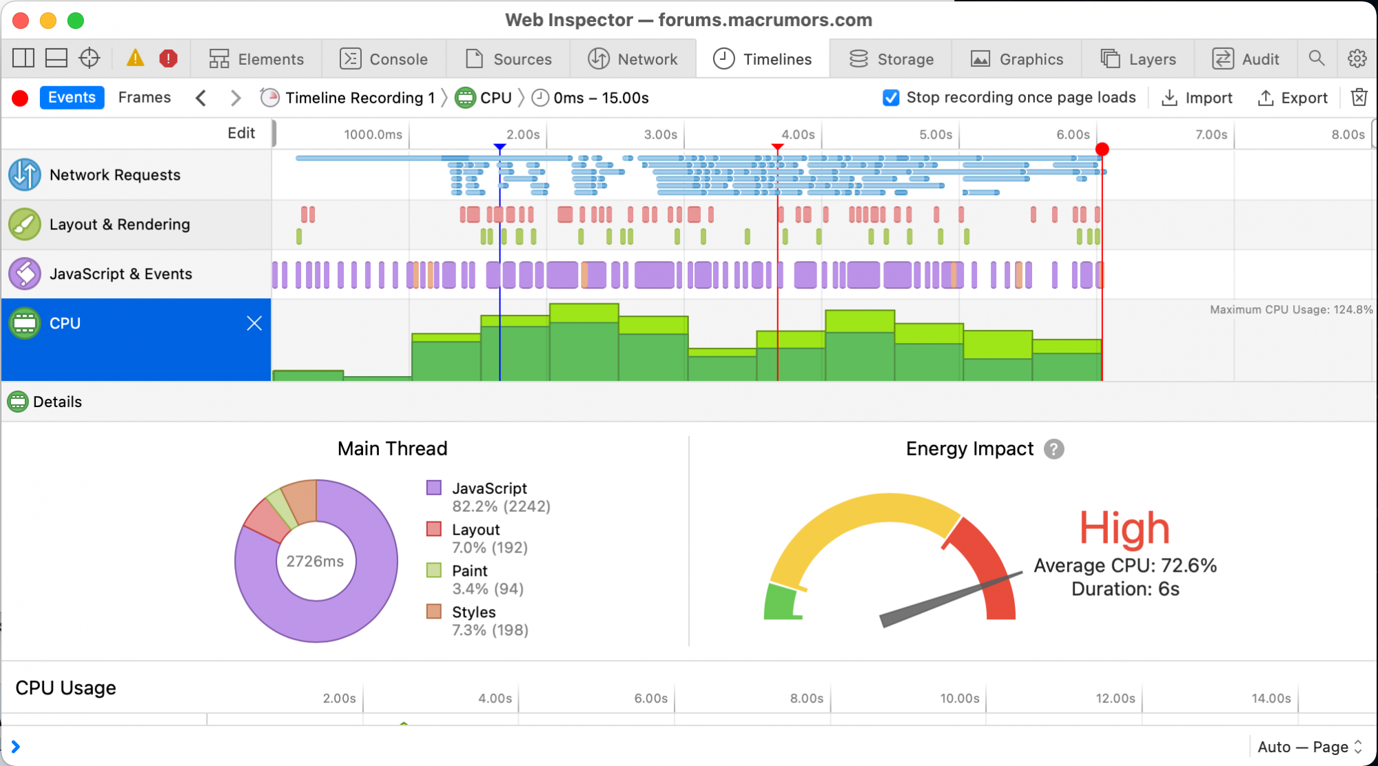

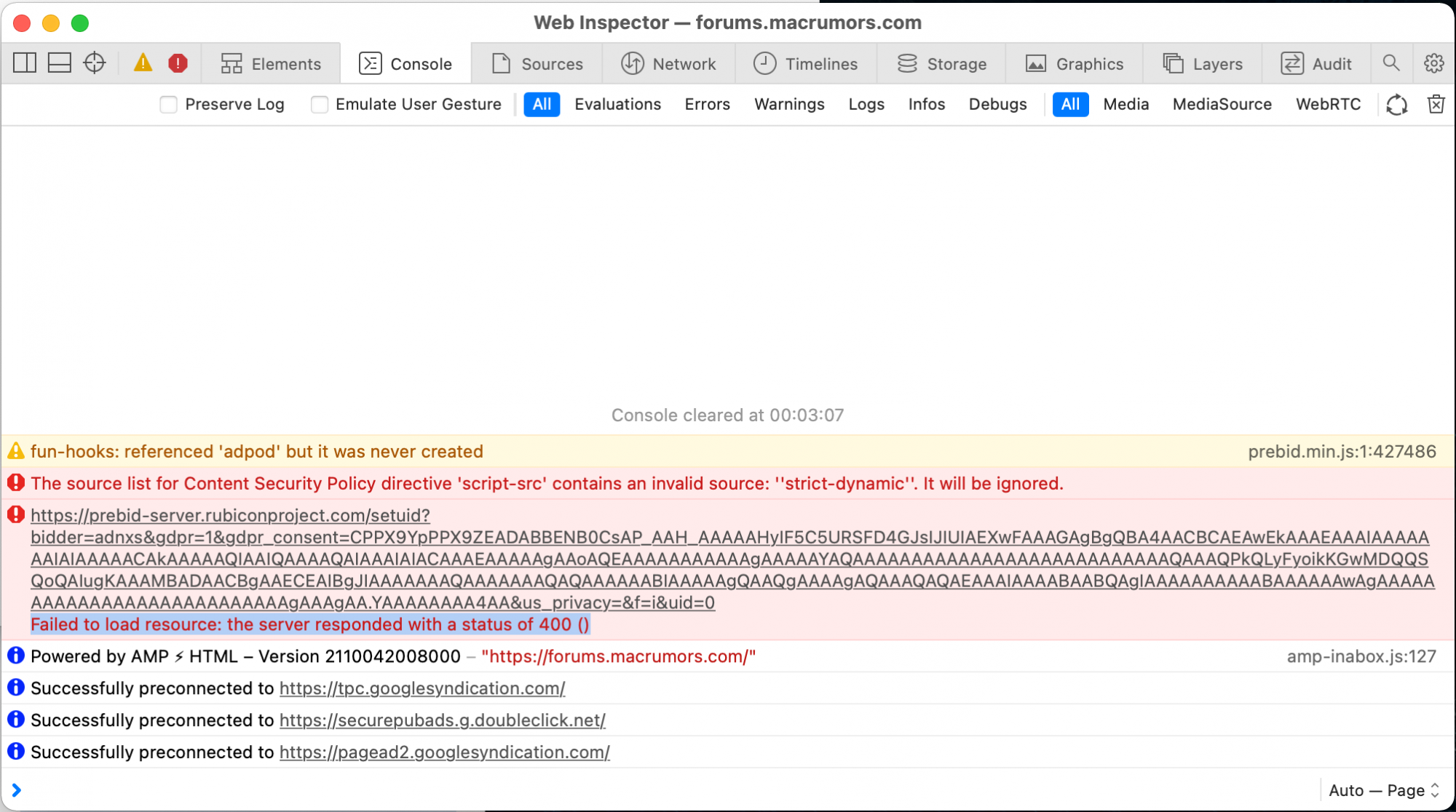

Here is the timeline and what is in the console for the same.

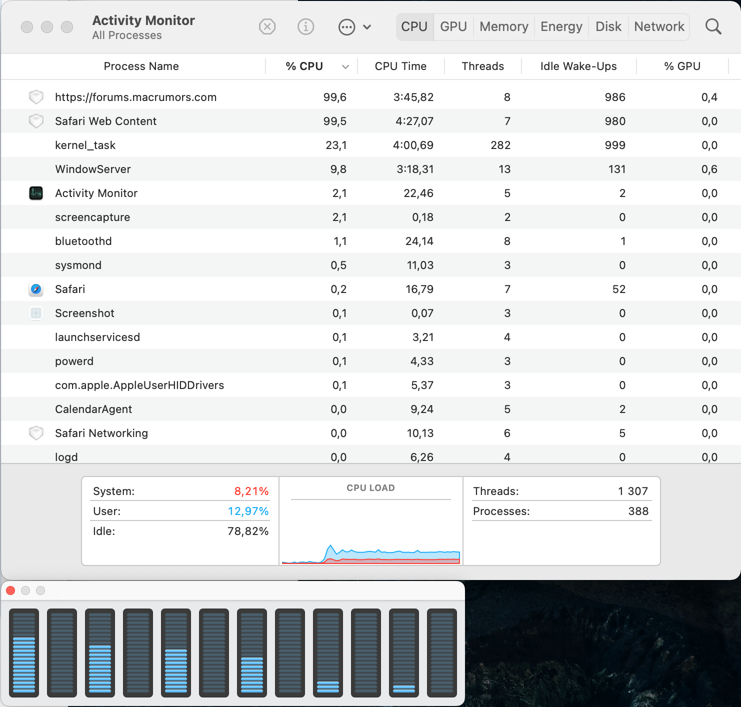

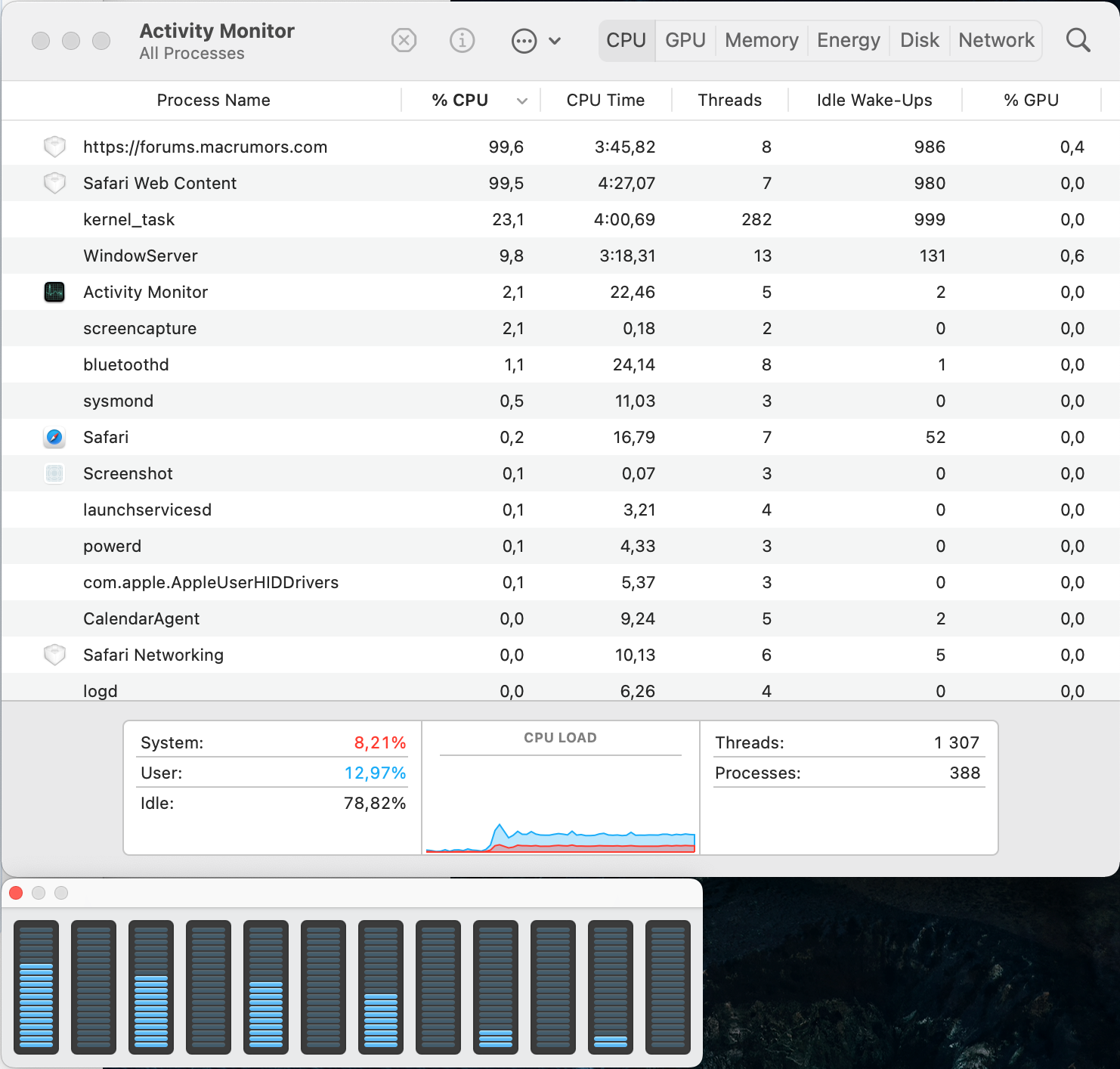

Right now, I am logged in, debug is off, typing this message, and my CPU looks like this:

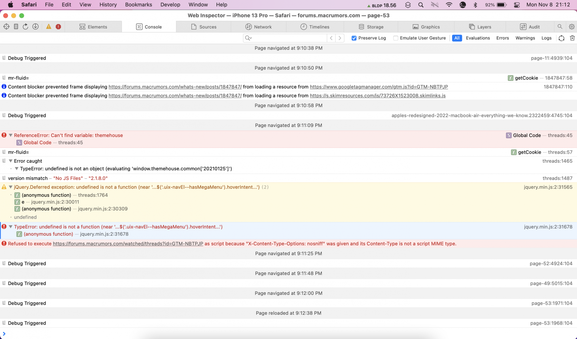

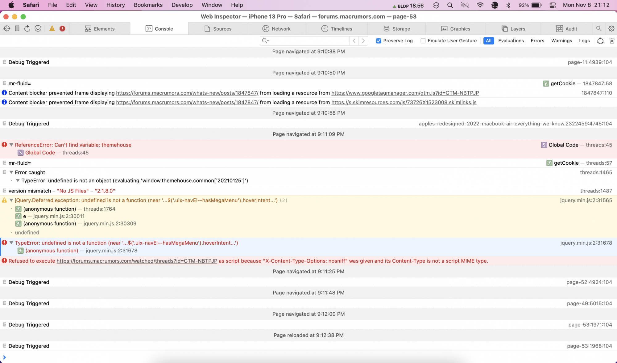

thanks
2. I'd be curious to see if "Debug Triggered" appears more than once.
Just once on each page load.

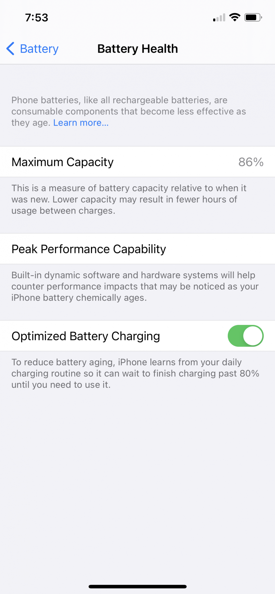

My battery health was 91 percent when I started coming on here with my phone… in the matter of about a month, it’s 86 percent. Phone gets hot, battery drains extremely quick.
