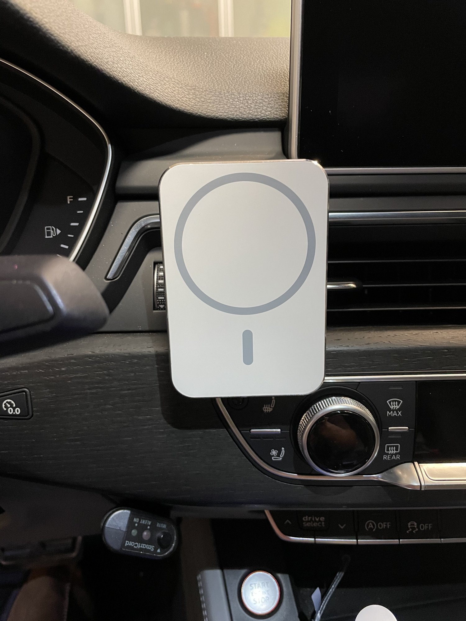

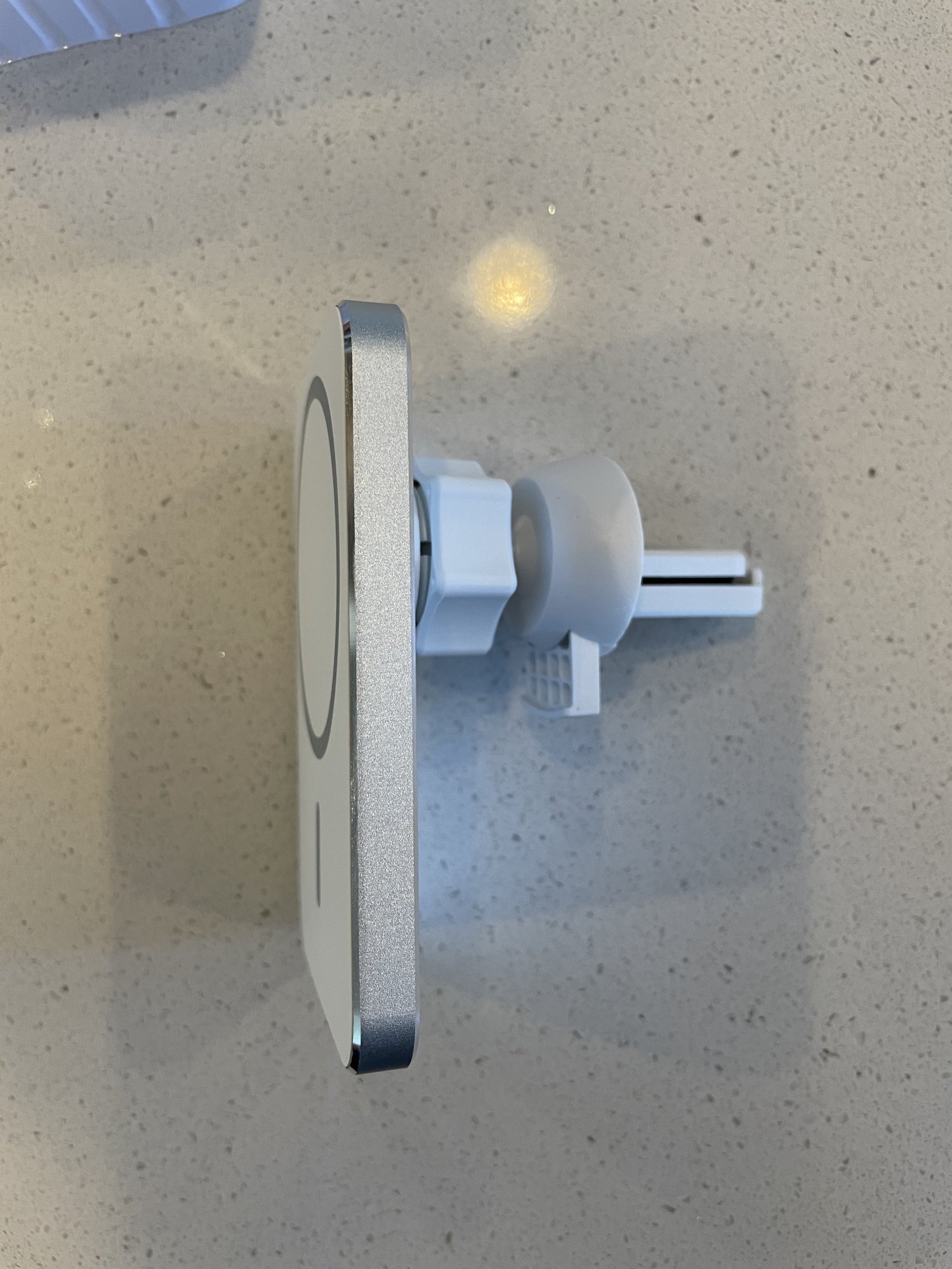

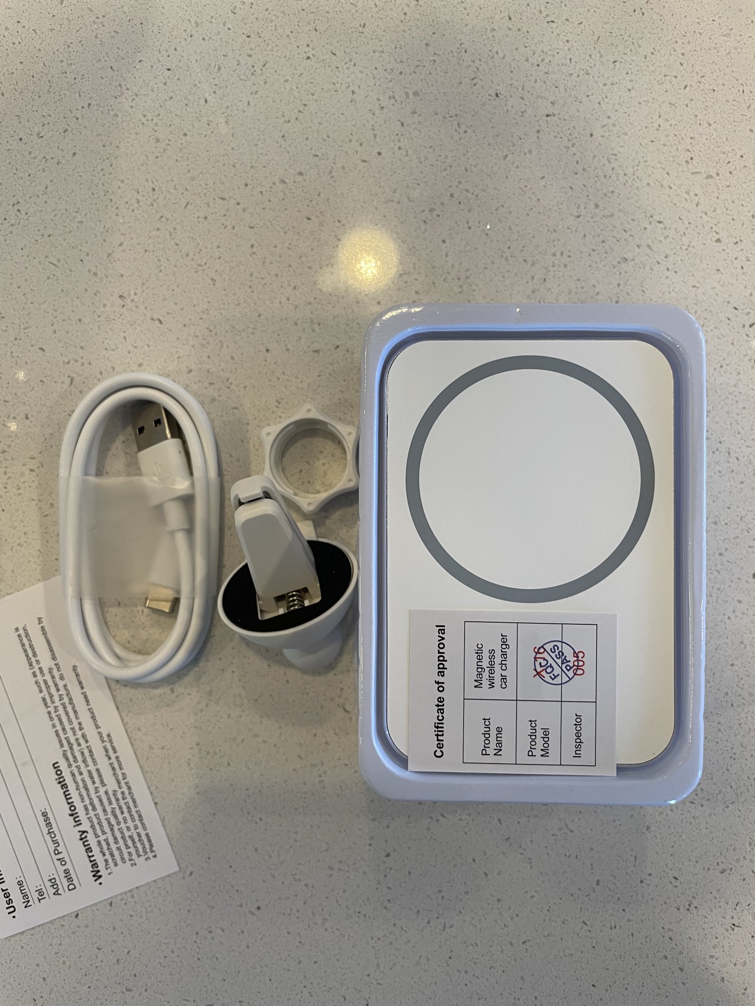

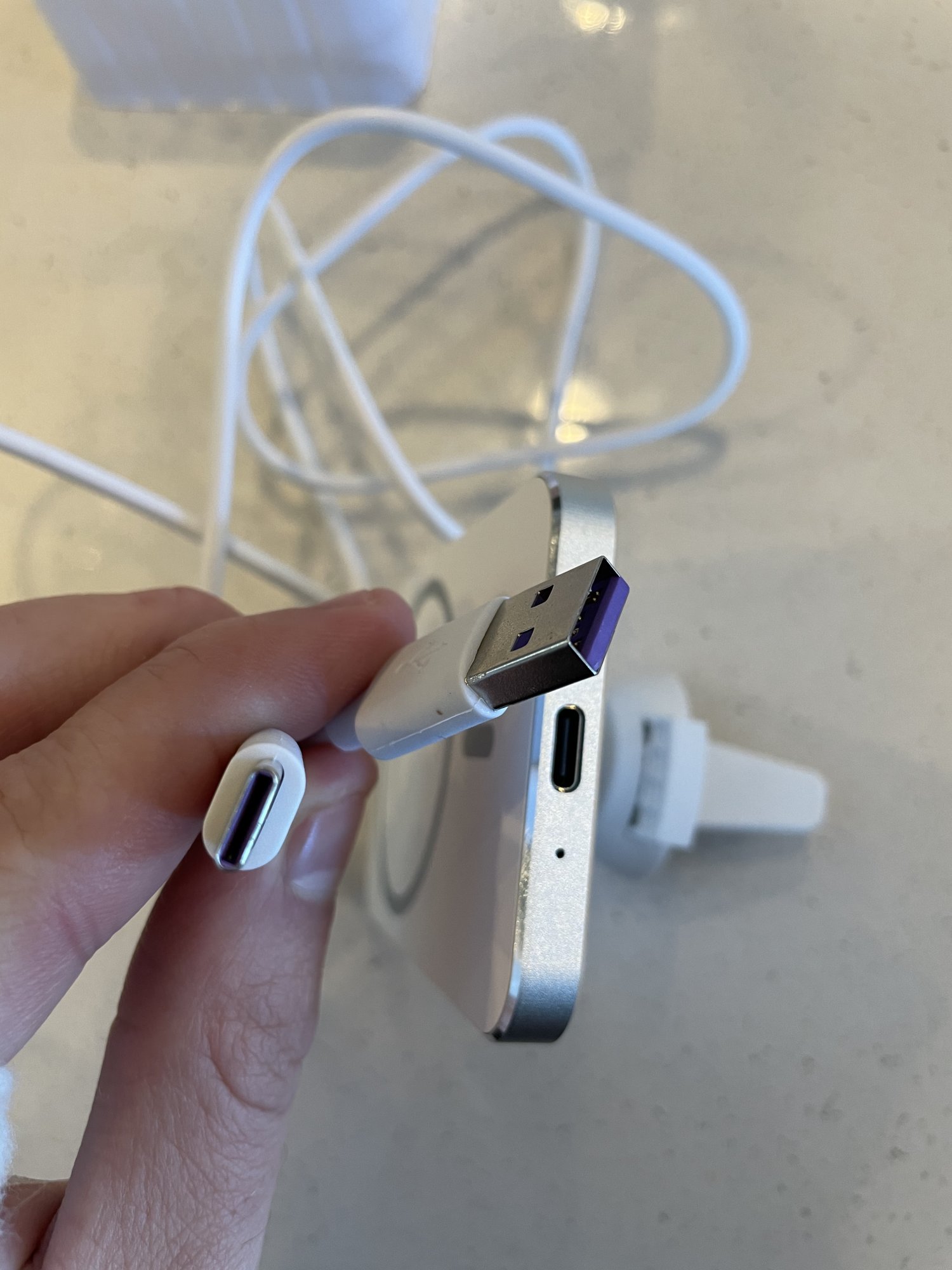

My take on the mount I purchased on eBay here, of which there are many copycat listings of the exact same product.
View attachment 1694960 View attachment 1694961 View attachment 1694962 View attachment 1694963 View attachment 1694966
View attachment 1694967 View attachment 1694968 View attachment 1694969 View attachment 1694970

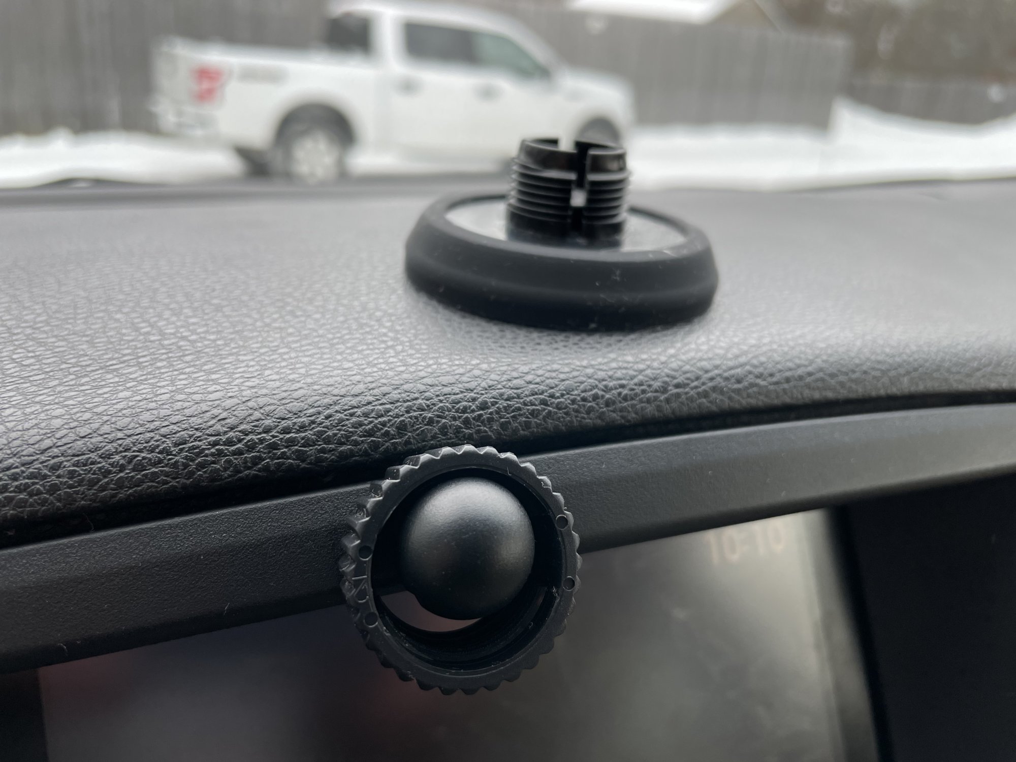

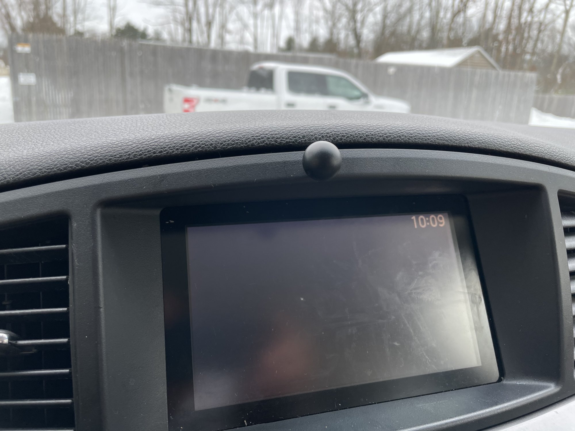

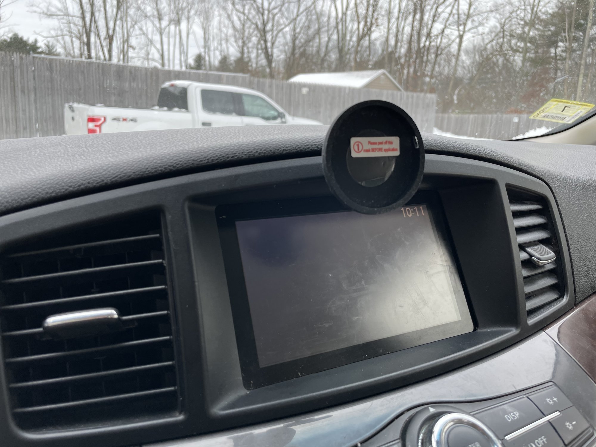

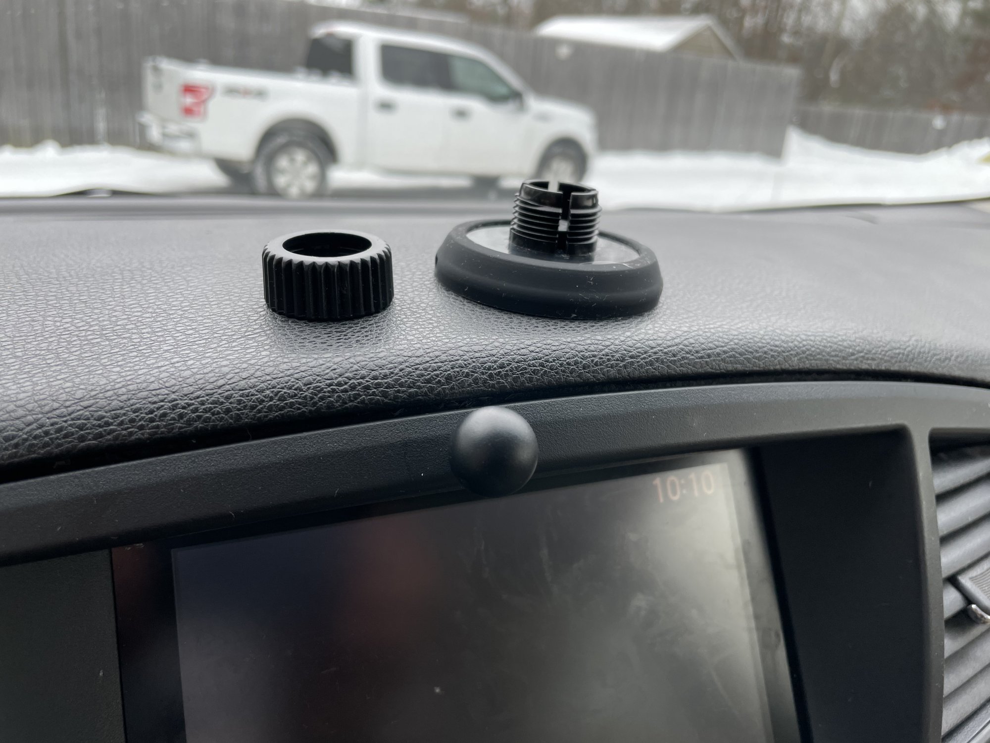

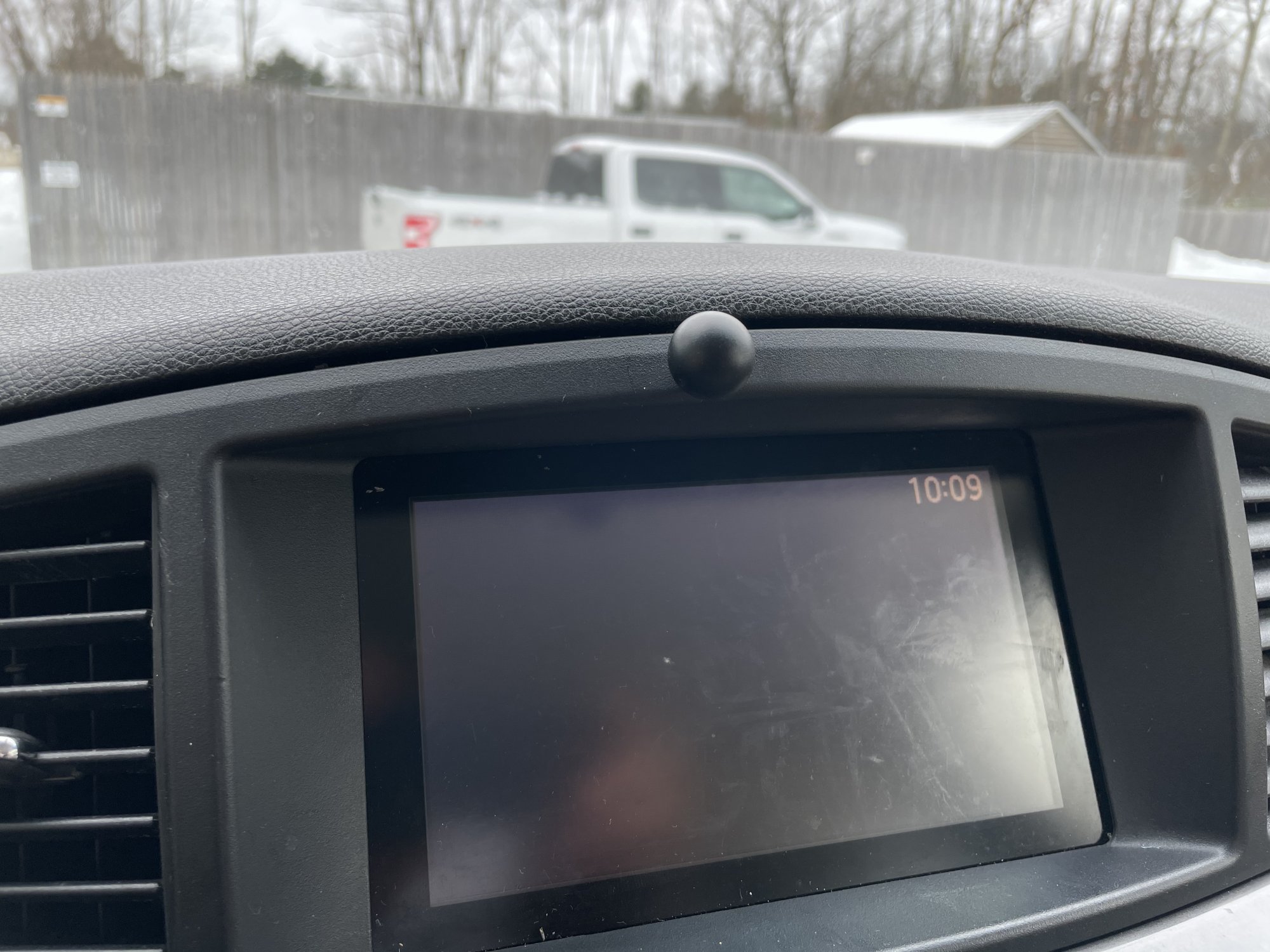

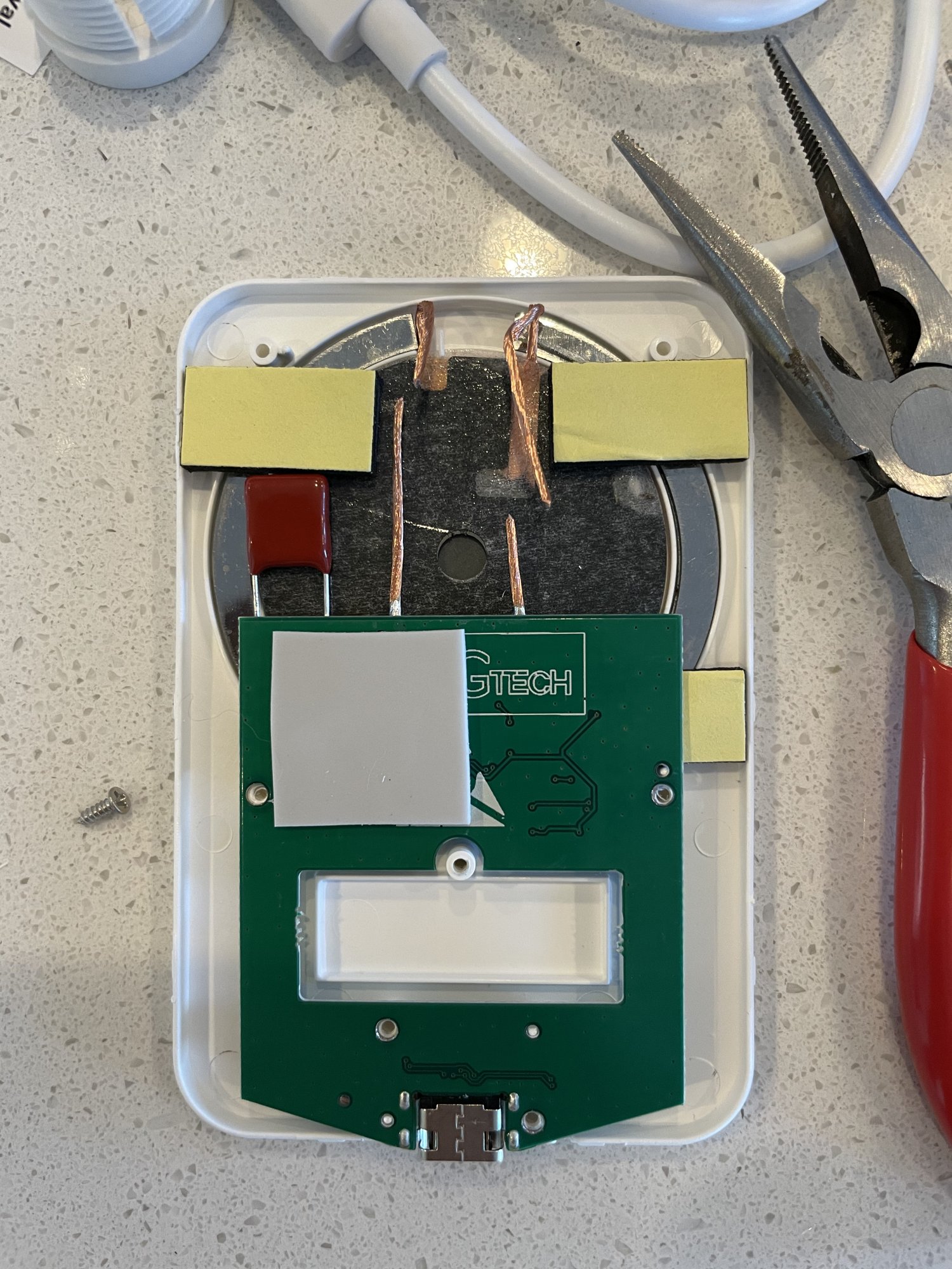

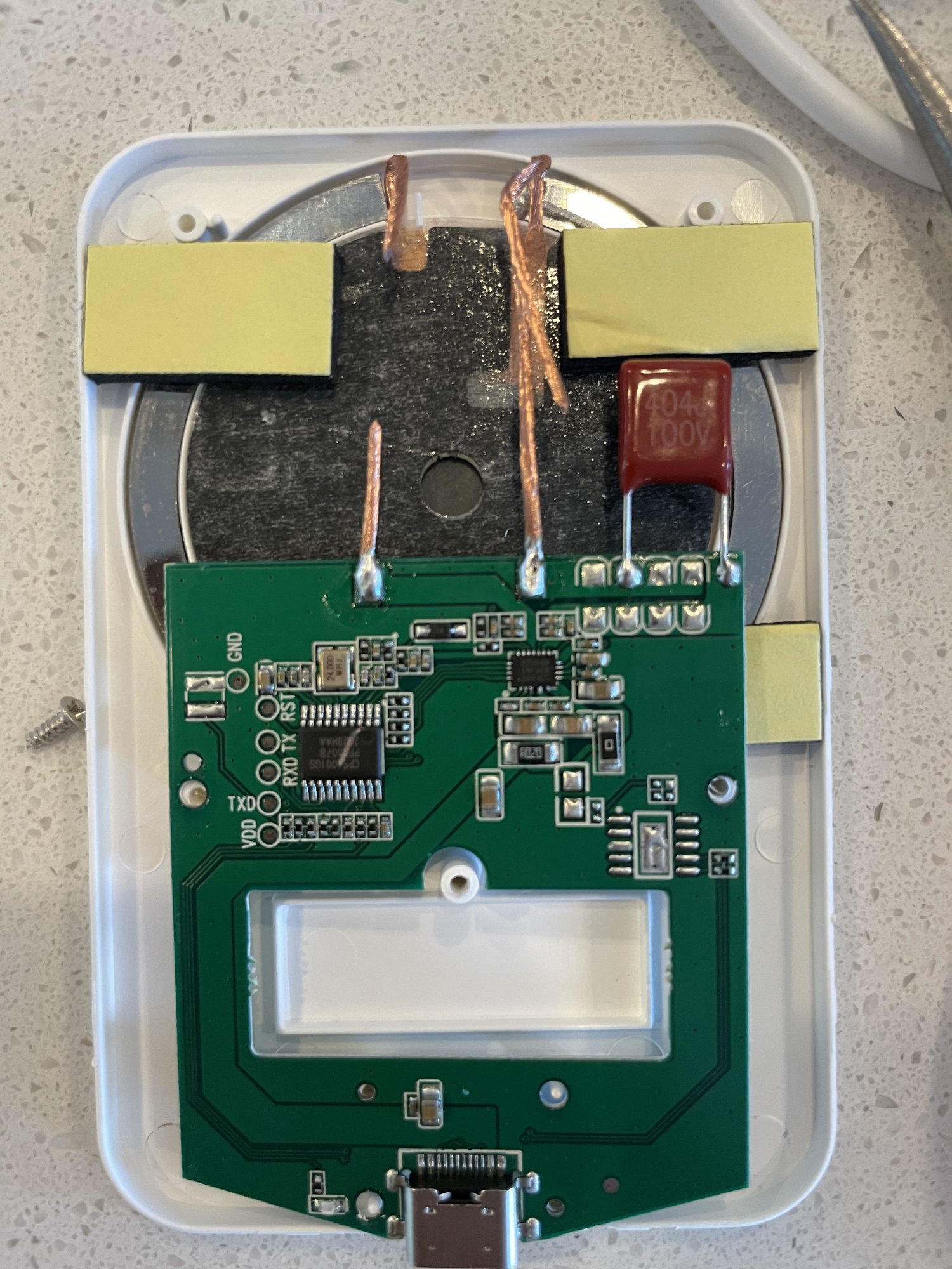

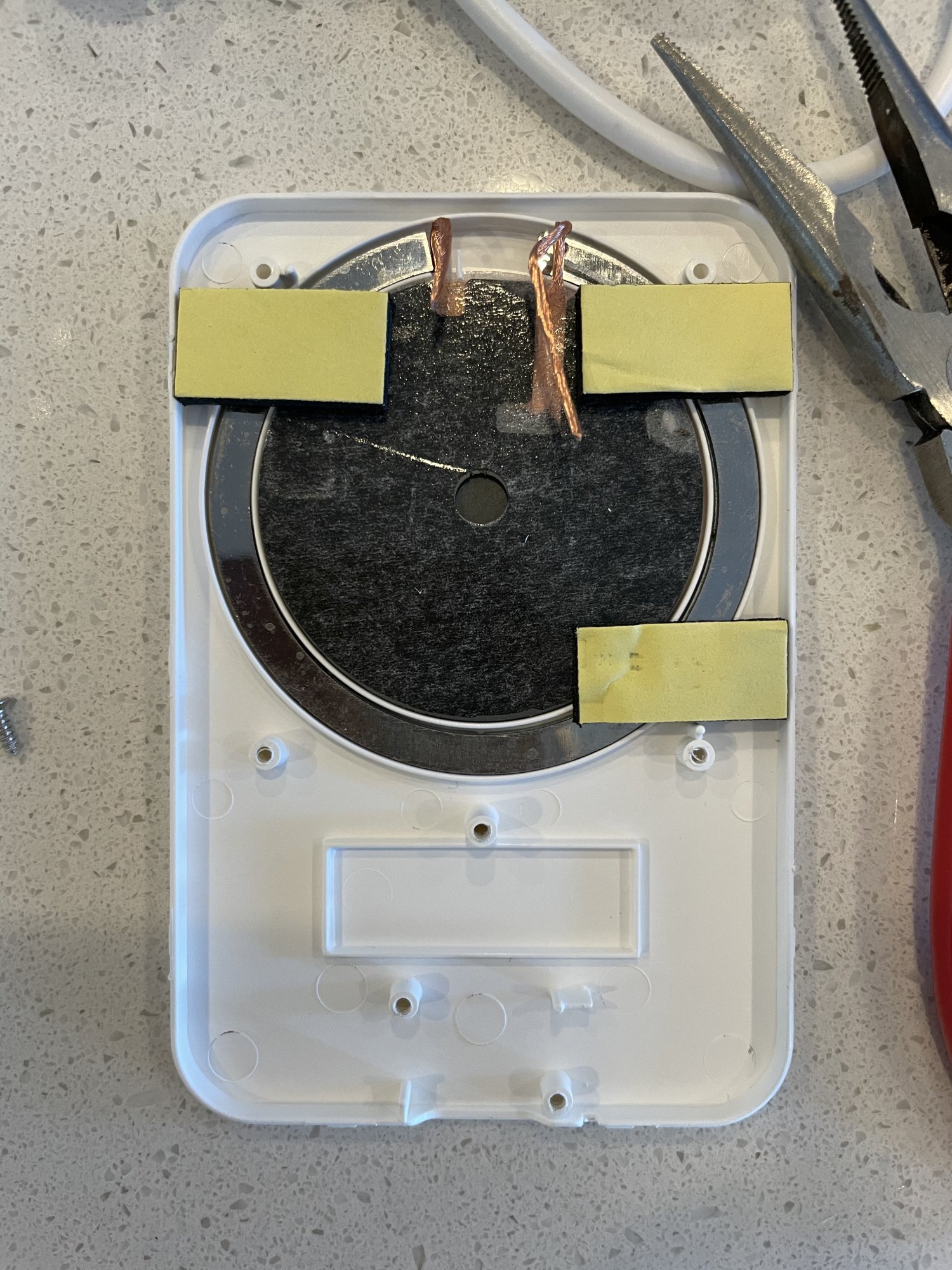

I took this apart so I could remove the electronics and ball mount screw. It's relatively easy to get apart once the ball mount is off, and the back screw is removed. Had to twist the unit a bit to expose one of the gaps between the front metal and plastic charging/magnet pad, then used a plastic spudger around the edges to undo the clips. I also cut the wires to the Qi coil, but before that I plugged it in and it did not show the MagSafe charging animation. This will be used in an environment in which I need to use wired CarPlay anyway. The case clipped back together well enough with no hassle or too much concern about fragility.
I found it odd that the photo on the box did not match the product, and that there were multiple unused adhesive pads inside the unit with one side left unstuck.
Pros
  • Holds very well, despite the alignment magnet being MIA and using an Apple Leather case
  • USB-C connectivity
  • The chamfered edges may not actually be aluminum, but they look premium
  • The vent clamp included seems very tight and sturdy, but I did not test it
Cons
  • Press on the magnet ring too hard and it will give/crack (e.g., when applying a 3M adhesive pad)
  • I don't expect this to actually charge at 15W, but no way to test now
  • Took a full two weeks to ship
Overall, this is a good interim solution until Moment, Scosche, etc. release their MagSafe products. I expect it to hold well.

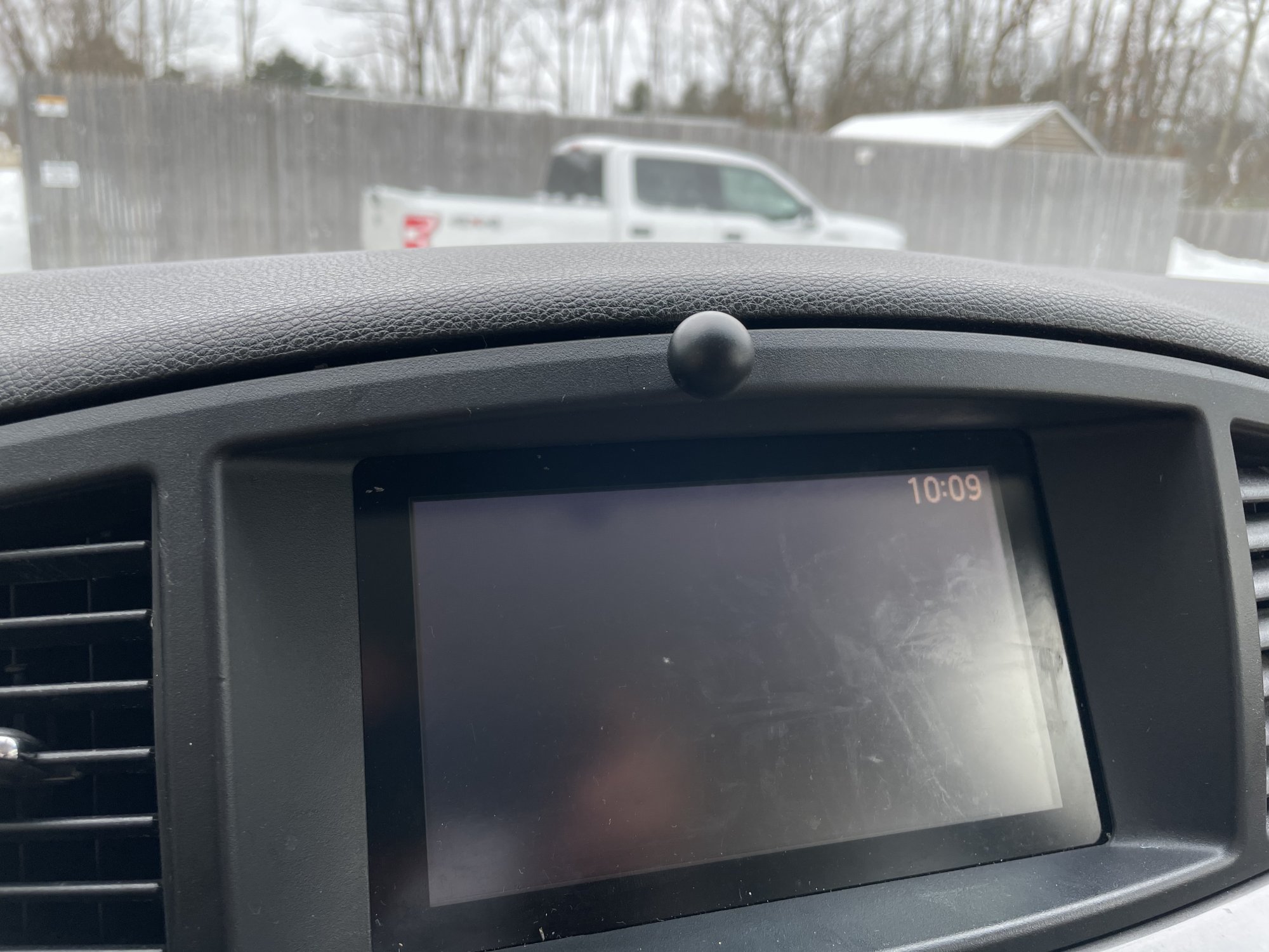

I installed a 17mm ball head that will accept a wide variety of MagSafe mounts and chargers. And since I’m in New England I have to keep it away from the vents so the iPhone will not overheat.
