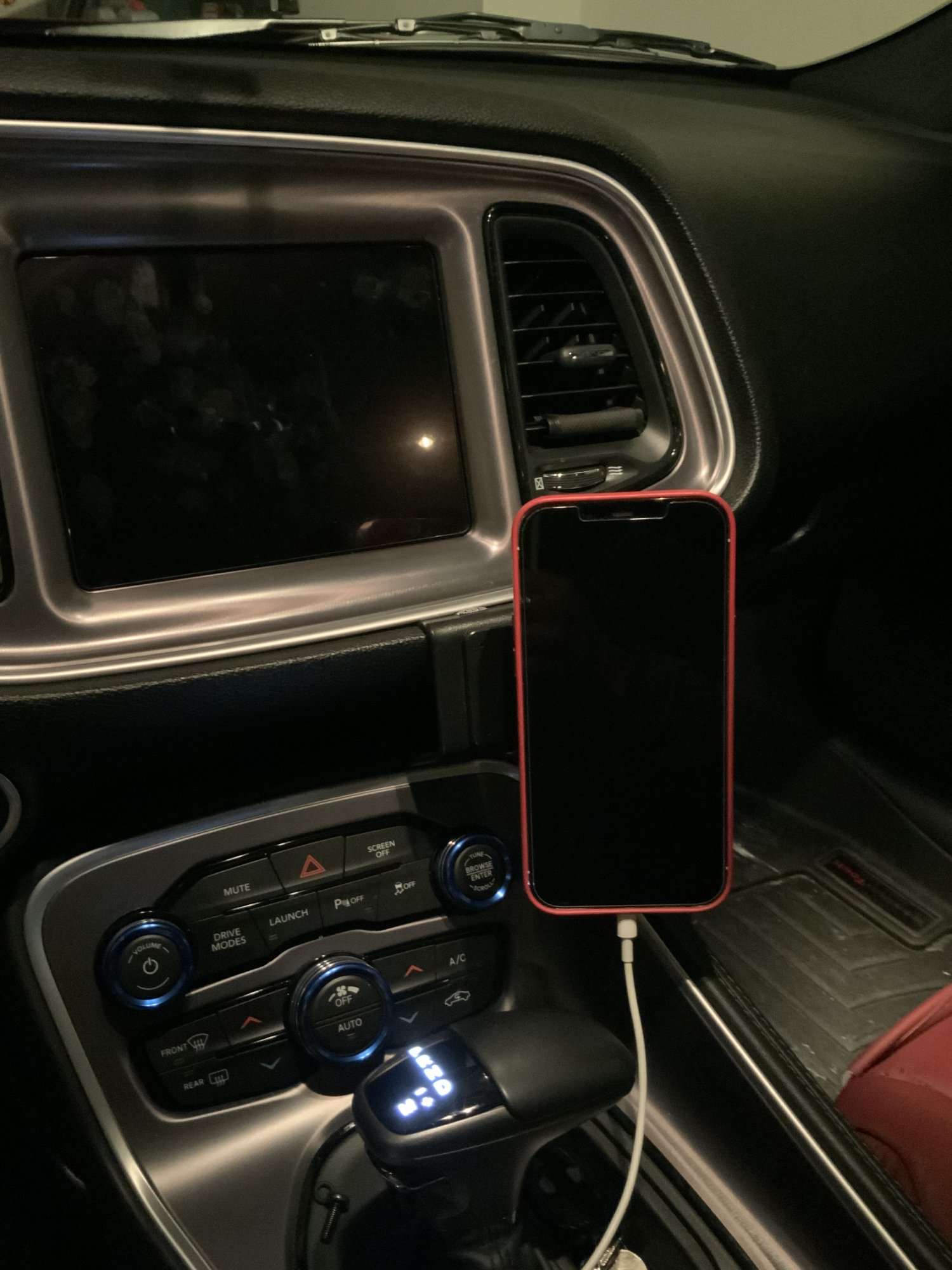

View attachment 1697693View attachment 1697695

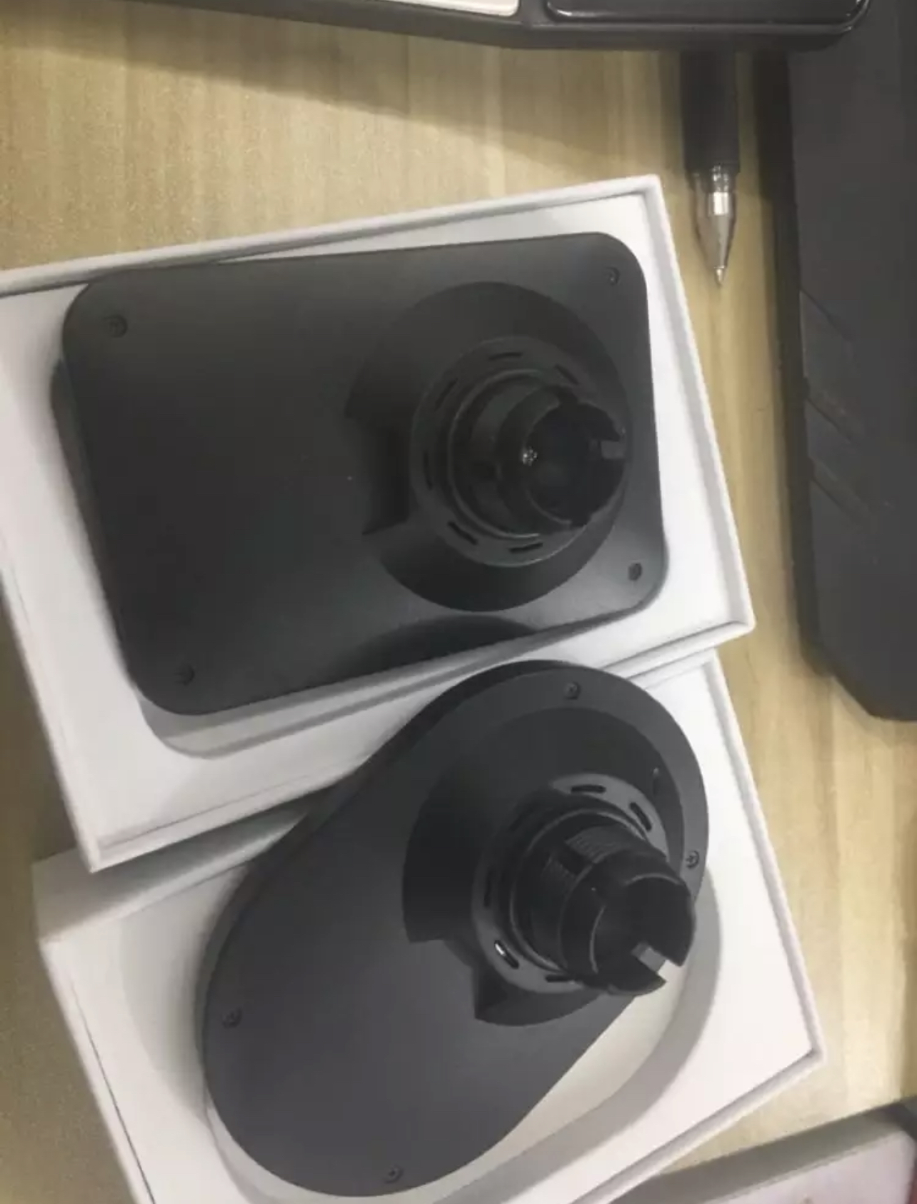

I just ordered two of those (rectangular, not oval) off Amazon. Supposed to be here Dec 21-23.
This video from Amazon is very promising...
default.jobtemplate.hls.m3u8
I'm assuming they use a 17mm ball mount so I also ordered two of these...

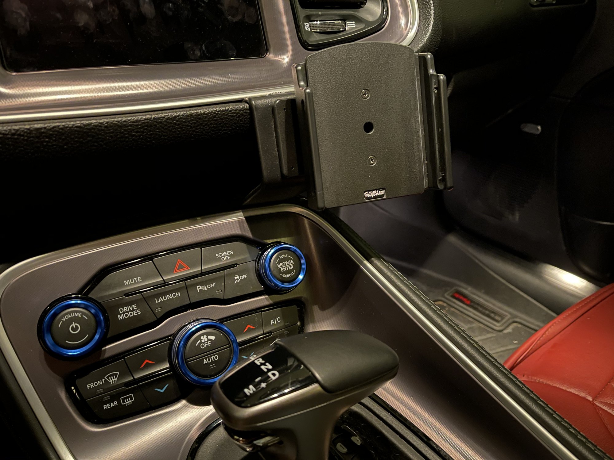

Plan is to replace the MagicMountProXL magnet on two ProClips w/the ball mount.
PS: I have an iPhone 12 Pro Max w/Apple Leather MagSafe Case.

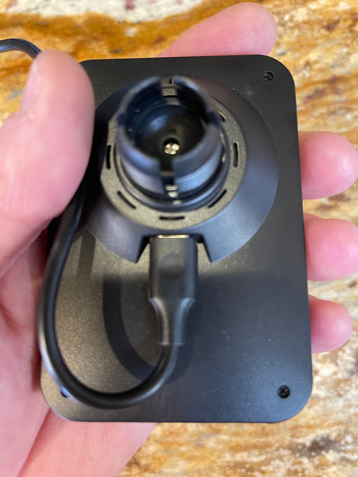

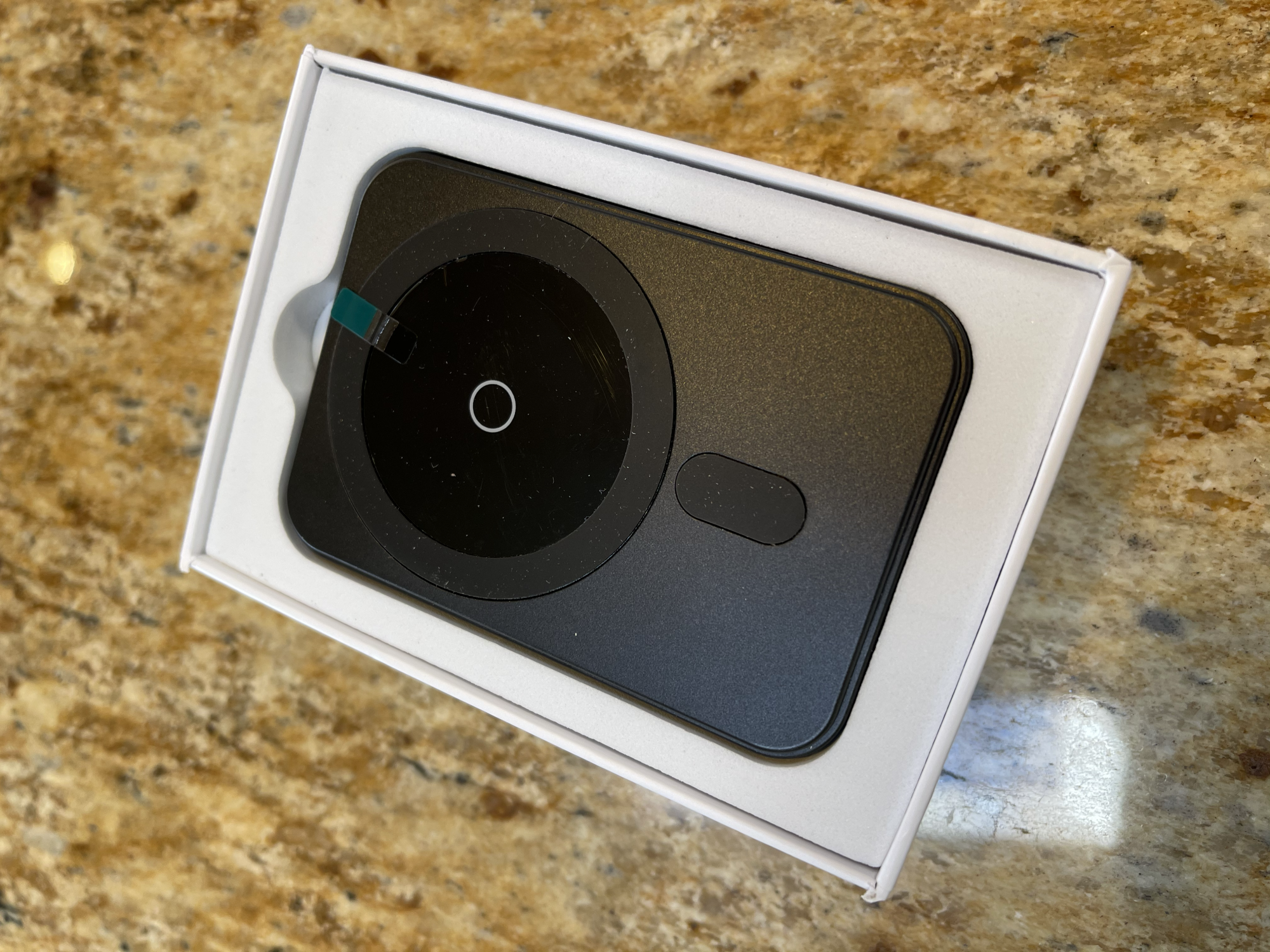

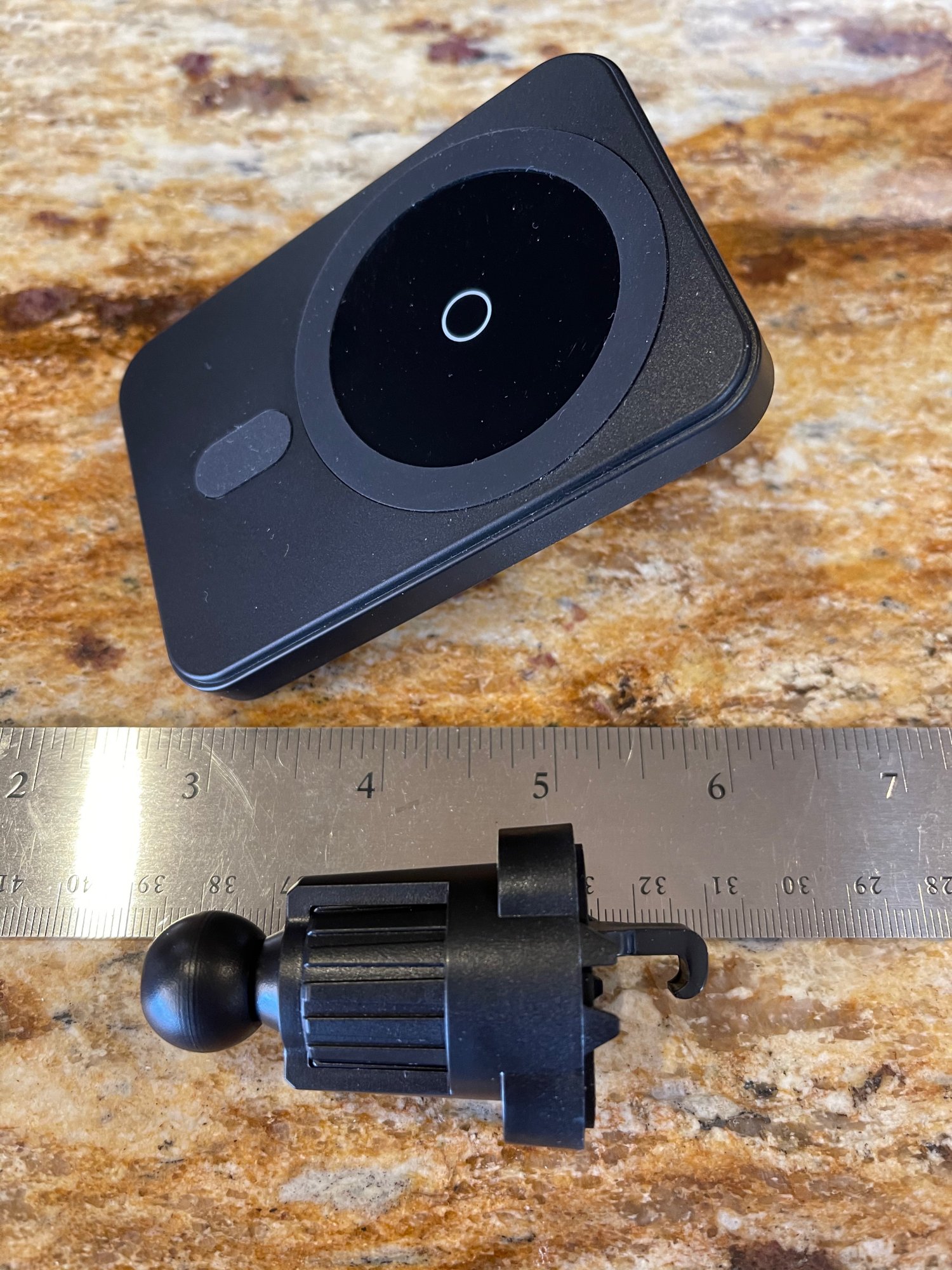

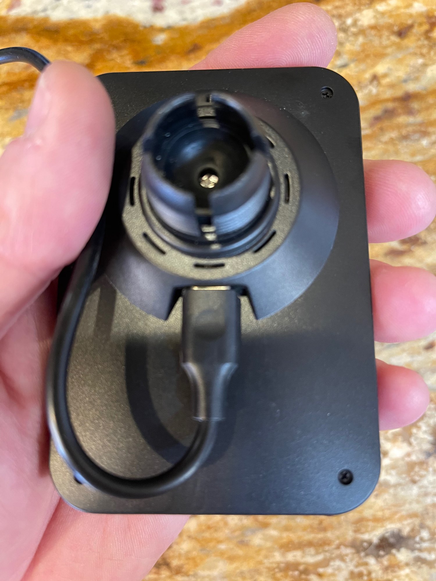

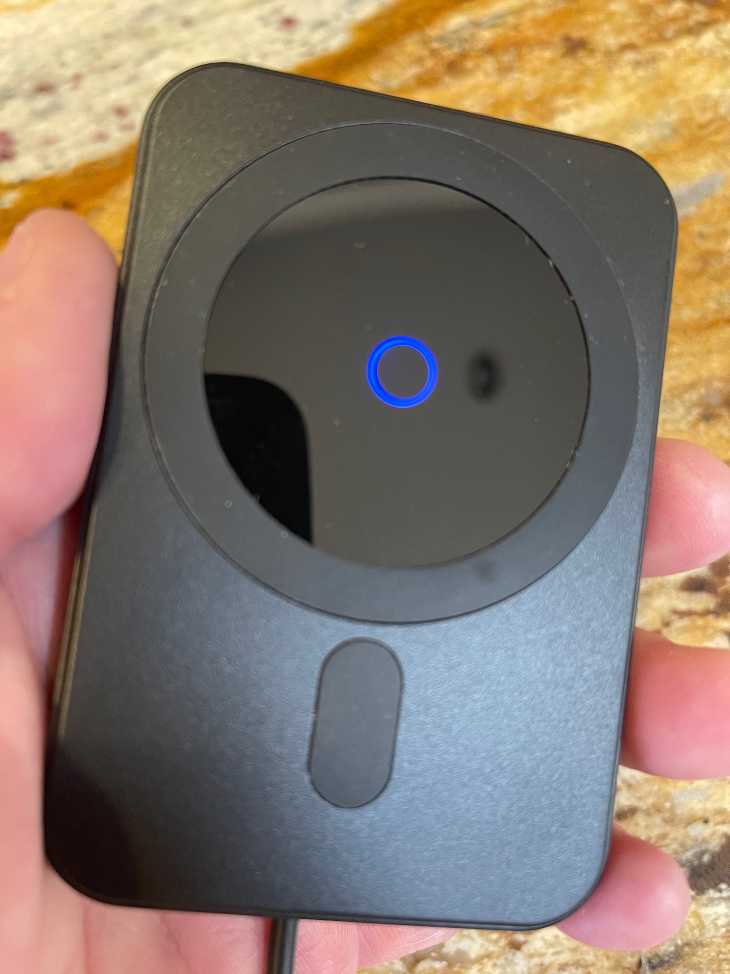

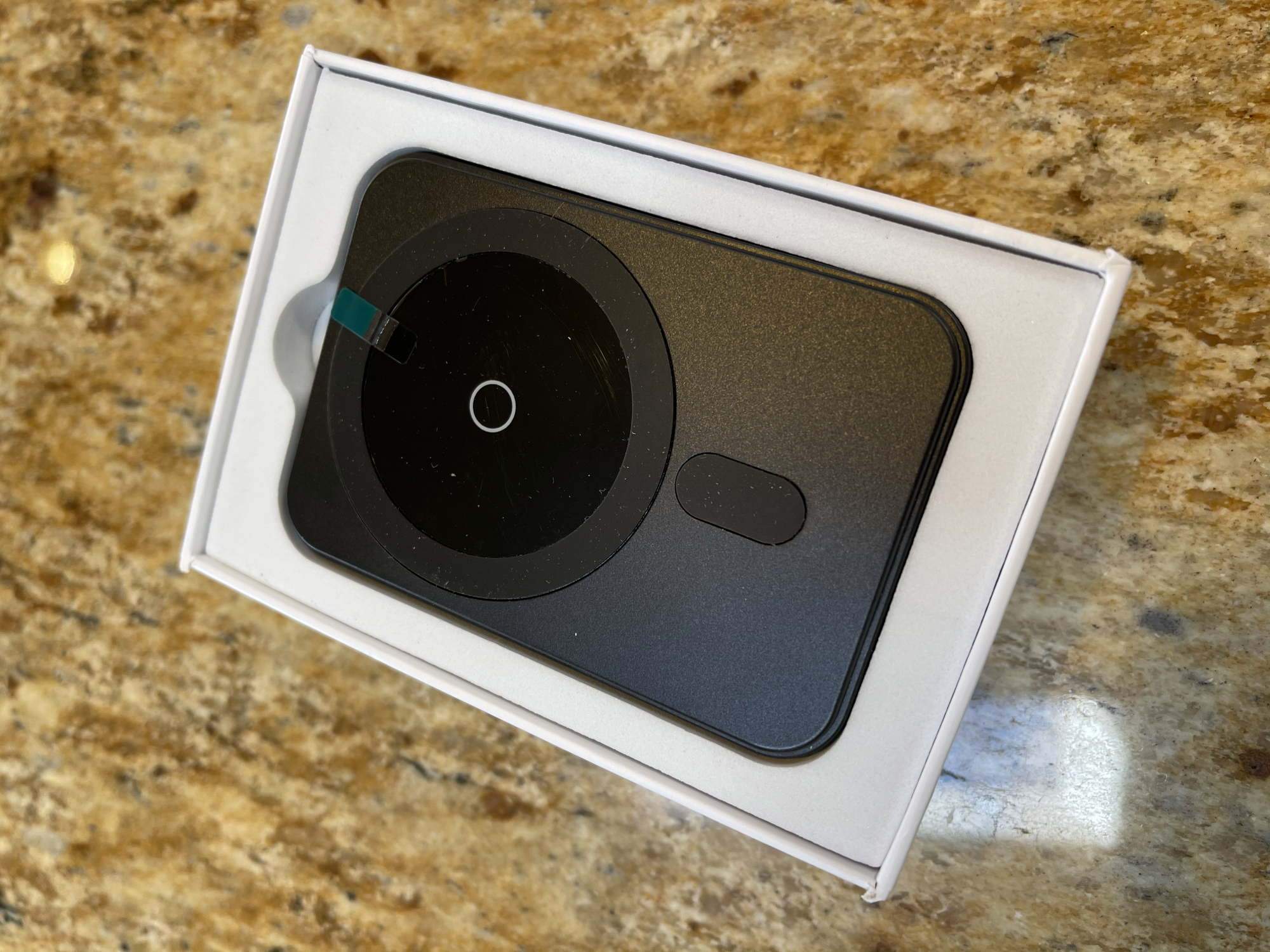

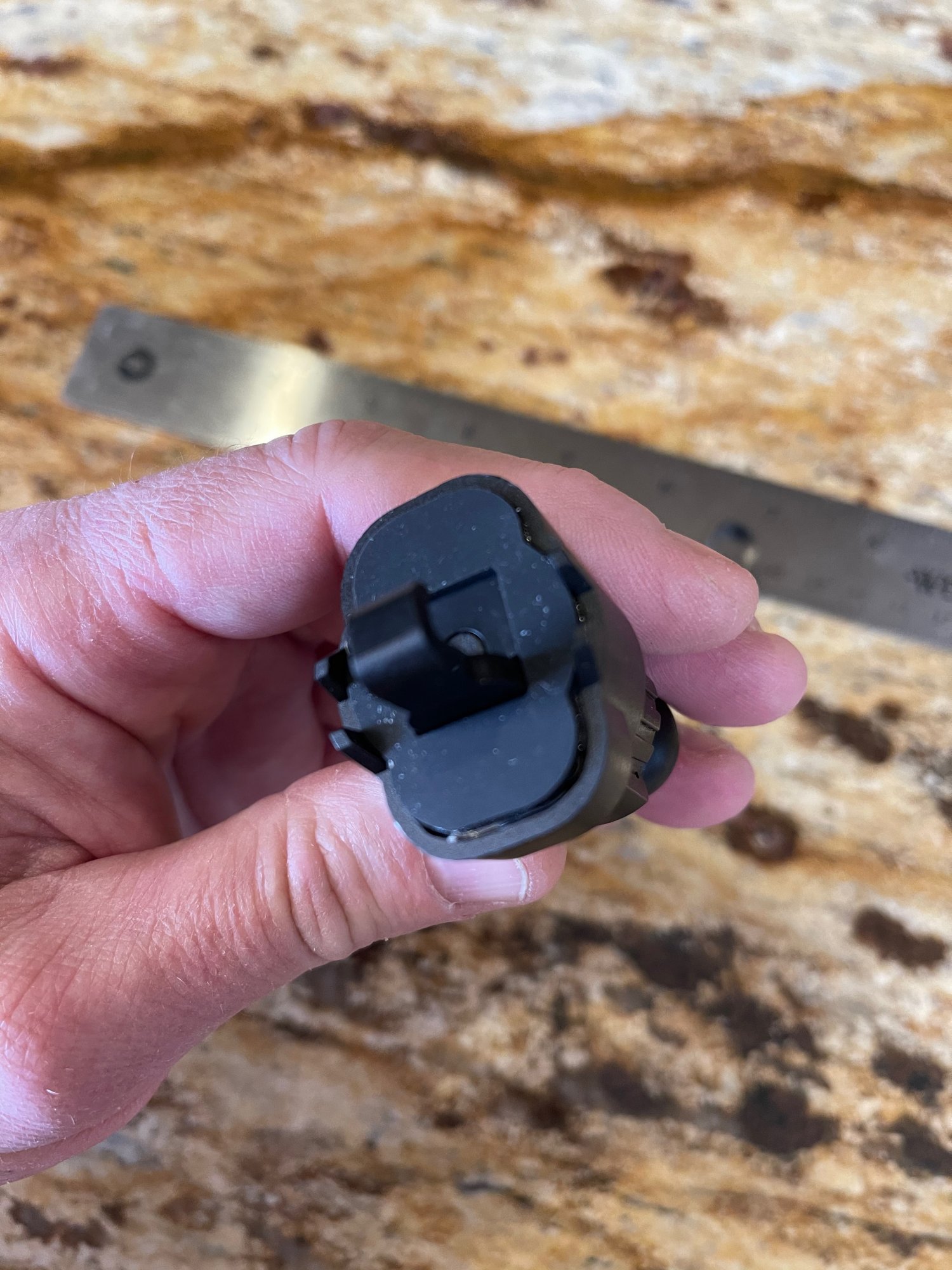

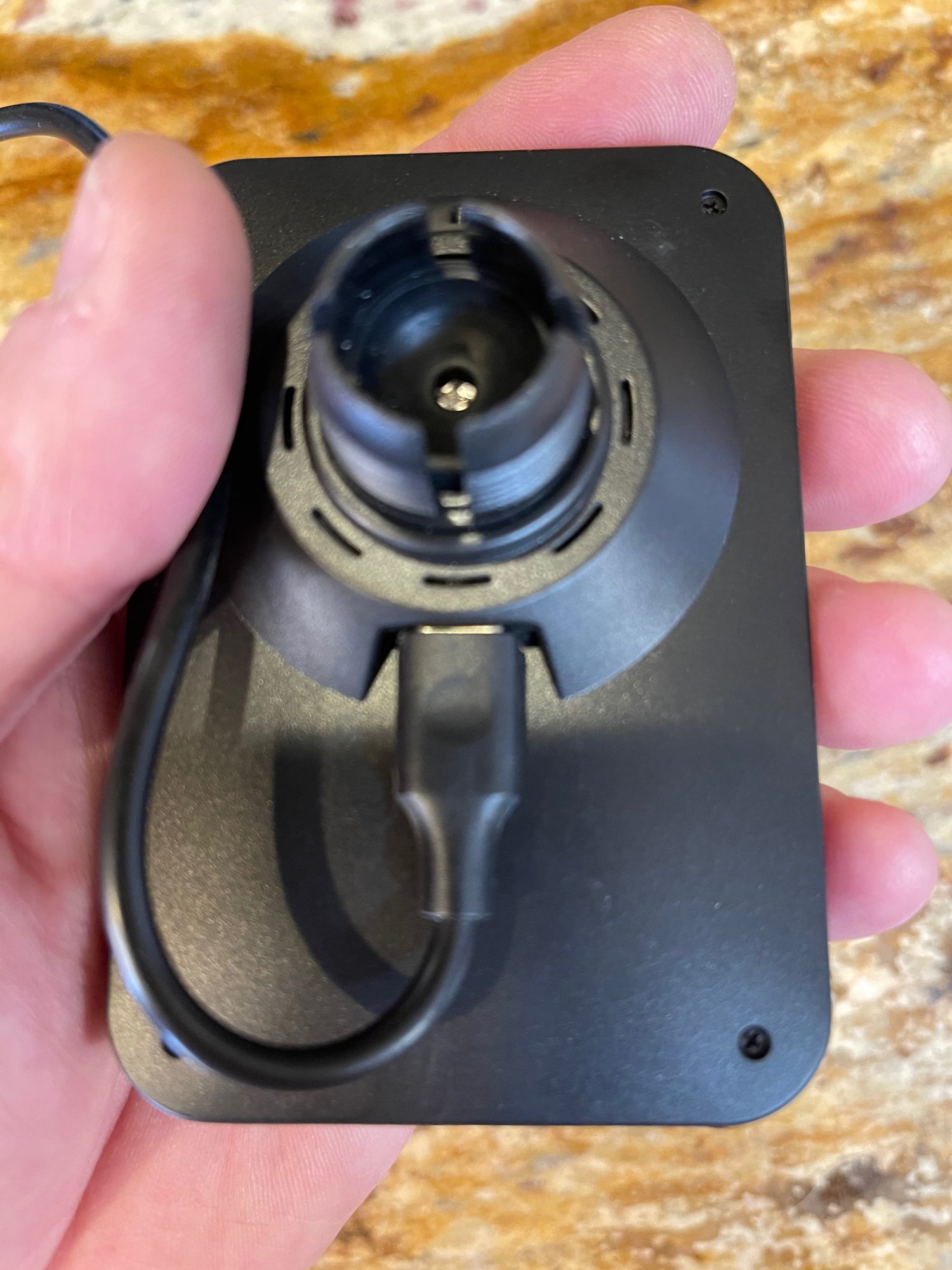

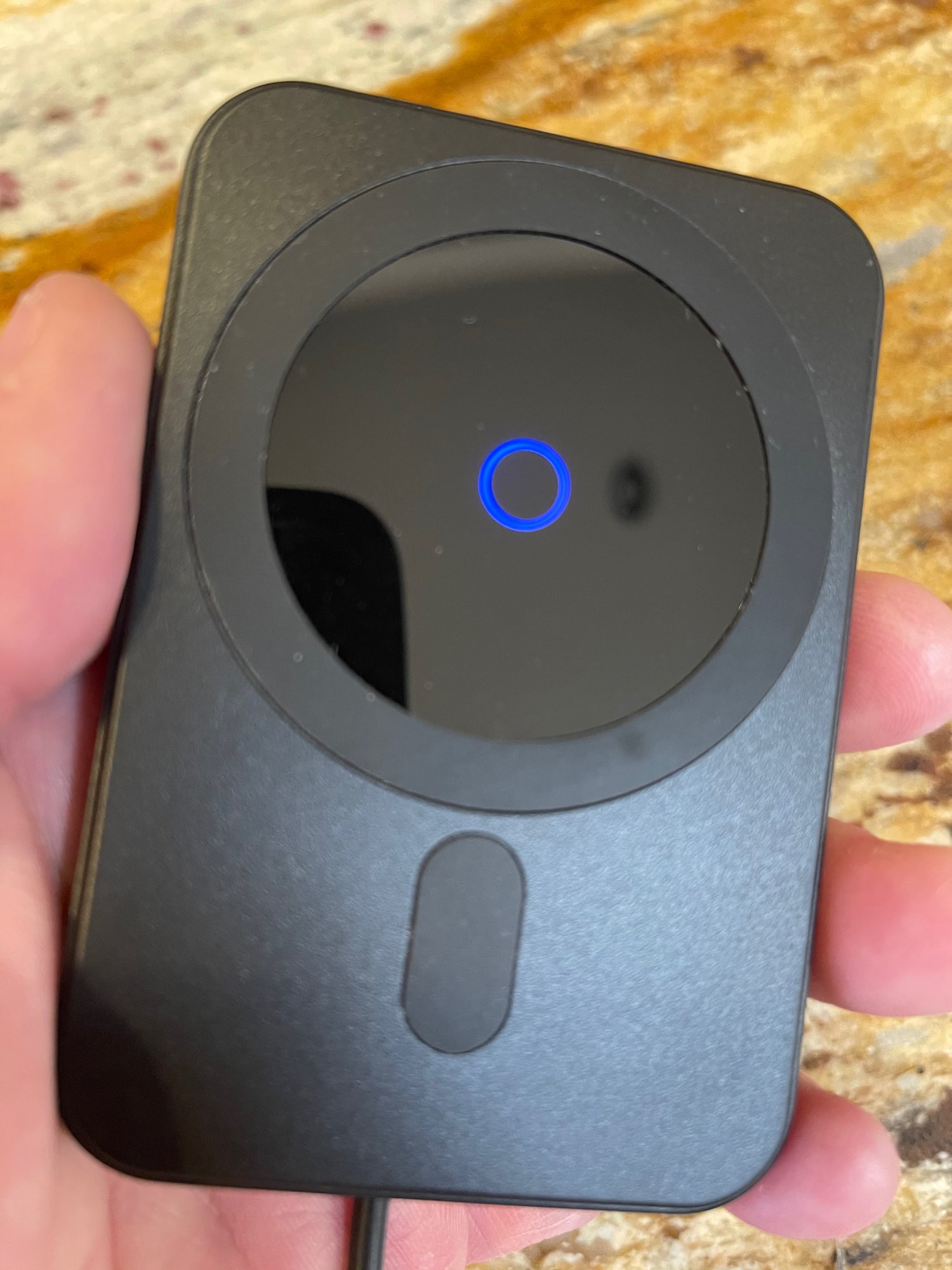

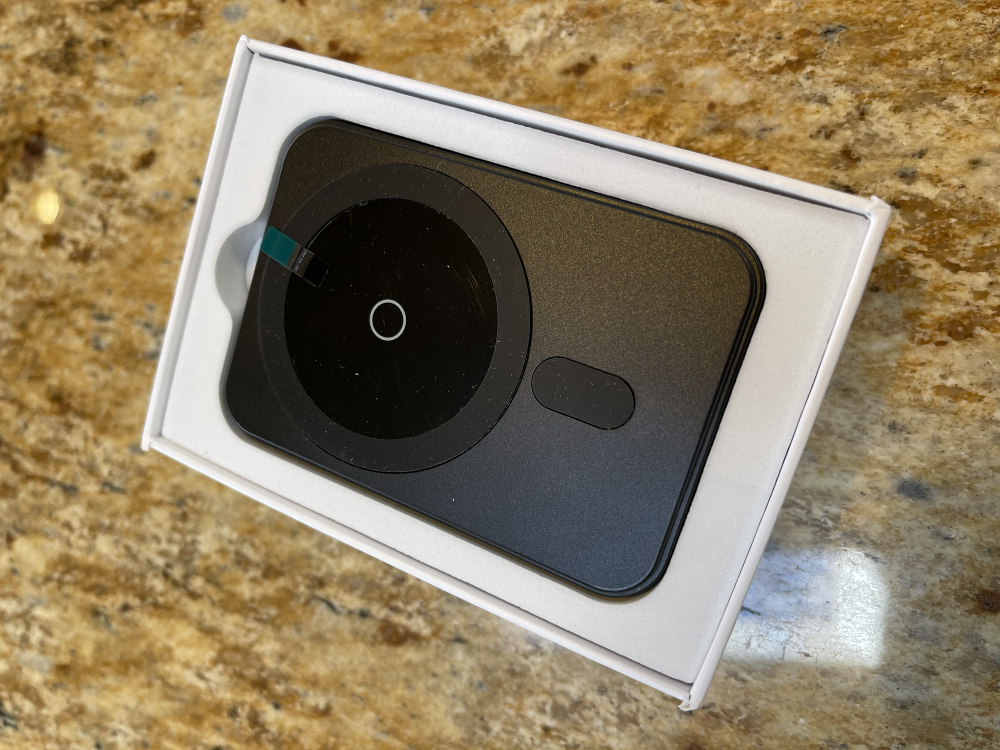

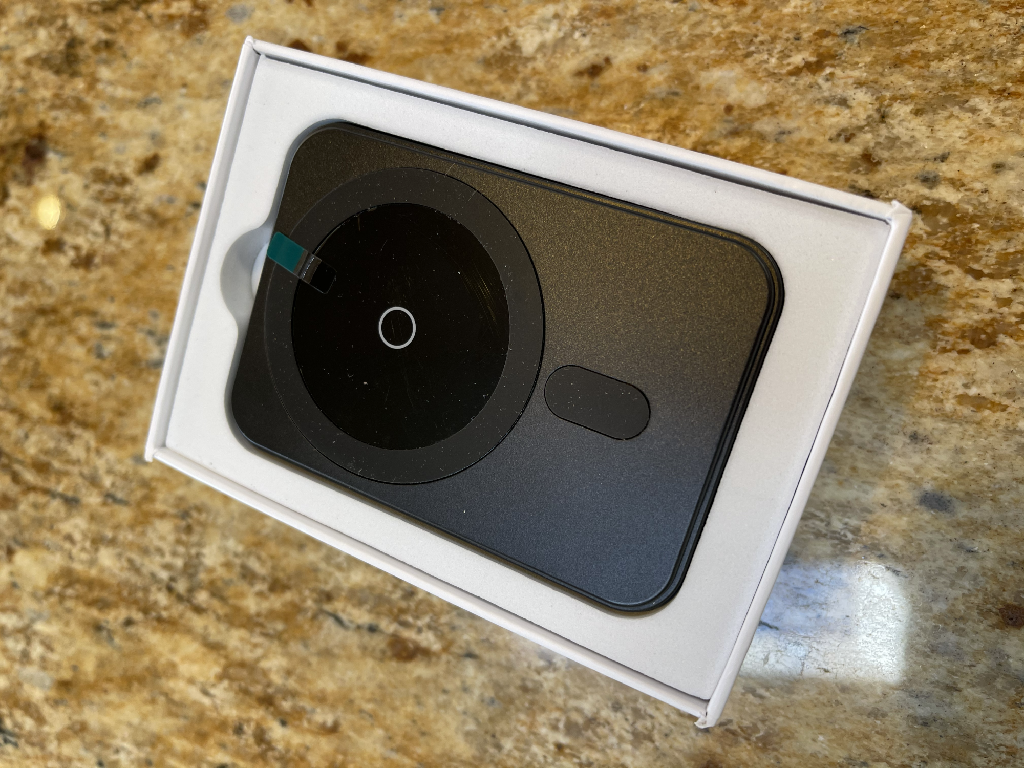

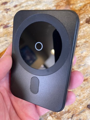

Just a quick note to let you know that I just received this charger from TIMESS on Amazon and am EXTREMELY HAPPY with the look/feel/function of it. 🥰 I have done some quick testing before installing it later this week in order to post these observations.
- The packaging and product quality looks like something Apple would offer as a 3rd party product. :apple:
- There is a satisfying grip when used with the Apple Leather Magsafe case. I have not tested w/o the case.
- it will mar the Apple Leather case with a 'polished' ring imprint, especially if you turn the iPhone horizontally while attached to the mount. This does not bother me.
- There is definitely a lower centering magnet. ❤️
- I get the magsafe attachment/charging animations when using the following (either port on the USB-C car charger)...
https://www.amazon.com/gp/product/B08G1LJ1M6
https://www.amazon.com/gp/product/B088NRLMPV
...an Apple OEM cable also gives the animations with the same charger.

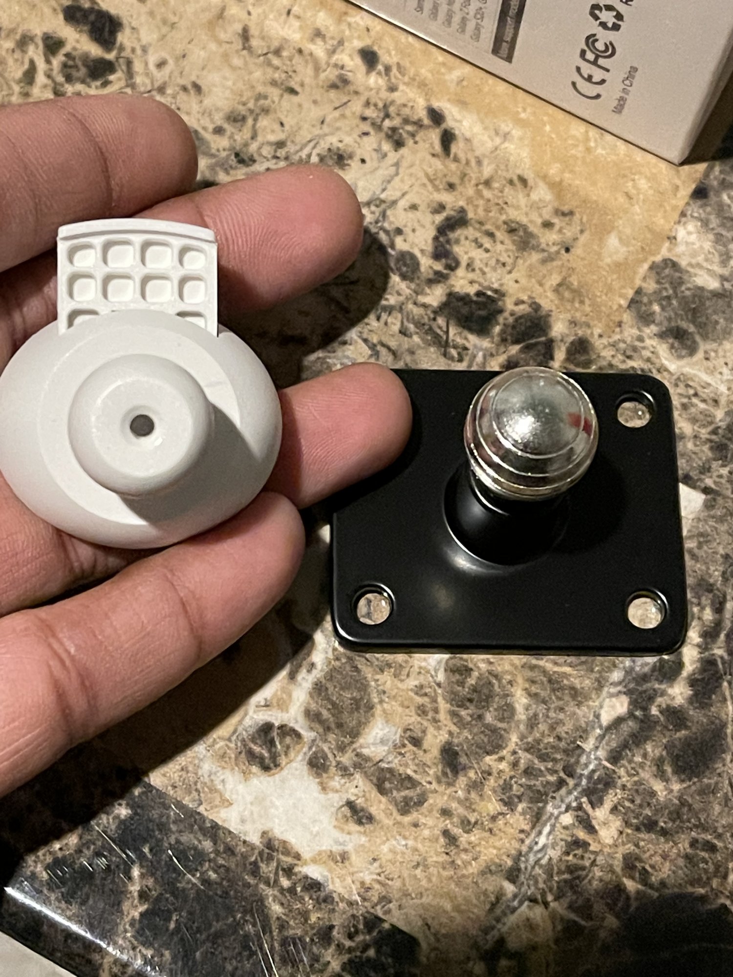

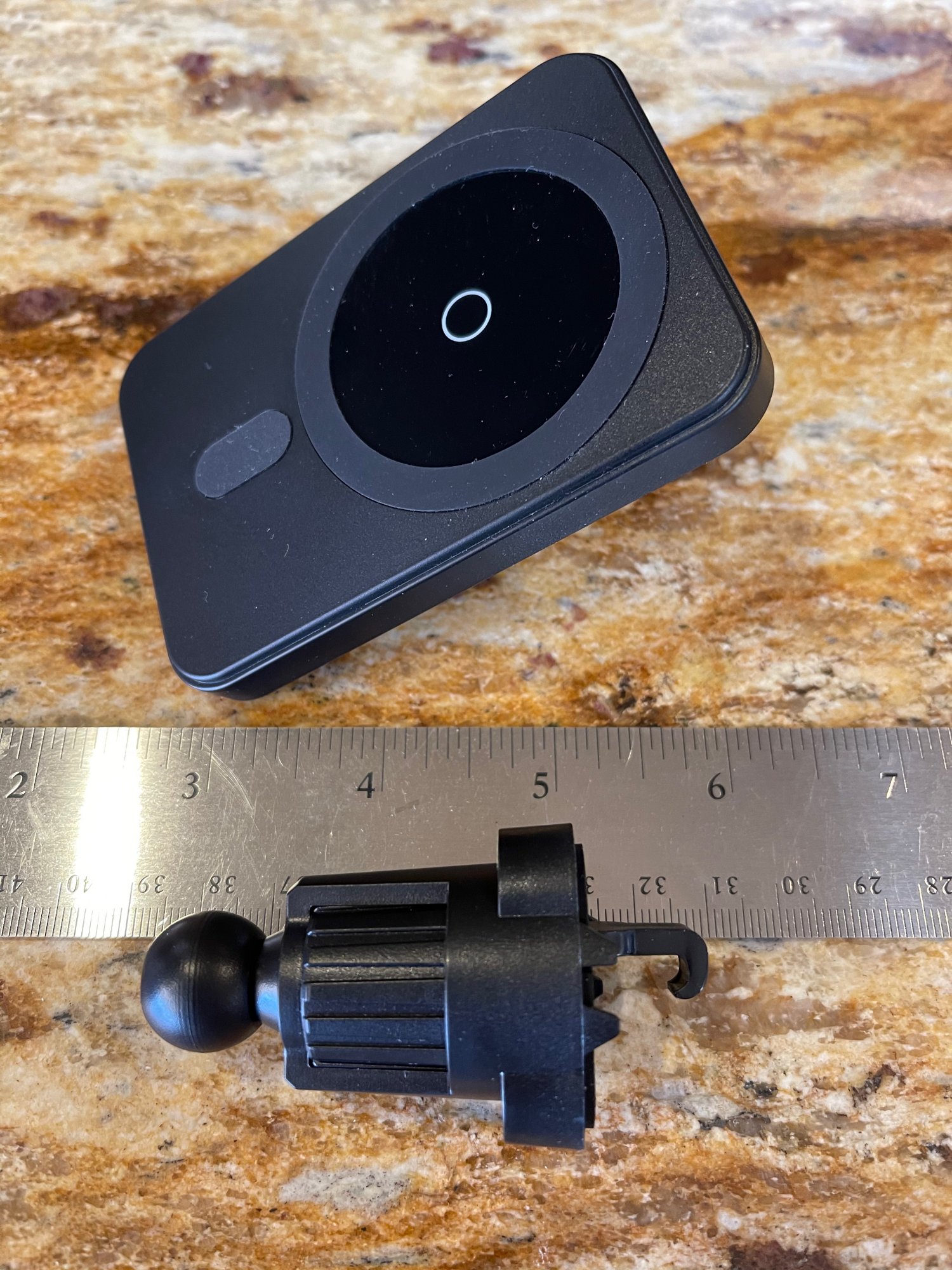

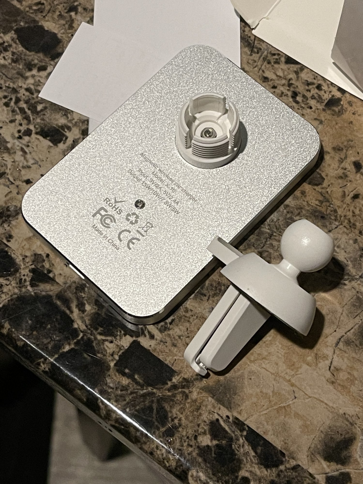

- The ball mount is 17mm.
- The thickness of the mount is comparable to the iPhone w/leather case. It does not seem too thick. It seems right.
The included vent mount looks like it will hold the phone closer to the dash than the low profile ball I was planning on adding to my existing ProClip mount(s). I'm leaning towards using the included vent mount at this point. ANY vibration, or optimal phone positioning might cause me to change my mind.
Hopefully long term use proves this to be a reliable product. Many thanks to the contributors on this thread who helped me come up with the best solution for me. 🙂

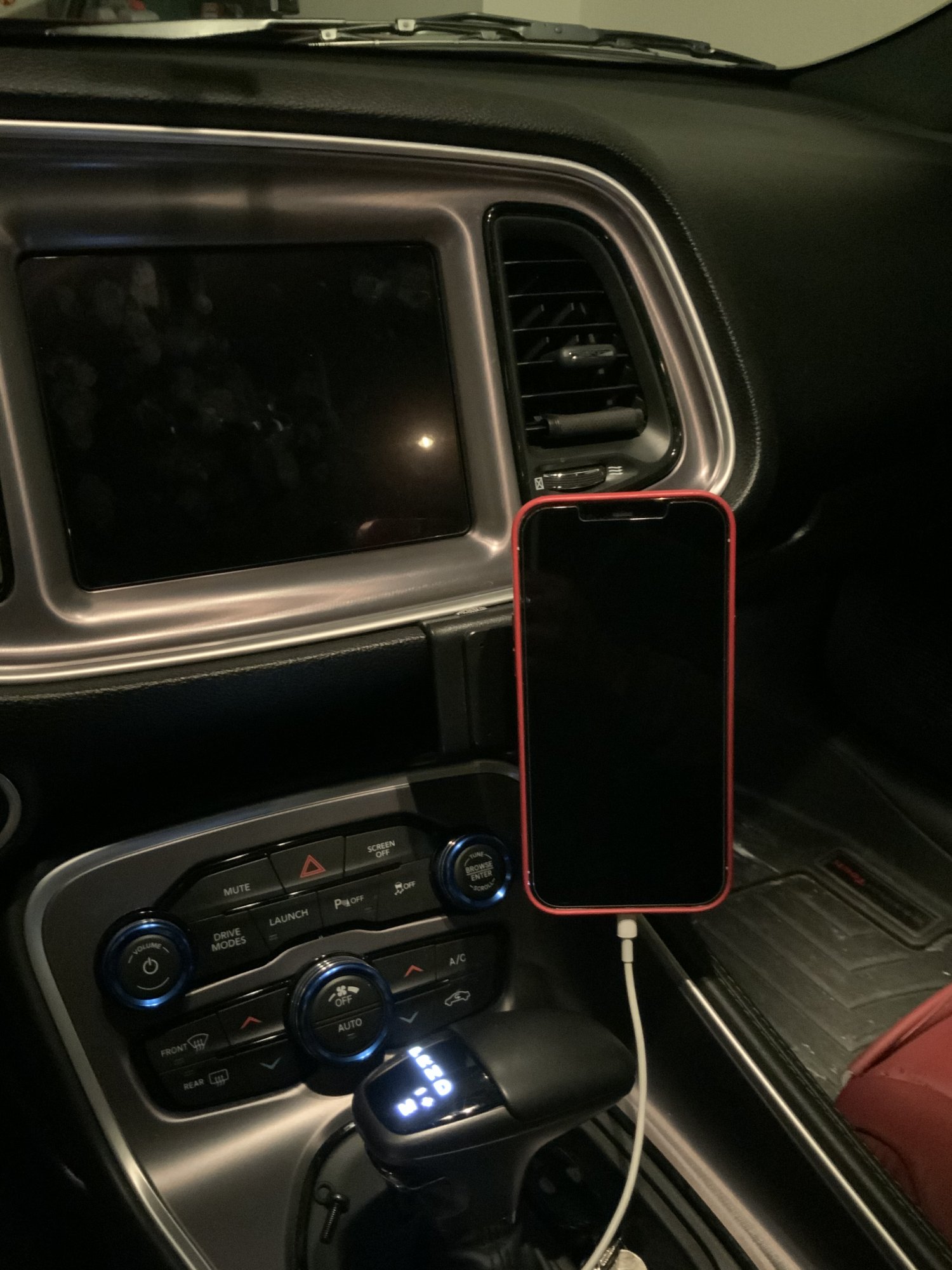

Update: I used the smaller non-interchangeable ball magnet near my car touchscreen and works great! It appears to be the same adhesive that was on my dashcam mount that I used in a previous car for a year, and the adhesive popped off with the mount leaving no residue. I guess we will see years down the road if I have to remove it again. Might not update you though.

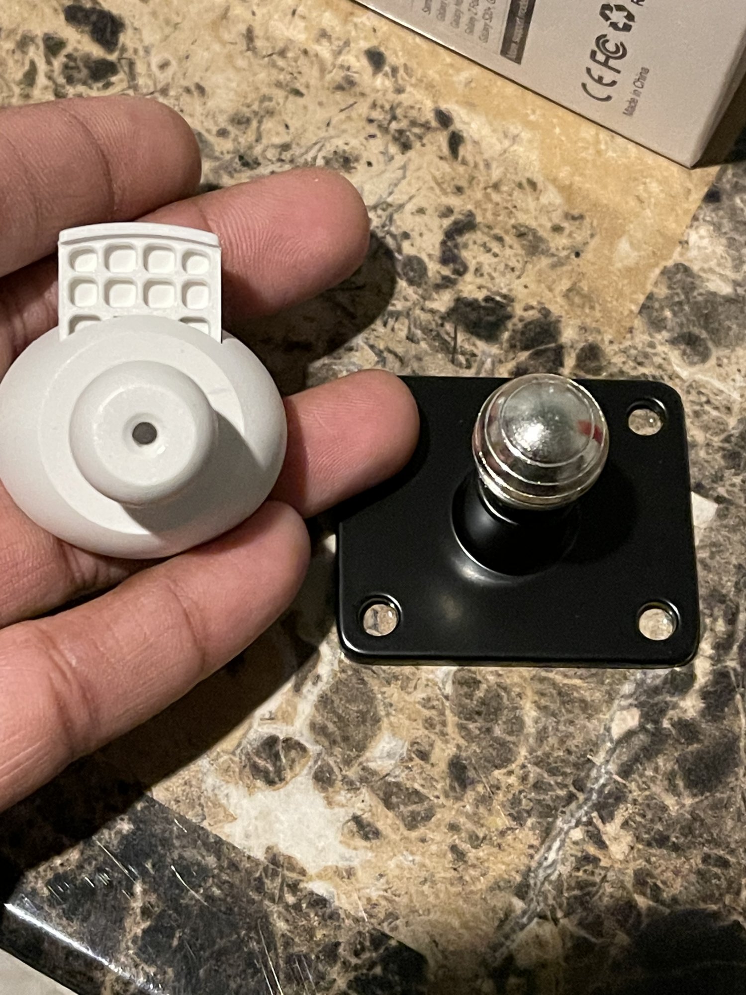

I put the round steel adhesive plate that came with the FITFORT holder on the back of the ZDAGO charger and the combo holds my 12 Pro just fine. I'm using a leather case with embedded MagSafe magnets but it's not the official Apple case.
The phone comes off of the charger with a simple tug and the charger stays where its supposed to.

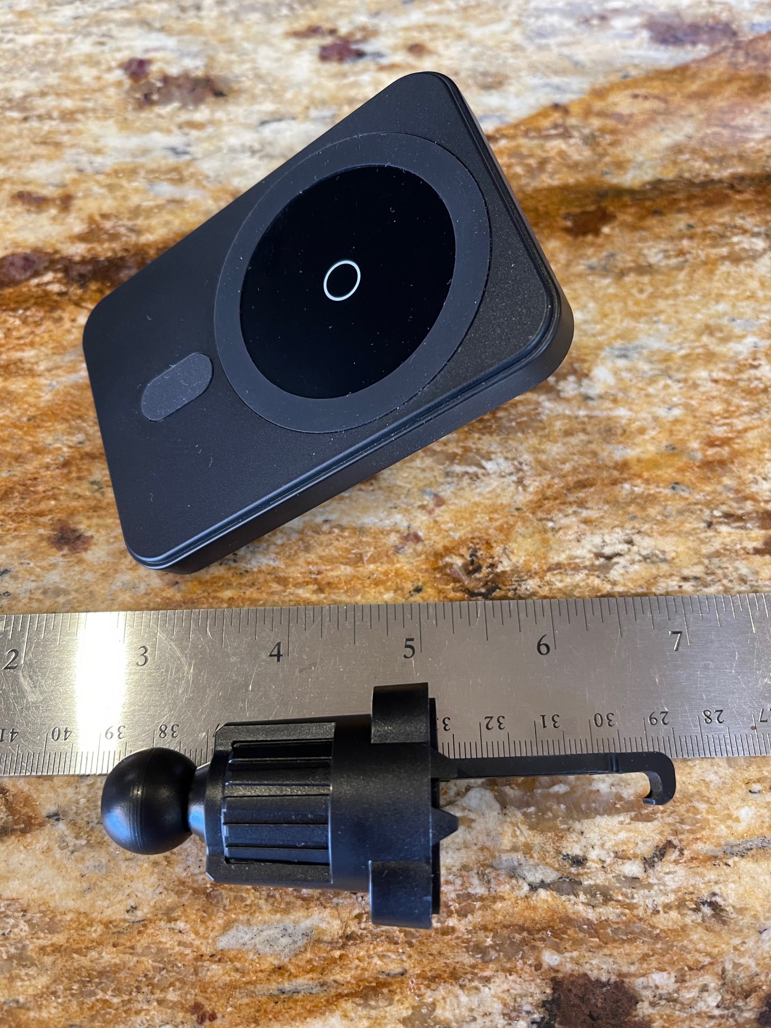

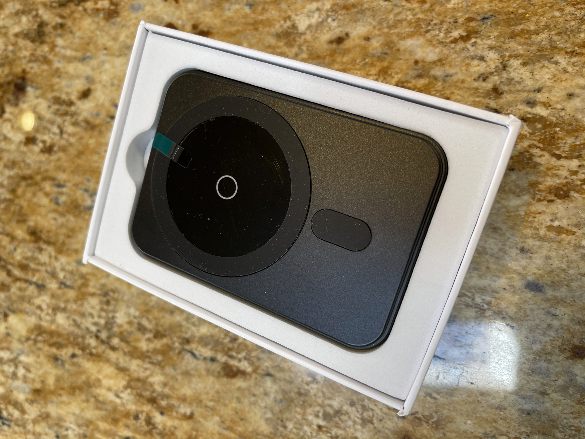

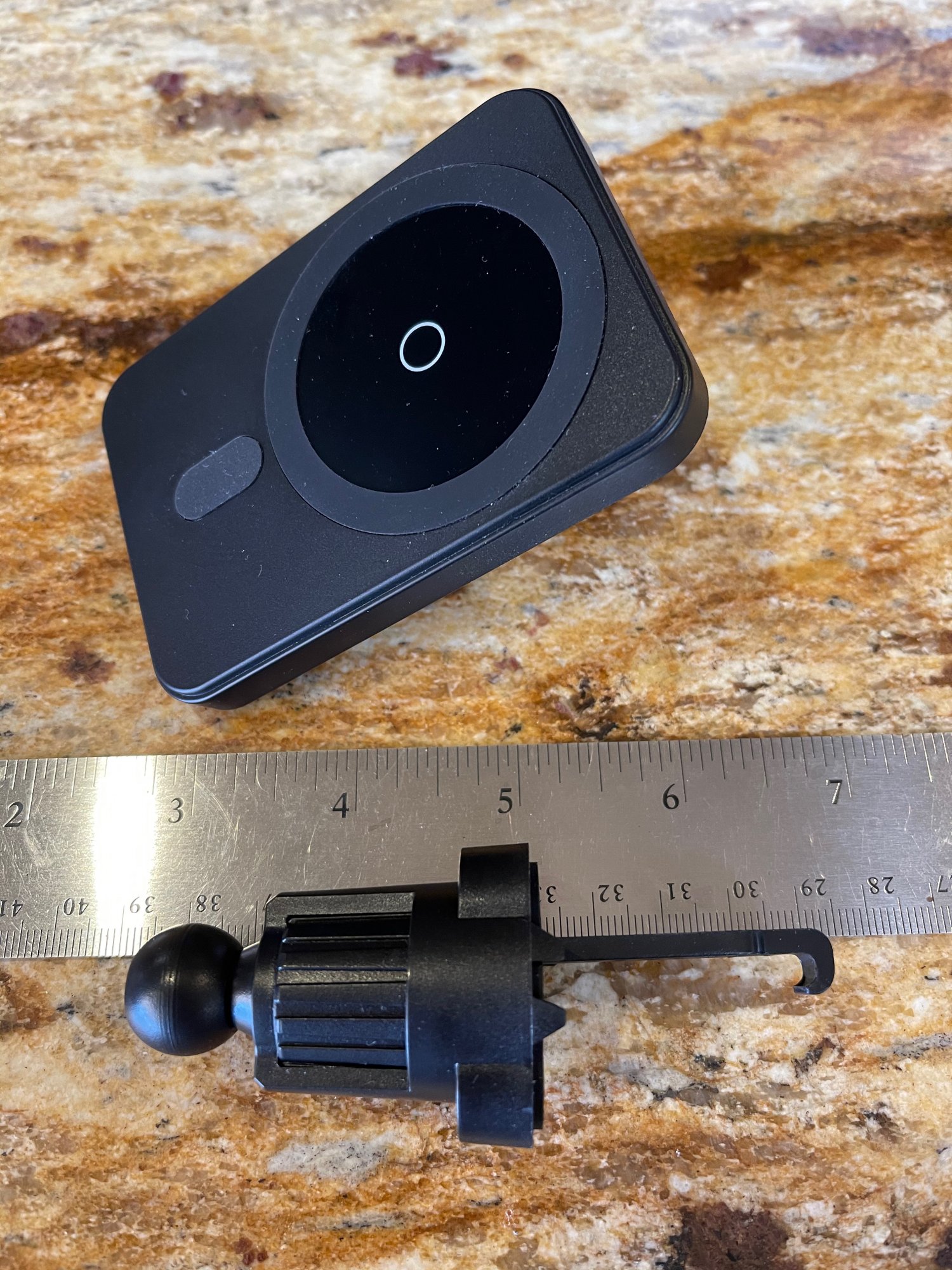

View attachment 1699393View attachment 1699396
PS - I ordered two of these from 2 different vendors on Amazon. Both were supposed to be here by tomorrow. I was just notified that the second vendor can't deliver until end of January. 😱 So I cancelled that order and ordered a second from TIMESS, which is promised to be here in 2 days (regular PRIME shipping). ❤️🤞🤞

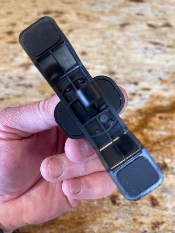

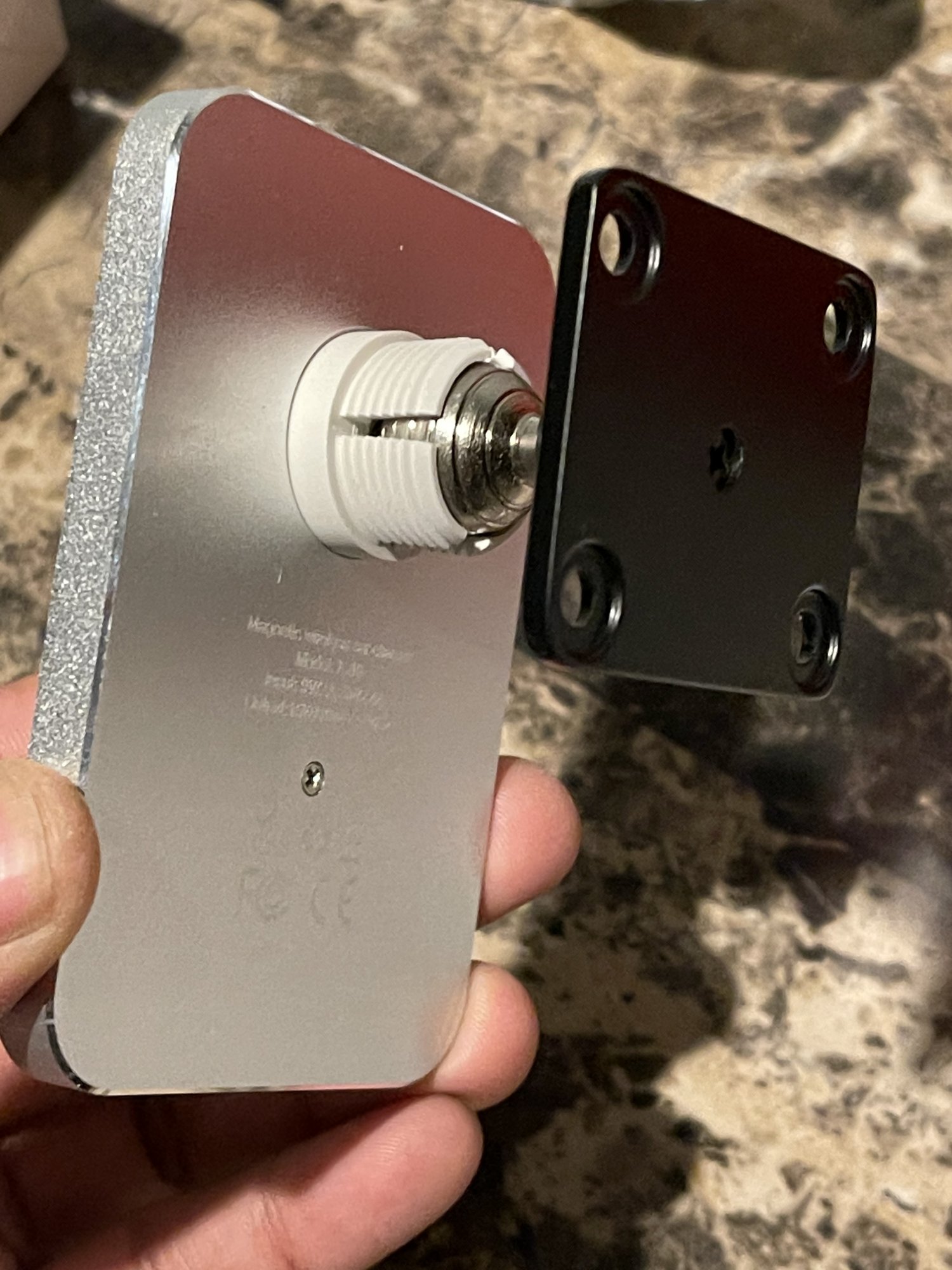

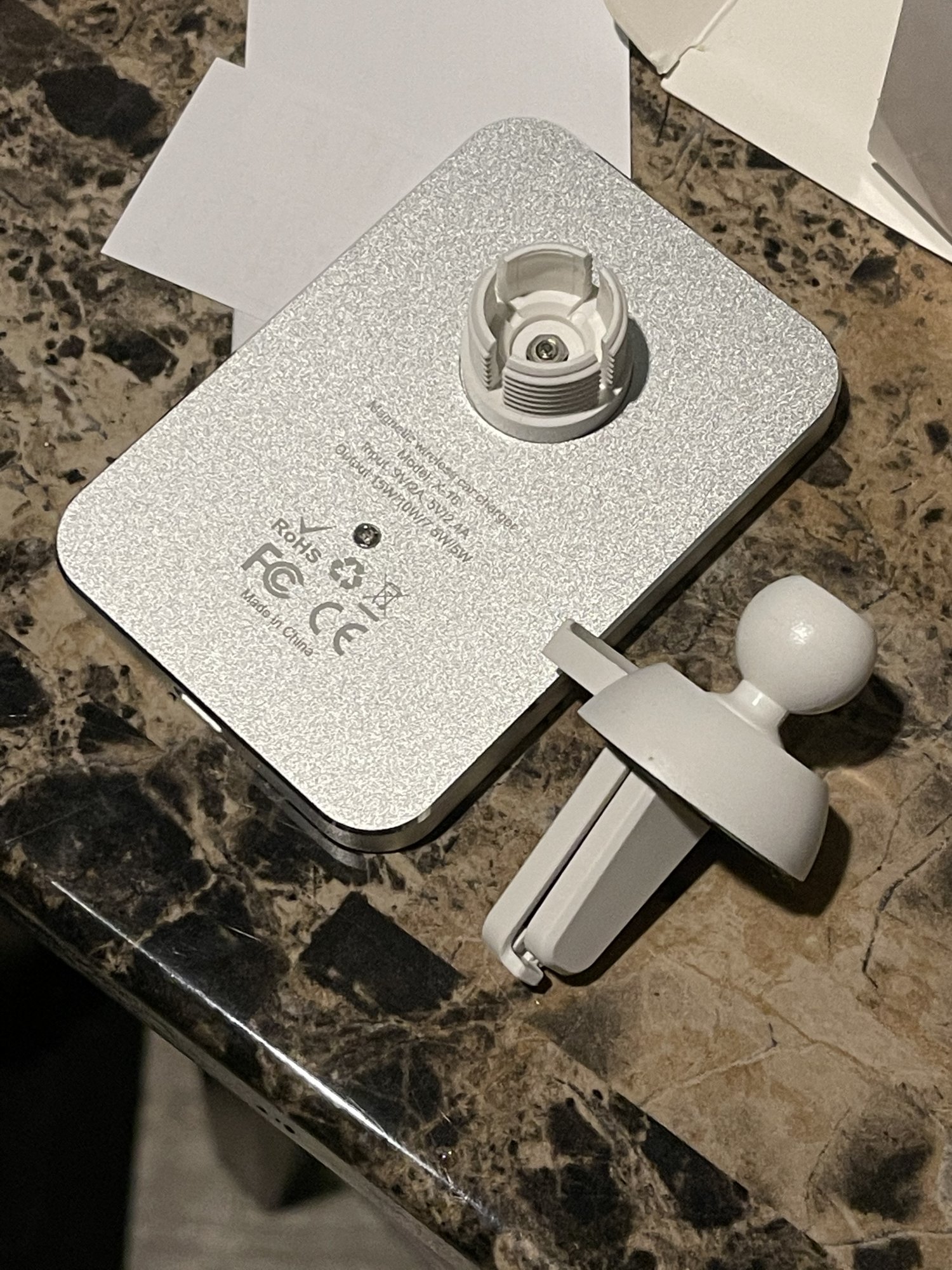

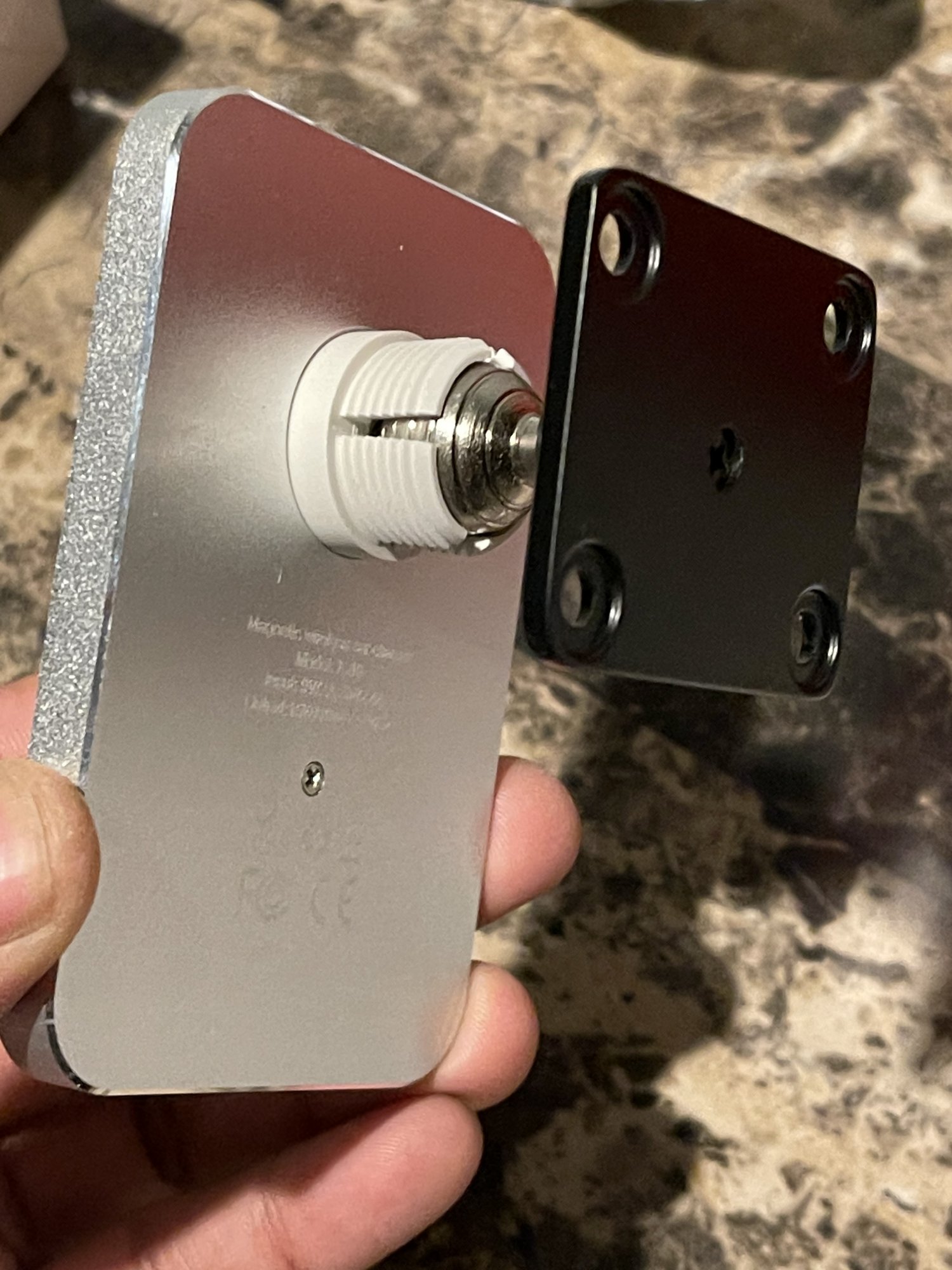

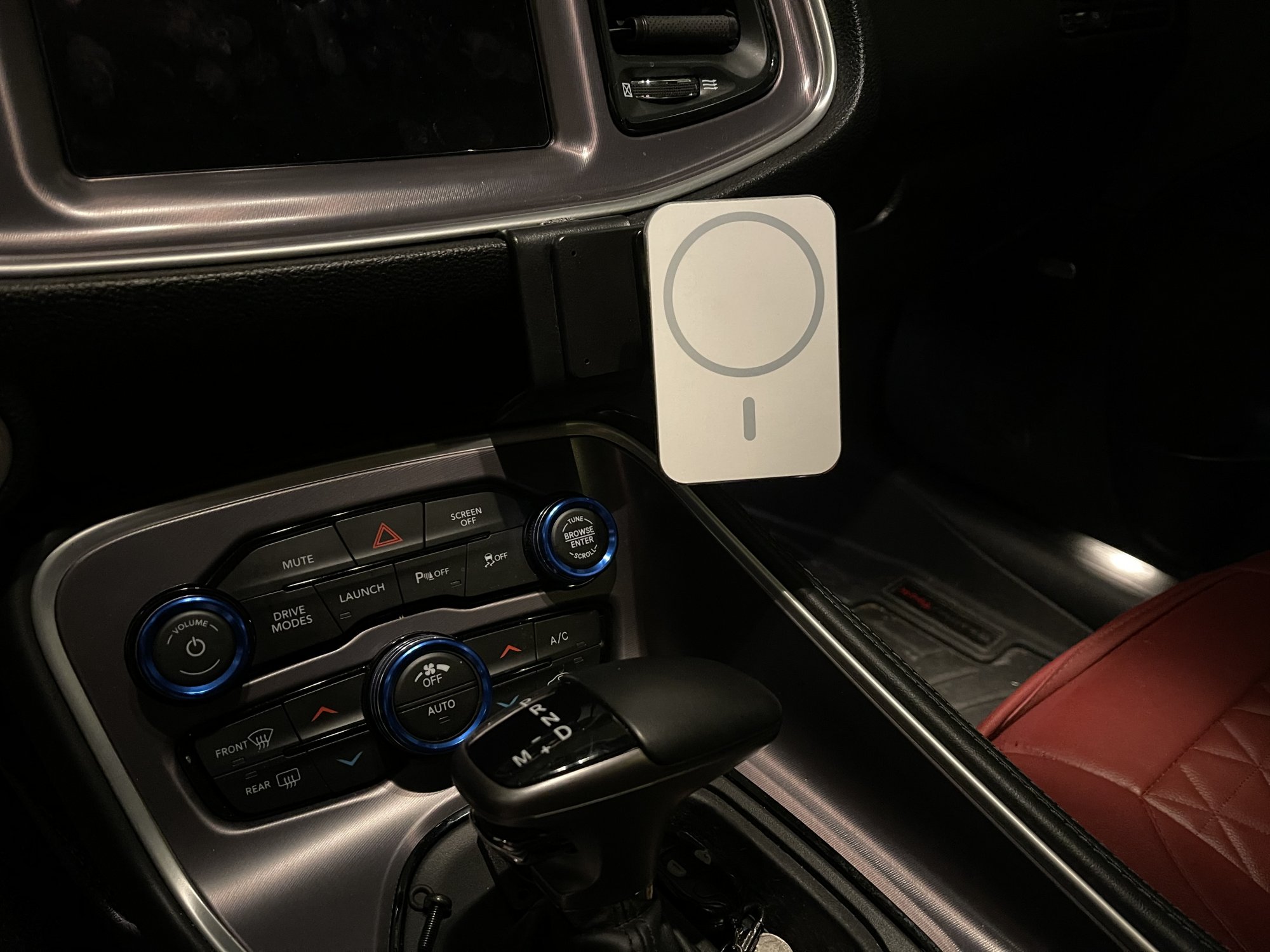

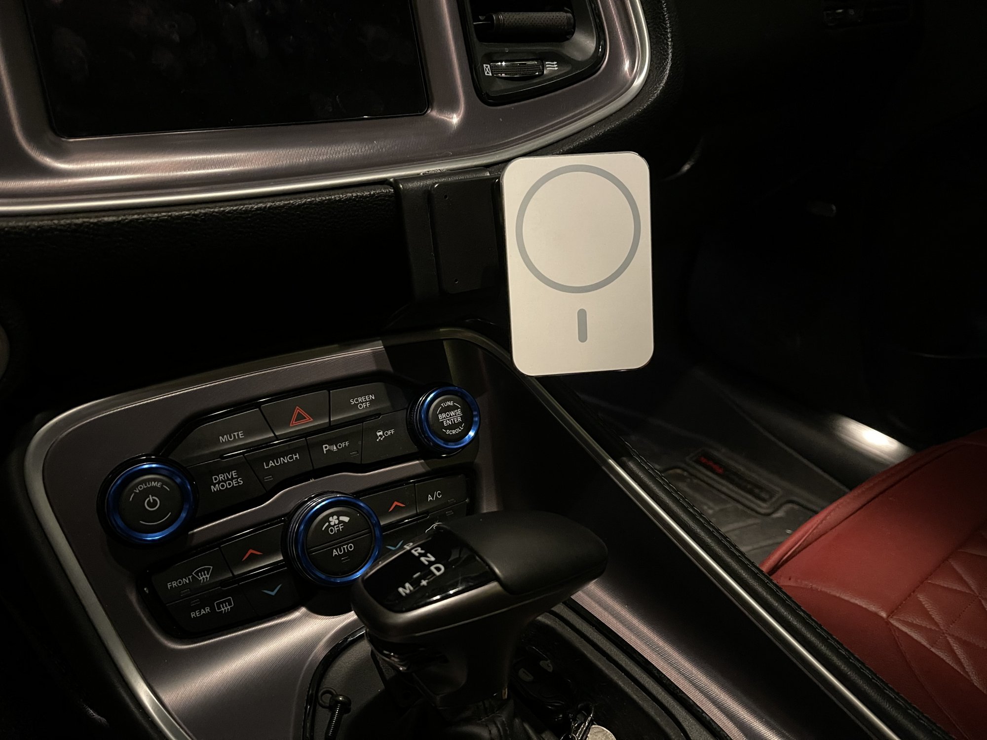

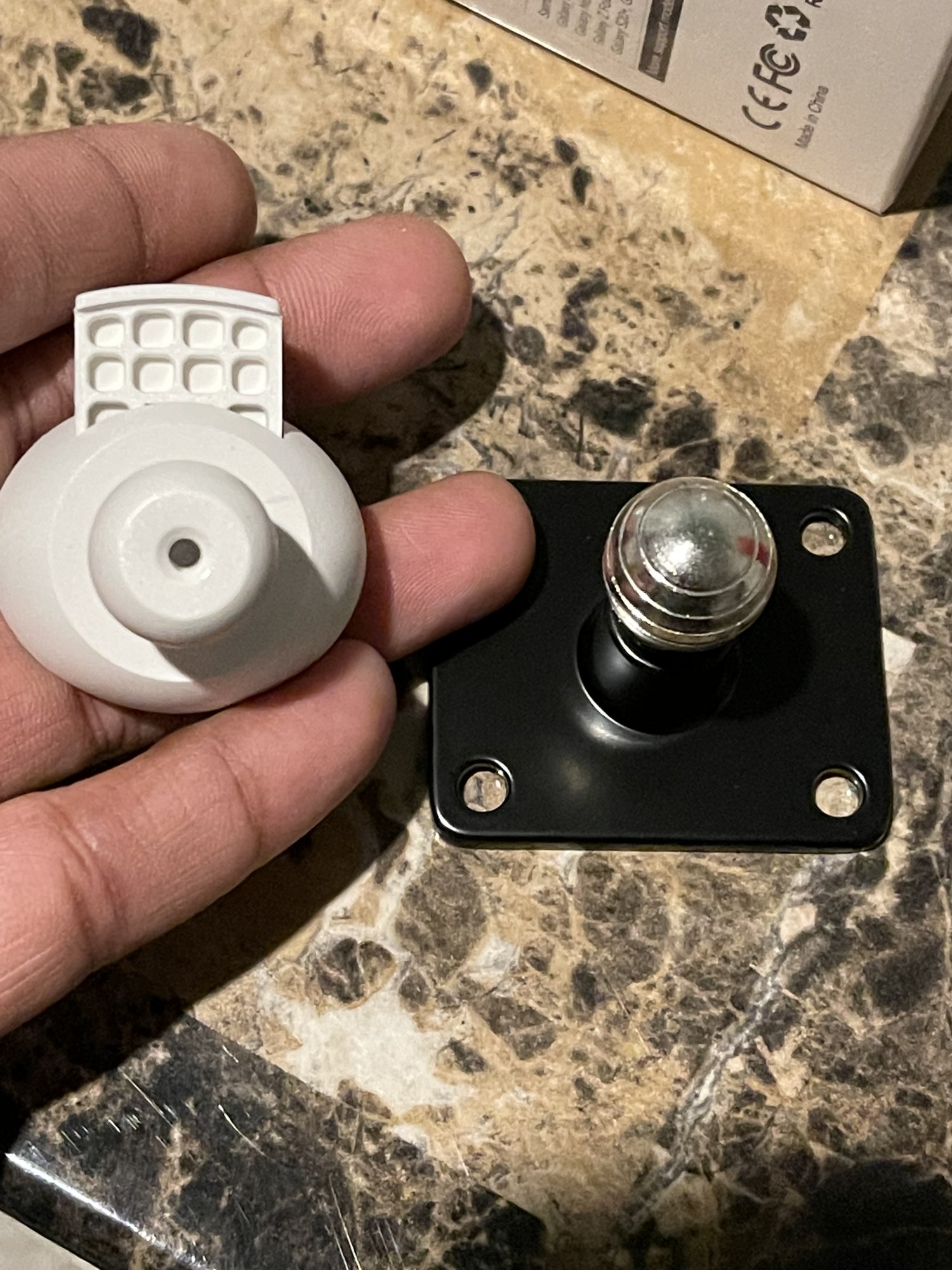

So I finally got the Chinese car mount. Was glad to see it fit the 17mm ball AMPS adapter. Installation was simple and this path is cheaper than the alternatives. (Around $20 give or take). Pretty satisfied with the integration with the Proclip. The magnets seem strong enough to do the job. Don't care about the charging since I use wired CarPlay.
Before
After

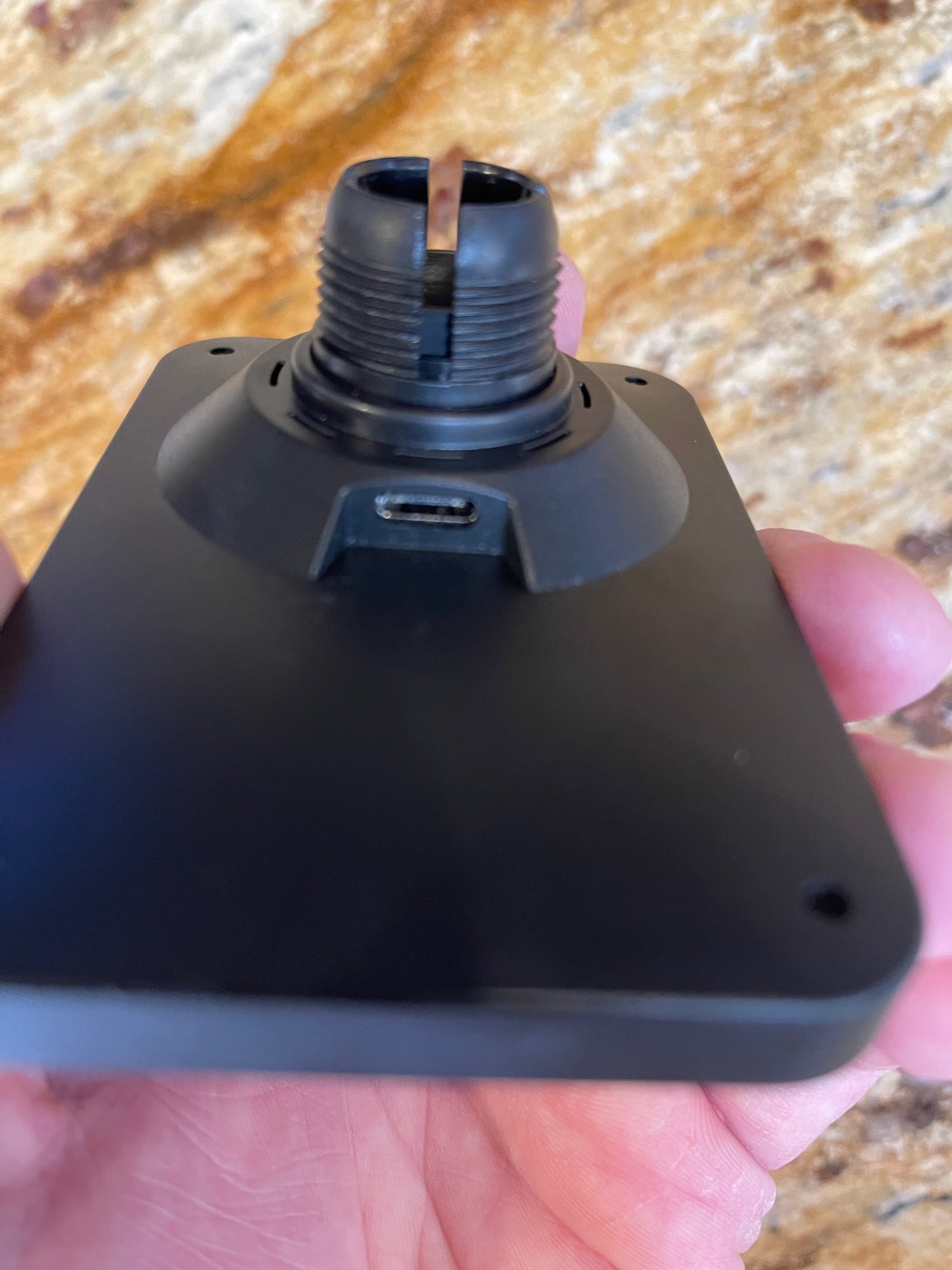

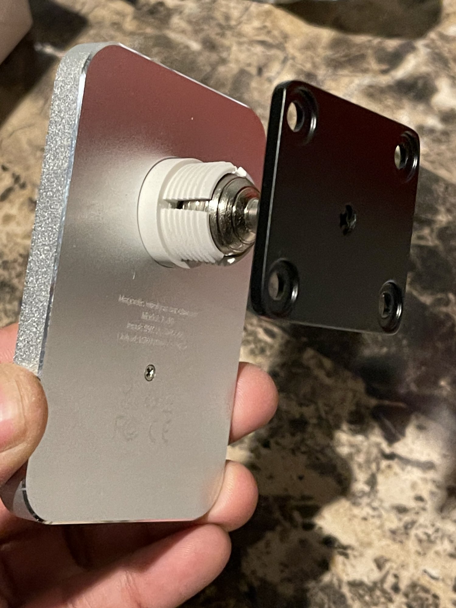

Hi, do you know if you can remove the plastic circular fixation?
There is a screw
Because i want to use as Magsafe charger (although i know its not really quick charge at Magsafe speed)
Thanks

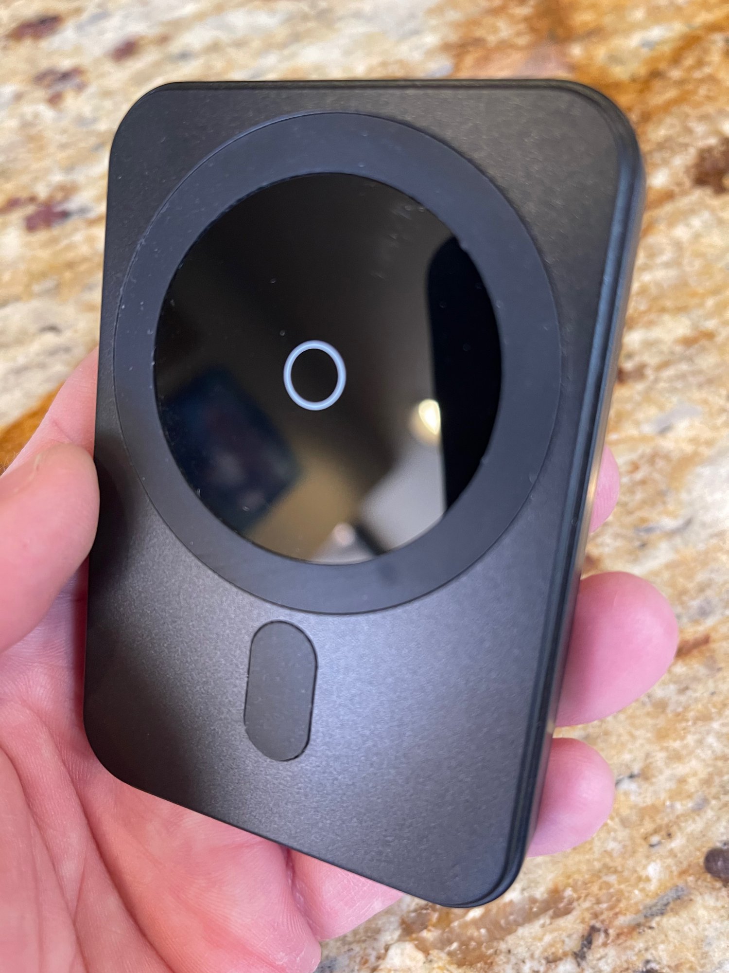

Can you take a few more pictures of it? Those are the ones I have coming soon also. How’s the back where the cable plugs in? Also how is the vent adjustment thing look? Is the front of that a textured black plastic?
These look Great to me. Like the Belkin but black and with a hidden cable. Seems like a better vent clip if it actually adjusts the holding part to lock onto the back of the vent.

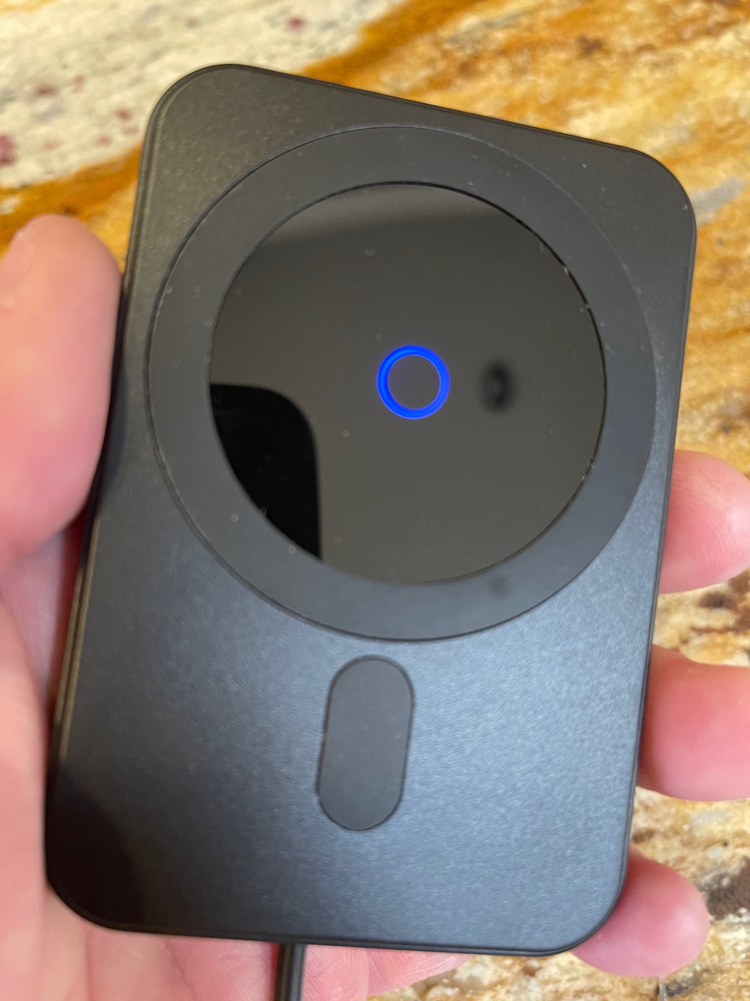

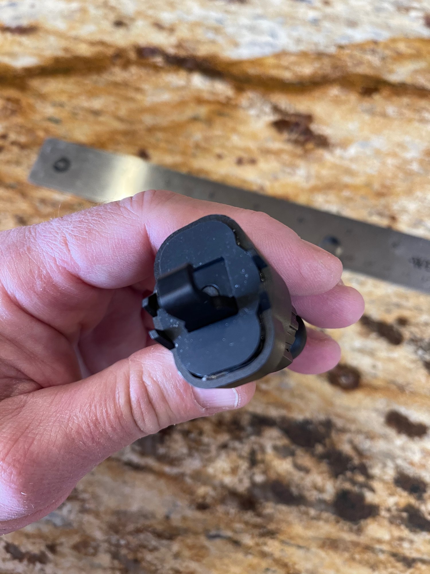

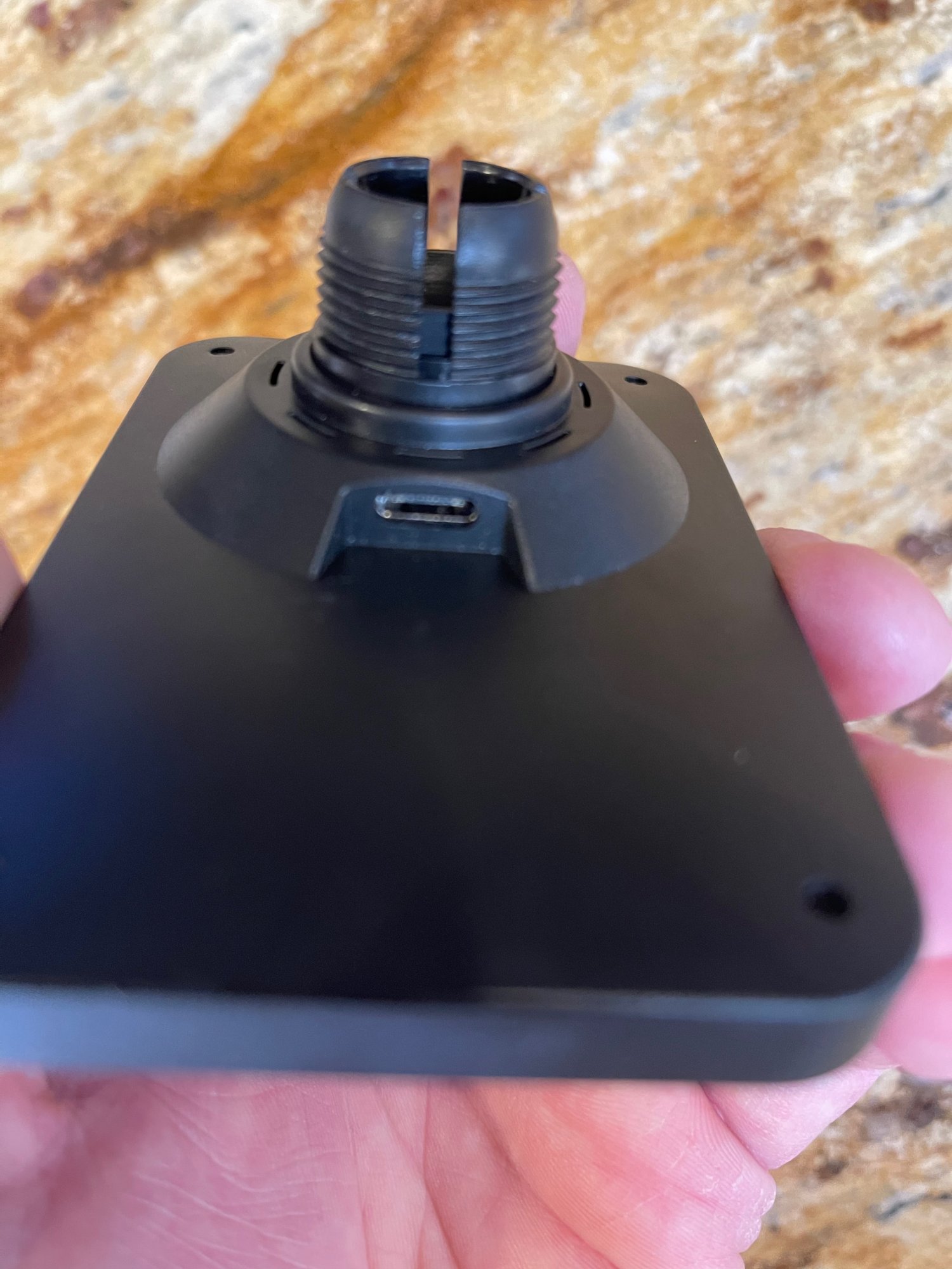

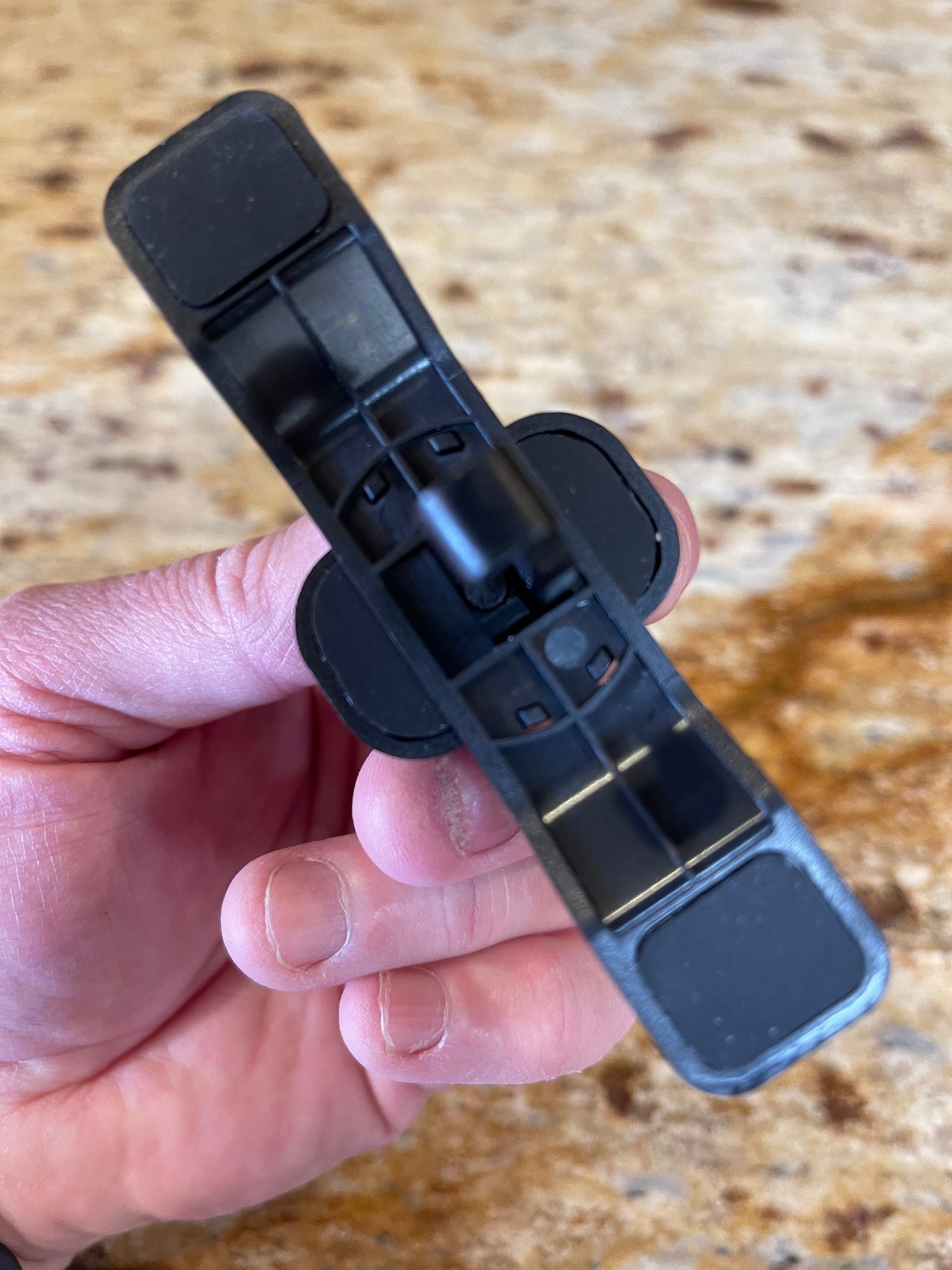

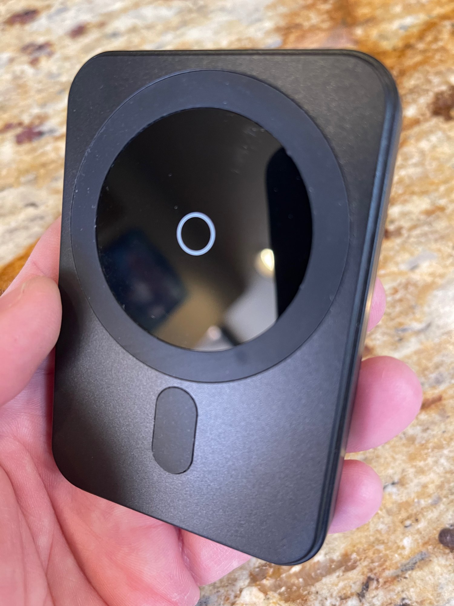

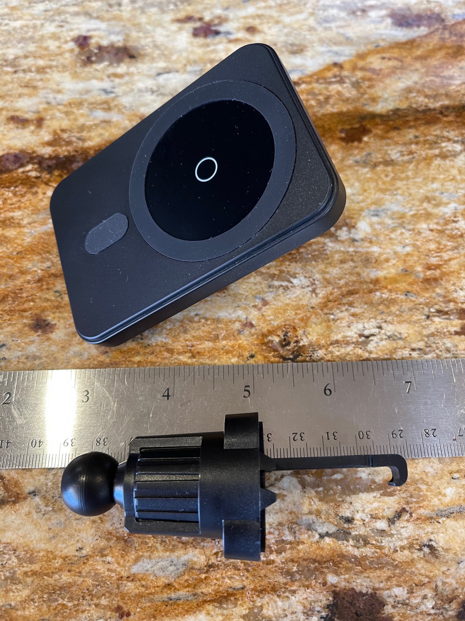

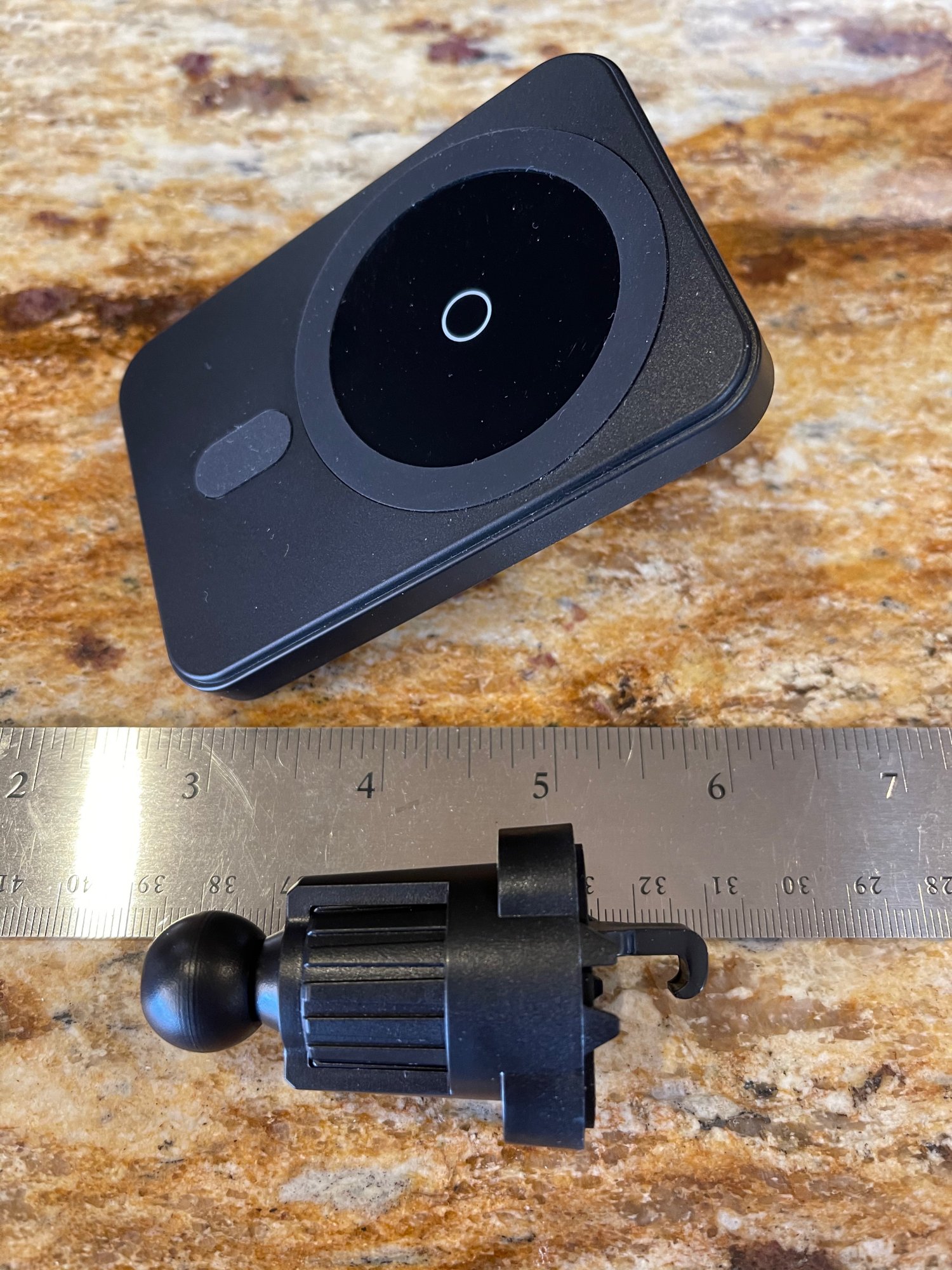

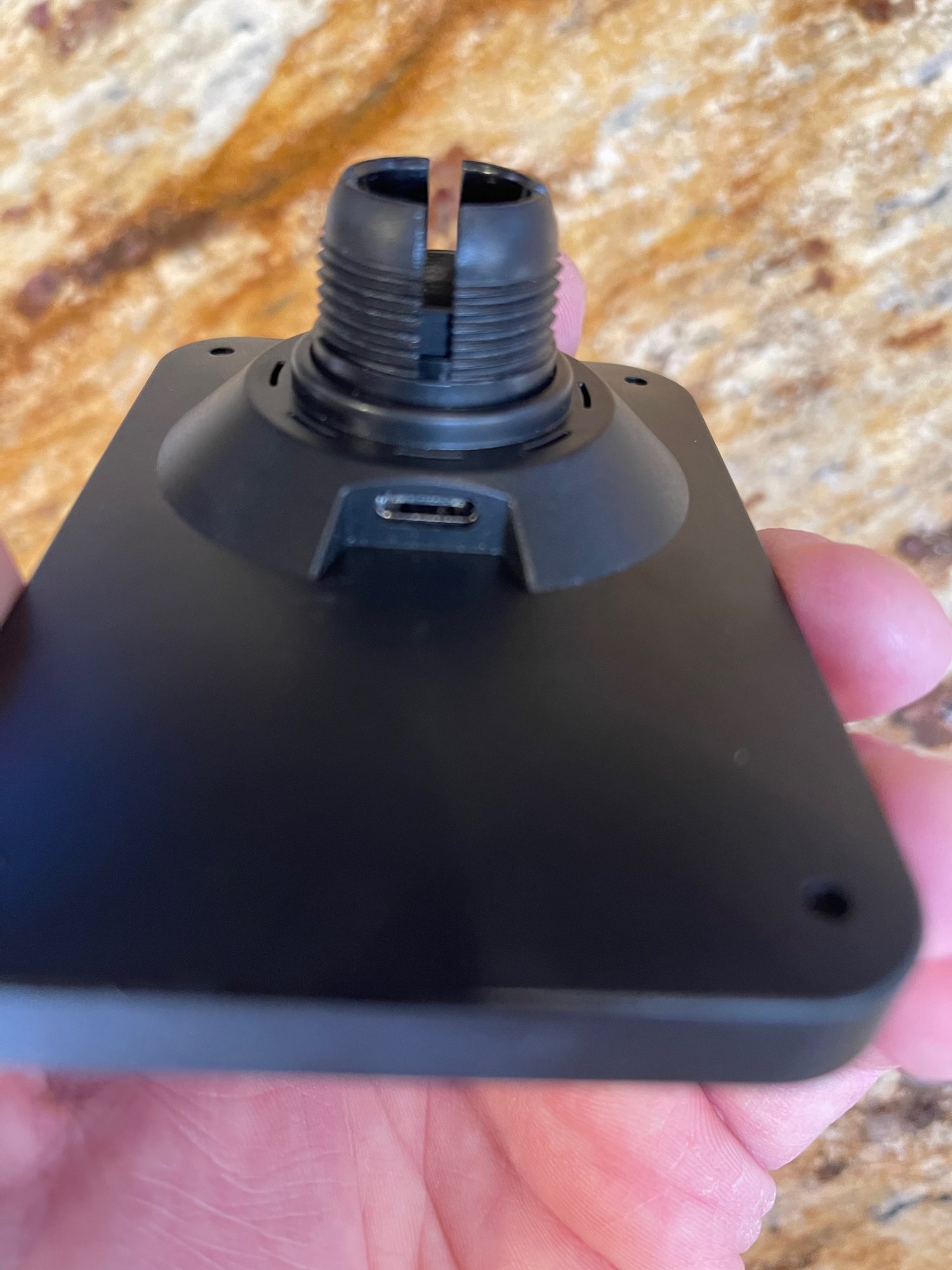

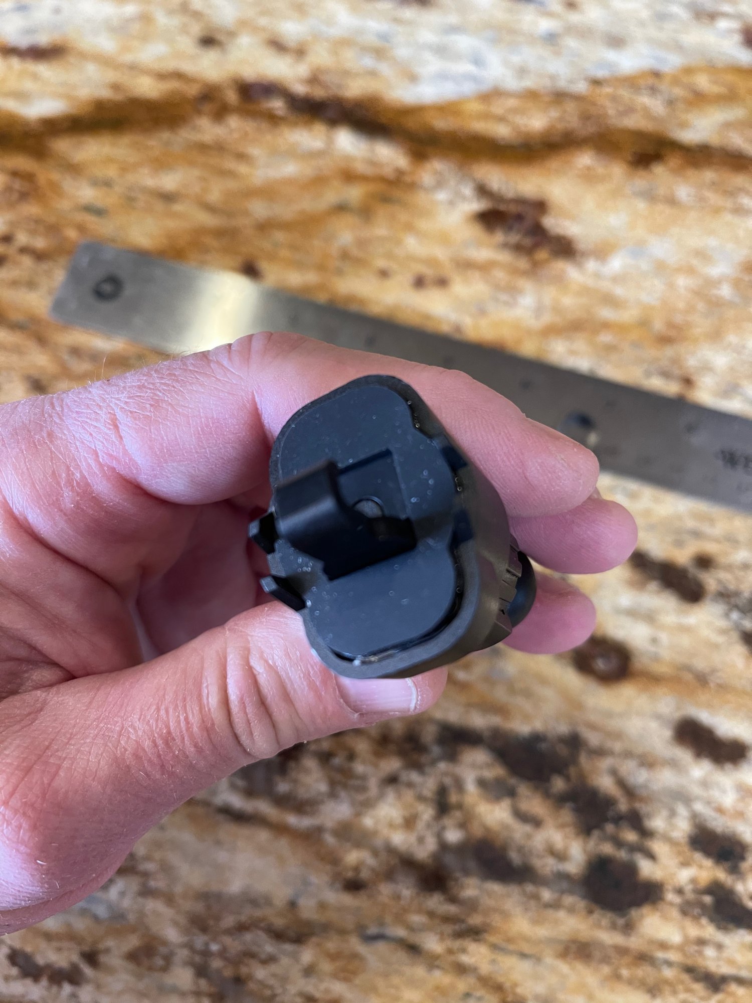

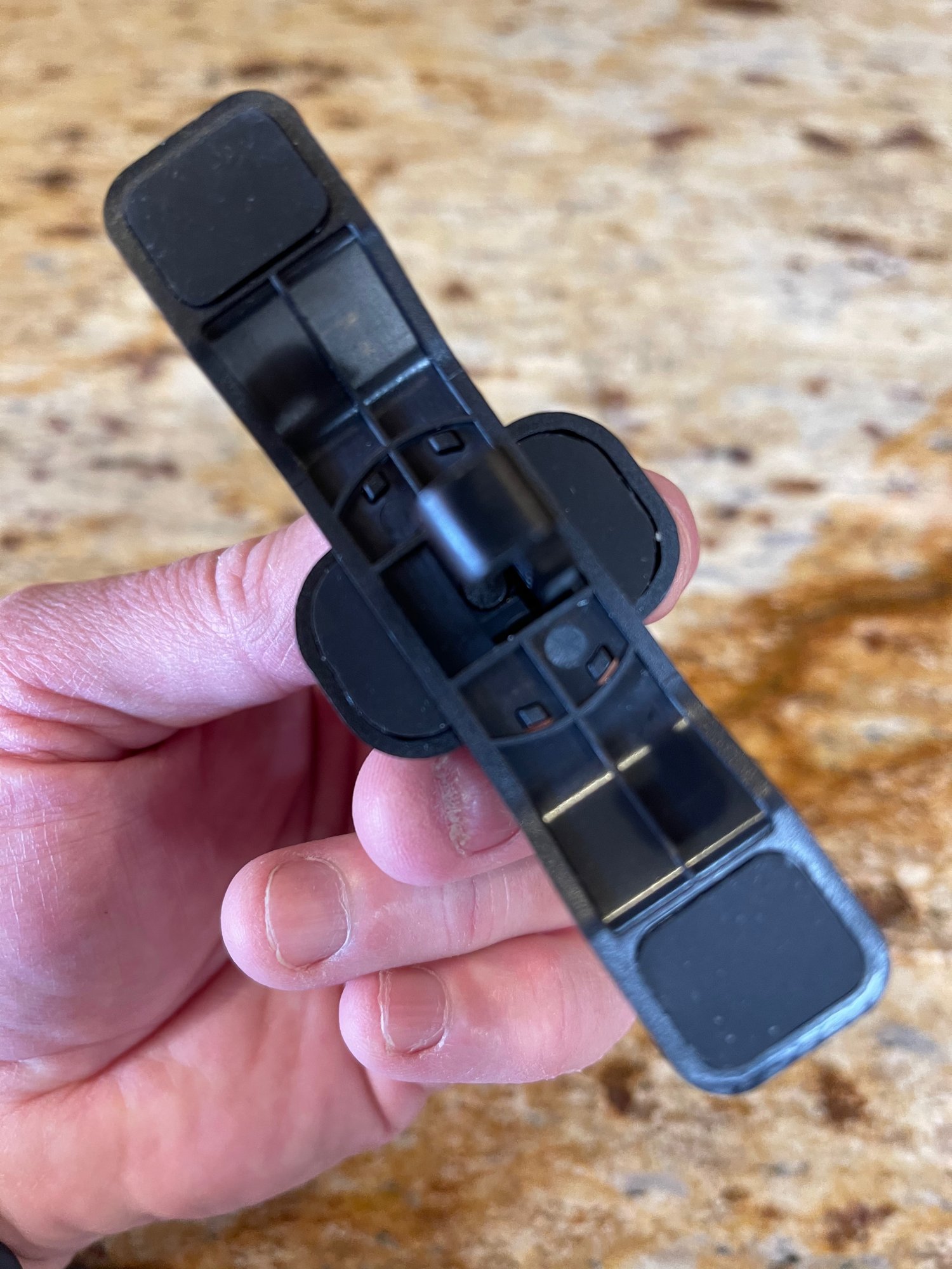

The connector for the USB-C cord has a satisfying snap when you plug in the included cord. Any other cord has less of a snap but feels secure.
The vent adjuster looks and feels solid w/rubber in the right places. It feels like the adjuster will stay tight on its own, but it remains to be seen whether the weight of an iPhone 12 Pro Max will cause it to loosen over time.
I would say the charger has a satin finish, and the included vent mount a slightly more matte finish.
The combined vent mount + charger will place the iPhone 3-1/8" (3.125") in front of the vent.
Thanks for getting the original pics from your seller in China. 👍 That's what turned me onto this mount. 😎

I got mine today from AliExpress.
www.aliexpress.com/item/1005001838613133.html
It does hold my Pro. Max (in an Apple leather case) very securely and also gets the Magsafe animation to play when the phone is placed on it.
I ran a test and it only charges at 6.7W, 1.34A. So it must just be a spoofed NFC chip bringing that Magsafe animation out.
I had it plugged into a 20W Apple USB-C charger.

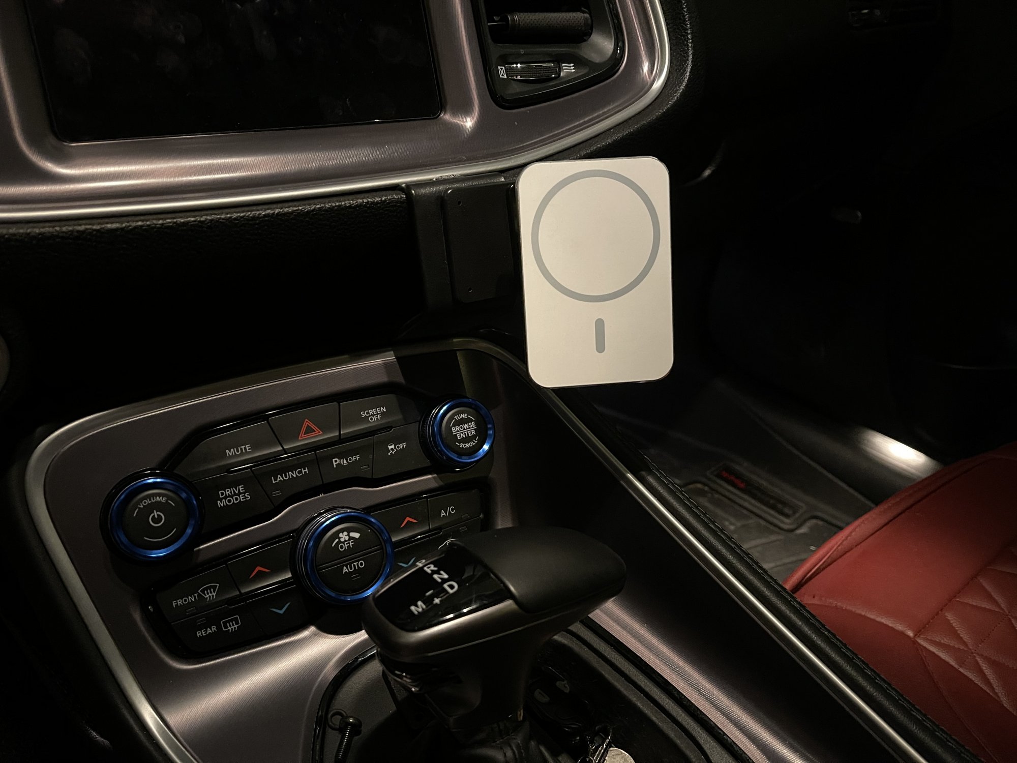

Update: I just Ran a test in my car and the wife's car.
  • Wife's car: Outfitted with the unit above (from Amzon): Charging peaked at ~9w. Which if you figure in the inefficiency of wireless probably means the unit is peaking at 7.5w to the phone.
  • My car: Outfitted with an Apple Magsafe puck taped to dash. Peaked at ~19W which again counting the inefficiency of wireless means the phone is probably getting the full 15W.
Both tests were done with USB-C PD 3.0 PPS car chargers, while my phone was at 66% charged.
