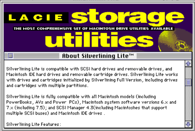

The only thing I can suggest is to use Silverlining Lite (Syquest) to re-initialize (format) the cartridge.
This is the bare form of "driver" that originally shipped with the EZ135.
The Control Panel's 'About' does say it's compatible with System 6

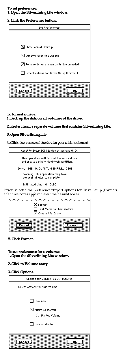

Make sure you set the advanced options: (full instructions are in the readme)
I STRONGLY suggest selecting "Test Media for Bad Sectors" - this will take some time but should prevent further difficulties.
To get that option you need to click the last checkbox in the first image below:
I'm not sure if the last image below is something that flips a switch on the cartridge's partition map or driver, but it seems selecting the "Startup Volume" (after selecting the formatted & initialized cartridge) might be prudent. It may be as good as setting the startup disk in later MacOS versions. I have no idea. 😕
