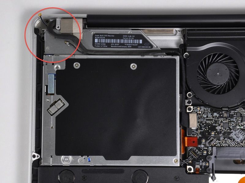

Did anyone successfully install a NewModeUS caddy in a new 17-inch aluminium Pro unibody MacBook?
I opened my MacBook a saw that you had to remove three screws, one orange flatcable (dvd-rw) and also two other black cables.
Could you please let me know what you did with these two black cables after the swap with the NewModeUS bay? I have highlighted these cables in the added picture.
Thanks for your help!
I installed the NewModeUS caddy in my uMBP 17" a couple weeks ago. It only has the one screw, near the connectors, holding it in. I just screwed the other two back in where they belong so I don't lose them (they aren't doing anything, but there's no reason they can't be screwed back in).

I have got all the pieces now: The newmodeus caddy, the X-25 SSD and a 500GB hard drive. I opened the case and... whoa. Looks like there's a lot of stuff in the way.
Has anyone installed this in a 17" MacBook Pro unibody? Can you let me know what you did? I scanned the iFixit teardown for this machine, but it's not detailed enough for me to go and take my perfectly working warrantied MBP apart.
In particular:
- There's a Bluetooth logic board attached to the original caddy. I have to take that off - how do the cables come off of this? I need to take them off without breaking, is that easy?
- There's a black cable (display cable?) passing over the caddy. Do I need to disconnect this from the logic board? It seems like I'd have to to get to the screws that keeps the caddy in place on the rear.
- There's at least one screw in the upper left corner near the display cable that seems to hold the caddy down - the newmodeus doesn't have a screw hole there
- There's a piece of foam glued next to the black cable near the display - what do I use to re-attach this to the new caddy? It seems like we need this to keep the caddy snug in place as the only compatible screws I can see are on the back. I don't feel good about this being held in place only at the back. It will flop around - I want to screw it down in other places, is that possible?
In particular: [...]
I'd say if you're worried about losing your warranty than you should't even start this modification. Imo it's strictly for those who know what they're doing and hence won't lose warranty or for those that aren't afraid of possibly losing warranty.
Whatever is the case with you, I performed this modification on my early 2009 MBP 17" and I'd say it's dead easy and not worth a separate tutorial. Only three screws need to removed and the orange sata cable needs to be detached, and then you can basically remove the dvd drive already. This mod is really easy and self explanatory, nothing like say re-applying thermal paste on the cpu and gpu with the risk of breaking of a piece of the processor's core!
