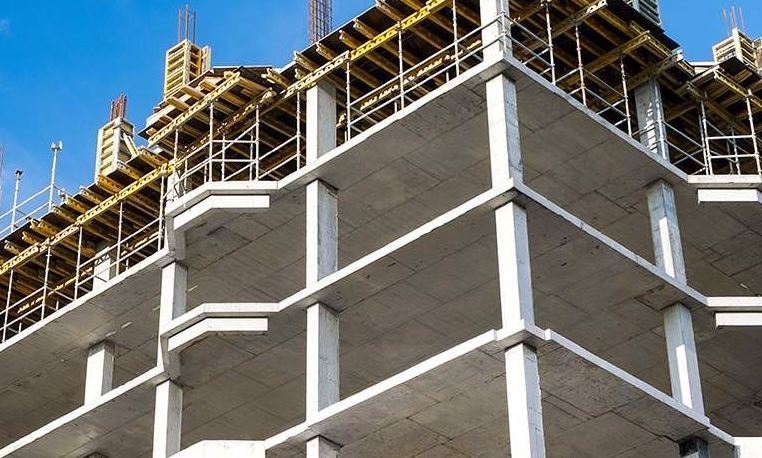

You said you've worked with home building so I'd guess you're unlikely to have had the need to become familiar with some types of reinforced concrete construction that don't use a post and beam type of skeleton.
So for your fyi and entertainment.......here are some photos that show what's called flat plate reinforced concrete construction. As you'll see, no beams at all, just columns and slabs. In many areas, it's a quite common construction type for mid-rise residential and office buildings....and I have no idea if this is how the collapsed building in Miami was built....it's just a side point in the discussion
I'm pretty sure all of us would prefer something other than a dirt floor! 😁

Correct on the clarification. Slabs do support, for lack of a better phrase, items for living. (known as the live load) But the support for the building's support skeleton(as I'll call it) (known as dead load) wouldn't be in conjunction with a slab.
The slabs are structural, supporting the live load.
The slab weight is also part of the dead load supported by beams, columns, and the foundation.

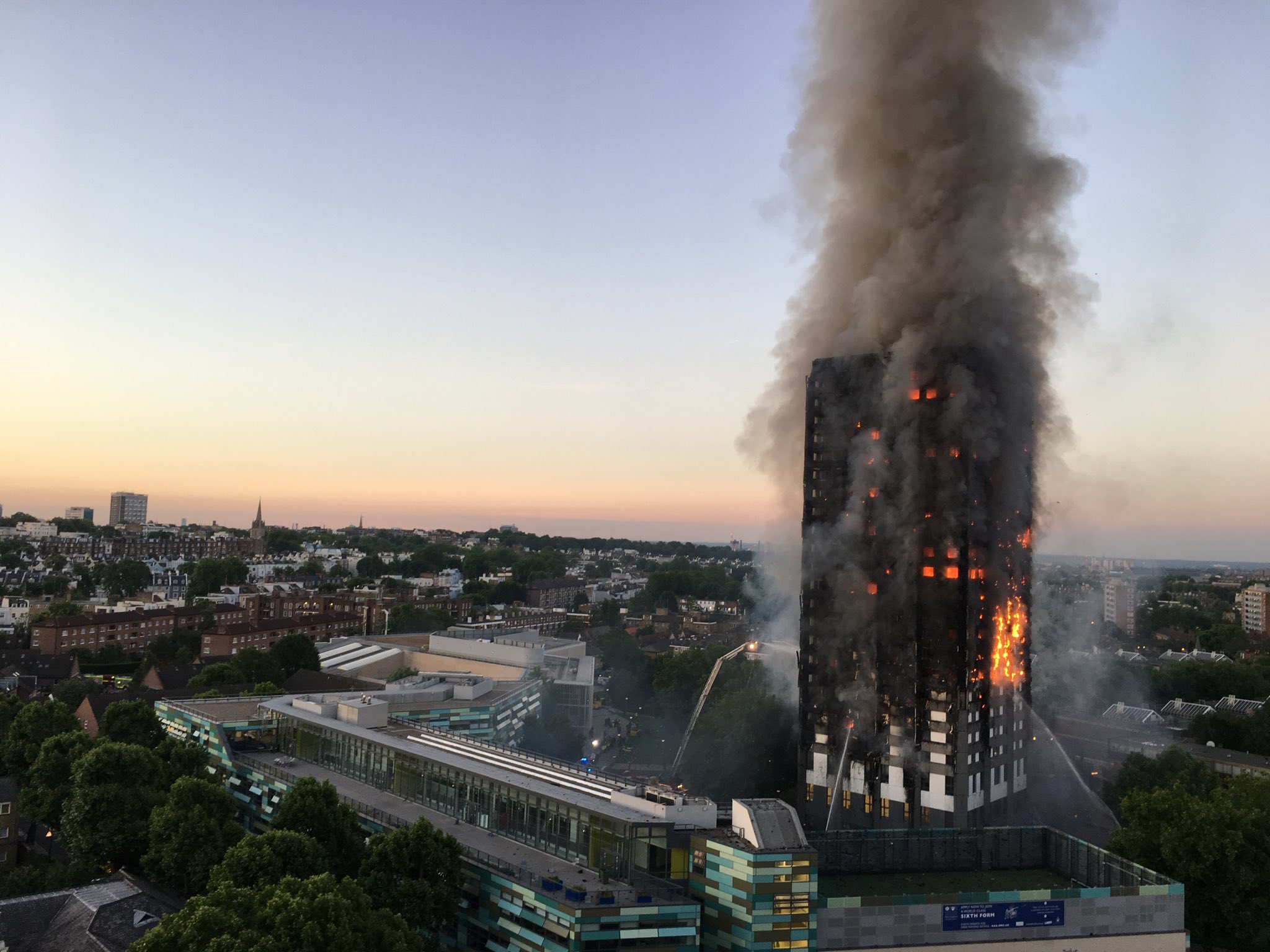

Well, at least your government didn't put flammable cladding on the sides of buildings...
Grenfell tower fire, London - 72 dead 74 hospitalised. Source: link
Given the high density of people in these towers I hope governments take a good hard look at safety. Collapses and deadly fires can kill a large number of people, so any inspection or building process that entails conflict of interest should be checked by an independent body with enforcement powers. If any good comes out of the collapse of the building in Miami, I hope it is that people are no longer complacent.
