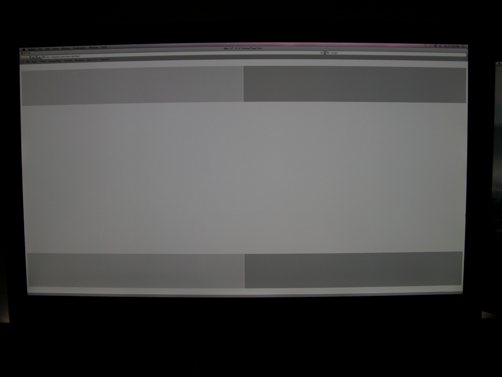

Ahhh.... crap mine definitely has it now I did the actual test. but it doesn't really bother me. I didnt even notice that until I read this thread. So will this problem get worse in time? I have apple care for 2 years may be I should just bring it in just before it expires? Will they fix it or not?
You've simply posted a screengrab, not a photo of your actual screen. The yellowing won't show up on a screengrab. You need to take a photo of your screen with a camera.
Duh. I am an idiot. Not sure what I was thinking. ha

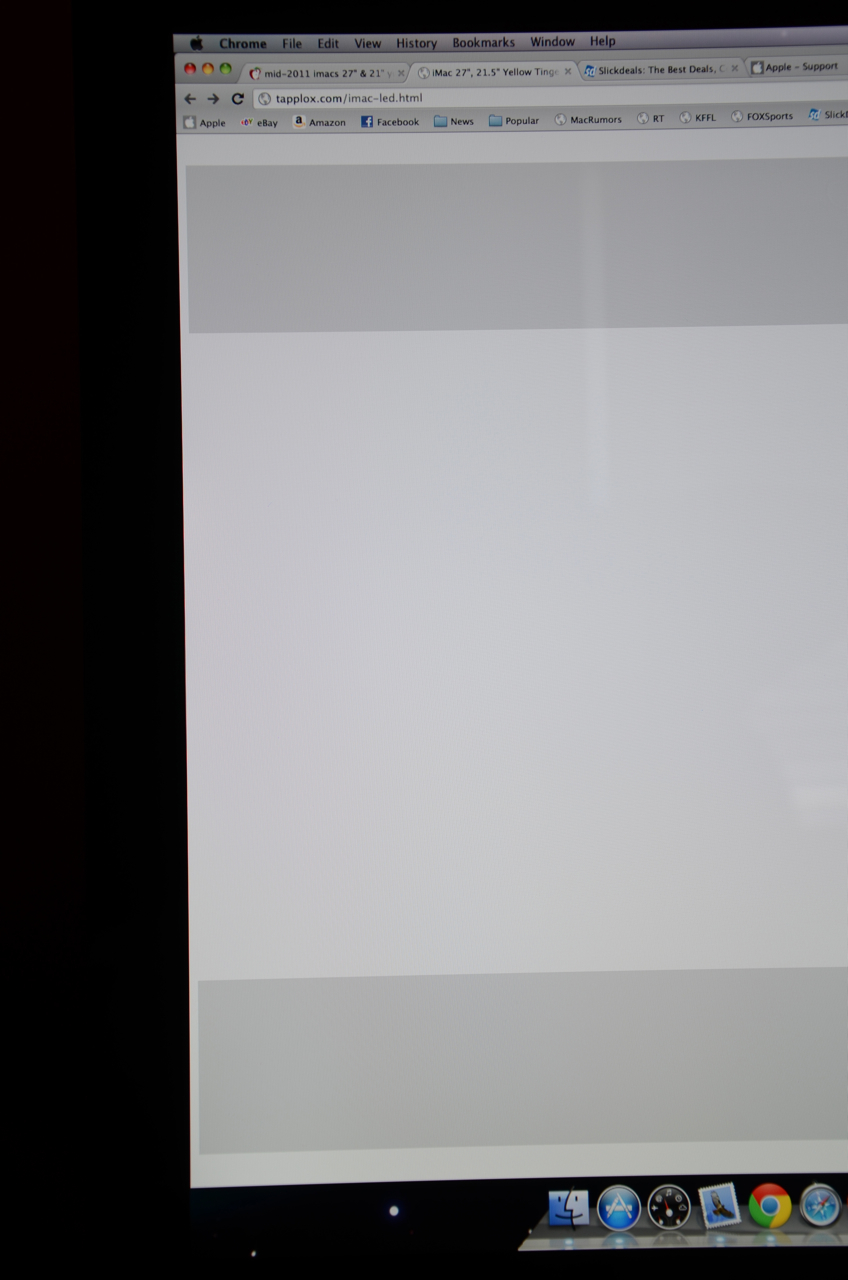

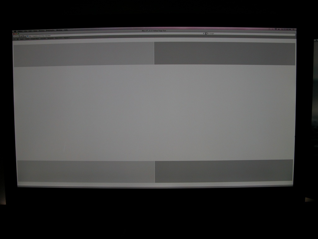

Here are some actual pics.

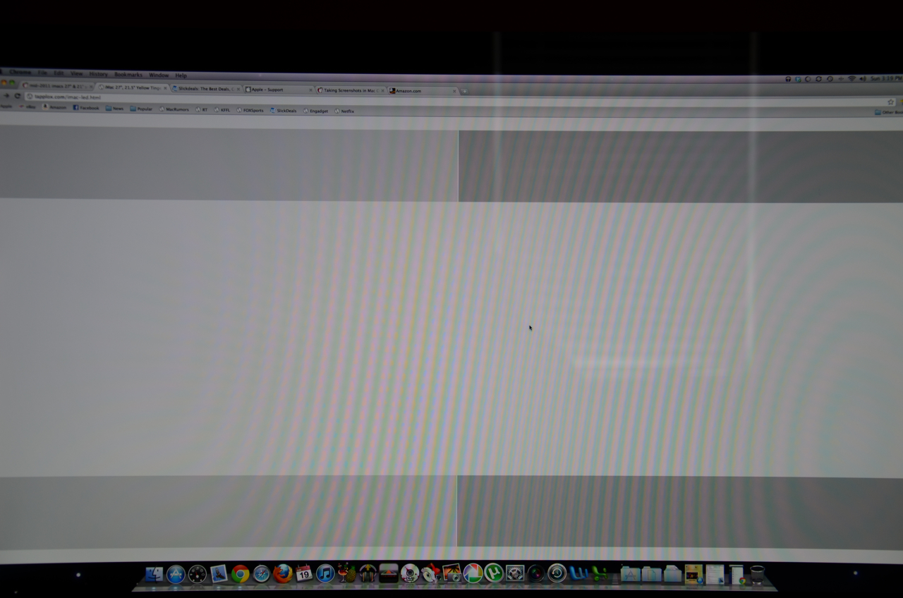

Try to make your camera focus on the apple logo on the front and lift it up before you release the shutter. That usually helps on the distortion (rainbowing) in the image.
on pic #2 however, it looks like you might have some yellowing at the bottom but it could be the quality of the picture.

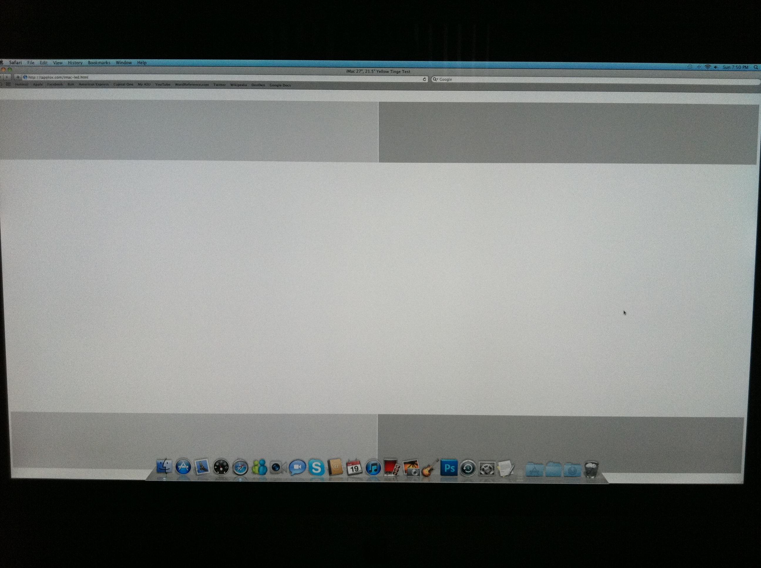

Hi everyone and thanks for the answers. This time, I did another test, the one with the timer.
I post the picture. I can see a yellow tint in the last third of the page. Tell me if you can see it.
Can I do something to calibrate the screen, like doing something with the white color? Thanks!

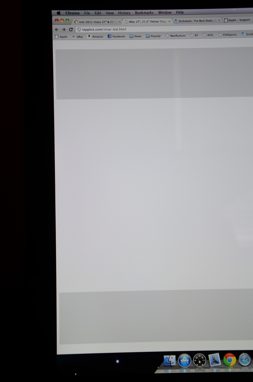

This is my new 2011 27" iMac. I am certain there is at least some yellowing throughout the bottom of the screen. Does it look bad to any of you? I can't notice it unless I am looking at something white and trying to find it. It's also quite visible when I first start up the computer, when the Apple logo appears on the white background.
I don't see it, it looks pretty evenly colored from your picture.
If' it clearly visible with a white background try examining it with the white background in the pixel test here: http://imac.squeaked.com/test.php
