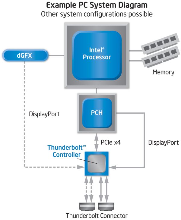

Isn’t the thing which prevents using a modified 2011 15/17 from connecting to an external display the same thing which would preclude using Thunderbolt for anything display-related?
There are two DisplayPort streams (from the Radeon) and four PCIe lanes (from the CPU) going into the Thunderbolt controller on a 15"/17" 2011 MBP. The following diagram shows a slightly different setup but the point remains: DP and PCIe are piped into the TB controller.
With the Radeon out of the game, the ability to attach a display to the MBP directly or to a TB dock (in a daisy-chain) is lost because there are no DP streams to tap into (the HD3000 isn't wired up to the TB controller at all). But the PCIe lanes are still there, so any PCIe device (such as the TB-to-FW thingy) including an eGPU should™ still work.
