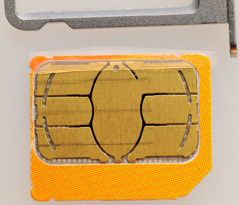

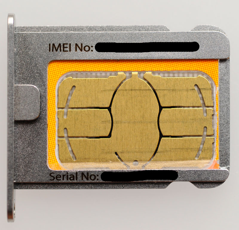

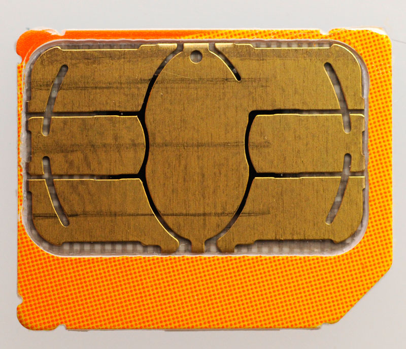

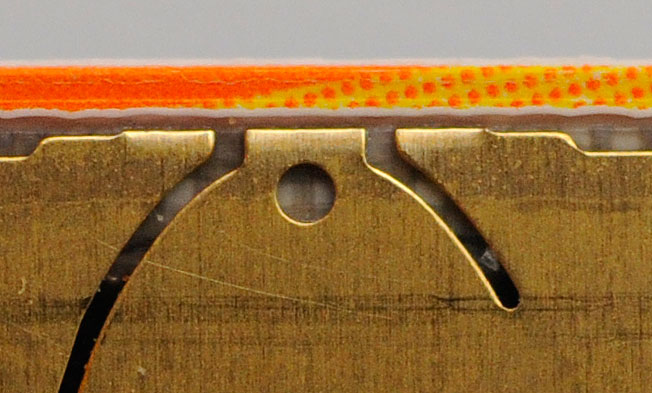

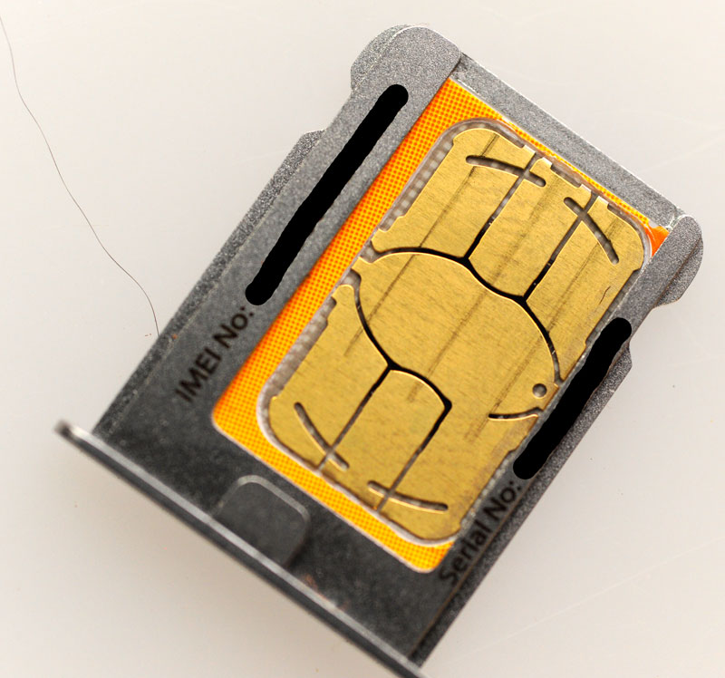

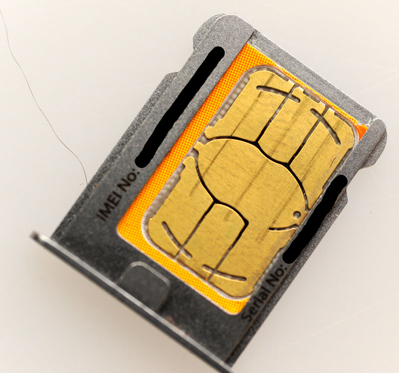

I re-did it to shoot some photos, go ahead and post them if need be.

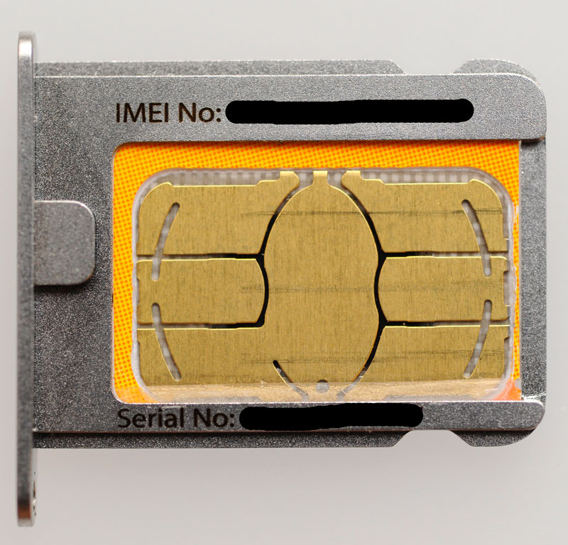

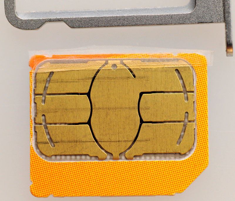

On the super close up photo of the contact side, the very edge of it is the brassed area ( about 1/64th ) where the contact has been touching the tray...just barely.
It seems to be working fine for me again...

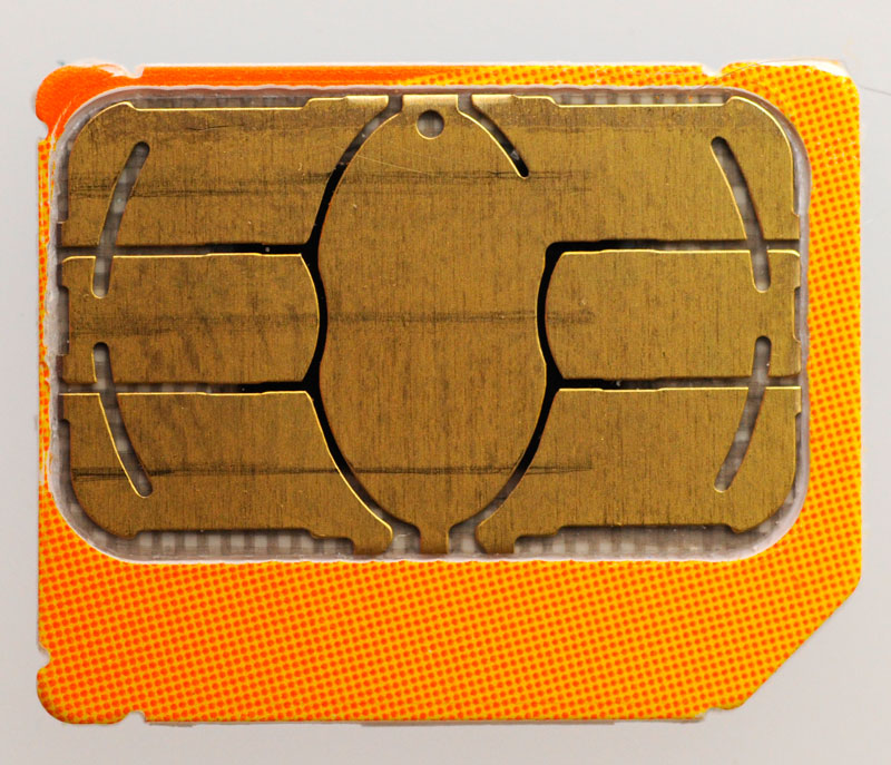

note on the third photo the shiny brassed area where the contact has been touching the tray.
The 4th image there - bottom right, the one that clearly shows the Serial/IMEI text, would be the one I'd suspect since the "gap" between the SIM pads (where the tape is) and the edge of the SIM tray are basically non-existant. Very interesting... the tape there would certainly seem to be something of use, even if we're just talking about an "air short" of some kind crossing that incredibly minute distance...
Edit: Yes I know it's the same SIM tray and SIM card... 🙂 Just pointing out that the bottom right image makes the "gap" there the most clear, at least to me it does.
