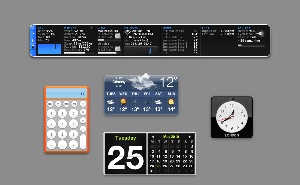

What even worse now is that the fans don't speed up, even at 104 degrees C... It's been turned on f0r 30 minutes and already at these temps. I'm dreading the Phone Call to Apple, basically because there ' service provider' told me it was not faulty, so Apple are bound to take their side 🙄

DUDE that is INSANE... your machine is absolutely broken...
its @104c and the fans are stilling idleing at 2000rpm...

CPU is hot, proven by group 8 under the stress tests max 107-110/111 C
Logic Board problems
I told Apple the fans now only go up to 2000rpm no matter what the temp is, so the fans could be at fault.

EDIT: When the CPU is 104 C, the heat-sink is around 75C, if that means anything.
