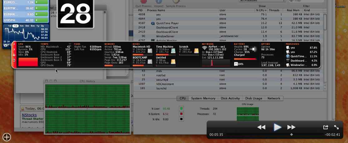

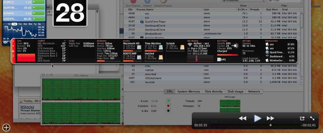

I brought it to an AASP, and showed them what is going on. I did this by running
yes > /dev/null​
in two separate Terminal windows and monitoring temperatures with iStat Menu. The yes > /dev/null command puts 100% load on a core, and running this twice will have both cores running maxed out. As soon as the tech saw this behavior, he suggested to change the thermal paste. Although this did not explain the fans revving up eventually, it was worth a try.
The temp still sky rockets up to 102°C when pushed, but the fans do their work now at least. I did reset the SMC twice, before they started to act normal though.
Have Apple/Group 8 replace the thermal paste and check your machine again. Last resort would be to change your logic board and RAM. For an outright exchange you need to have a bit of luck and push them for it somewhat. Demand a permanent solution for your issues. I wish you good luck to get this resolved.
