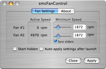

To any MBP 15" owners.
I know there are two fans installed in 15" MBP.
However, with or without this program, only one fan (the right one) seems to spin.
What about yours?

Hmm. Now when you refer to with or without, do you mean with being the scripts, and without being the manual entry of the code in the terminal?
I'm just asking to be clear, but I'm sure you probably mean that if you attempt no alteration of your fan speed, only one fan spins. In that case, I would say that you need to get your left fan replaced. What does your temperature usually run at when idle? Just out of curiosity.

Correct that's what I meant.
I've been monitoring the left fan.. and once in a while, it turns on for 1 sec, then shuts off.
this is what i get from the program. (the RPM hasn't been modified.. but just to measure the RPMs.)

sounds like you got a bum fan.

Where'd you get the gui program for smc? But yeah it sounds like you need a new fan.
I have that app (from http://homepage.mac.com/holtmann/eidac/index.html) and i'm wondering what is a safe RPM rate is to keep both fans at. I want to keep my system cool, but I don't know if you can damage the fans or anything by making them run this high or something. Thank you for your help! 🙂
(I have them synced right now at around 3,000 RPM. It brought my temperature down from around 160F to an average of 130F which is wonderful. I want to know if I can do more. Thanks again for your help!)

I'd say 2000-2500 is a great low end speed. But 3000 is ok as well (that's what I usually keep mine at). But don't plan on leaving your laptop working on something while you leave the house...I used the program to put the minimum speed at 3000rpm, and walked away as I rendered a video. I returned & my laptop had reached 200F, I had to force the fan to 6000rpm & close the software just to keep it from getting any hotter. It seems that right now, if you want to change your fan speed, there is actually no decent option that doesn't require you to be in constant watch of your temp for fear of something not working right.
Wow! You just made me really scared. I was told that MacBook's and MacBook Pro's all have a shut-off temperatuer of 180 degrees F. I've been keeping my temperature under 100F, with 5,000 RMP on both fans. Now i'm a little concerned because of what you said..

Currently I have mine set for 1800RPM and it is running just fine. Runs about 130 to 140F if I put a load on it. If it gets higher than that I slide it up some. However the two buttons for Start Hidden I can select but the Auto Apply Settings does NOT. If I select it it shuts off the "Start Hidden". Anybody else having this problem. Also I assume that Auto Apply means it should boot up to that. But mine defaults to 1000 RPM and I have to apply it to get it to speed up.
