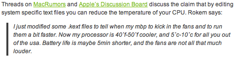

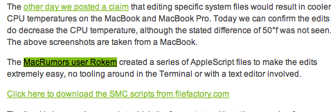

just browsing the series of tubes known as the net and cam across a the site appledefects.com. I read a few of the post on the front page and found myself twice. It just made my day. 🙂
