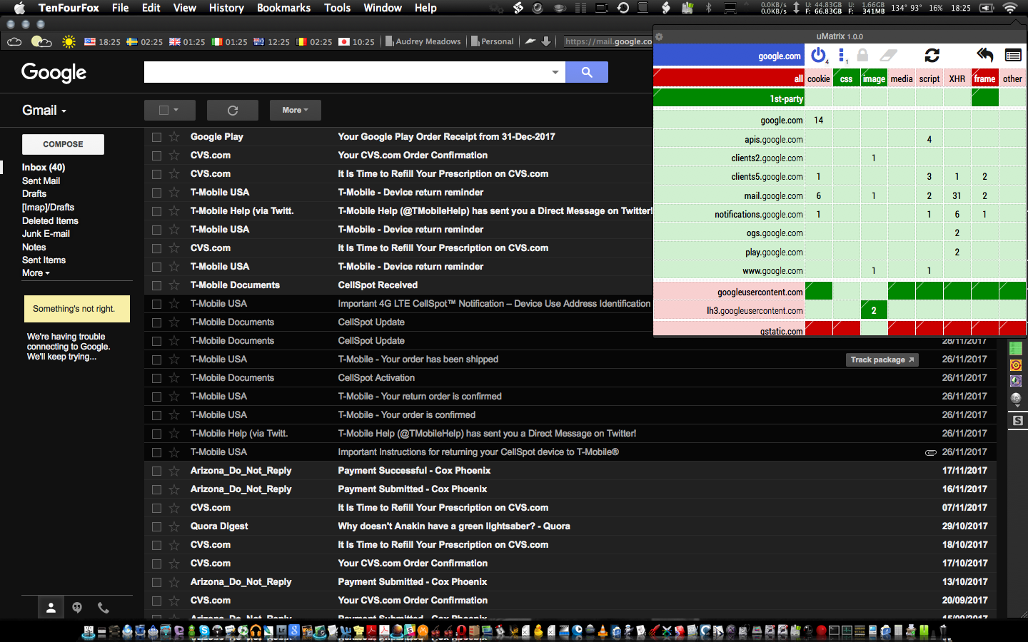

    Here's what I have going with GMail…this is on my 1Ghz 17" PowerBook.

    I see you're a Tmobile customer haha, I manage a Tmobile store here in Florida.
    Are you running Tiger, or Leopard? Because I was actually searching for a way to change to a dark theme, like in modern versions of macOS. I am wondering if I shouldn't just downgrade to Tiger, though I'm not sure how big of a performance gain I would see. I was honestly hoping this system would be a little snappier. But even with using just 1-5% of my CPU on these forums, the text can't keep up with my typing.

    #300
    I'm using Leopard on all the Macs that are capable of having it installed.
    Some points.
    1. Downgrading to Tiger won't help with websites. If you are having issues on MR, make sure your Rich Text Editor is off. That's Javascript running in the background ALL the time. You'll know it's on if you see text formatting buttons in the quick reply box. You'll have to learn the shortcuts for coding bold, italics, etc though.
    2. Do a search for optimizing Leopard here. There are things you can do. Onyx, Secrets prefpane, terminal commands, etc.
    3. I'm using a black theme called Black Mac OS X via Magnifique and a dock/icon set using Candybar. If you want that, do a search for black theme with me as the poster. There will be a Dropbox link. Be aware that it cannot theme folder backgrounds. They will still be white in list view.
    Finally, I use FT Deepdark in T4Fx as my browser theme. You'll need to disable compatibility checking and force install the non-PC version if you want to use it.
