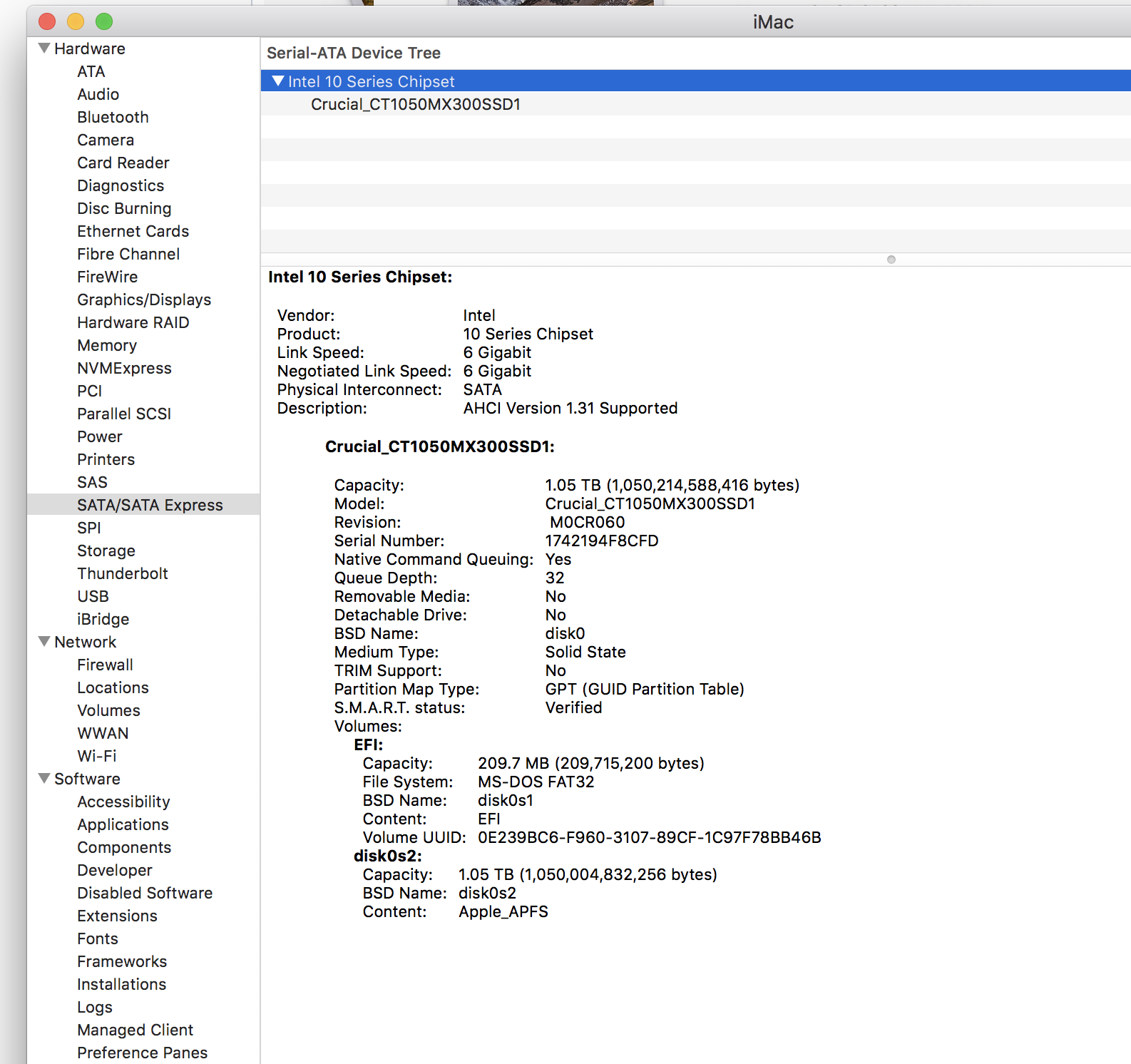

Hello, recently I have purchased a new iMac 27' 2017 with 1TB SSD.
The weird thing is that I have noticed the SSD is connected through SATA interface:
As far as I know, iMac SSDs are supposed to be PCIe, correct?

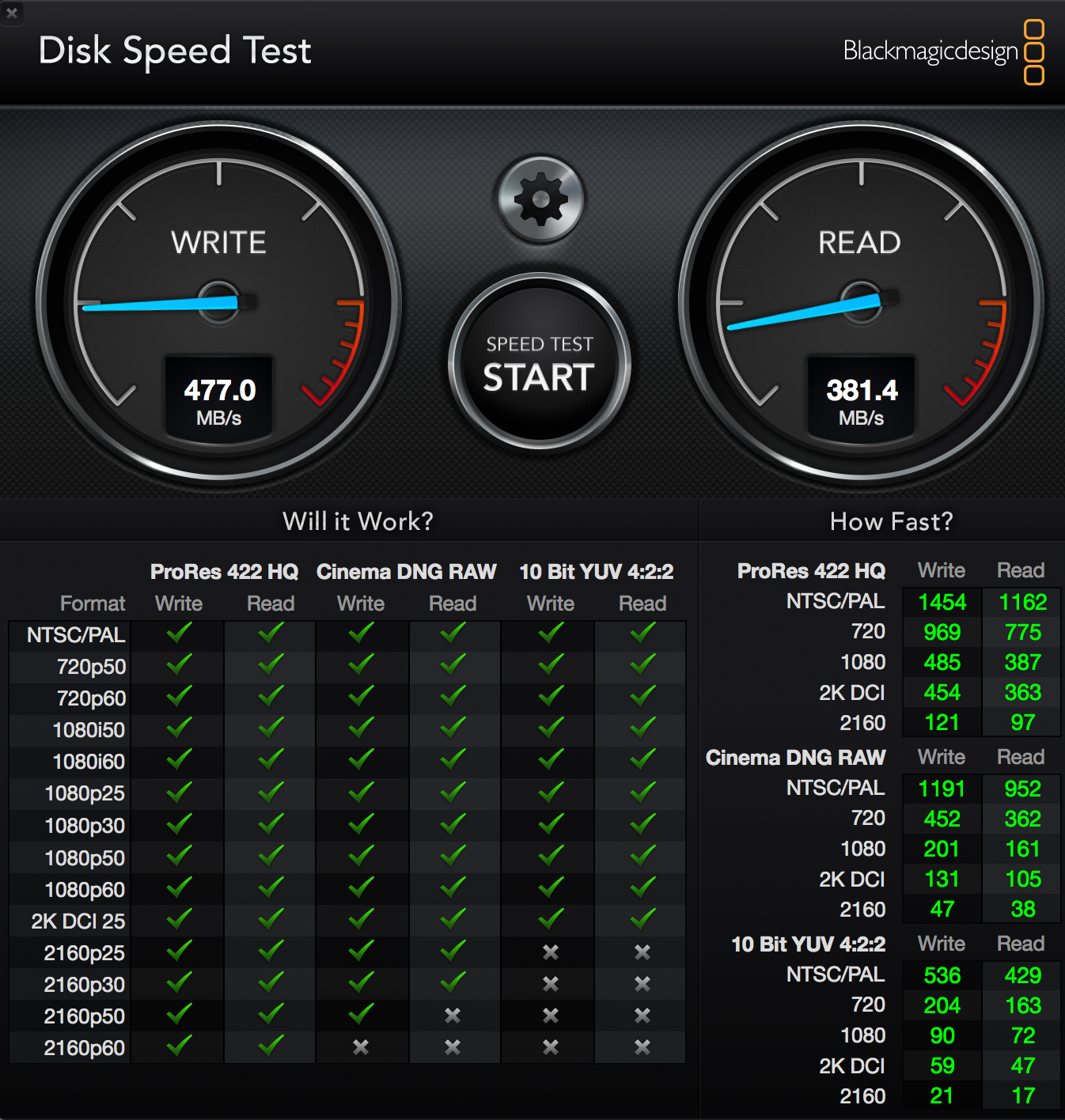

The speed tests shows slows performance compared to what they are supposed to be:
iMac SSD speed should be around ~2300 MB/s for read and ~2000 MB/s for write.
I'm missing something or should I get it checked?
Also when I click on PCI and NVMexpress in the Hardware section, it says:
This computer doesn’t contain any PCI cards or devices. If you installed or connected a PCI card or device, make sure it is properly installed.
The Mac is definitely not “new.” Looks like your Mac has an aftermarket crucial MX300 SSD installed - this is a 2.5” ssd so does use the SATA connection. As this is not an official Apple SSD you may also no longer have a warranty.

That's so strange. How come I'm getting an after market SSD for a new Mac?
Here's crucial's page on the drive:
http://www.crucial.com/usa/en/ct1050mx300ssd1
CT1050MX300SSD1
  • Brand: Crucial
  • Form Factor: 2.5-inch internal SSD
  • Total Capacity: 1TB
  • Warranty: Limited 3-year
  • Specs: 1TB 2.5-inch internal SSD • SATA 6.0Gb/s • 530 MB/s Read, 510 MB/s Write
  • Series: MX300
  • Product Line: Client SSD
  • Interface: SATA 6.0Gb/s

[doublepost=1518370043][/doublepost]hi have you tried enabling trim? terminal sudo trimforce enable,

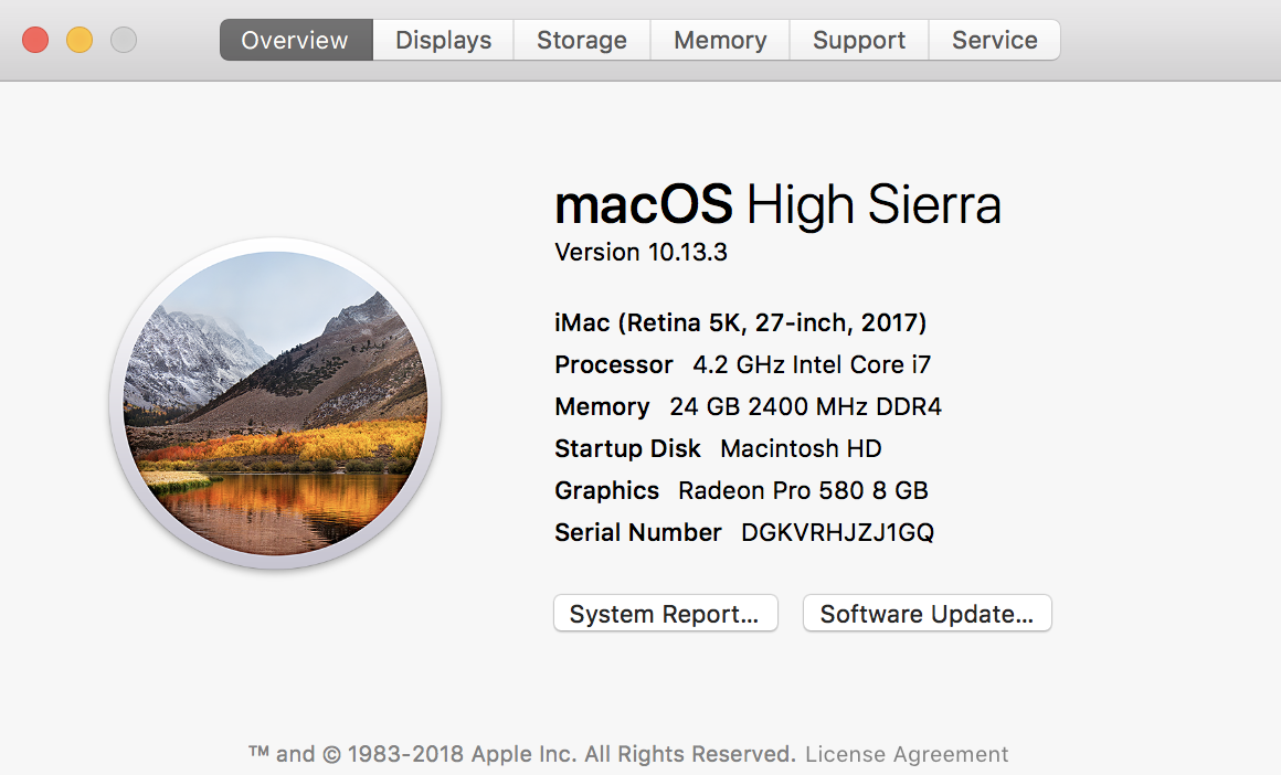

Just to confirm: I have an iMac 27", 4.2GHz i7, Radeon Pro 580 8GB, 1TB SSD and:
  • The SATA/SATA Express section on System Report is empty.
  • The SSD shows up in the NVMExpress section, model: APPLE SSD SM1024L
Also, 24GB RAM means that it was bought from Apple as an 8GB model and has had 16GB of third-party RAM installed - popular, because last time I looked that cost less than getting a 16GB model from Apple. Frankly, that's not a technical concern, but the dealer should have made it clear what you were getting.
It seems like I have to get back to the shop for a replacement.
If it was sold "as new" and at full price, absolutely! The Apple SSD is faster (and more expensive) than the Crucial one you have, and officially supports TRIM (which will affect performance in the long run). You can force TRIM support on the Crucial (someone already posted the command) but that comes with an "at your own risk" disclaimer. The RAM upgrade is reasonable, but that SSD is no way equivalent to the Apple SSD - and should have saved you several hundred bucks off the Apple price.
Actually it's the opposite in my iMac. the SATA/SATA Express shows as SSD and the NVMExpress shows empty.
Regarding the RAM, I have upgraded it my self. It originally came in 8 GB and I got an extra 16 GB. (No issues here)
The thing is, the cost of my iMac is exact same as the Apple price. Good thing I have noticed this early, I'm going to replace it.
