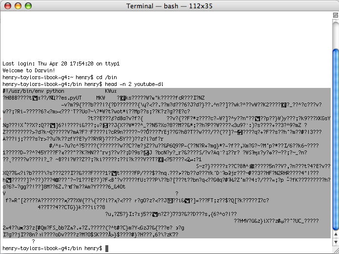

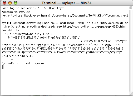

I look forward to using this on my iBook G4! I've installed it, but, unfortunately, I get some error in Terminal whenever I try to download or stream. PPC Media Centre is installed, and I followed the extra step for Tiger but it doesn't work.
Screenshot:
Any idea what could be causing this?

Yes, using the same Python that PPCMC installed. Tried the command:
The errors point to /bin/youtube-dl, which is the file I copied from /usr/local/bin to /bin. Maybe it has to be copied differently?
From the error message it indicates that there is an encoding conflict where it tries to understand unicode as being ASCII

Can you post your output from Terminal for these commands :
  • which youtube-dl
  • cd /bin
  • ls -ltr youtube*
  • head youtube-dl
  • ./youtube-dl
  • which youtube-dl - "/bin/youtube-dl"
  • cd /bin
  • ls -ltr youtube* - "-rwxrwxrwx 1 henry henry 1229378 Apr 18 17:46 youtube-dl
  • head youtube-dl - CRAZY ERROR, unreadable!
  • ./youtube-dl - SAME AS ABOVE

This is on my PB G4 running Leopard, I didn't install youtube-dl via PPC MediaCenter but the first 2 lines of the head command should show you the environment variable to which the pep error refers.
What output does ./youtube-dl give you ? With me it starts python and outputs the help .

That's because the encoding is basically converting a unicode encoded file to ASCII , when you cd /bin , what does
head -n 2 youtube-dl show in the first 2 lines ?

Yup my thoughts also, but might be worthwhile to compare both your outputs on the commands I previous listed.
what does

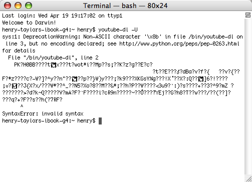

For what it's worth:
#!/usr/bin/env python
Pf?\J?$??5?>youtube_dl/aes.pyUT _??Xc??Xux
@Dronecatcher uninstalling and and reinstalling youtube-dl is a good idea. Could you please tell me how to do it? 😛 Sorry, I honestly have no idea how. 😛
