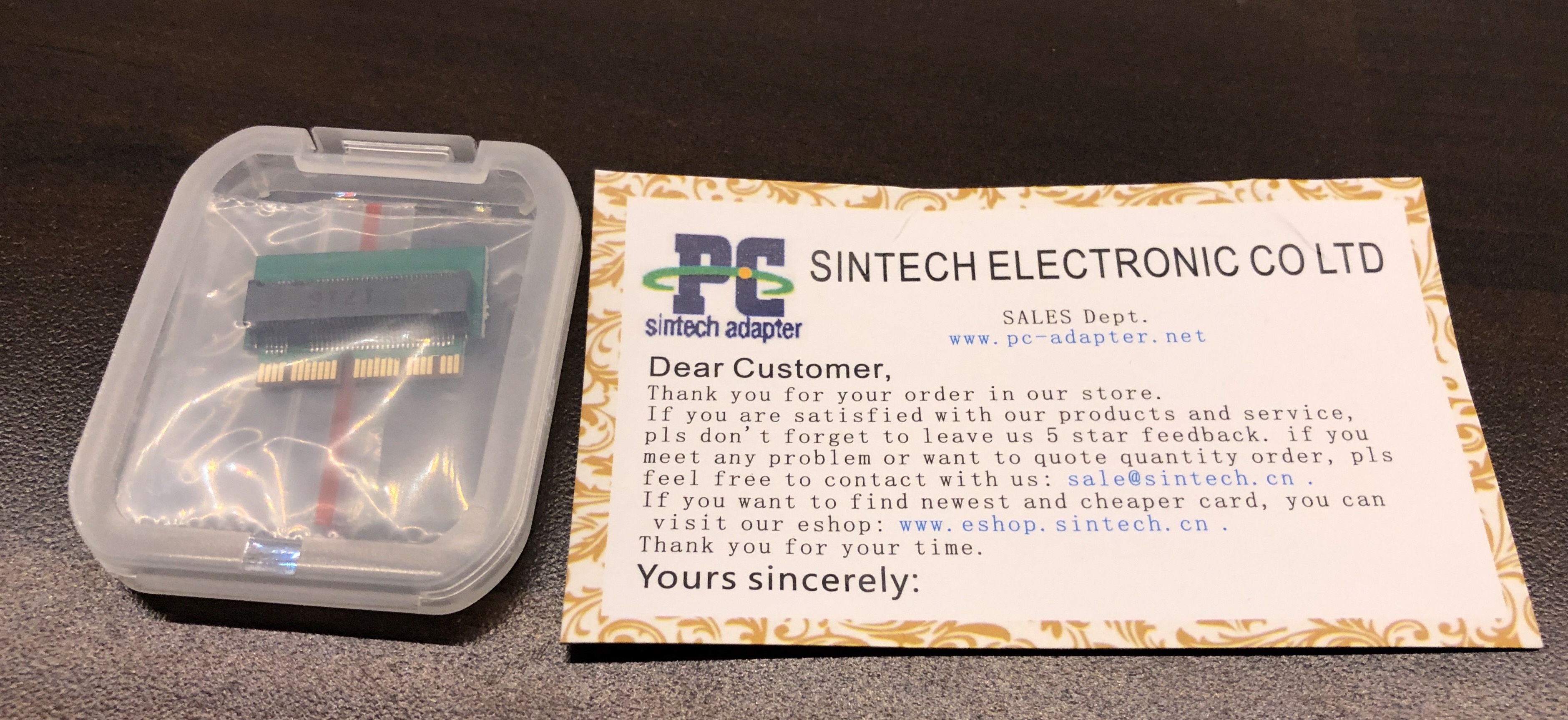

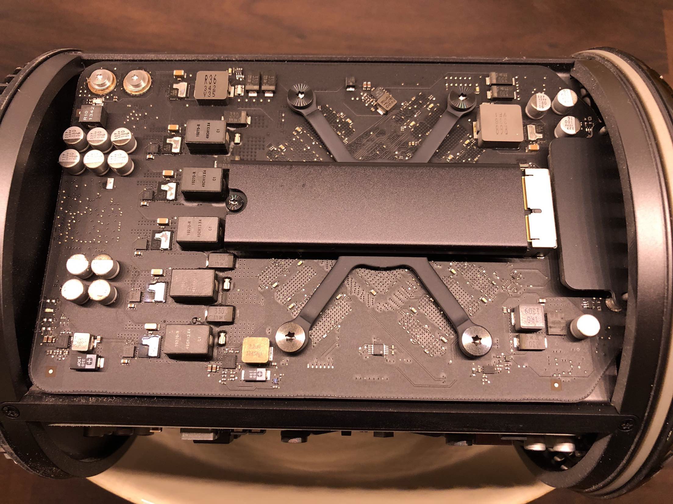

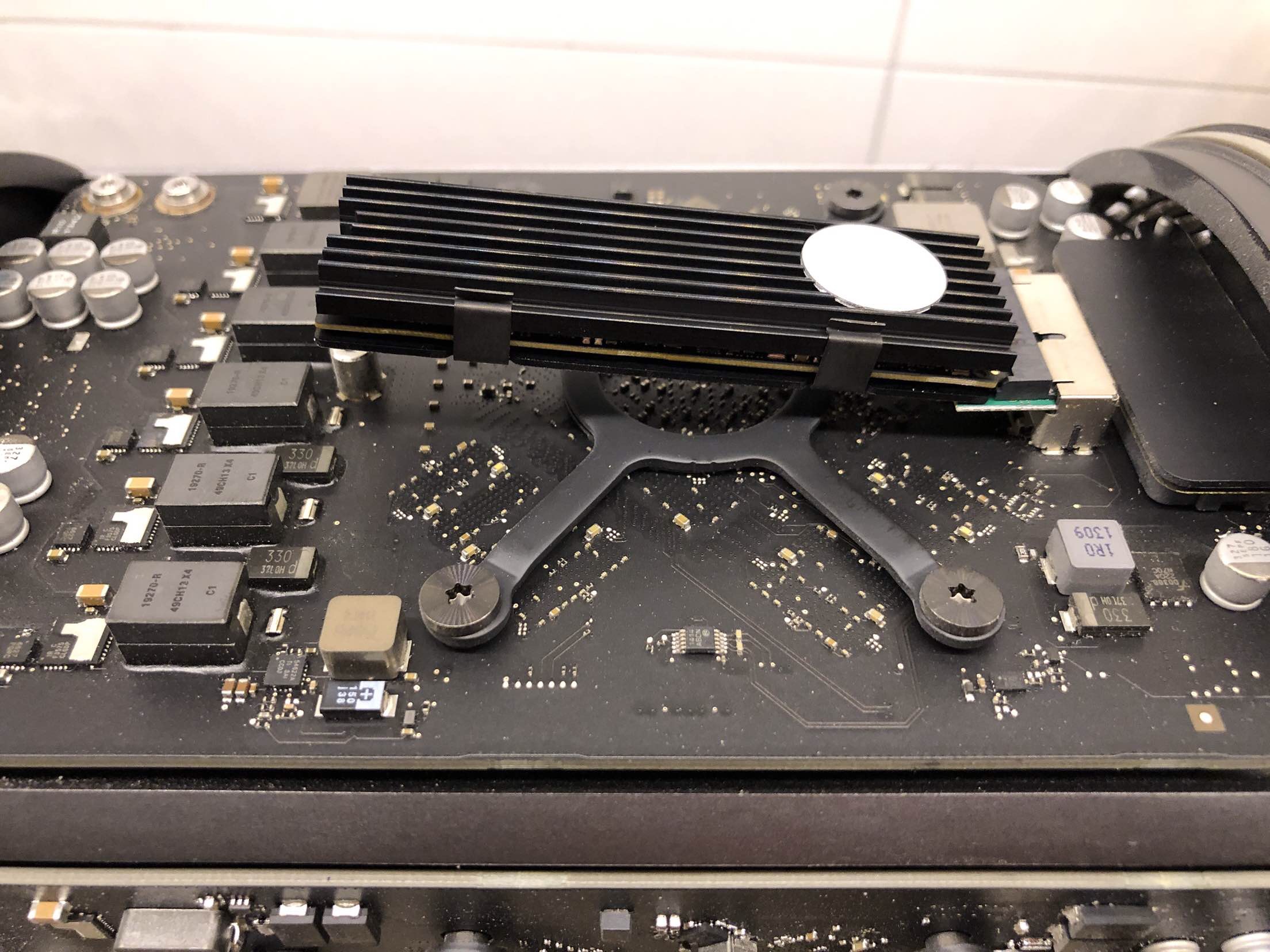

Tried to upgrade my MacPro6,1 with a Samsung 960 PRO 2TB and a CableCC/Chenyang SA-213 adapter. Applied Kapton tape. The SSD was detected, but wasn't reliable for longer use and sometimes vanished after restarts. Some people trying the adapters in MacBooks have had similarily bad experiences (see here).
I've ordered a few ST-NGFF2013 directly from Sintech and will report findings.

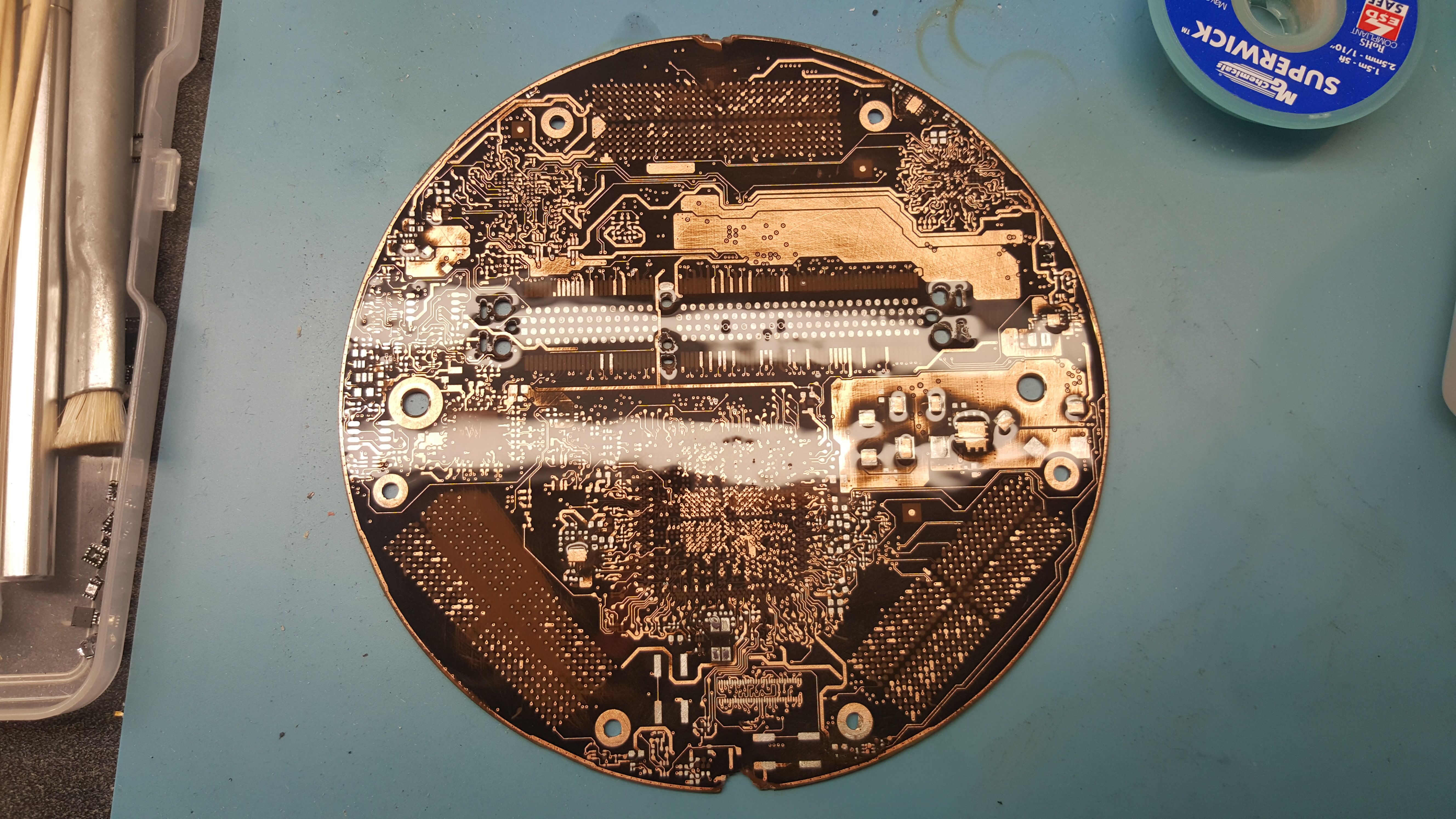

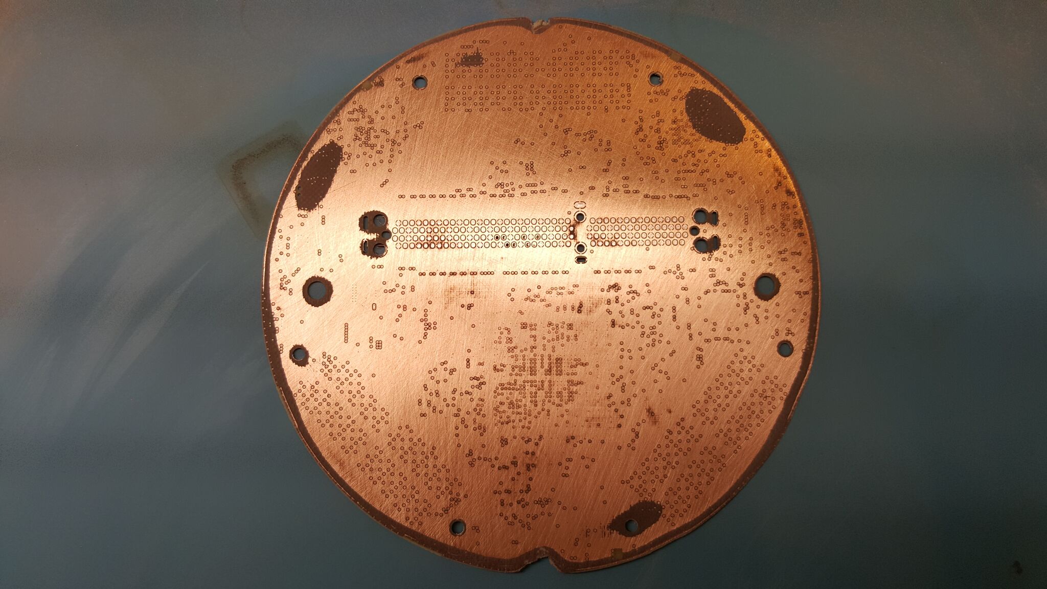

first layer of top of logic board minus the damage

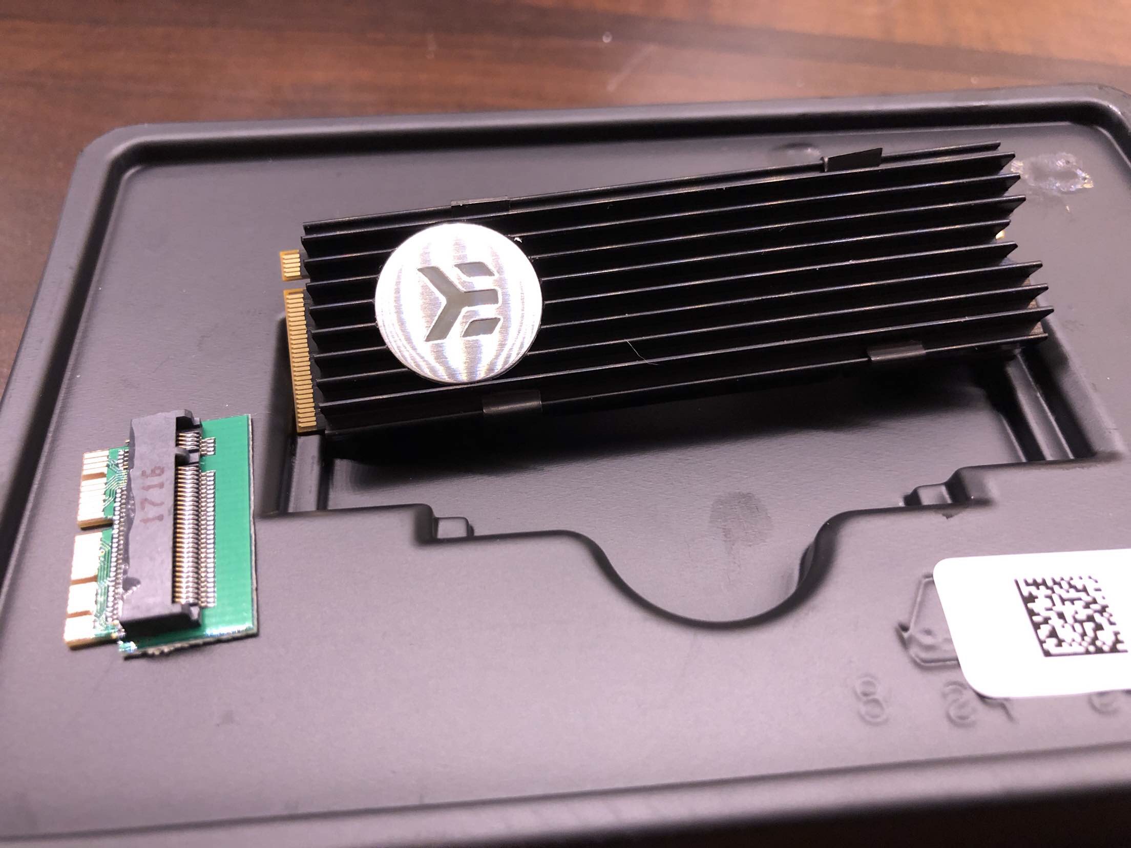

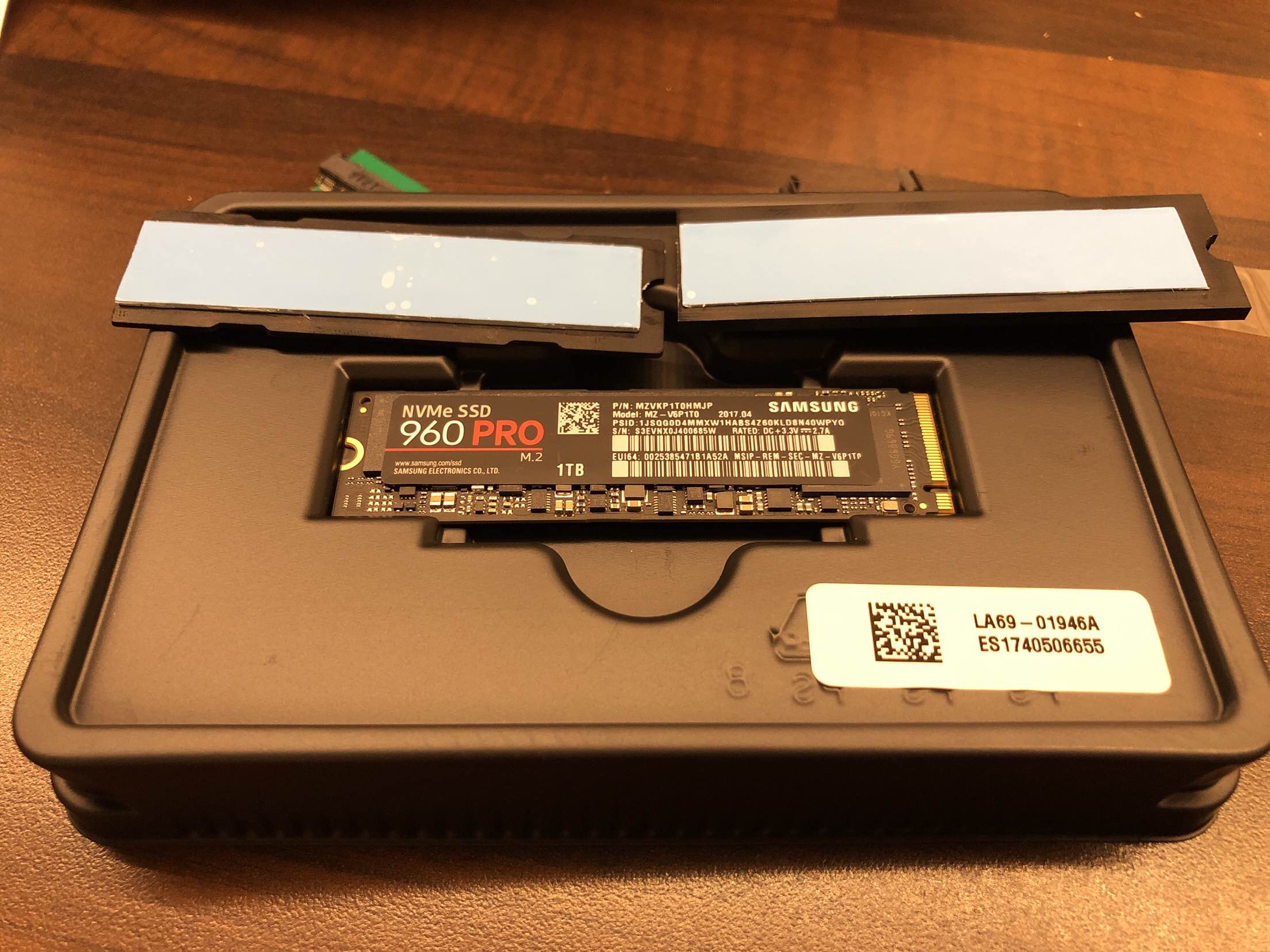

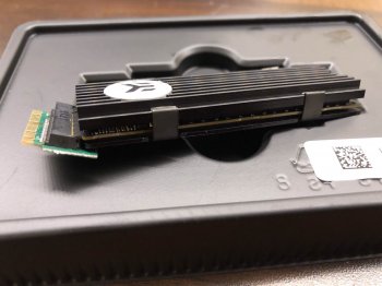

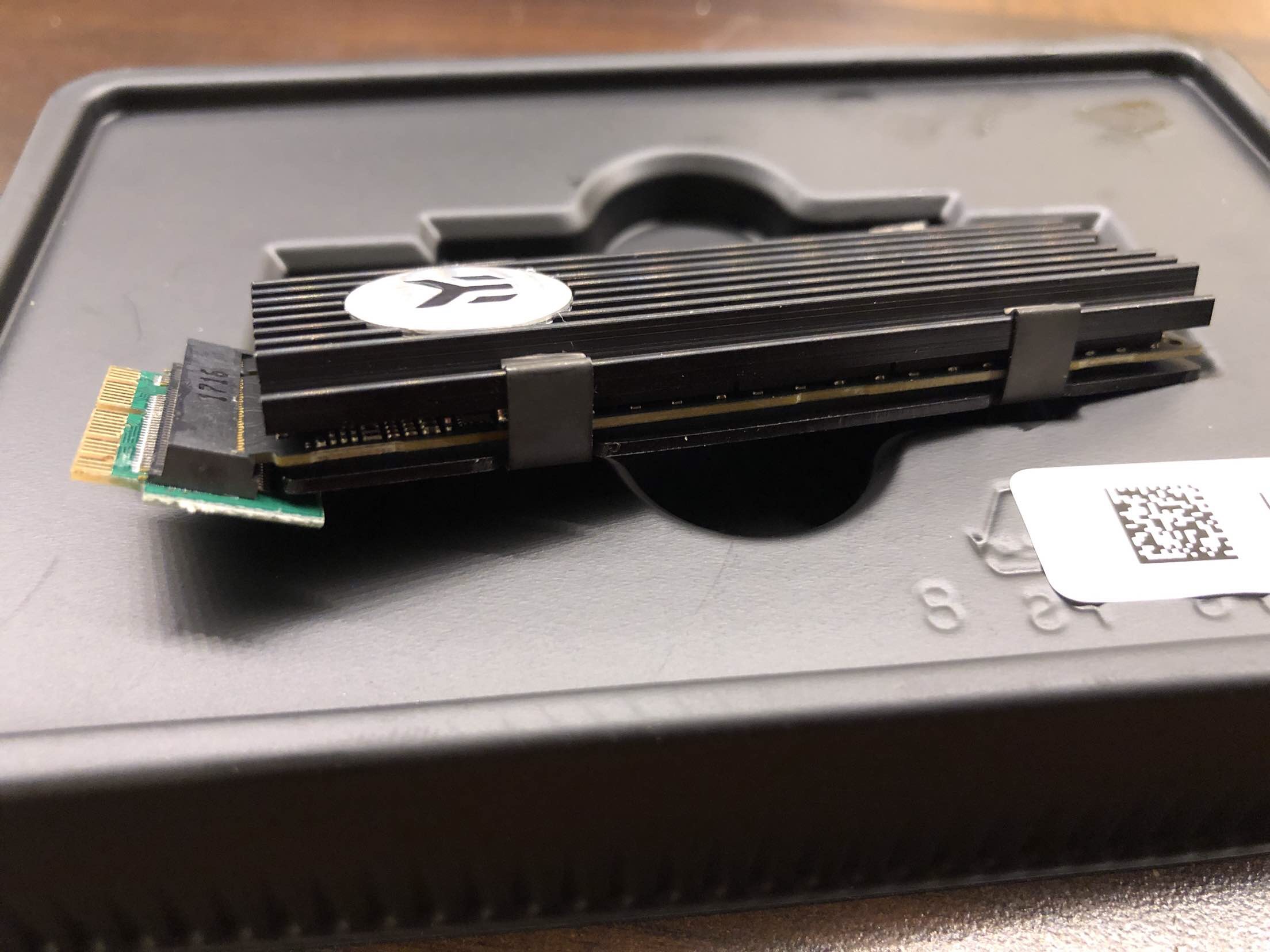

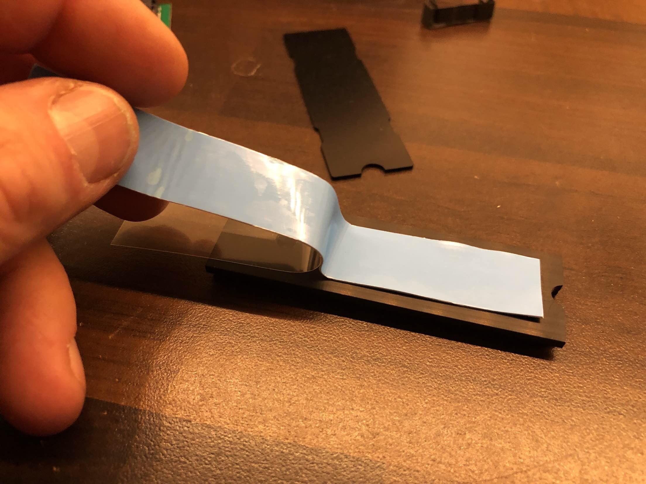

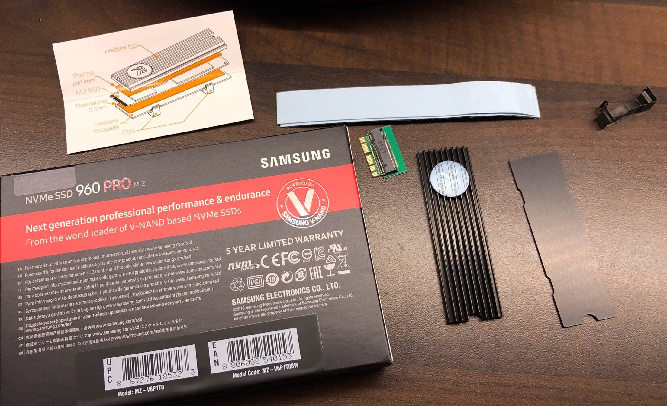

Finally one of the adapter arrived. heatsink also arrived 🙂

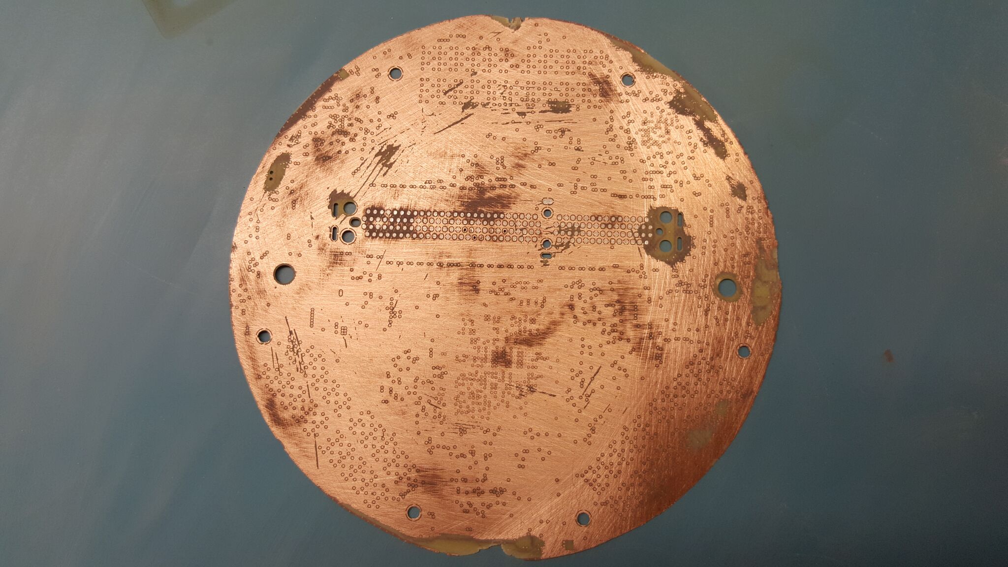

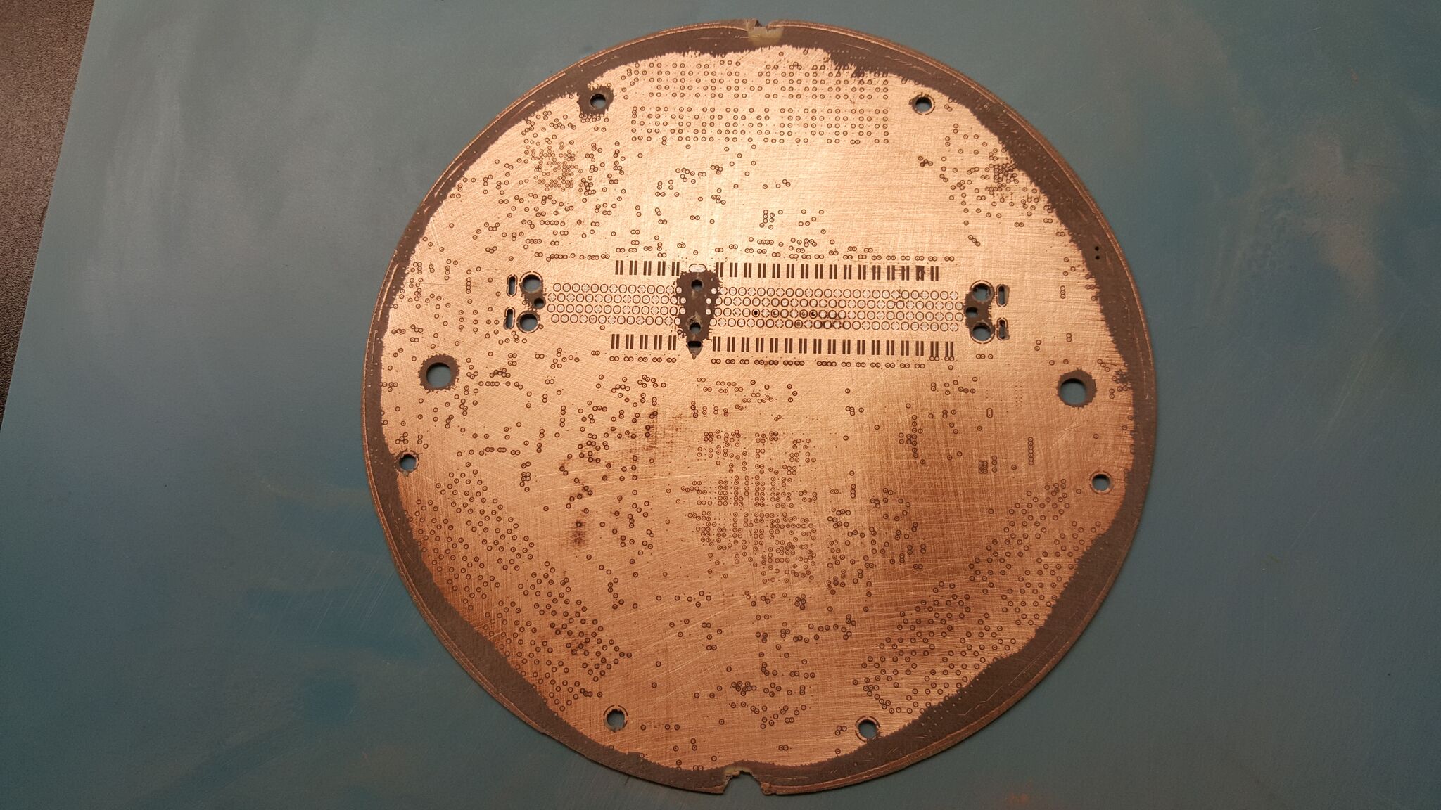

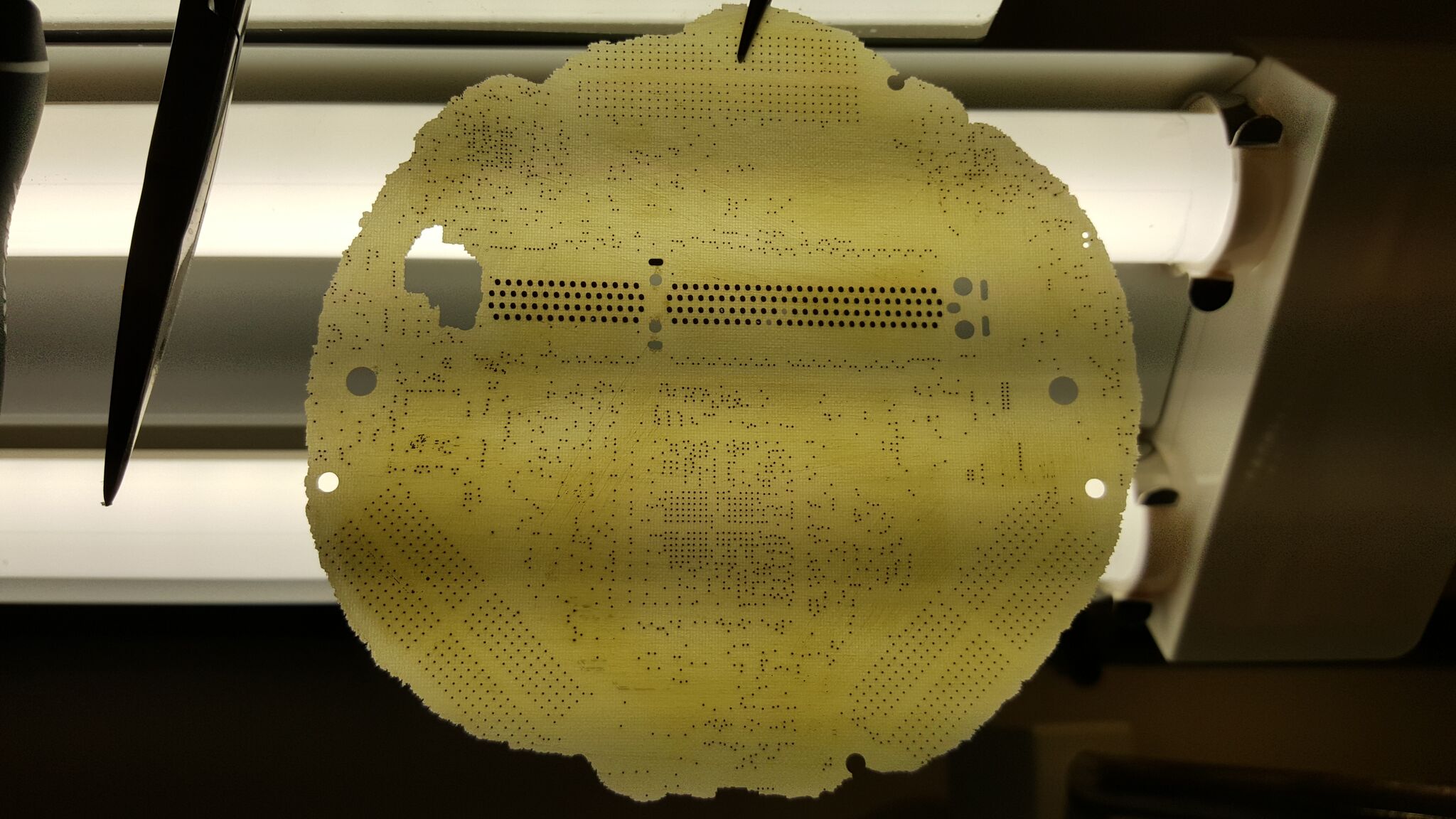

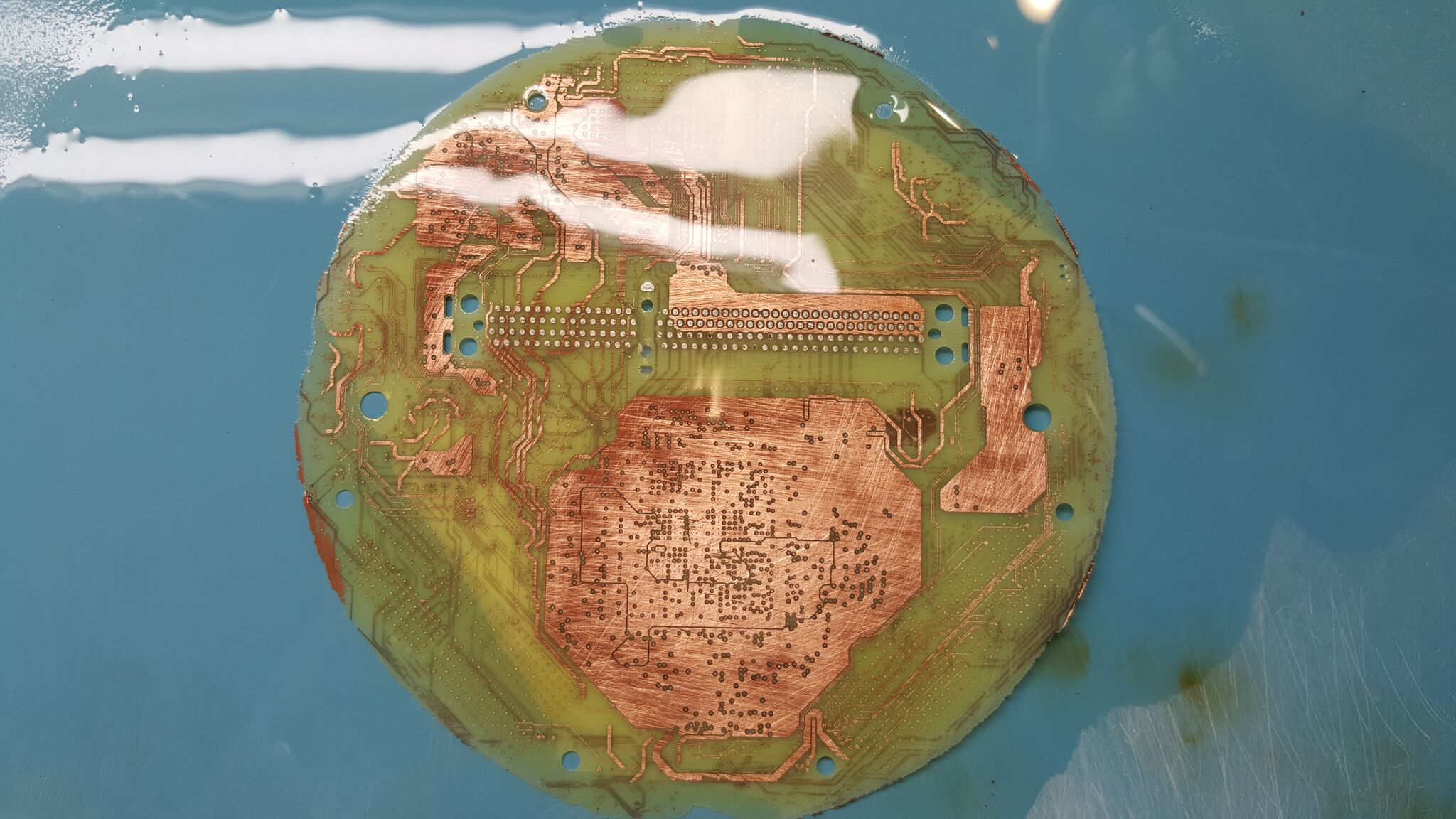

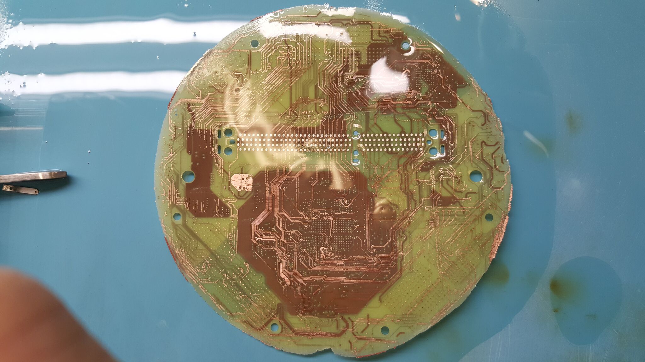

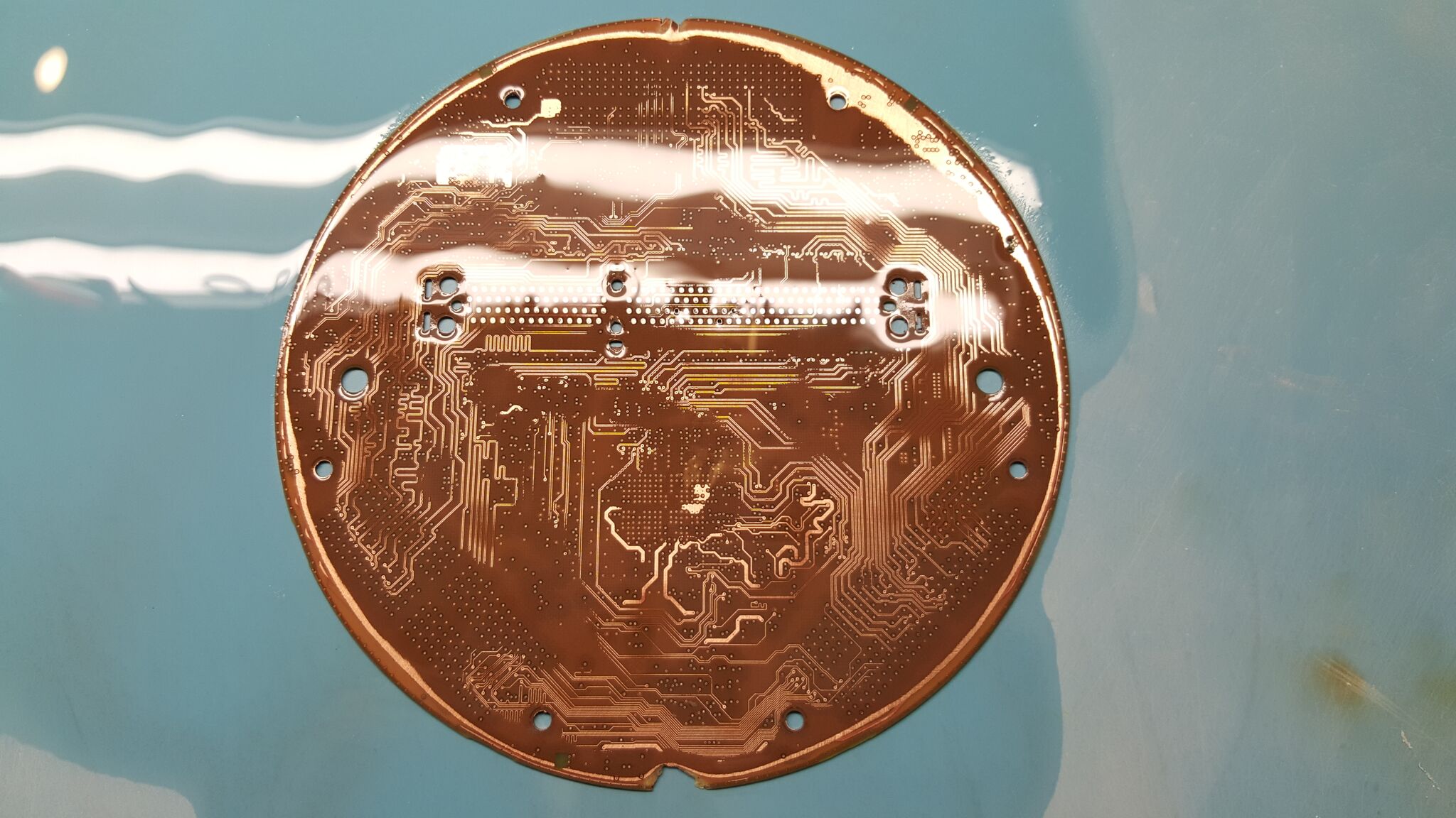

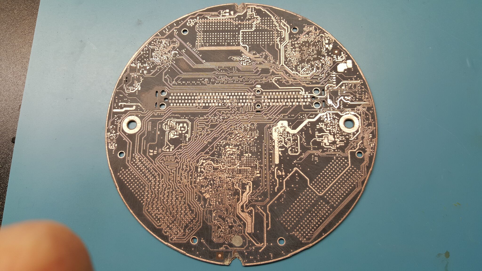

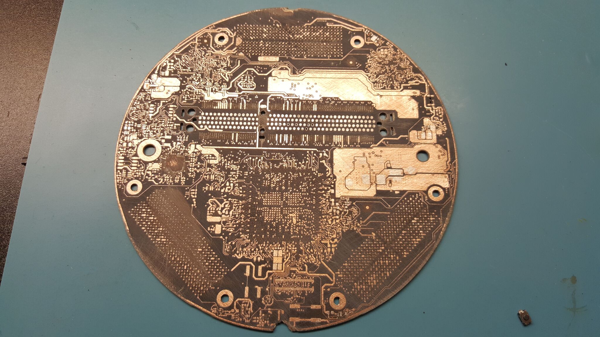

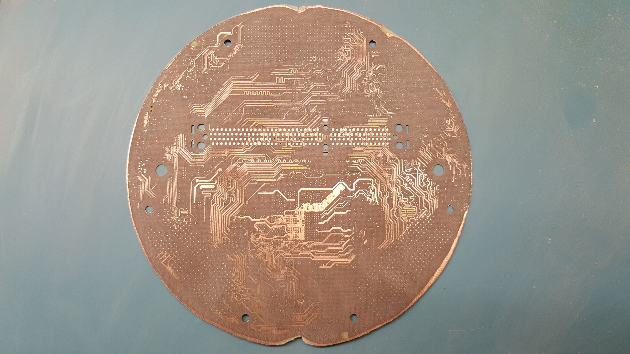

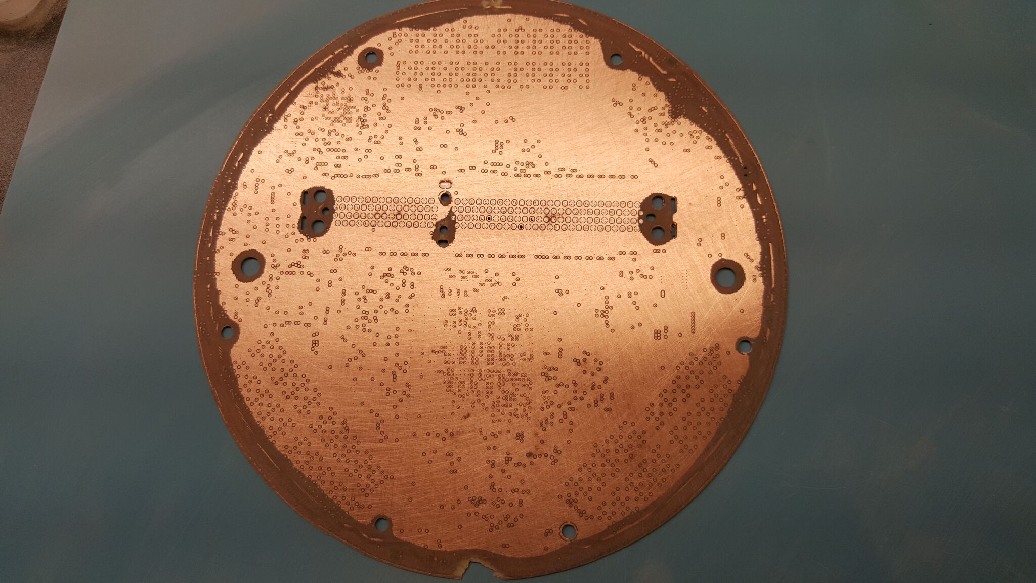

The Mac Pro 2013 Logic Board has 10 layers. Took two days to depopulate and sand down by hand. Not perfect. Next to sand down a Mac Pro 2013 CPU Riser Card, though I don't have a spare $800 lying around. If anyone wants to ship me a card or help sponsor my research send me a direct message thanks.
I accidentally sanded through a small portion of the trace in multiple layers. In the top layer, I lost some trace when I ripped components off the board because I was tired of manually desoldering each individual component.
I have never worked through the layers of a board before, this was my first time. So relatively speaking a great first try but I can do much better for the next board I perform this process on. I spend two days with a metal file and 100 grit sandpaper. If instead, I spend 5 days with 60, 80, 100 grit sandpaper and no metal file, and also depopulate the top layers with the aid of an open oven or 'hot plate' instead of crushing and ripping components off the board then it should come out with all the trace of every layer.

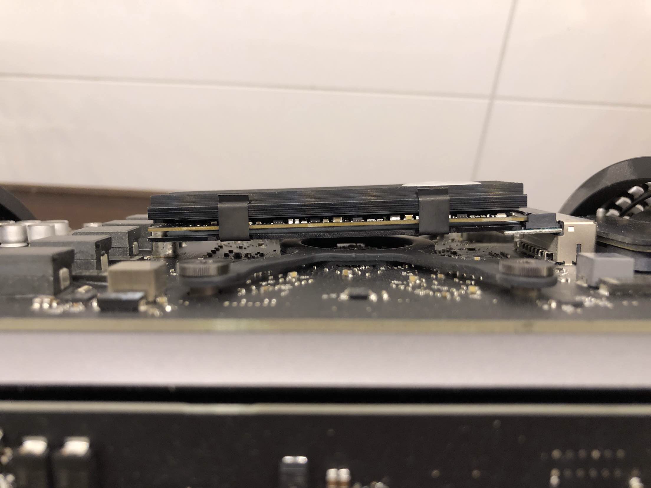

Finally 🙂
[doublepost=1513448411][/doublepost]Installing and cross my fingers
[doublepost=1513450341][/doublepost]I tried the adapter I bought from the webshop first, and got many strange error messages and hangup. Then i tried the adapter shipped by CodeJingle and that worked perfectly 🙂
