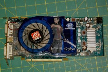

The Sapphire HD 3850 graphics card showed up in the mail today.
Looks dusty, taken some abuse at some time by the look of it!
How do you expect to get a PCIe GPU working in a G4? I don't think it's going to be possible.

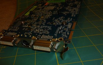

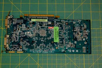

View attachment 619872 View attachment 619875View attachment 619873
Hmm, those mount points line up with nothing, and it's pretty think plus I'd have to cut holes in the base plate of this for the capacitors. Maybe this card wasn't ideal. But it was cheap!

So I looked at my collection of cards, compared screw holes.
A few were the same at the lower hole, but none were even close at the upper hole.

Plus many cards (video/graphics card particularly) use the socket screws to mount, not folded over tabs. Just like the Sapphire HD 3850, I kept the holes open for ventilation.
