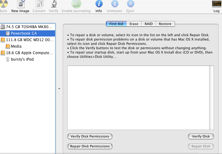

On my 15" PB, none of the problems you mentioned. I verified and repaired permissions right after I installed 10.4.4, you might want to do the same. 🙂
Applications -> Utilities -> Disk Utility
