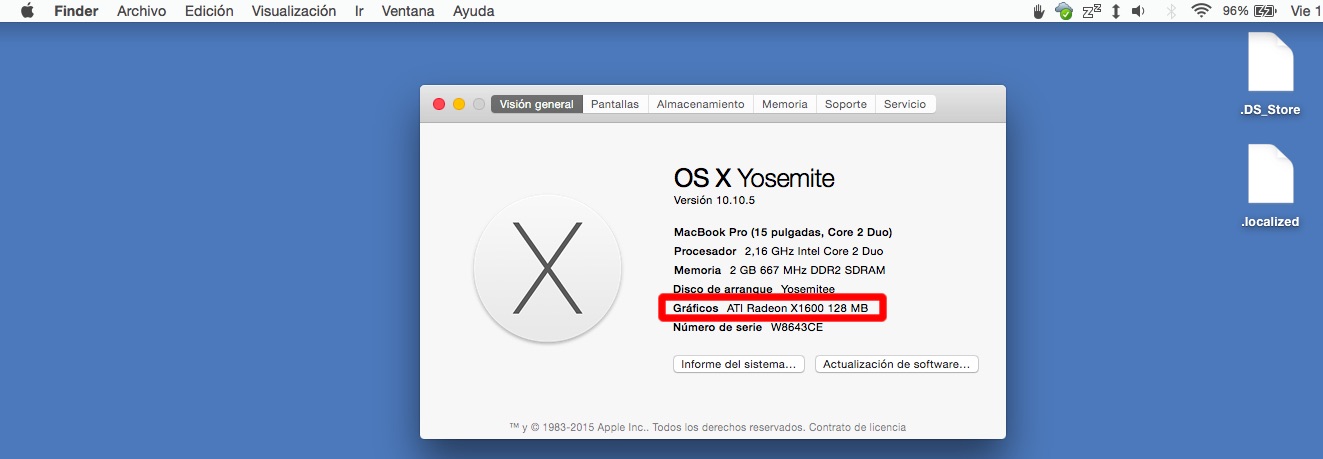

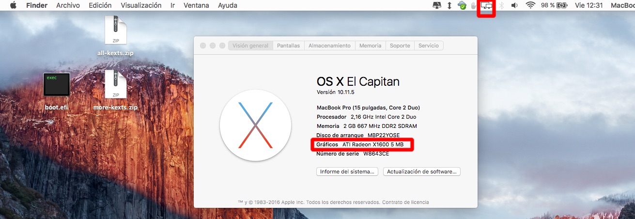

HOW TO INSTALL EL CAPITAN ON AN UNSUPPORTED MACBOOKPRO 2,2
INTRO
Hi, I've got an old MBP 2,2 ATI X1600 128MB. I've taken my "Capitann" external HDD, installed OS X Hackers ATI drivers and so on, and it has worked!
Basically, you have to follow the procedure as described in Post #502, but adding one step between 7 and 8:
THE 7,1 STEP
You have to download and install to your "Capitann" drive the OS X Hackers ATI drivers.
Download from here: http://dl.osxhackers.net/Kexts/ATI Kext Installer.pkg
When doing steps 10 and 11 you will see on your terminal these lines, added to the other ones:
kext-dev-mode allowing invalid signature -67061 0xFFFFFFFFFFFEFA0B for kext ATIRadeonX1000.kext
kext-dev-mode allowing invalid signature -67061 0xFFFFFFFFFFFEFA0B for kext ATIFramebuffer.kext
kext-dev-mode allowing invalid signature -67061 0xFFFFFFFFFFFEFA0B for kext ATI1900Controller.kext
kext-dev-mode allowing invalid signature -67061 0xFFFFFFFFFFFEFA0B for kext ATI1600Controller.kext
kext-dev-mode allowing invalid signature -67061 0xFFFFFFFFFFFEFA0B for kext ATI1300Controller.kext
ISSUES
The issues with MBP2,2 are the same that with MB2,1, but maybe related to graphics issues are worse, because the MBP screen is detected as an external one, this was what happened with MB2,1 before installing GMA950 kexts in compatibility mode. Besides, I cannot open Preview (I don't know if it's a coincidence or a consequence of this issue).
It seems these OS X Hackers are ready for Yosemite, but the El Capitan version has not released yet, as it happens with GMA950.
So, here we are, waiting for the next graphical kexts release 🙂
Thanks a lot to TRMJIJ and the rest of OS X Hackers.
I'm attaching two screen captures to see the difference between kexts and yose/capitan.
